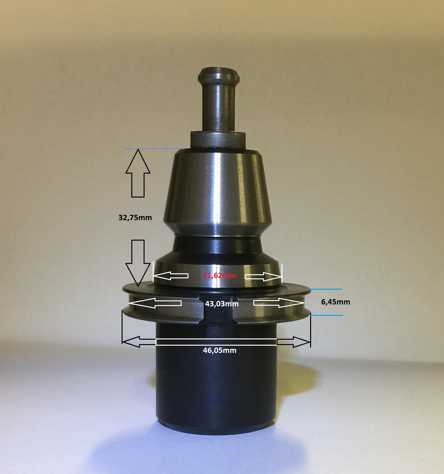

Ok, I`m stuck here.
Looking at my toolholders for my VMC300, there`s a difference between them, and the toolholders at Coventry Toolholders.
(http://www.coveng.co.uk/group/covent...sy-change.html)

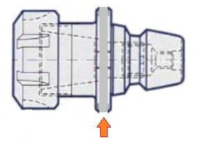

Mine has a machined groove in the top flange, and i do believe for my ATC holder(spring loaded fork). Se Attached Picture.
However the toolholders at Coventry has not :-\
Looking at the video on youtube, it seems they have 2 types. One With just the 2 notches on each side, and one With additional groove for a ATC Version With spring loaded fork.
Am i completely off track here, or is my assumption correct ?
Are there any drawings in some far away corner of the internet on these toolholders if i would make them myself ?
I could of course make my own drawing and plot it in.
They are a bit expencive if you need say more than 5-10pcs ER32 Easy Change Collet Chucks..
Any advice gents ?

Have you got any pictures of an existing tool holder?
I'm not aware that Coventry ever made anything suitable for an ATC, and I'd guess the ATC uses a more standard taper. A good list of standards with dimensions can be found at http://www.tools-n-gizmos.com/specs/Tapers.html

Don`t know if Coventry Toolholders is the correct one, but i do beleive to remember that name from another post somewhere here in the forum.
Took a Picture of it, and measured som of the Critical parts.
By the way i took a lokk at the link you gave me, but could not find anything even Close to it.
Maybe my Pictures could explain better, or hopefully somebody recognizes the holder...
Attachment 20022
Re: VMC300 Toolholder question
Looks like a compact version of a BT30 holder, with a pretty standard pull stud on top.
If my maths is correct, given the height on your photo, the diameter of the top would be about 22mm?
Unfortunately that means it's most likely a custom holder, so getting more will not be straightforward.

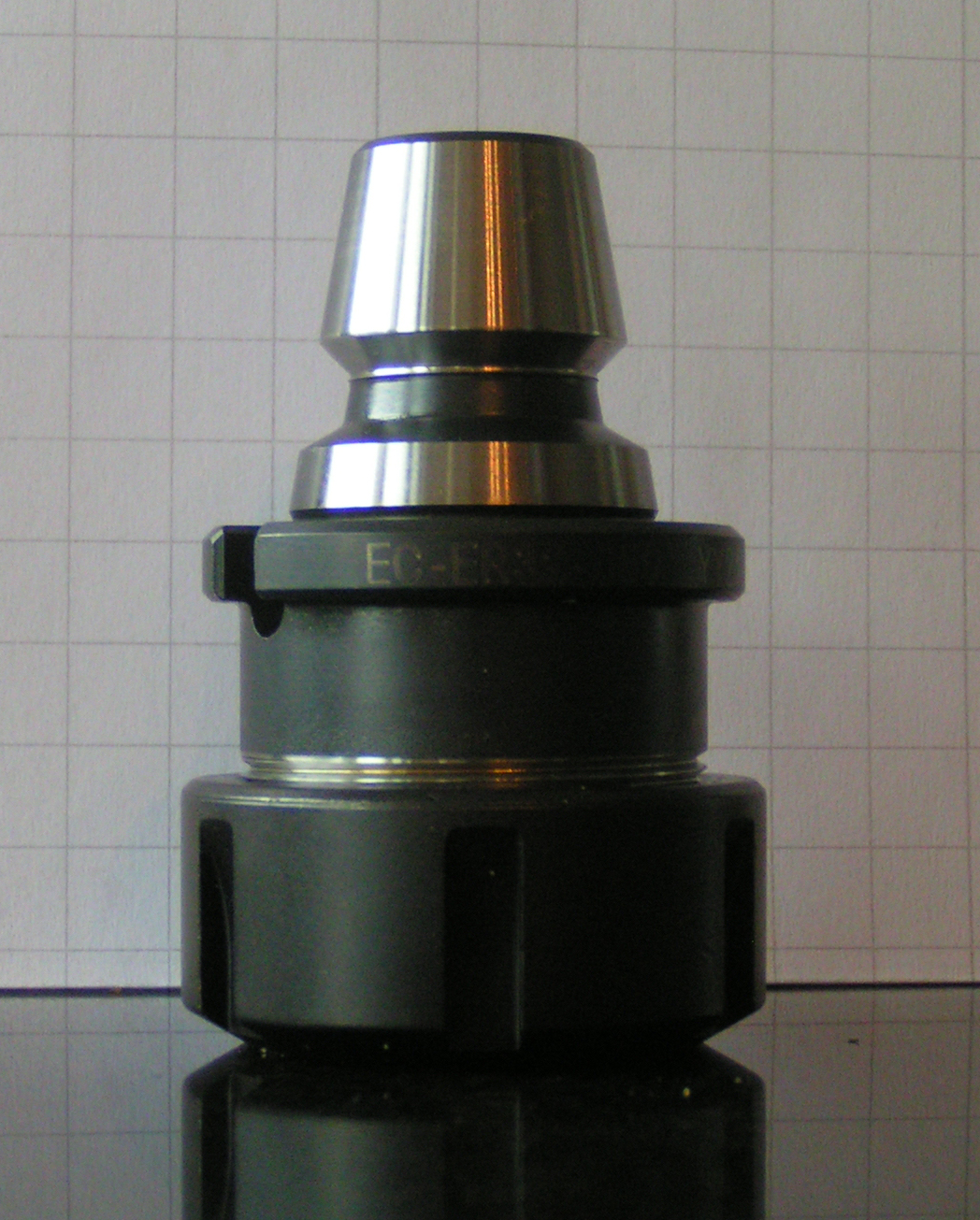

The background grid is 1cm
The tool holder is a Coventry Quick Change
Attachment 20027
There will be a little parallax but it should give you a pretty good idea of the dimensions and angles,

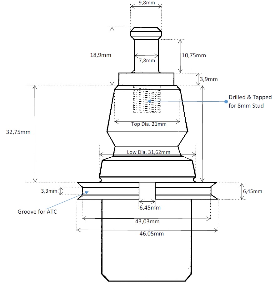

I`m adding a sketch i made today With all Critical measurements.
Attachment 20034
Will also send it to Coventry Toolholders and have them confirm all measurements and explanation as to why the groove is missing in the top flange in their catalog.
Believe the flange is a special Boxford solution on their first ATC`s.. or something...
Would be interesting to know if there`s anybody that would buy any of my bearly used standard Easy Change toolholder like the on in the Picture though.

Because it's not a Coventry Easy Change tool holder.
I've just been and compared one to a BT30, and the Easy Change holders have a steeper taper, which would be correct as the Easy Change holder doesn't use a self locking taper, whereas the BT taper usually is self locking and needs force to remove it.
Unfortunately the battery is flat in my angle calipers and I don't have a spare, so can't give an exact angle.

I compared it to the BT30 as well and the angle is different.
Besides the taper length on BT30 is 50,4mm(including the 2mm notch), whereas my mystery taper lengt is 32,75mm.

Measured the angle and although it might not be dead accurate, it reads 21 degrees.
(Se Attached sketch)
Attachment 20038
I just hope Coventry feedback next week will tell me something...

This is basic Math Nick, but the Challenge is to measure 100% correct top diameter on the taper and correct distance in between(the taper top i slightly rounded).
Tryed to improve my measurements and got lower dia at 31,61, top dia at 20,9 and length at 30. This gives a Cone angle α = 20.24° = 20°14' , taper 35.7%.
This is definately no standard taper in my opinion...

Got answer from Coventry today.
The toolholders are custom made for Boxford.
Production stopped in 2012, but they can make them at 156£ each with the groove. However, i strongly belive it's the same as their standard Easychange toolholder(without the groove).
I will order 1 and check similarity with the ones i have. For nearly 60£, i could could even fix that groove myself in my lathe.
The pullstuds however is a Boxford product according to Coventry.
Will have to make them myself
