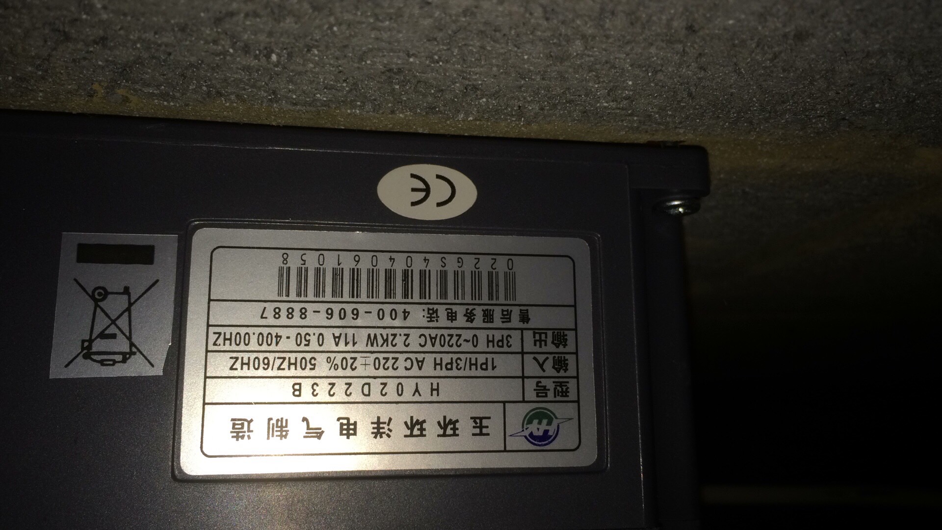

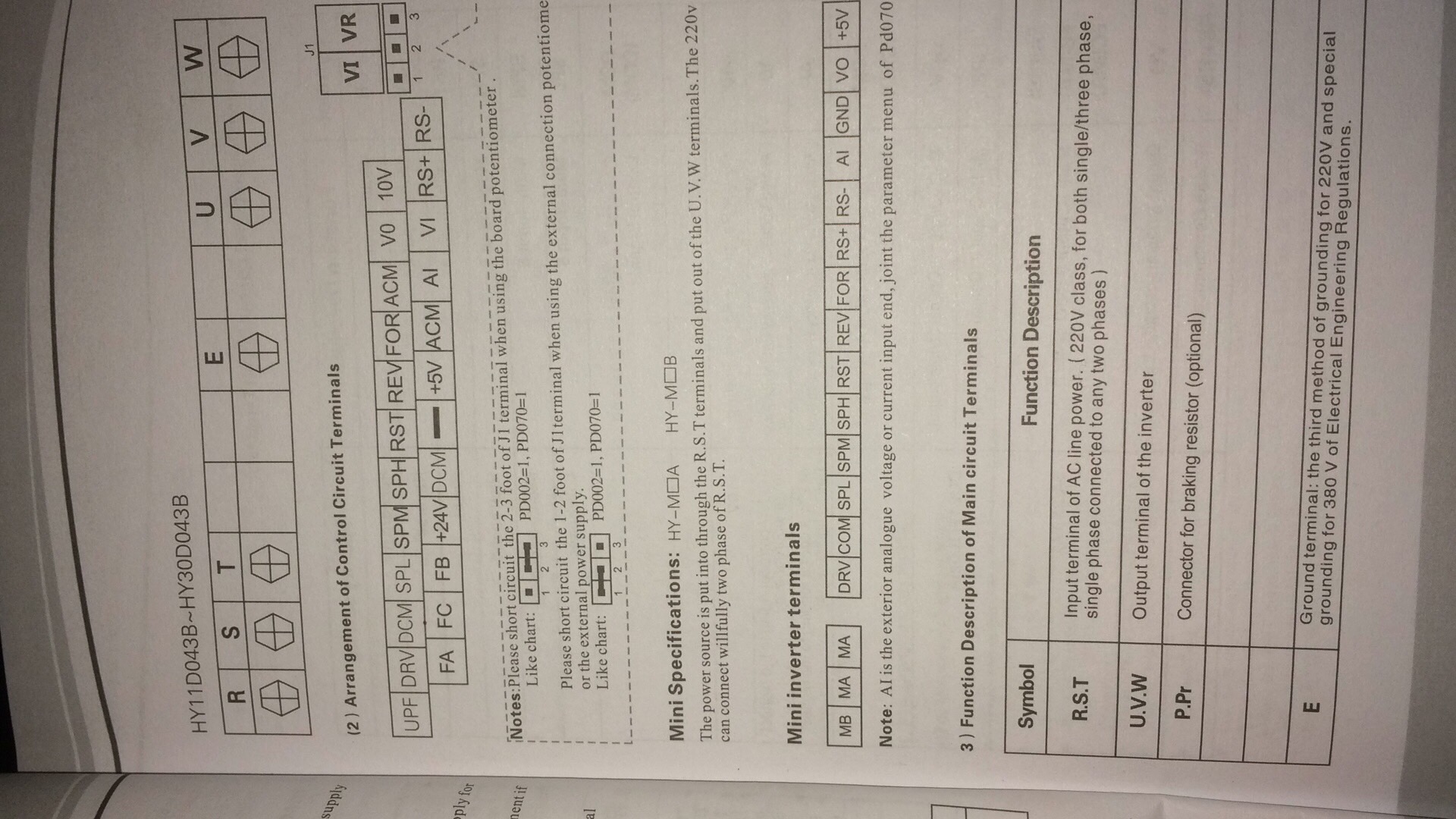

Hi, I've recently bought Huanyang HY02D223B and I'm stuck with wiring.
I've read 67 pages manual and could not find single sentence where I should conect L (live ) N ( neutral) and earth.
On manual say it is single phase 230v wired or 3 phase 380v wired.
If my house have 380 V supply I have no problem with wiring.
But my house is single phase 230v.
All I need is someone to tell me where to connect
L as ( live)
N as ( neutral)
Earth.
Many thanks. Stan
Re: Wiring Huanyang HY02D223B

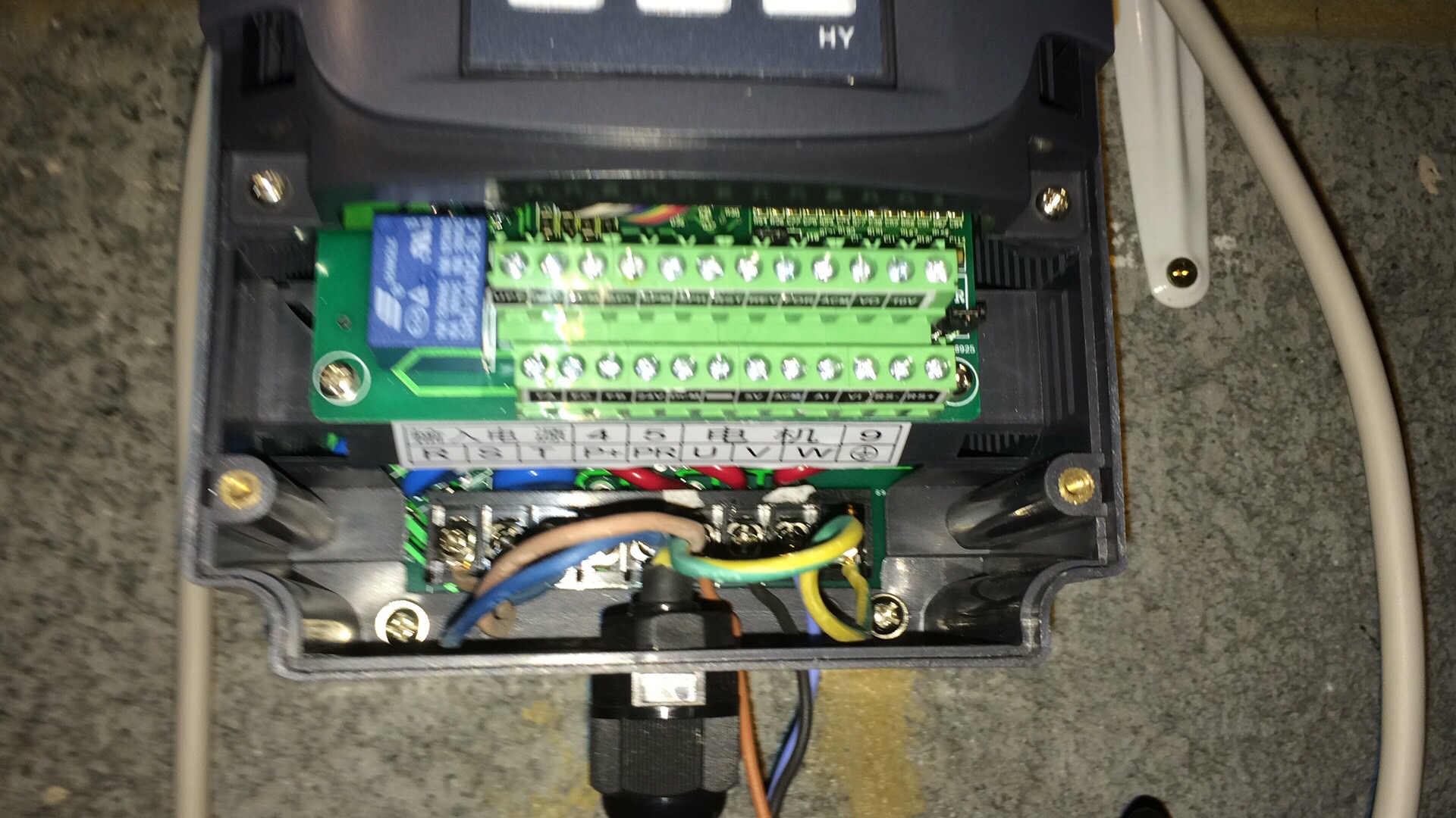

On page 10 of the manual, the connections R,S,T are for three phase, but you just use any two of them to connect Live and Neutral of single phase. Earth in both cases goes to the E terminal.

L goes to R or S or T
Earth goes to E(9)
And N?
I can't connect N to R or S or T
R,S,T is phase not Neutral
It tripped my Fuse straight, I've tried, twice.
Thanks for replying. Stan
Cropwell is quite right - you connect live to one of the RST terminals and neutral to one of the other two. It doesn't matter which. My HY inverter has been working beautifully for a few years like this, just like many others. If your MCB or RCD is tripping, there must be a fault elsewhere - can you describe a bit more what the inverter is plugged in to?

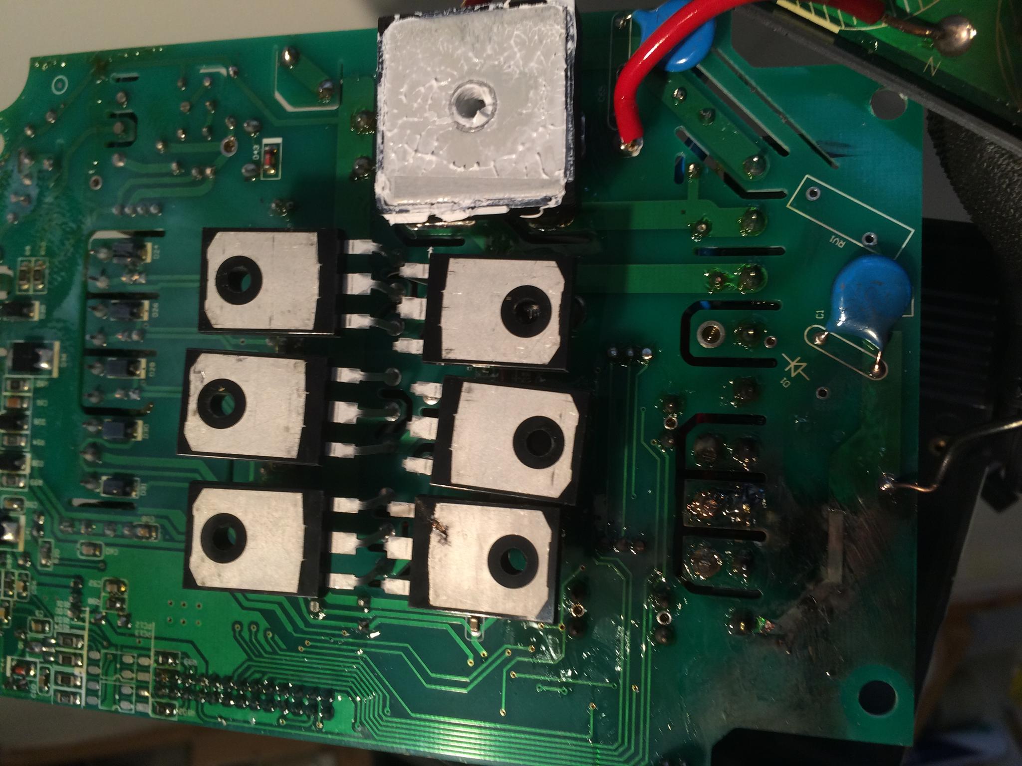

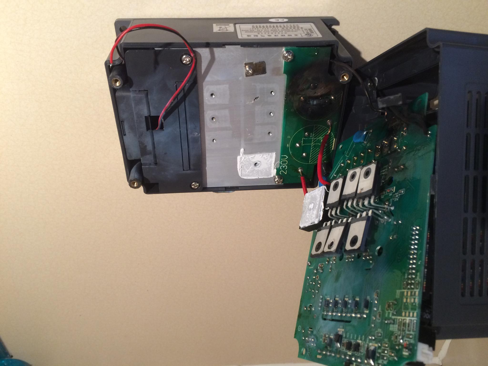

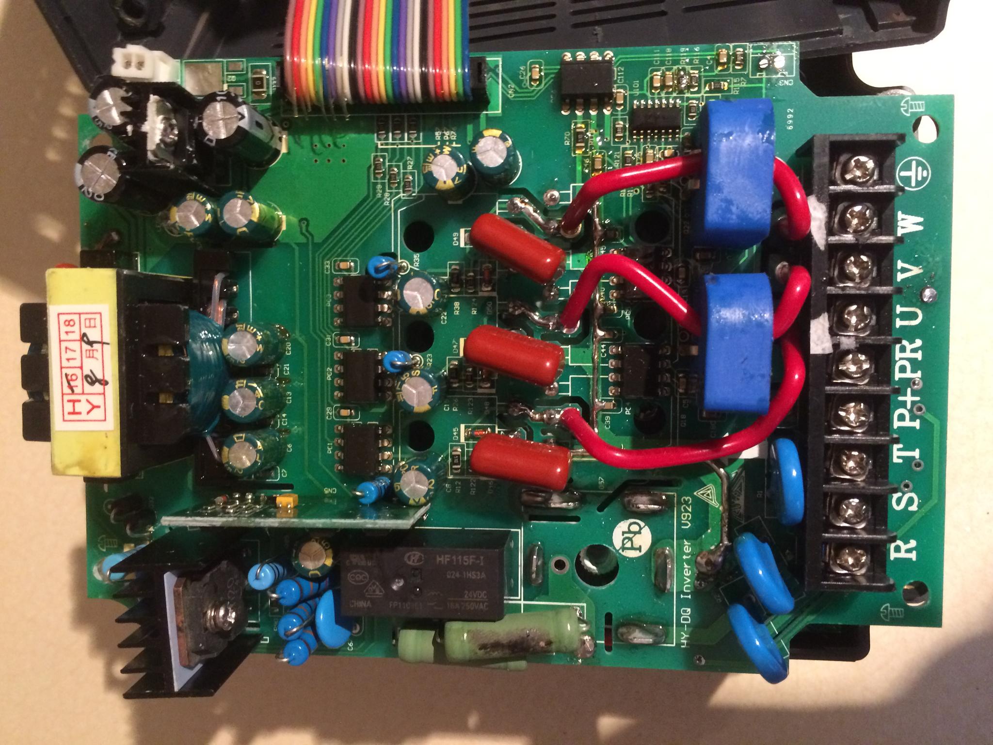

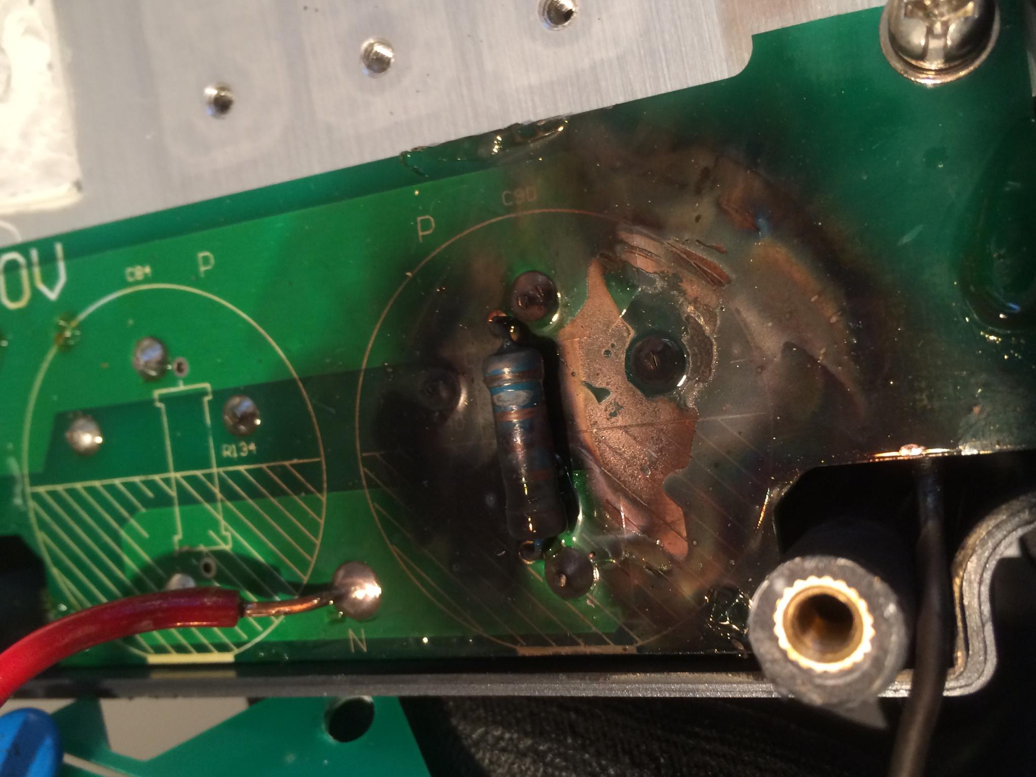

6 Attachment(s)

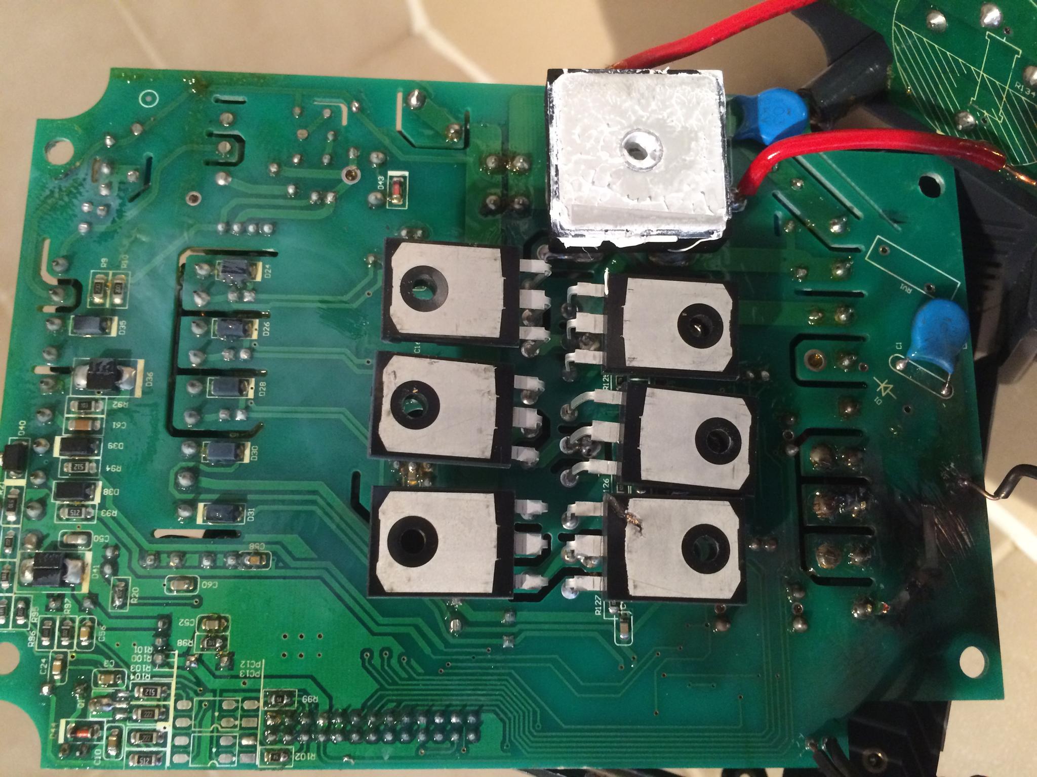

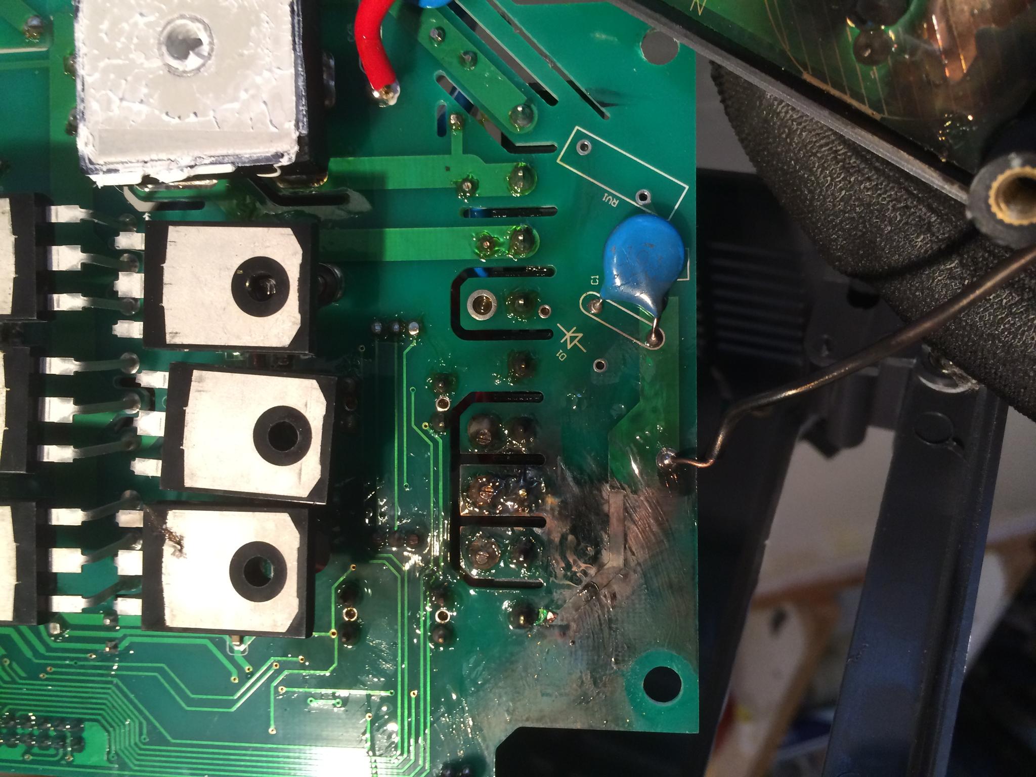

Hi, thanks to all who replied.
It's all over now.
I've waisted £299.
My VFD is burned out.
Unfortunatelly I wan't so lucky as many of you with my VDF Huanyang.
It's all about wiring.
RST is life only, you can't conect N neutral to it, it will burn as mine.
Thank you all for your support, I appreciate it.
Attachment 20143Attachment 20144Attachment 20145Attachment 20146Attachment 20147Attachment 20148

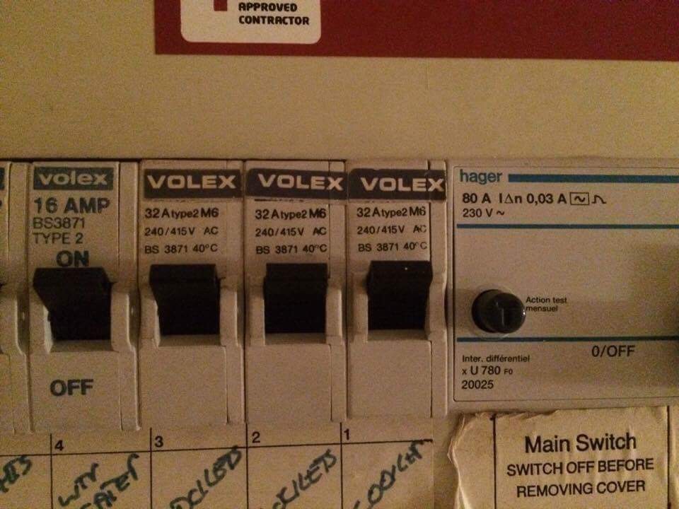

I have fuse board, one fuse 32 A type2 M6 is going to my garage, wire is 2,5mm, strong enought . Also on fuse board is 80A RCD.

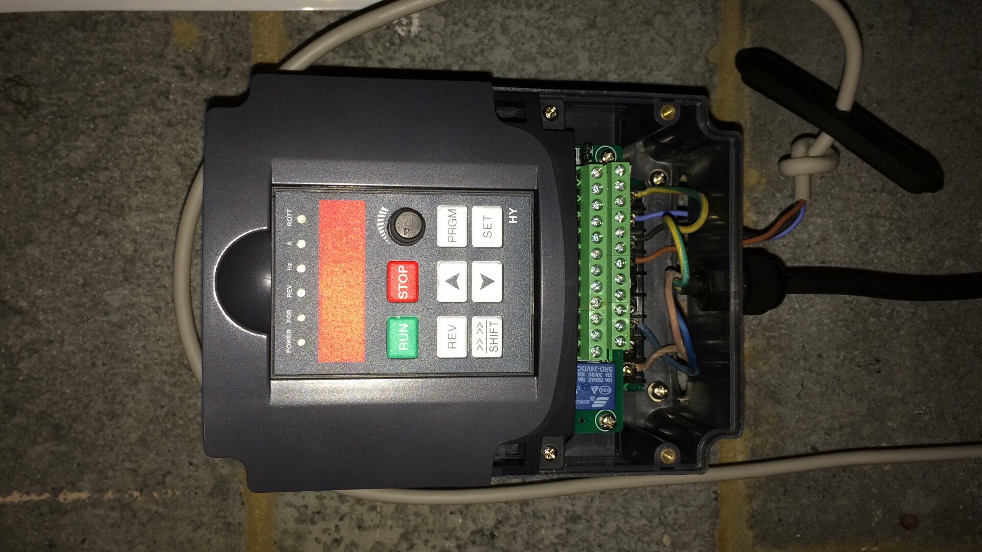

Maybe the RCD 's is problem?Attachment 20149

The problem I foung is that my RCD is not strong enought tho hold the leakage that VFD make when is powered on.
Now the option is to upgrade my RCD to higher - ( which is very expensive) or disconect it , but only for my VFD.
Any suggestion? What should I do?
Shoul I try to connect it one more time but without the RCD?
Many thx. Stan

Attachment 20151Hi.
I've connected main, 240v R and T and E and UVW cabel, but only cabel, nothing was connected to motor.
Sympthoms of damage was white smoke, strong smell.
It is not normal that it trips the RCD. If it does then something is wrong but at the same time tripping the RCD means the VFD may still be OK and not burned. Maybe it is easily repaired perhaps just a simple short circuit inside. Anyway, demand a refund. It is obvious that something is wrong.
Edit: just saw your last post. White smoke, bad smell means it is definitely burned. Demand a refund but expect long discussion with the seller, he will blame you. Don't waste time, time is to the advantage of the seller only.

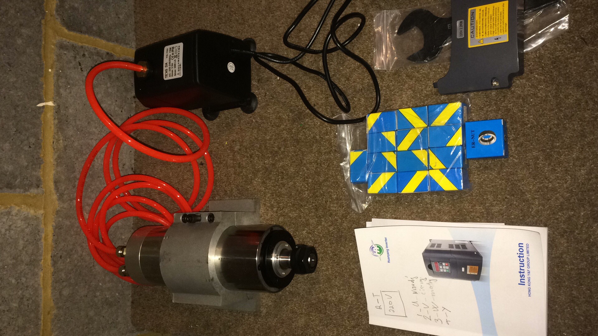

7 Attachment(s)

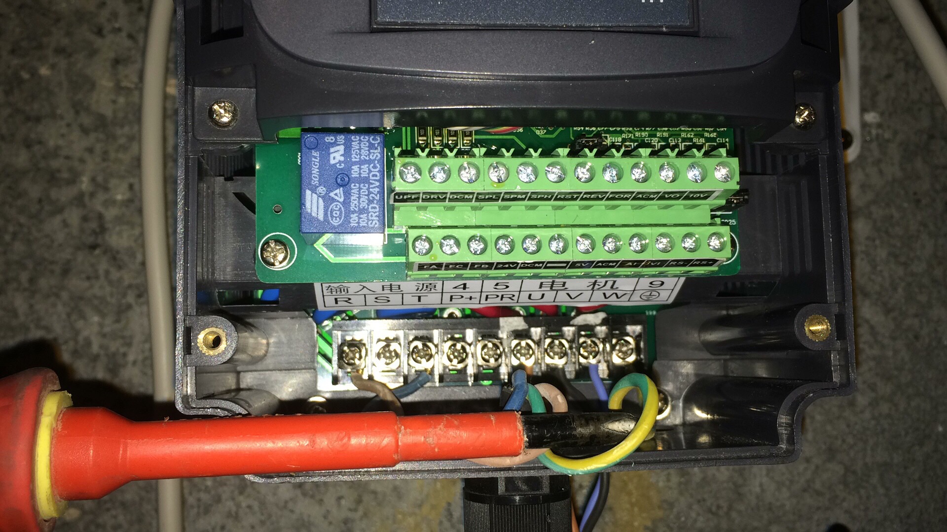

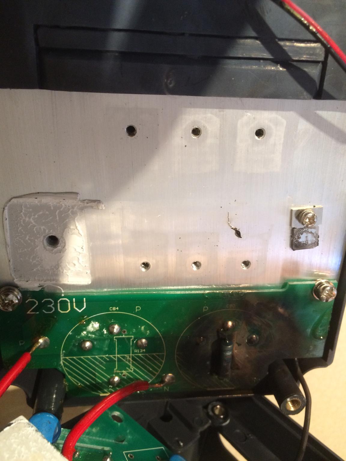

Hi all.
Just updating about my Huanyang.
eBay sellers refusing refund/ exchange
Here's what happened.
Wired L to R and N to T and earth to E(9)
Tripping RCD, twice, checked connection, have read manual, contacted eBay seller about wiring (he send me video) and scheme.
I've checked wires, wiring, exchange few messages here
Tried again and it burned.
Thanks all for support.
Buying cheap/ buying twice. ( I learned)
Attachment 20171
Attachment 20172
Attachment 20173Attachment 20174Attachment 20175Attachment 20176Attachment 20177

Where the ends separated.? If not This may have caused the 3 phase wire to short.
I've fitted more than 100 of these and only had about 3 faulty on first fit and only 2 or 3 actually fail in use within the warranty period.
If your sure you didn't cock up then It's unacceptable and Ebay will act if you contact them but don't go showing them those Pics. It wasn't wise thing to do stripping the VFD and breaking the warrenty seal.
However in all my dealings (lots) with the Chinese they never ask for damaged or faulty goods to be returned but keep stum don't tell you stripped it.
