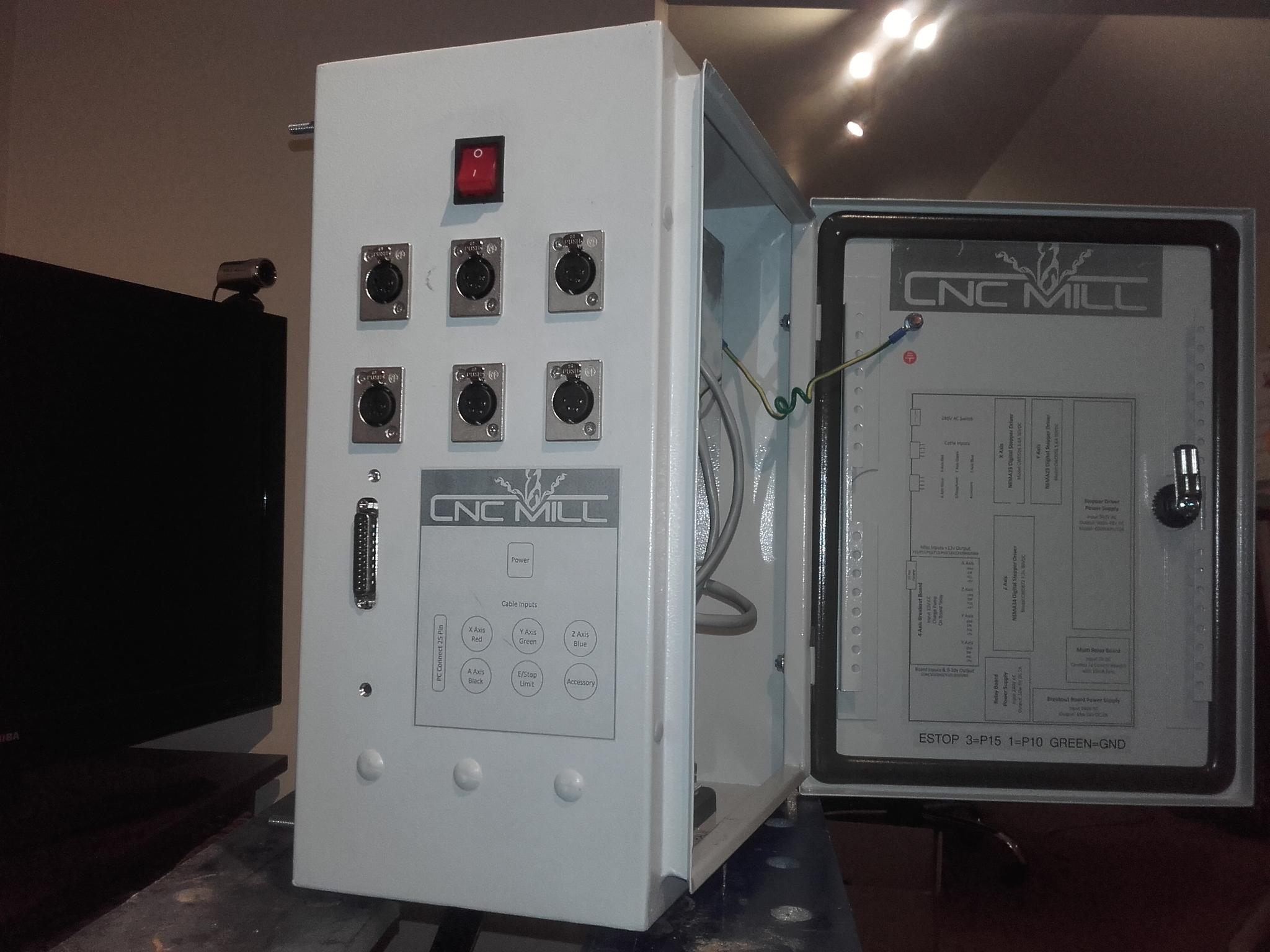

Things I've done/bought so far....
p
Electronics
• NEMA23 4nm motors for X & Y axis
• NEMA34 8nm motor for Z axis (I plan to add power drawbar etc and had read that a bigger motor would be a good idea for the Z axis
• Digital steppers, 5.6A for NEMA23 and 7.2A for NEMA34
• CP0-10V 4 axis breakout board. Only planning on using 3 Axis initially but wanted to leave option for 4th if it ever became desirable
• 48v power supply for drivers/motors
• 24v power supply for breakout board
• I've added an additional 4 relays and seperate 5v power supply to control box for future upgrades
p

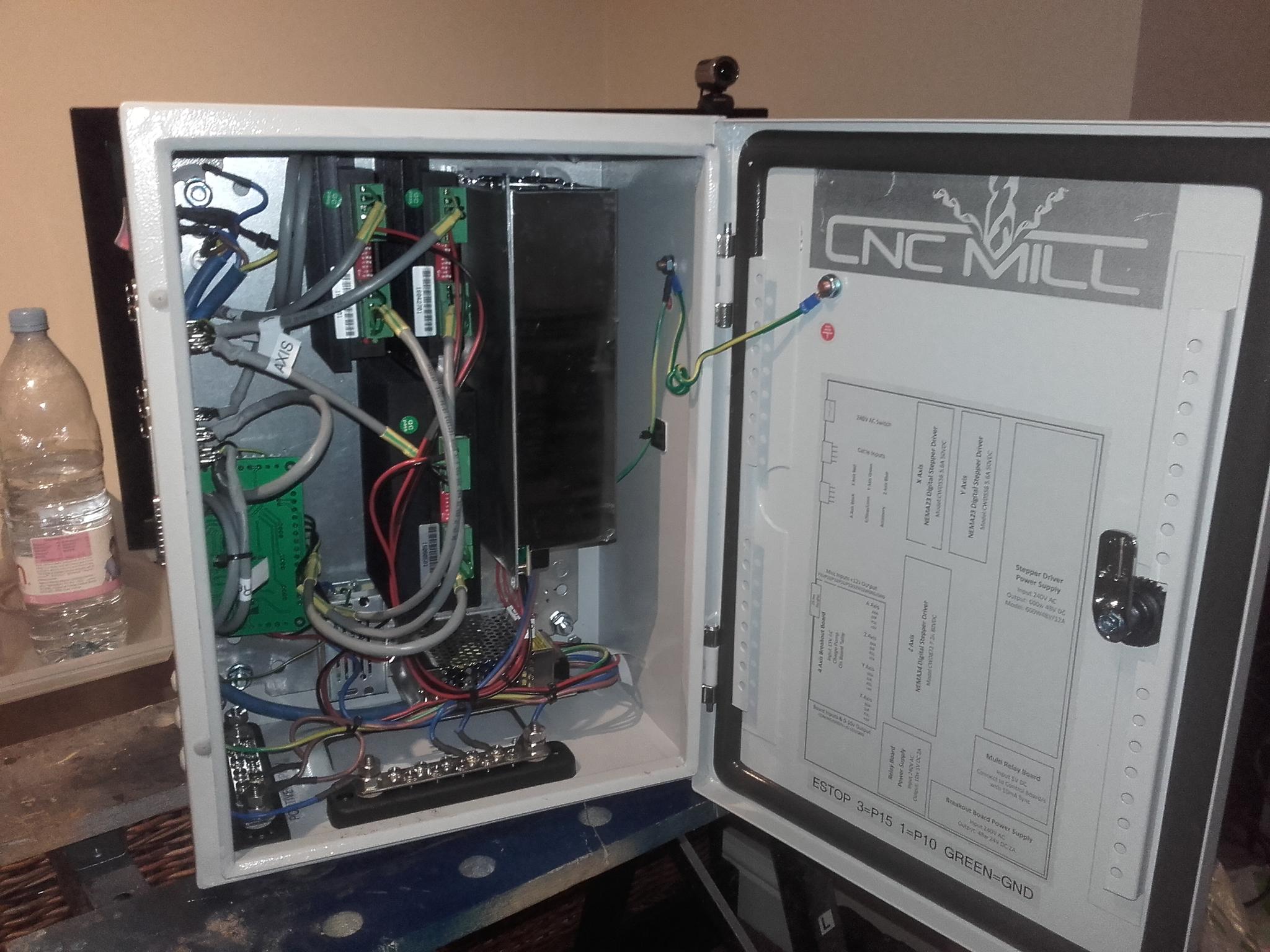

At this stage I've pretty much finished up the machine control box. (you'll note from the pics that even if I cant afford a Tormach, I can at least have a fancy Tormach inspired logo? lol)

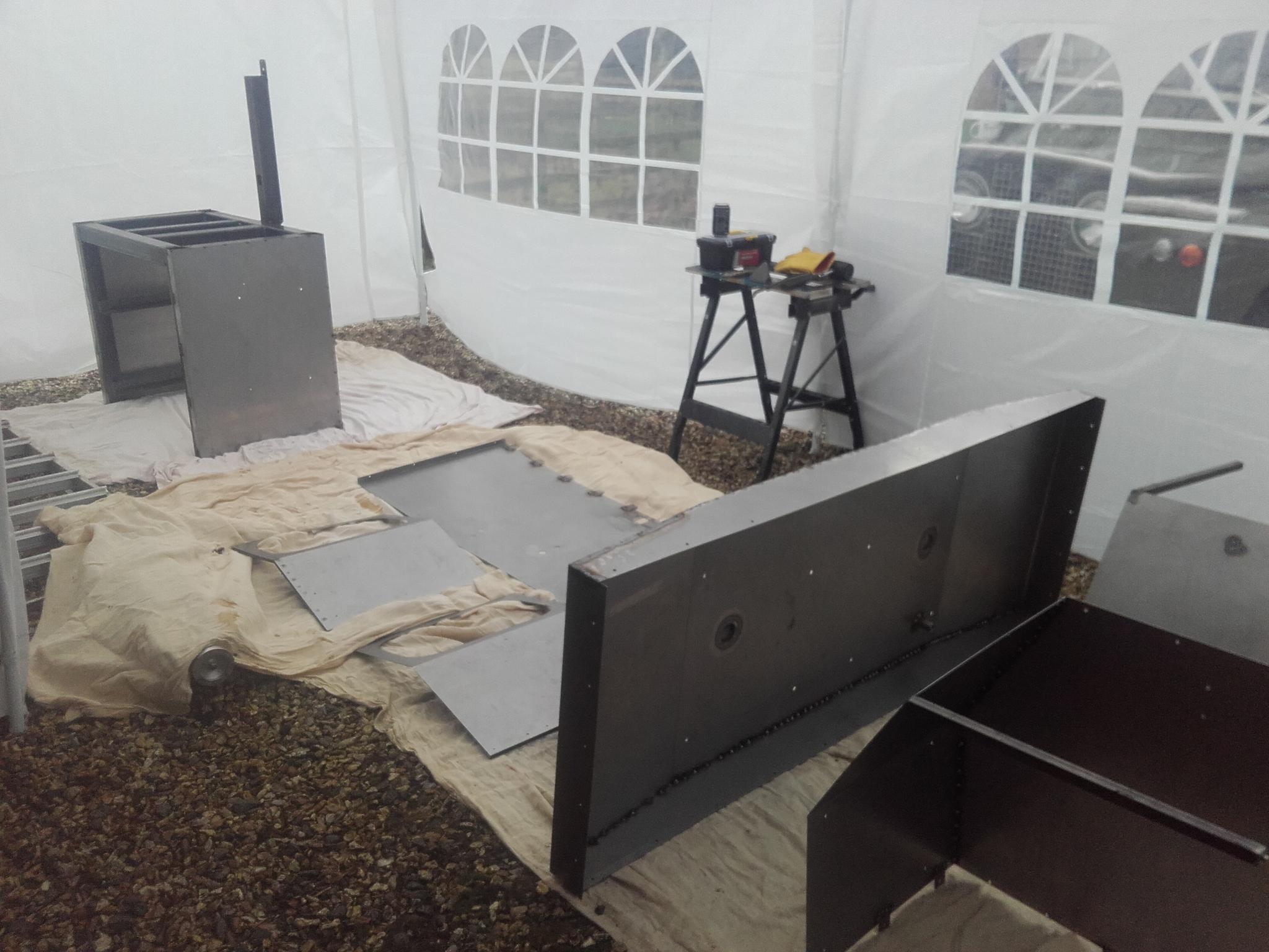

2 Attachment(s)
Re: Converting an AMAT25LV

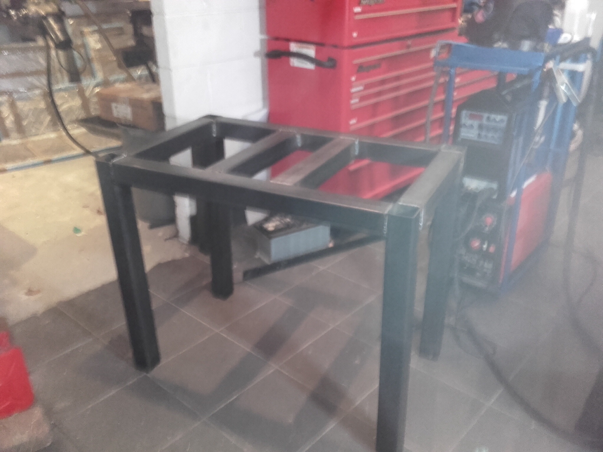

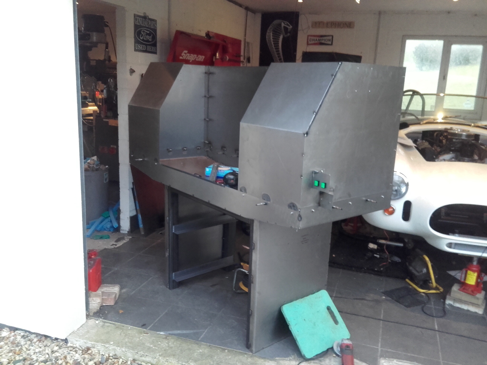

Made some progress on the enclosure this weekend. Quite a lot yet to do but with luck I'm hoping to get it in primer and enamelled next weekend.
P
Have set it up for flood coolant for the future. There's also box section at the rear to bolt the Z column to. If nothing else should be able to hold everything pretty rigid.
P
Mill arrives next Saturday so hoping to make a start taking that apart soon. :smile:

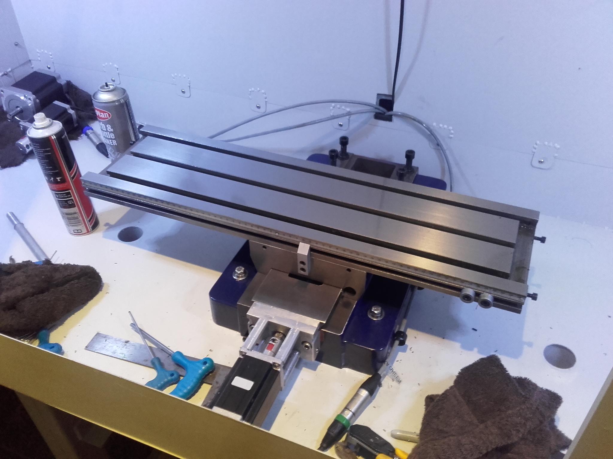

3 Attachment(s)

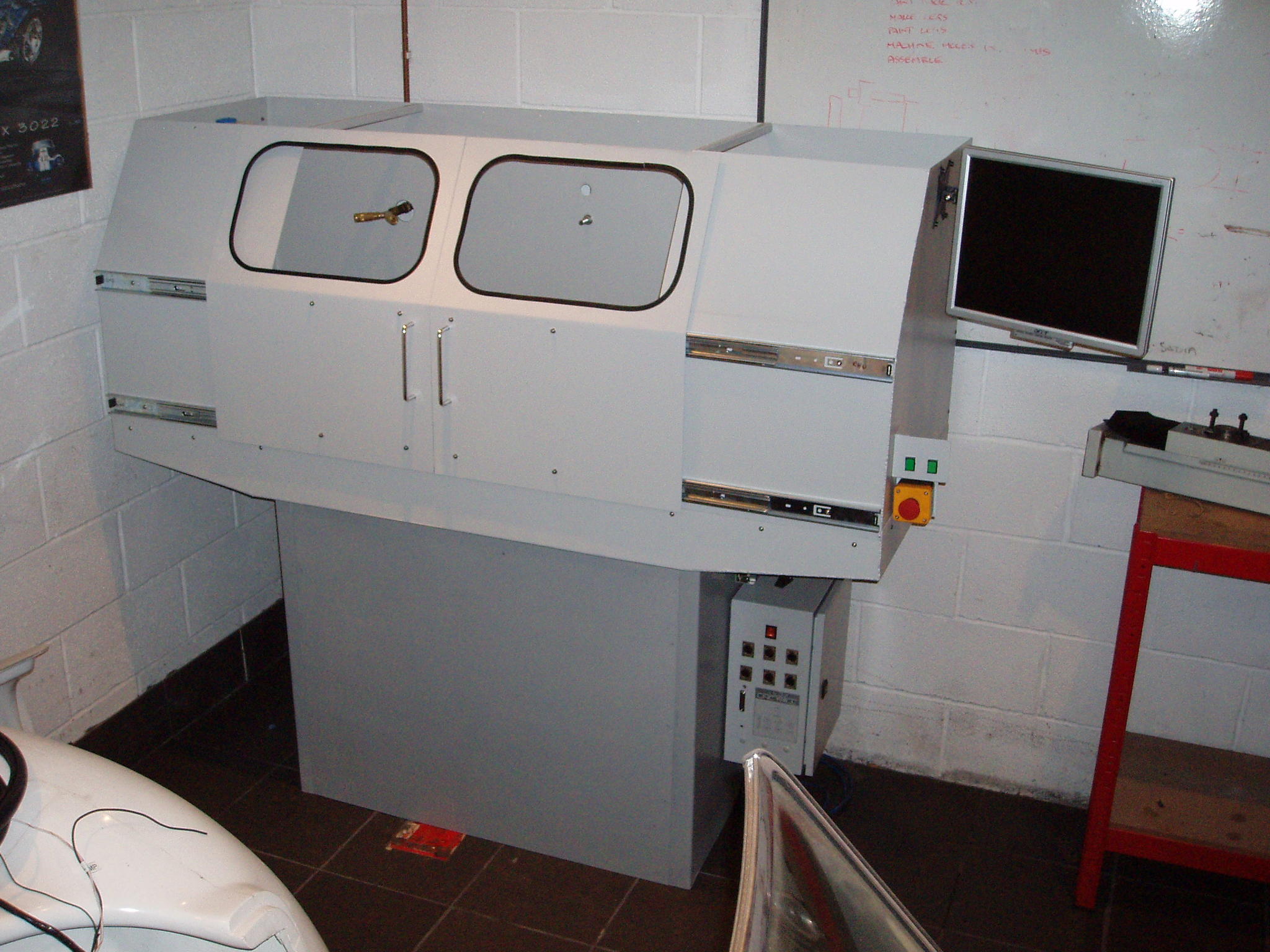

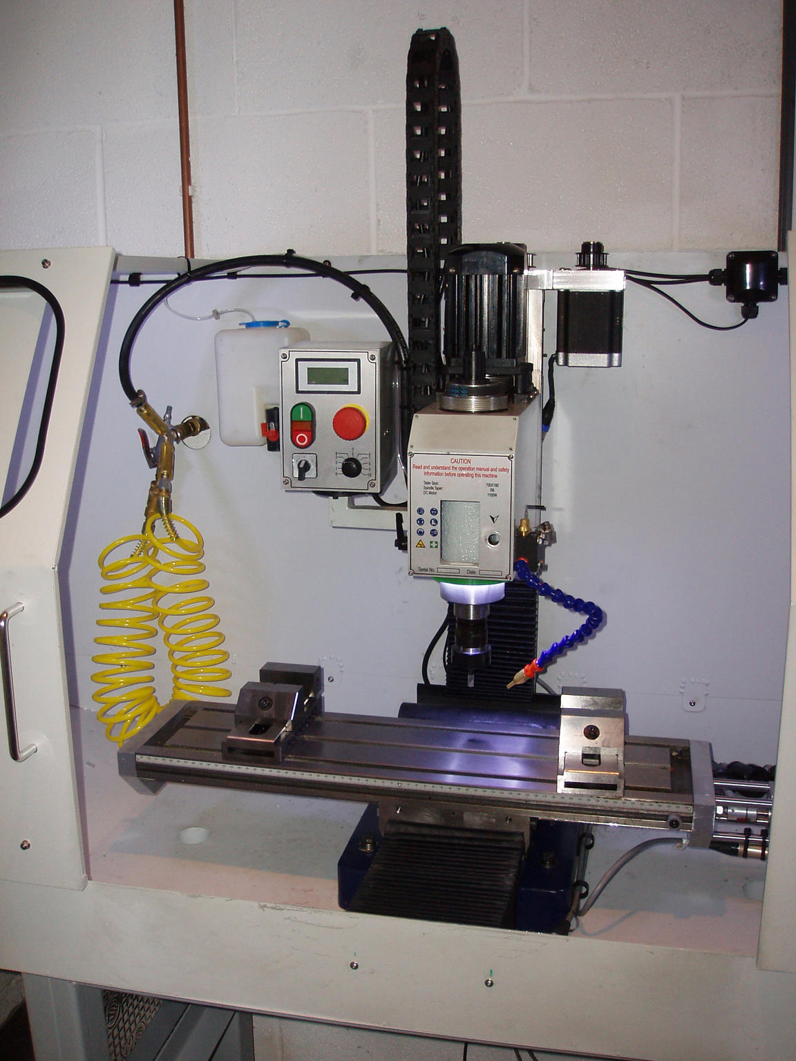

Bit more progress over the weekend. Pretty much finished up my enclosure. A 3rd set of rails for the tops of the doors to be added, and some more polycarb for the windows now that I've measured it right! Some final wiring of lights etc and its about there. I've plastered it in sound deadening and its bolted to both the floor and the wall so very rigid. Will be nice to have a bit less cleaning up to do, the Bridgeport fills the whole shop with chips.
P
I've also put a fixing in at the rear direct through the enclosure to the wall to give me a strong point to anchor the column to to beef up its rigidity further. I'm planning to add some adjusting screws to help tramming the mill. How well do the columns line up on these little Chinese mills normally? The mounting faces look nicely ground but I've not done any measurements at this stage.
P

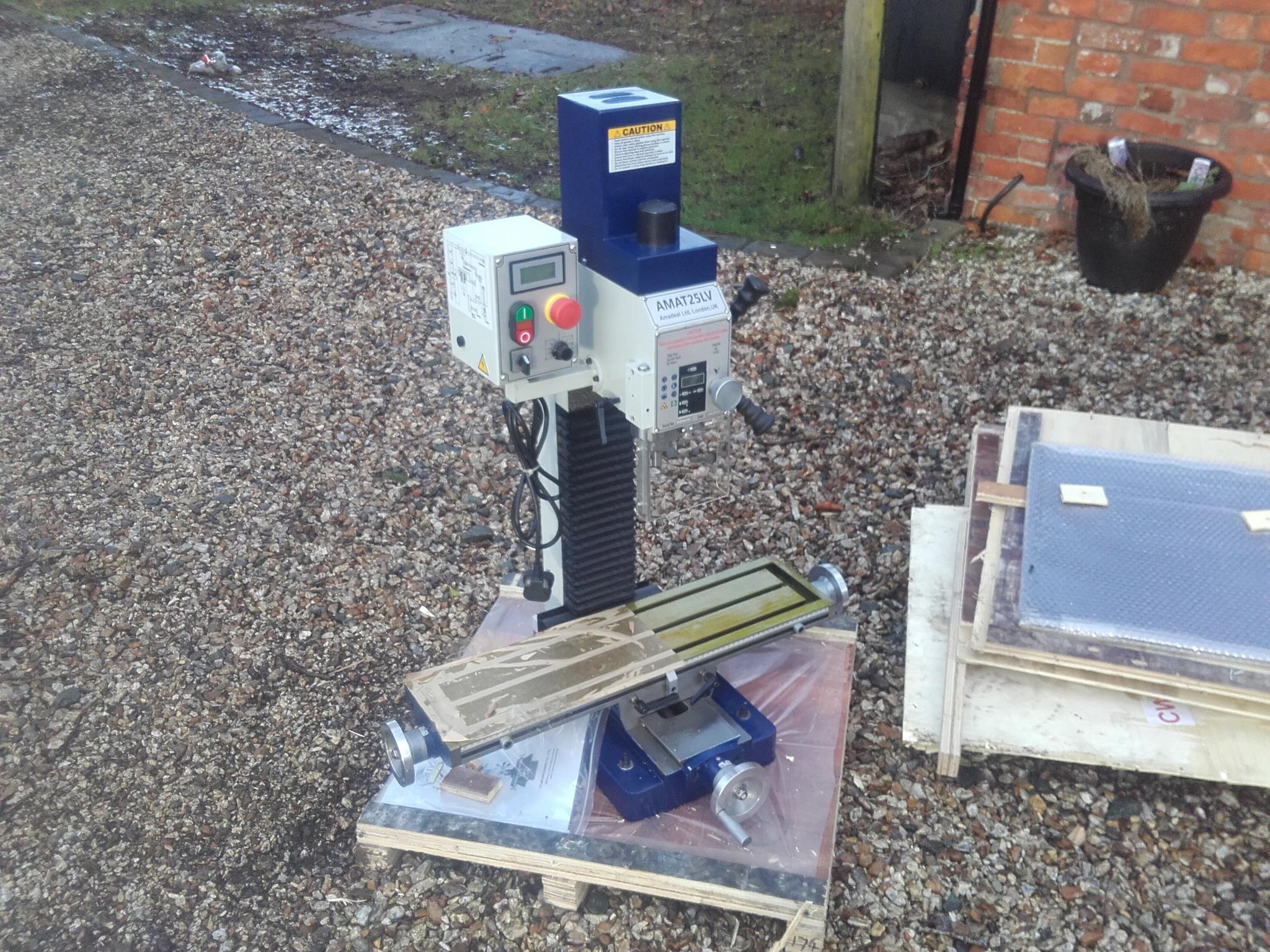

The mill arrived so starting stripping that down as well. First time I've bought a brand new machine then proceeded to start throwing half of it away!
P

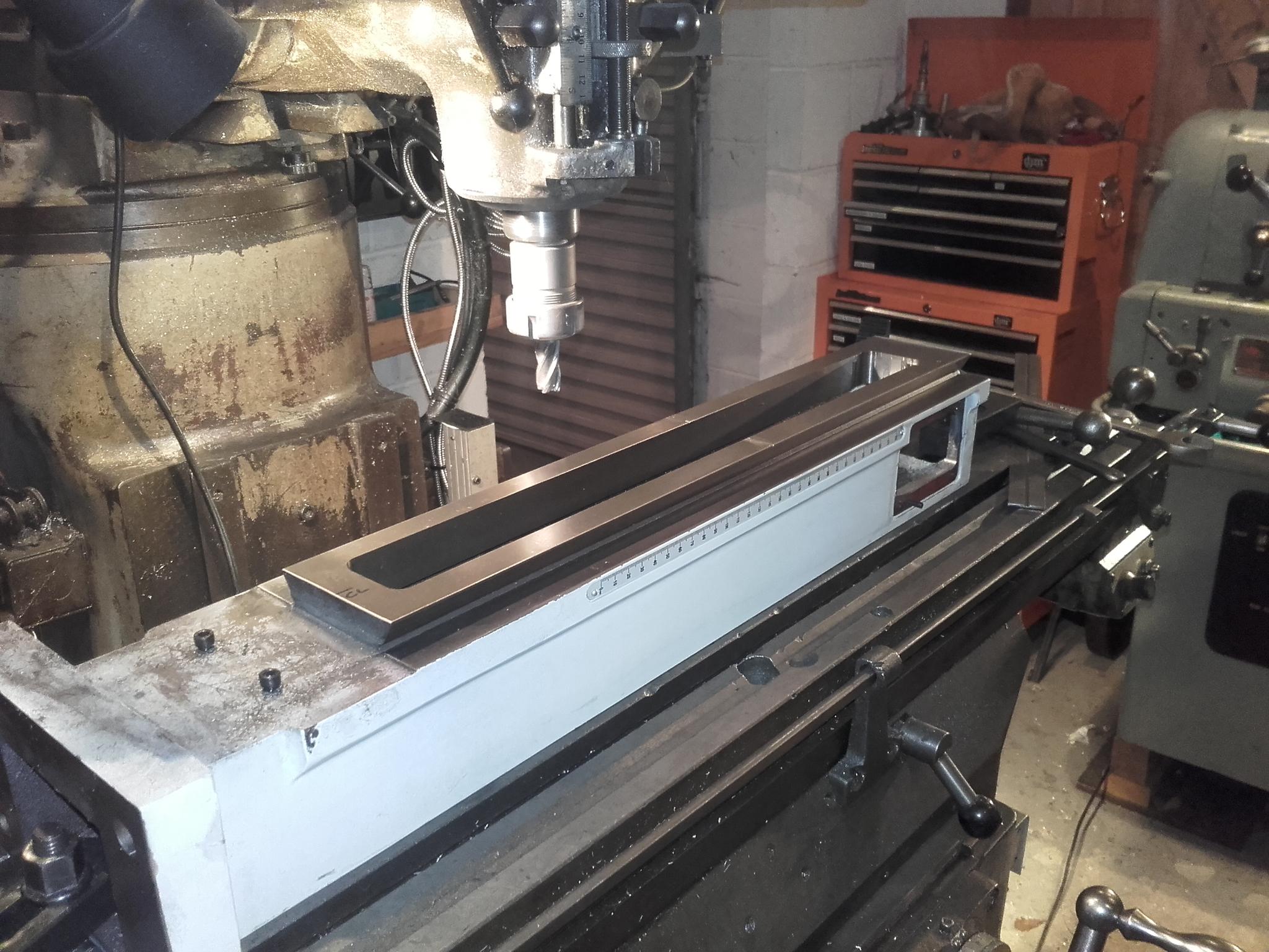

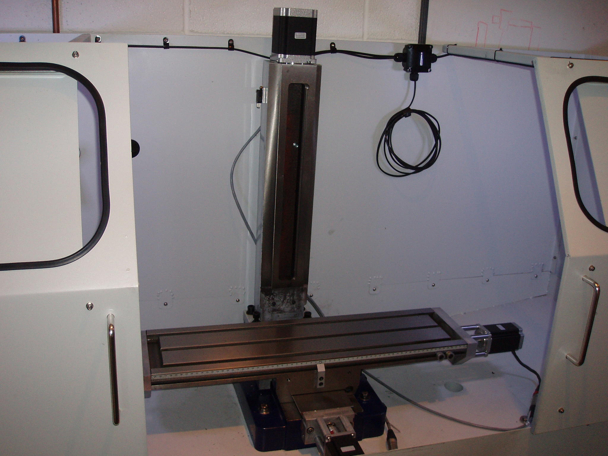

4 Attachment(s)
Bit of an update. Have started building machine back up.
P
Machined the base out to get a bit more Y travel, and generally clean it up. The ways look OK for a Chinese machine but the casting is the typical Chinese effort, bit wibbly wobbly! Had to do some slightly clearancing to the underside of the table where the casting was very uneven to make room for the ballnut mounting. Both axis are now running nicely under Mach3.
P
Column also needing machining to straighten up the slot for the ballnut mount which was a little cocked over. That's back in place. Next job is the Z axis motor mounts and ballnut mount and should be somewhere near ready to try some cuts.
P
Was going to upgrade the spindle to 5k rpm but I'll need to make some fresh motor mounts for that so might as well get the machine running and use it to make them as a test.
Attachment 20780Attachment 20781Attachment 20782Attachment 20783
Aaaarrrrrggggg.
You have made a fantastic job of the enclose and the rest of the machine and then mount the steppers on 4 pillars ?????????????????????????????????????
It's a CNC machine tool not a fooking clock !!!!!!!!!!!!!!!!!!!!!!!
Still one of your pet hates then John? :0)
Nice job on the mill and enclosure.
I take it you don't like my spindly legs then?! Lol.
Have to agree they aren't the most manly looking of things, although in my defence as a newb I'm simply copying what ive seen elsewhere. They do seem solid.
I'll be hiding them with motor covers soon and we shall be rid of the sight of the abominations for ever! :shame:

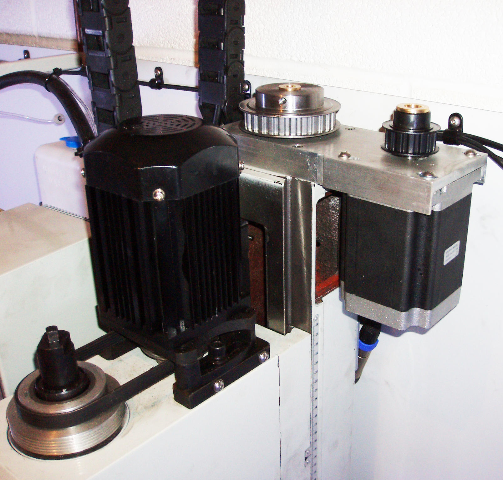

3 Attachment(s)
Well, its about ready to go. I've taken the advice and setup the Z Axis with a 2:1 belt drive (very annoyingly I ordered the wrong belt length so just waiting now for the right one to come). Most of the rest of it is complete so once the belt is here its time to take a few trial cuts and see where it is. Y Axis NEMA23 with spindly legs is now mercifully covered up, cover plate for the X Axis next. Hopefully starting to cut some trial parts this weekend.
/p
Appreciate all the advice so far :thumsup:

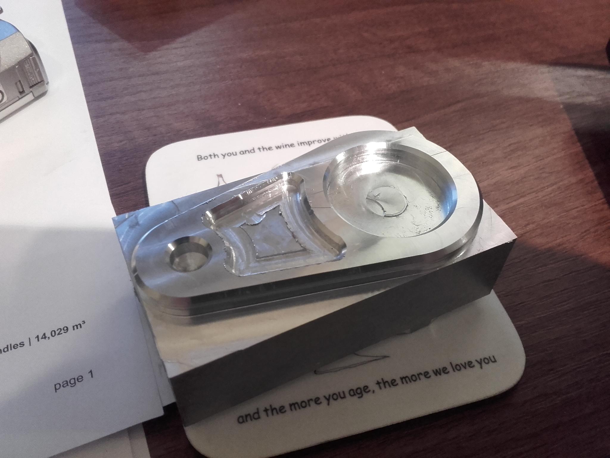

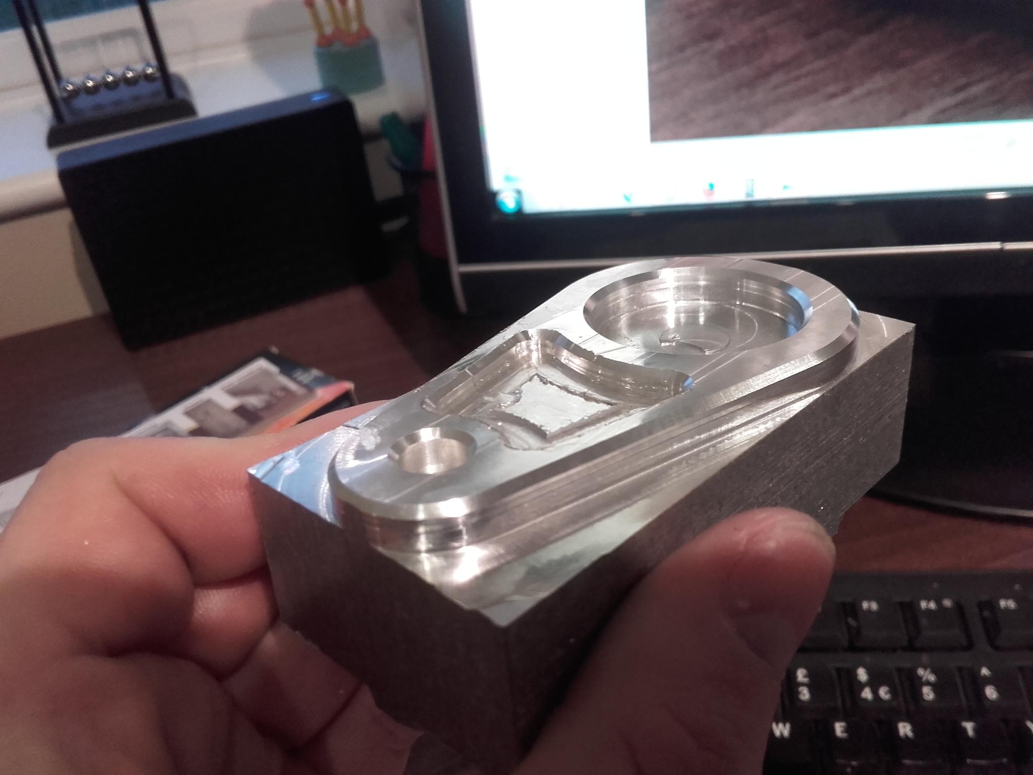

Well chaps, she runs like a good un! Many thanks for the advice. The Z NEMA34 motor didn't work with 48V and direct drive as you suspected, was losing steps. Switched it out to a 2:1 belt drive and all sorted.
P
Got Mach3 licenced today and ran a quick test part. Few screw ups here and there, didn't get the CAM quite right (Fusion 360) so the pocket bottoms didn't clean up, and like an idiot I managed to run the spindle in reverse for the first part of the chamfer op so that's a bit messy in parts, but that's just me being an idiot and easily fixed next time.
P
The machine itself I'm generally pleased with. It ran the part in around 40 minutes, and with fresh end mills that are a little sharper I'm pretty sure I can be a bit more aggressive if I needed to be. Dimensionally it seems to be cutting to around 0.1 to 0.075mm accuracy which I'm hoping I can improve by tweaking the jam nuts on the ballscrews to take out any backlash etc. What sort of accuracy do you think its practical to get on a small machine like this? 0.1mm would be fine for many of my parts I'll be making, some however I'd need a little better, for example where I'm after a sliding or press fit between two parts. I didn't put a lot of time into this part, it was more to get myself going on the basics so I'm sure with time I can improve.
P
Doubtless I'll have more dumb questions as I get the mill dialled in. For now though I'm planning on getting my tool library setup and sorted out in Fusion and get some parts through to get more comfortable with the CAM in particular. I'm still at the stage with Fusion CAM where I'm not 100% sure what I'm doing, particularly selecting the geometry to get it to do what I'm after but I'm sure it will get easier. Once again, thanks for the advice and encouragement. Much appreciated. :thumsup:
P

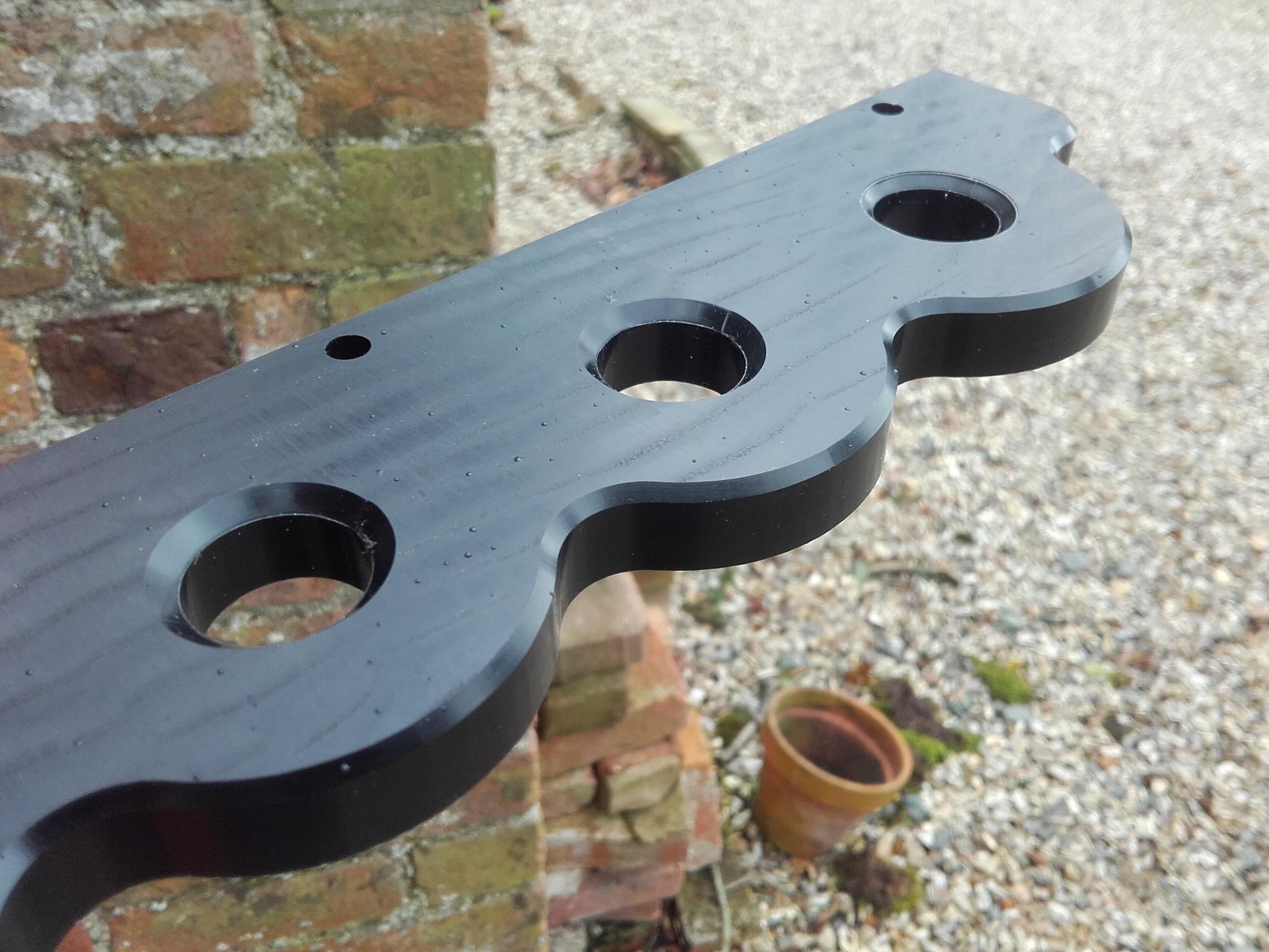

3 Attachment(s)
Slowly getting there.

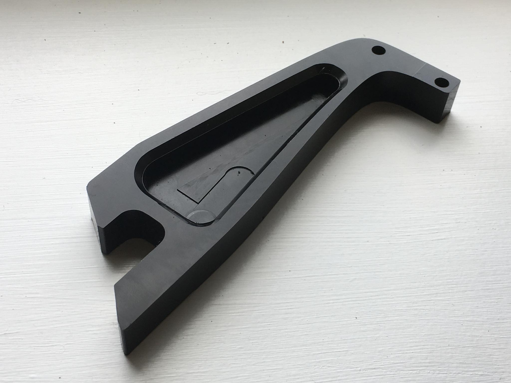

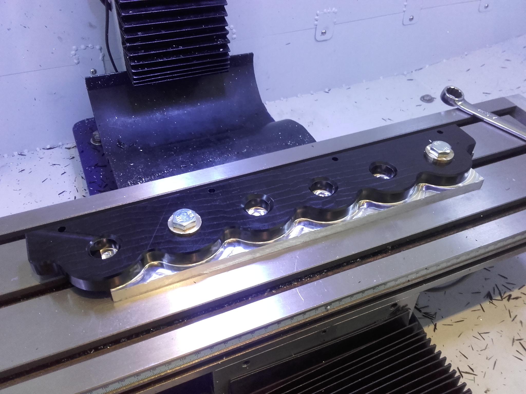

p

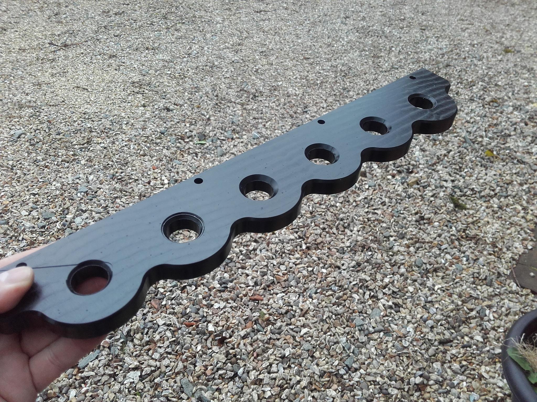

Thought I'd make a tooling holder as a practice project. Haven't quite got the hang of the settings in Fusion 360 for chamfering yet, plus when I had Mach3 in feed hold and was restarting it did a preparatory move and milled a channel right across the piece (under my thumb in first pic) :upset:.

On another note, whizzed up a pair of brackets at the weekend. Am using Fusion 360. When I'm using the 2D pocket function it never seems to clean up the bottom of the pocket properly. Made 2 brackets at the same time from a single piece of Acetal and it did the exact same cut on both. Using the simulate tool in CAM it doesnt show this. I think the pic shows this ok. Am I doing something wrong?!
Attachment 21484
In the pocketing options, have a look at the setting on multiple depths. There is something that says stock to leave on walls and bottom. It usually defaults to 0.1mm or so.
For pockets in soft materials, have a play at adaptive clearing. It is quicker and really good fun :D
Cheers fella, will check that out. I'm doing something wrong for sure! We never stop learning I guess.
The chamfers are also not coming out right, supposed to be just a 0.5mm edge break. I think its because I add a chamfer in the model, and then use chamfer option in the CAM but you end up selecting one of the edges of the 45 degree feature, rather than the now non existent 90 degree corner. That probably makes no sense at all!
it does make sense. I have faced the same issue. To make it work, I usually make a sketch in the model mode and use that as the profile to mill from. Otherwise, select the inner most chamfer edge and set the heights accordingly
