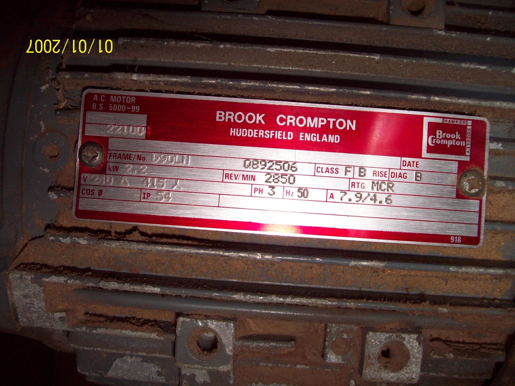

Re: Hi looking to change 3 phase motor for a 240v, any help much appreciated
It's a dual voltage motor so simply wire it Delta (240v on the motor plate) and use a 240v VFD.
Job done ;-)

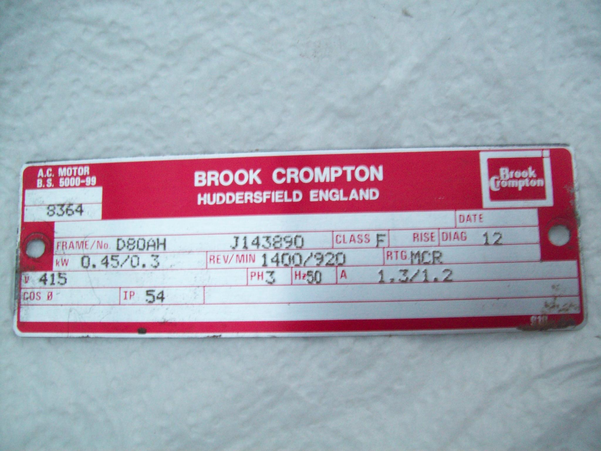

I take it nobody has noticed the dual low speed motor (for the feed?) makes no mention of voltage?
And I'd guess it will be designed for 380V only.
m_c
I just read the motor plate which states Delta 240 Star 415 on the main plate

Yes, you are spot on the motor you refer to is for the feed and I like you bet is it 380V is that a spanner in the works! I thought I was getting off light!

And it's not just a motor, it's a gear motor so no easy swapouts :-(

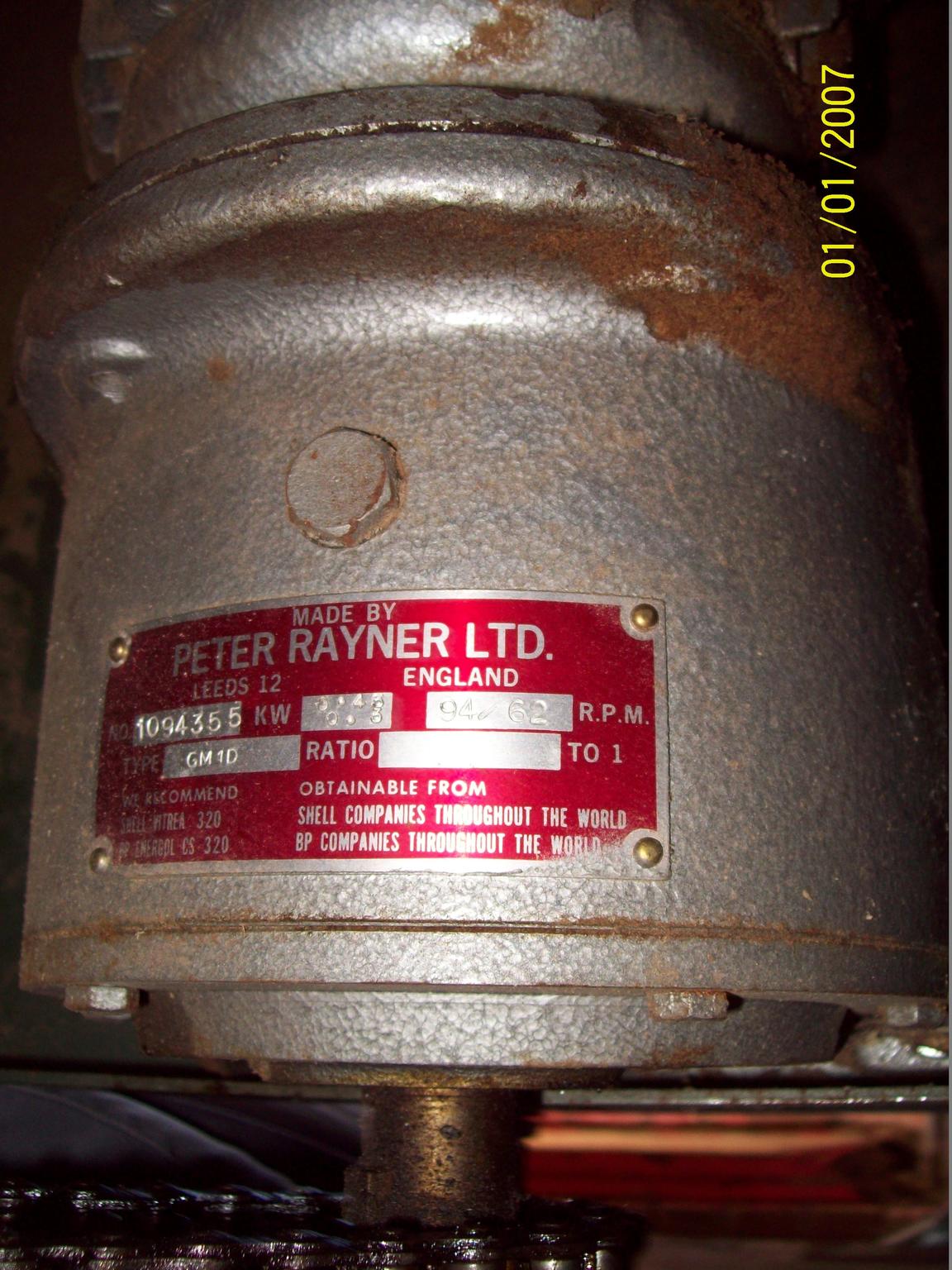

Might be worth having a look under the plate over the connections on geared motor to see if delta/star is possible. While it doesn't say it's dual-voltage, it doesn't appear to say that is single-voltage either. Can you post a pic?

Hi Neale and you guys that have helped and thanks for that. Here after a lot of swearing, poor photos and ripped shirt we have a photo of the plate from the geared motor I had to take it off, it was in a pig of a position!
Attachment 20374
As I suspected, it's a dual speed motor, which are usually only designed for a single voltage.
IIRC it'll have 9 wires in the terminal box, which depending on how they're connected, set the speed.
Don't mistake the number of wires as being a way of changing the voltage like a standard 3 phase motor.
