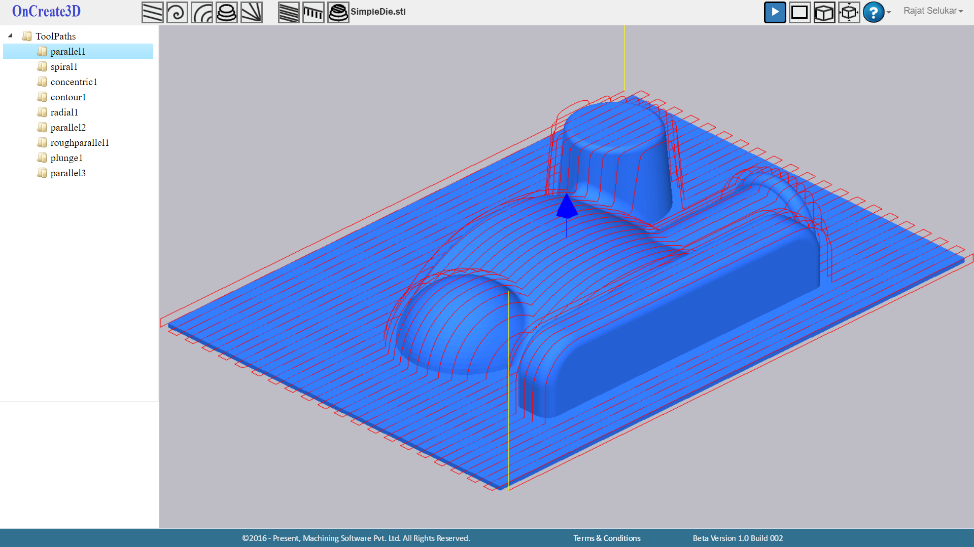

Full Cloud CAM App - OnCreate3D

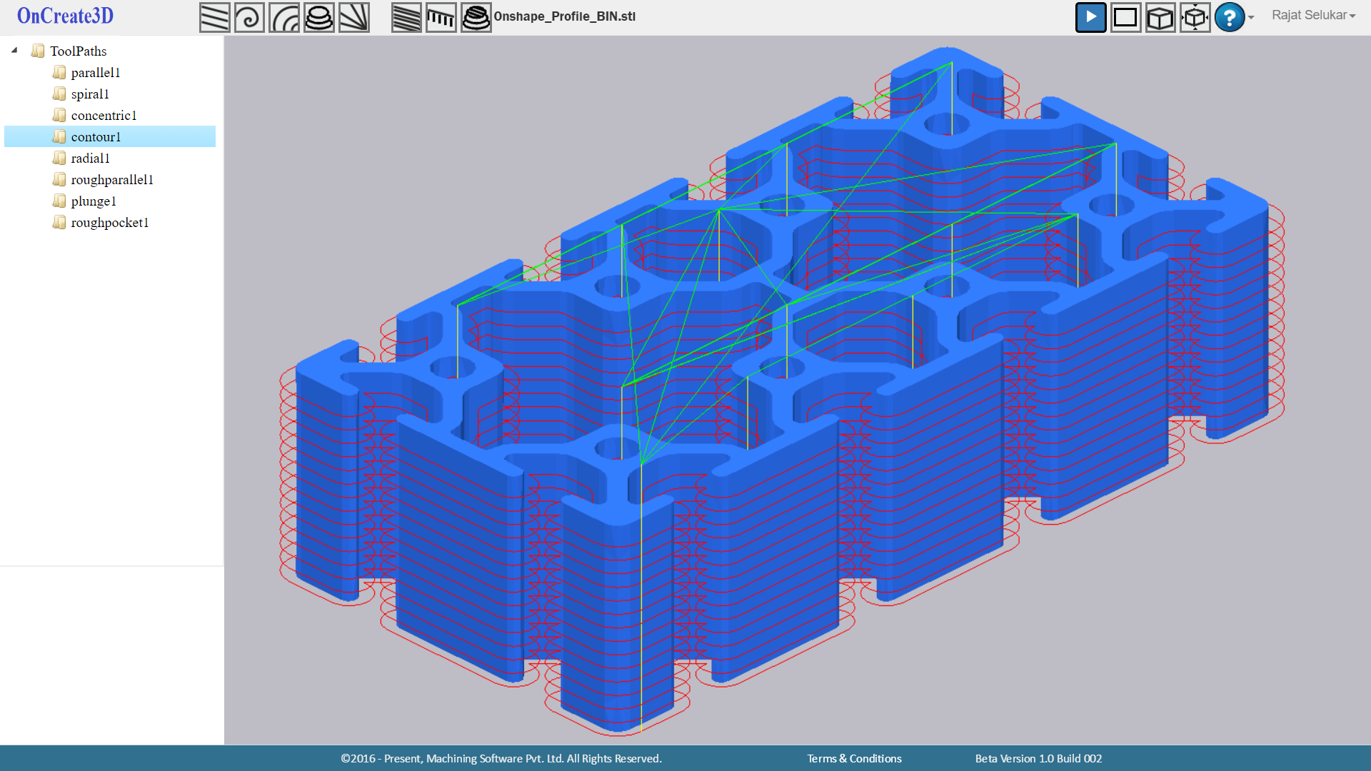

www.OnCreate3D.com is the first full cloud 3D CAM app. It runs in a web browser and on any mobile device. Simply import a CAD File and choose a project type such as Mill, Lathe or SheetMetal. Many file formats such as STL / IGES / STEP are supported.
Create Operations to cut the part. Mill 3D supports Pocket, Contour, Parallel, Radial, Pencil and many more operations. Mill 2D supports Pocket, Contour, Rest Area operations. Lathe supports Turning, Facing, Grooving and many more operations. Mill 2D & Lathe will be introduced soon. You can Simulate the operations to check for gouges, spikes, undercutting etc.
Create NC File for all selected operations by providing basic information about the controller options. That's it. You are ready to take NC File to your controller.
Attachment 20462Attachment 20463

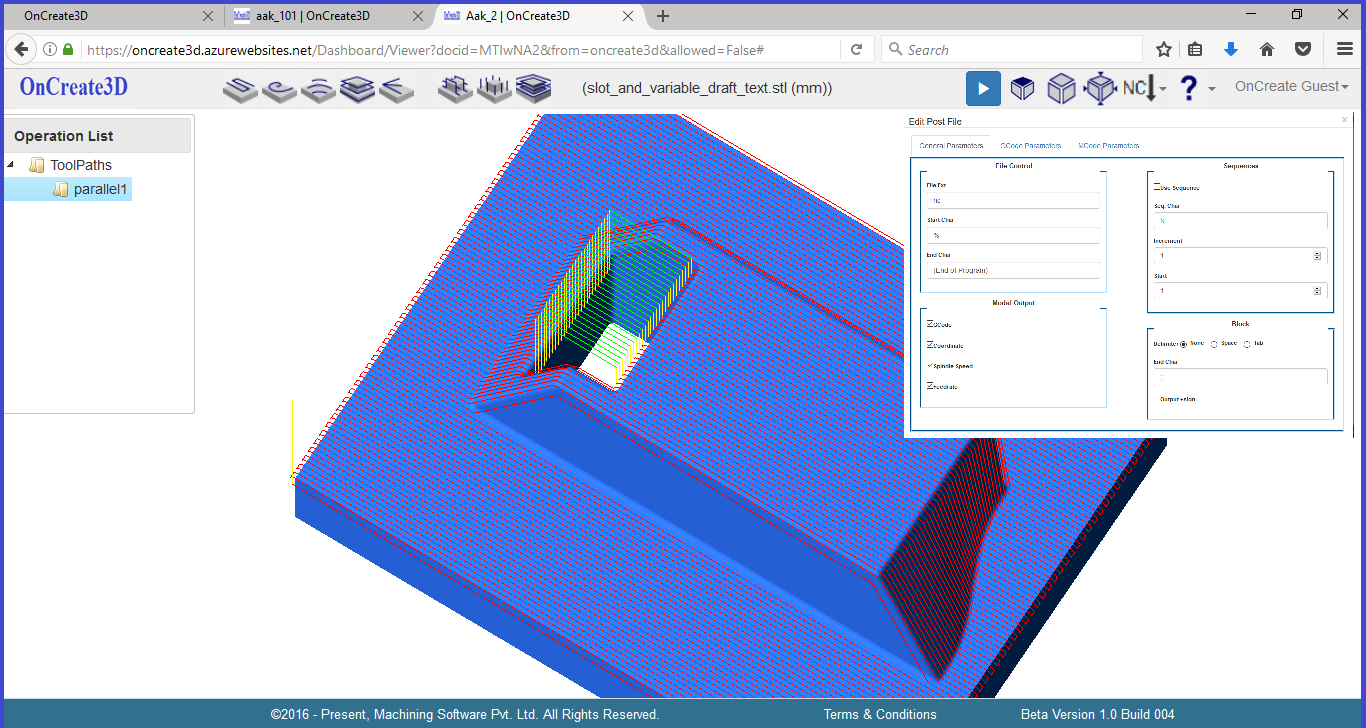

Added few interesting features to recent deployment at OnCreate3D portal

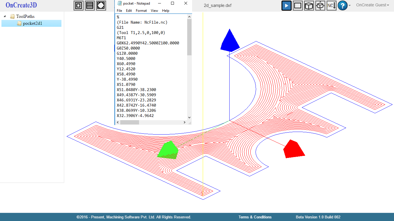

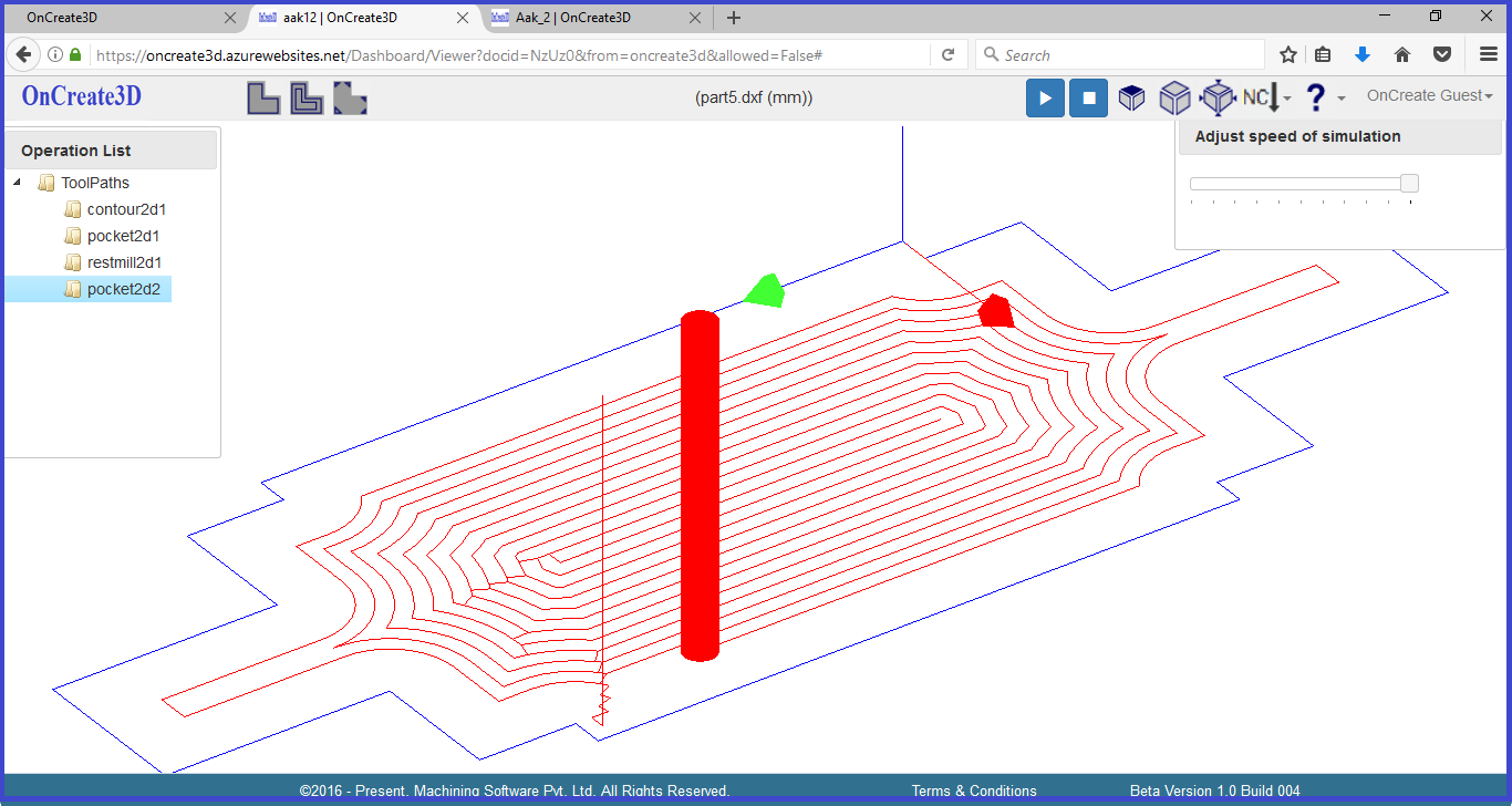

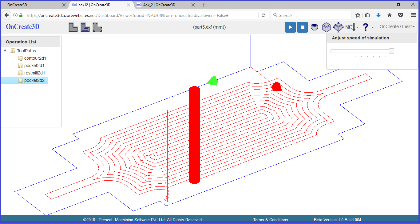

Mill-2D Operations:
OnCreate3D has Mill-2D project type that allows import of DXF file for 2D Contour, 2D Pocket and 2D rest mill toolpaths.
Attachment 20935

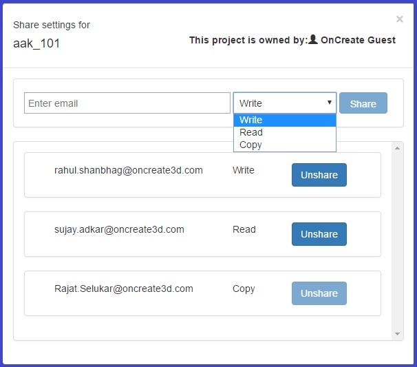

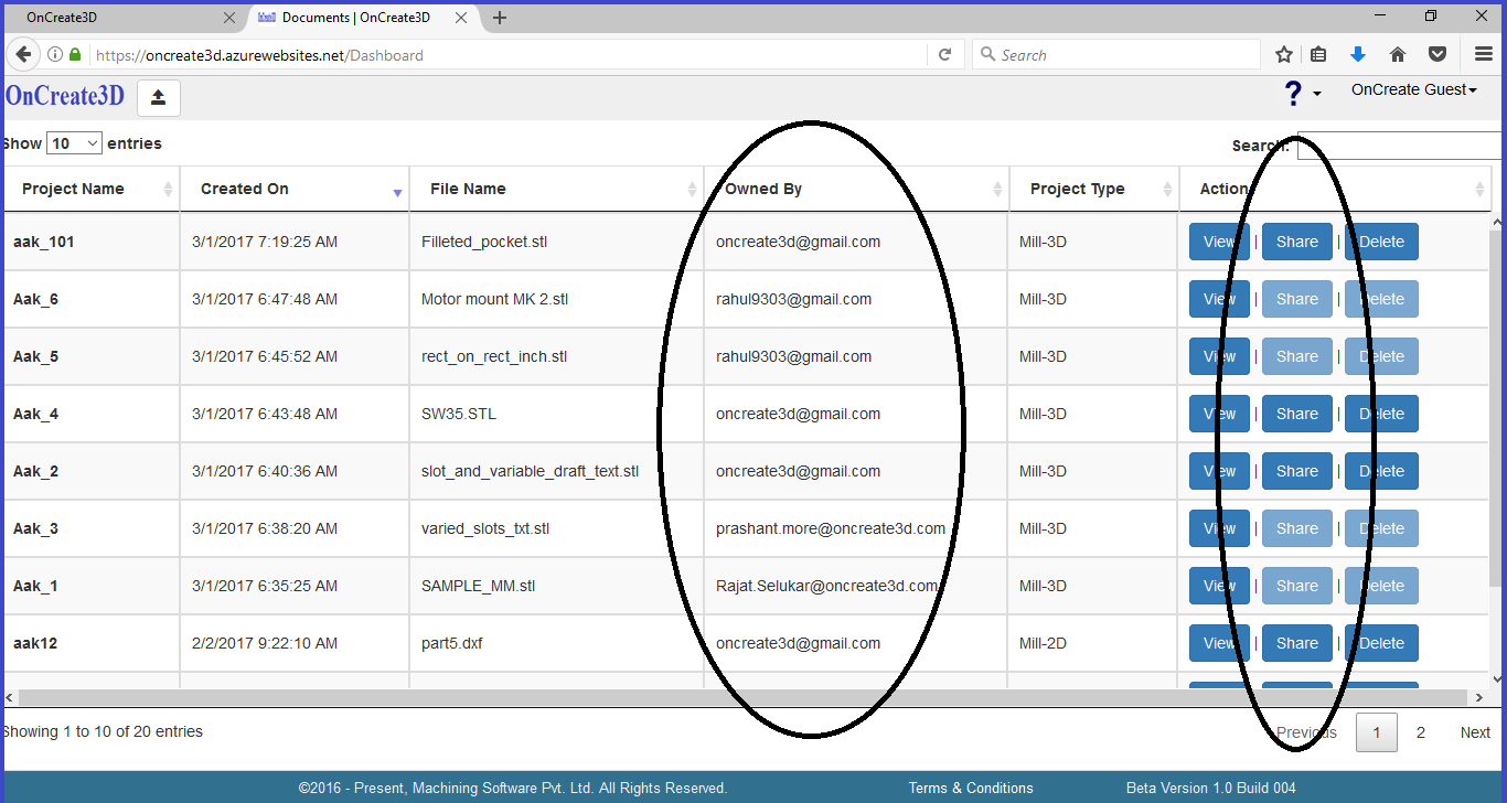

Sharing projects with others:
OnCreate3D, First Full Cloud CAM app, makes life easy for Design Engineers & Machinists, by allowing to share their project(s) with other users (operators, decision makers etc.) Machinist seating at his remote office can create NC Files for CNC Machines in his production facility. He can simply share his project with operator who can download NC File and run the machine. The machine that Machinist programmed for is busy? No problem, operator can configure POST to output new NC File for different CNC Machine. Create toolpath operations only once and use it for different locations, different machines multiple times. Machinist doesn't want operator to change his toolpath operations? Simply give READ permission. Machinist wants to allow operator to edit toolpath parameters to suit machining conditions? Give him WRITE permission.
Attachment 20936

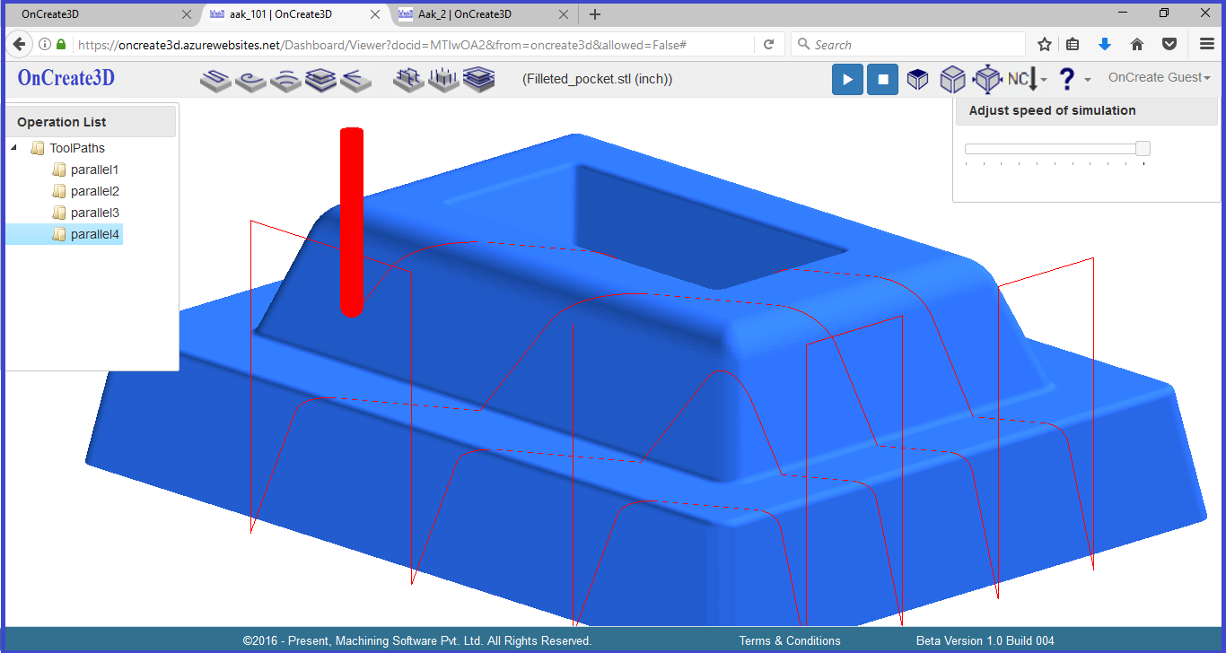

Toolpath simulation:
OnCreate3D has introduced toolpath simulation to visually check for correctness of toolpaths before downloading NC Files. You can play/Pause any time, you can speed up/down anytime. Although it is simple simulation for time being, we are working on showing updated stock after every operation. The feature is coming soon. Stay tuned.
Attachment 20937
Attachment 20938
Customizing POST parameters:
Users can now customize POST parameters and generate correct sequence of commands in NC File.
Attachment 20939

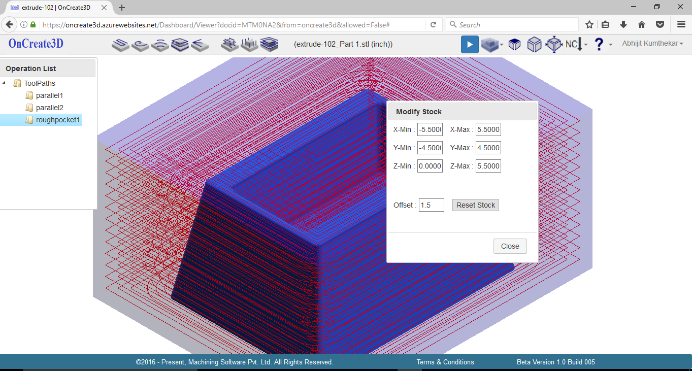

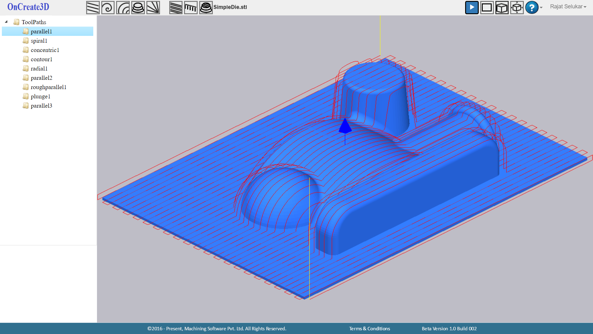

OnCreate3D Introduces Stock definition, display and use in roughing toolpaths.
Latest build of OnCreate3D has introduced stock definition. As the CAD File is uploaded in new project, stock is automatically calculated and shown for the part in CAD File. User can modify or reset the stock, as well as hide/show stock. The stock volume is used for roughing toolpaths namely parallel, plunge and pocket.
Latest build has also introduced STEP import, fast forward and rewind options for simulation, Customized NC out, standard APT output and few other enhancements. Check out latest build at OnCreate3D. Just sign-up for FREE unlimited projects and unlimited NC File downloads until June 30, 2017.
Attachment 21331

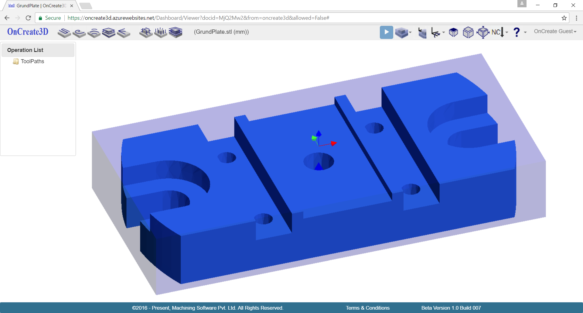

April Deployment of OnCreate3D, First Full Cloud CAM App, (www.OnCreate3D.com) added Stock definition, editing and using the Stock for roughing toolpath operations. May 01, deployment has added many interesting features that will make OnCreate3D more user friendly. First important one is the part orientation followed by WCS definition. CAD modelers may have different default orientation that may not match orientation for machining in OnCreate3D. Users can now rotate imported CAD geometry around X, Y or Z axis to orient part properly within OnCreate3D. User can also define WCS with respect to part bounding box.
Attachment 21492

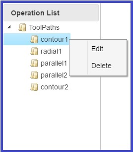

Second important feature is the facility to Edit existing toolpath operation. Users can right click on toolpath operation in tree view to edit the already create toolpath. When user changes some parameters in toolpath dialog box and clicks OK, the toolpath is re-created and displayed to user again.
Attachment 21493
Third important feature is to share project along with toolpath operations and NC File to other users already registered with OnCreate3D. When you have spent considerable time creating toolpaths that will machine a part correctly, you can simply share your project with other users, so they save valuable time. A machinist can create toolpath operations in his office and then shares project with operator or manager at shop floor. operator just downloads NC File and start cutting the job. User can give Read, write or copy permissions to other users.
Attachment 21494
