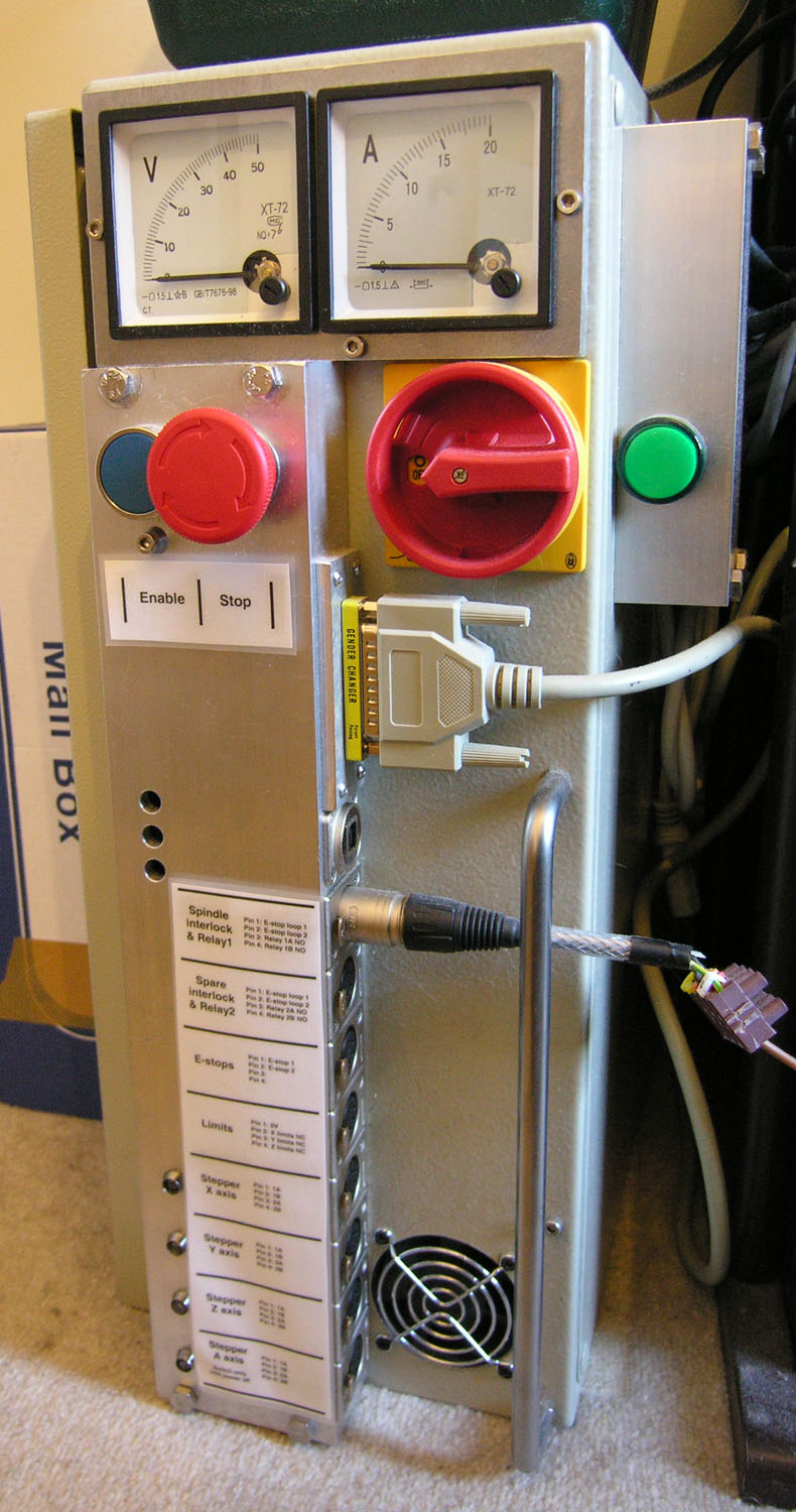

Power supply will be three 350W computer power supplies (free from a mate) in series for 36V, 20ish A :-). More than required most likely... but price is right. Will build in some nice analogue panel meters to show output.
All of the electrical connections (steppers, limits, e-stop, spindle) will be plug-in via XLR or similar plugs so once unplugged, the control box and computer can just sit under the bench too. Have yet to decide on controller software and CAD/CAM options.
