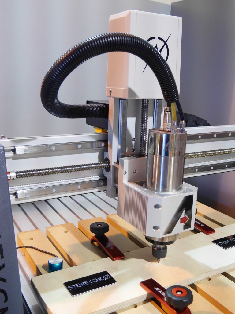

The design flaws are with the Linked machine you showed. Single rail on gantry, Weakly supported gantry, too tall and narrow Z axis, Lack of support on bed frame. These are the main ones which are not little issues and define the machines abilty's.
The other's I won't get into too deep because as caused me troubles in the past but what I will say to you and others "Boyan" need to Look beyond the gloss and the covers then you'll see design issues that shouldn't be there in machine costing this much money.!! . . . . To highlight my point those with experience look at this pic and tell me whats less than ideal.?
Attachment 20994
On the panel cutting front then it wouldn't be big deal to design Z axis in such way that Saw could be fixed along side spindle so have the best of both worlds.!! .. . . . . . It's all possible with bit of thought and common sense.

Oooh a where's Wally competition?
I think Wally may have run off with the rest of the Z axis plate for the motor mount and the other set of bearing blocks that should be on it...
Re: Production grade CNC router Vs Homebuilt CNC router advice
Washout
That's one but there's another thing missing.?
OOoooooo is that the ballscrew connected to a lovejoy coupler (and therefore directly to a stepper) with no AC bearings I see before me??!!
njhussey
We have Winner..:yahoo: (shared with Washout)
There actually is Fixed bearing at other end but still it's not good design and shouldn't be like that on machine costing that much money. These machines use smoke and mirrors and people need to start looking deeper to see the real truth.!
