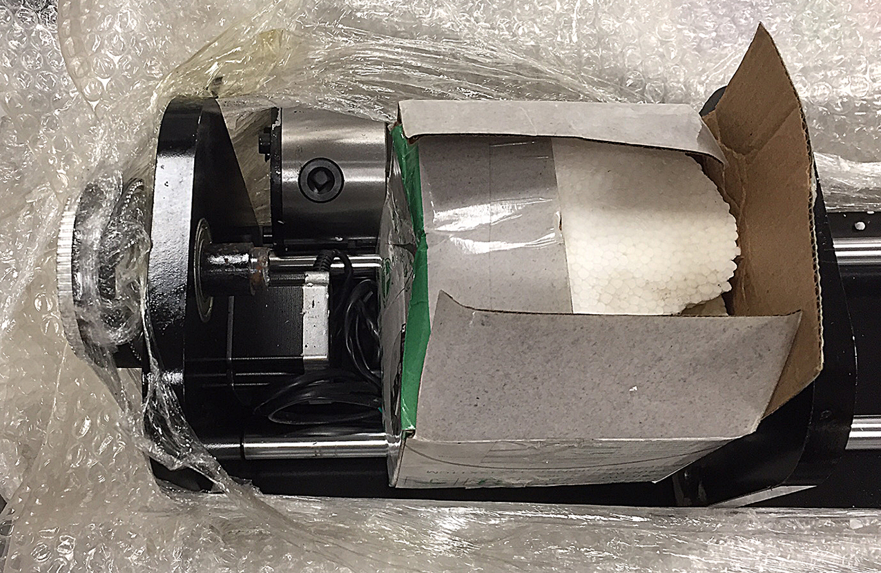

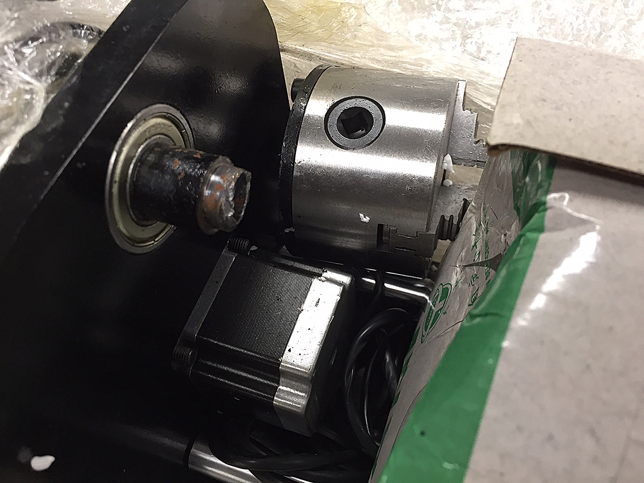

The rotary attachment arrived today - totally wrecked as the chuck had broken the shaft that mounts it and was loose in the box, unusable and a complete waste - the box that should have held the chuck was in there so why was it fitted??
My thoughts were previous customer return item.
emailed supplier with a photo.

I did see another one of the type you have on a forum somewhere, where the spindle had pulled out of the upright because the bearing was a loose fit but it looked an easy fix if you could get redress off the seller.
Re: Ready to push the button and buy a laser....
This would be an easy fix - re-weld the plate and true up on the lathe but that's not the point :)
See what they say in the morning.
3 Attachment(s)

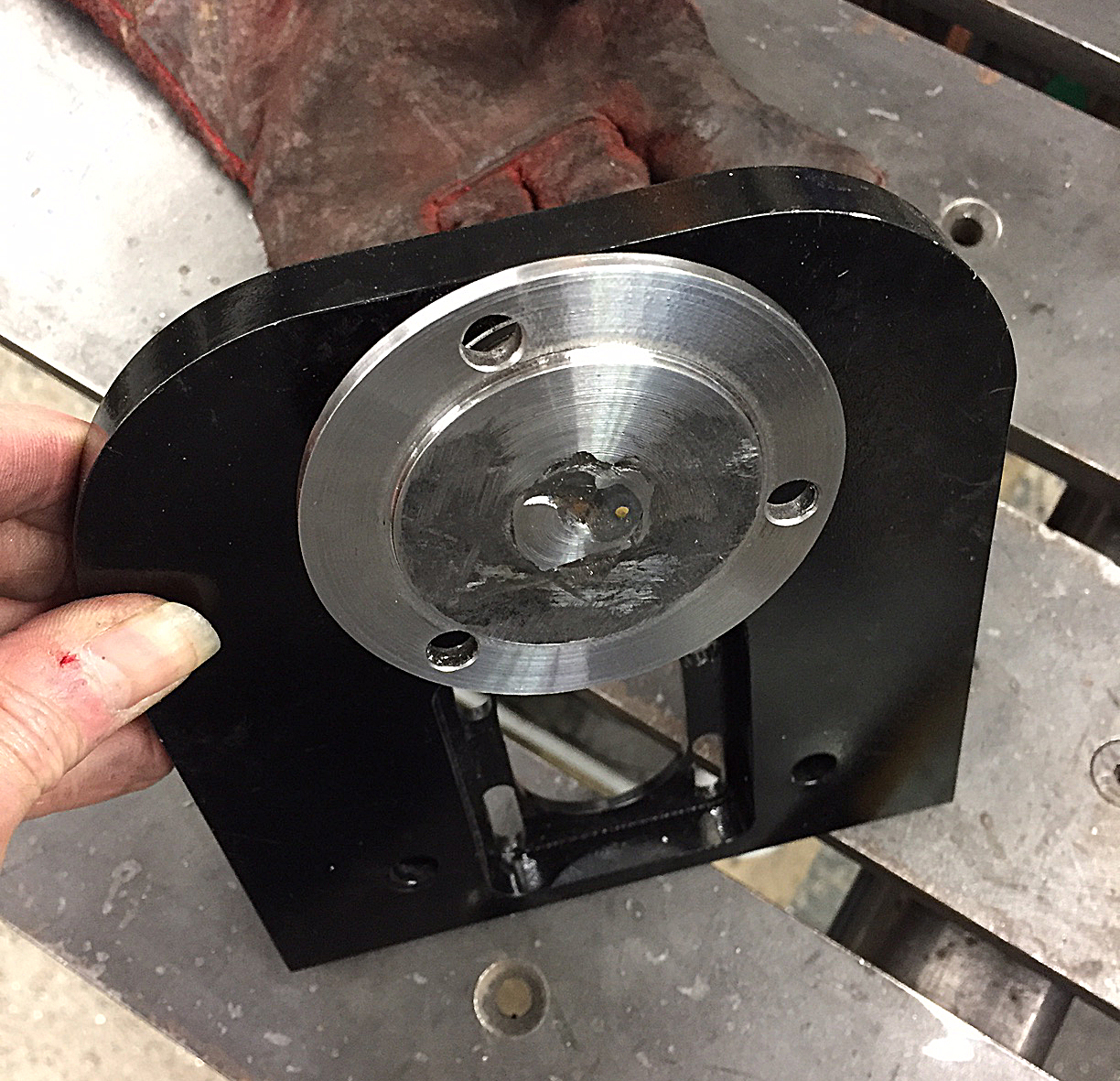

Broken weld, if you call it a weld...
Attachment 21108
Put the chuck box in though, thats a nice touch...
Attachment 21109

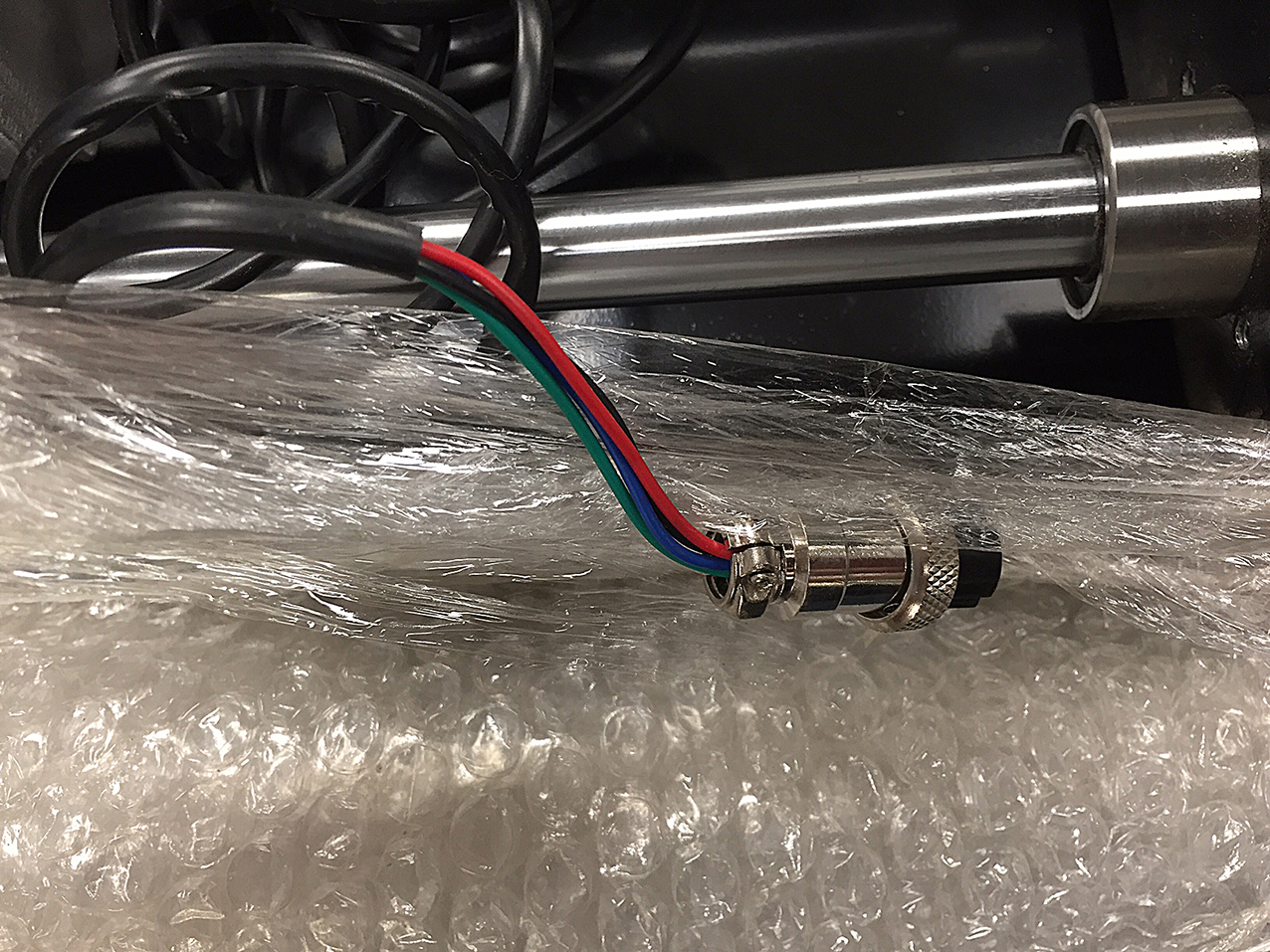

Nice wiring....
Attachment 21110
JS probably saw my post here on Madmodder - see reply #23
http://madmodder.net/index.php/topic...html#msg126523
Oh, and my cable outer also was stripped too far back to use the clamps like yours, but I found that by friction warming the outer by gripping with a cloth and sliding it, I could ease the outer far enough down the wires to get under the clamps (which are too large a diameter to grip, but a bit of the serrated end of a tywrap makes up the gap sufficiently !

More like it...
Attachment 21117
Ground the bird-sh1t off, turned a bevel on the stub so there was somewhere for the weld to fill, nice heavy fillet, turned the flange true to the shaft, refitted it.
Also drilled a couple of divots for the pulley screws to locate into.
I'll also replace the crap allen screws which appear to be M6 but have a socket that fits nothing with some proper M6 ones !

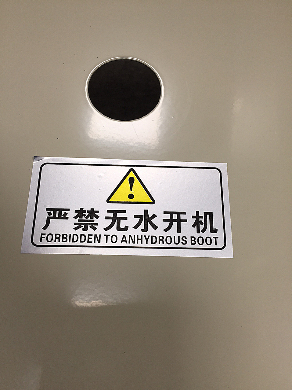

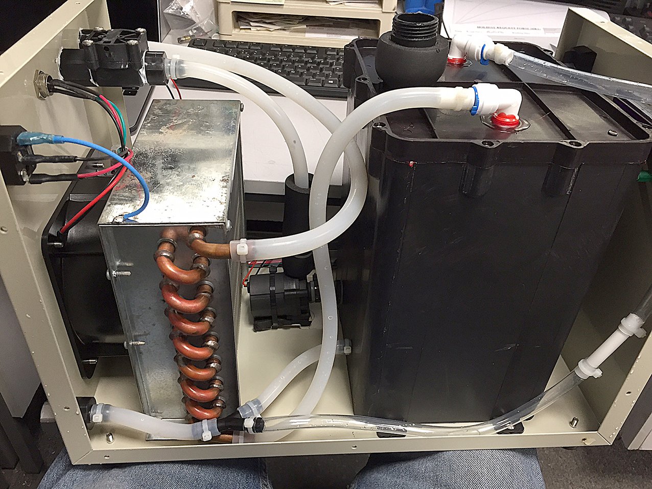

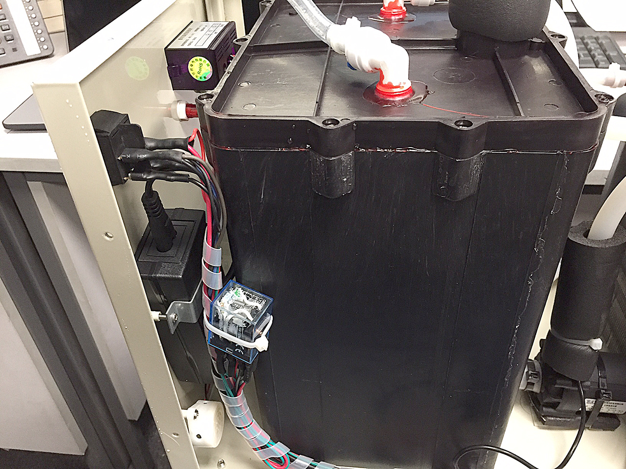

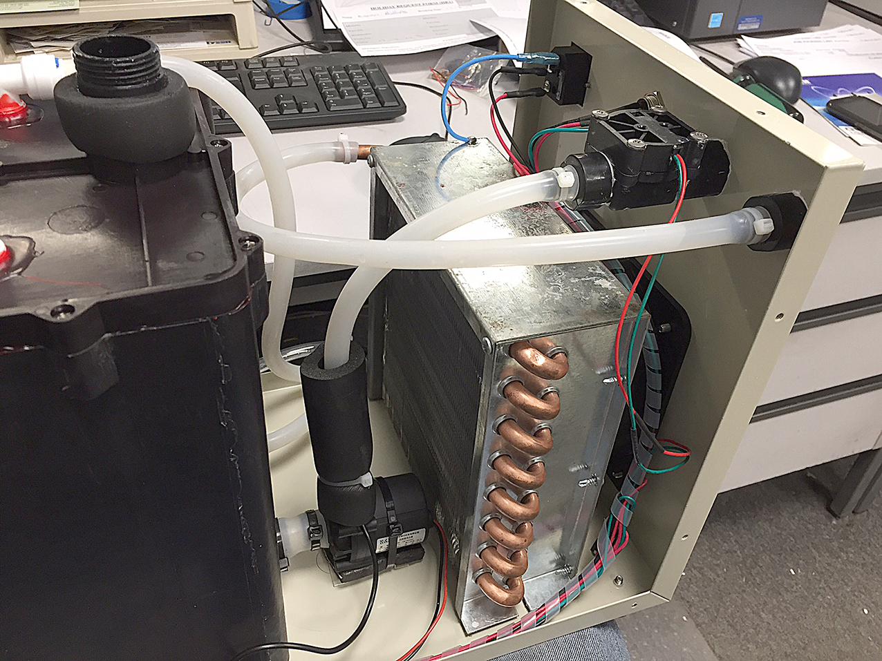

Chiller arrived today, not really a chiller more an active radiator but far better than a pump in a bucket:)
I was pleasantly surprised with this bit of far eastern engineering for a change...
Attachment 21141
Attachment 21142
Attachment 21143
Nice, tidy wiring, earth connected to chassis, no more bare pipe matrix - now we have a nice finned radiator unit, wall-wart psu - nothing wrong with that, flow switch and audible alarm function nicely if you squeeze the pipe shut, thermometer reads ok, even has a liquid level display on the front.
I might even get another for the 2kw spindle on my mini-mill.
This put a grin on my face...
Attachment 21144
"Forbidden to anhydrous boot" - I guess it's a long way of saying "Do not run dry" :)

Don't forget - its not an active chiller - just a pump and radiator :)
The CW5000 model is active but costs more of course

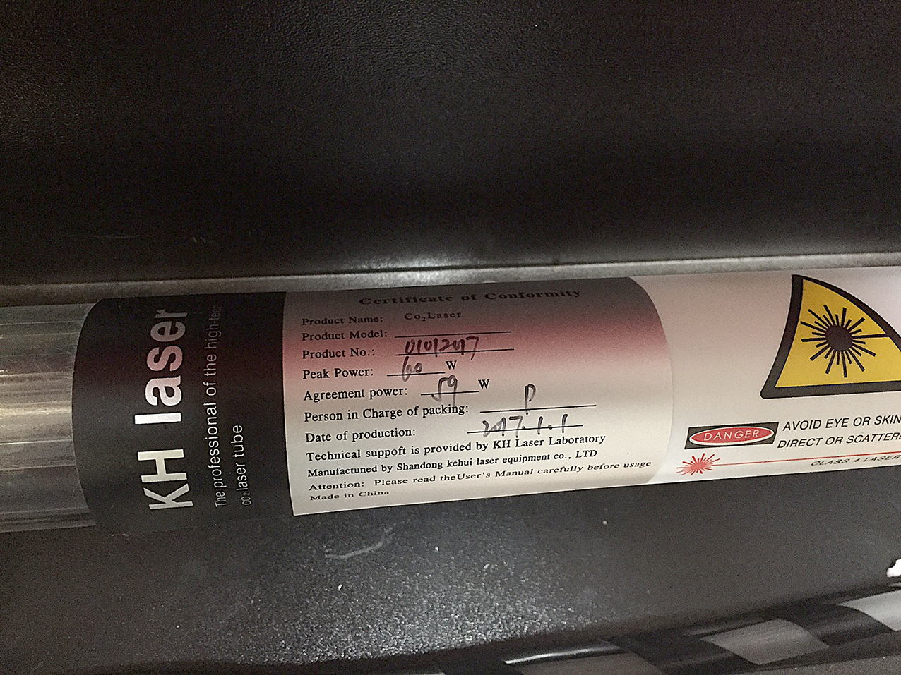

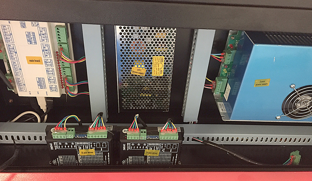

It's here :)
Uncrated, no signs of severe damage, the only two things i have spotted so far are the table up/down buttons smashed and the safety switch on the table cover broken.
The tube as suspected is NOT the 60W one i ordered but a 50W overdriven. It's only 1000mm long and a 60W should be 1150mm approx.
Attachment 21178
The wiring seems well done...
Attachment 21179
I can't see any loose wires or trapped ones etc, the safety reset button was loose, I have wound the head back/fwd by hand and it seems easy to move to so no jams there. Couple of scuffs on the paint but not worth worrying about.
The universal sockets on the back will be coming off and replaced with IEC ones.
Now to get a claim in with the supplier for the wrong tube etc......

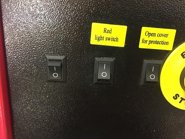

Beware - there was a little rocker switch on mine that over rode the cover safety interlock switch - it got disconnected very quickly - I'd like to keep the one eye that I have left !
Obscurely labelled 'Open Cover for Protection' what it actually does is remove the protection of the cover safety switch !

Yeah i have that one too, i am ok with safety, got goggles etc.
