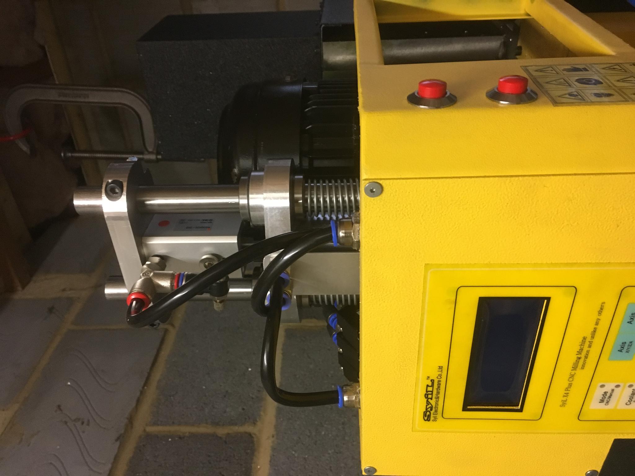

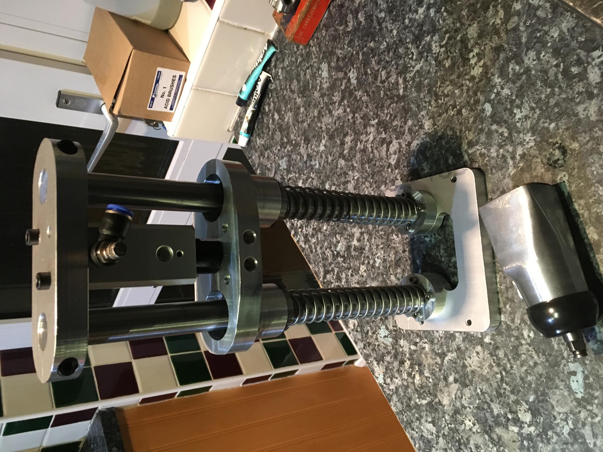

A syil power drawbar. Couldn't find a suitable one given the space. Thought you might be interested in how this turned out. Works really well.
Shout if you want access to the CAD files.

Sure, Here you go...
Attachment 21153
& Video
https://youtu.be/1Z9hIX_w8FU

I am :playful:
- Standard old butterfly. You have space & might want to beef up the air piston from the small one I have.
- Find a 12 point socket for the drawbar.
- Air plumbing (in my case) used 3 air solenoids.
- The long strip in the design suits a limit switch to start the wrench.
- Cut an internal relief for the piston clamp
- Source a couple of linear bearings for the wrench plate travel
- The bars were silver steel (what I had in stock at the time), they're holding up fine.
https://a360.co/2J9wMhg
Hope this helps.
