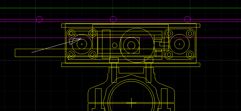

Attachment 21177
If you can't do it, you can't do it. Picture shows it is possible. The white arrow points to a 1mm clearance between the X axis linear rail in purple and the 8mm linear Z axis shaft in yellow :topsy_turvy:

However, am i right in thinking that's only possible when using unsupported round rails on z?
I think I'm probably interpreting your drawing wrong, as there's a lot of stuff there and I'm not sure how it all fits together in 3d, do you have a side on view?

What you could do is slip pairs of linear blocks on to two pairs of linear rails, lay two rails on top of 2 rails at right angles then slide the blocks around a bit and see where the metal of the Y and Z slides can fit in around it.
Does that make sense? :beer:
