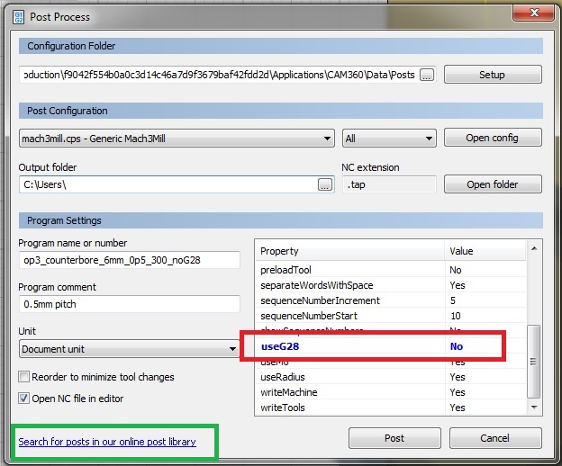

how do you go about changing it or turning it of?
Re: F360 - returns to machine zero not work offset
Hi Charlie,
When you post process the toolpath you get this menu:
Attachment 21203
(red box)
Select G28 - no
I've also looked into searching the post processor library (green box) and there is another Mach3 PP in there which mentions various features including G28. I'll look into that.

Forgot to say thanks Graeme. As you can see from the above switching off G28 could be an option for me.
Clive, Neale,
Thanks for your thoughts on it. I thought about editing the code in notepad with find replace (G28 > G0) and am sure that would work, but bit of a pain to do it every time.
I will try and look into the F360 online site of post processors as this mentions a Mach 3 version with various features including something about G28 usage. . . With a bit of luck it will create G0 instead of G28
