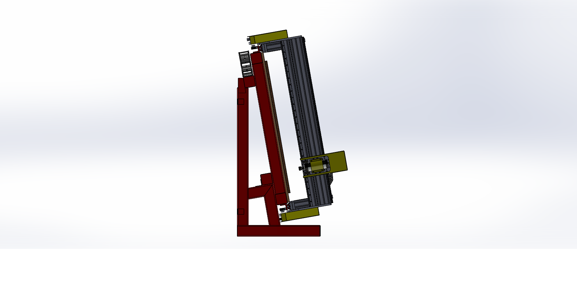

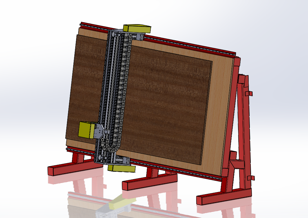

3 Attachment(s)
Re: Router Build number 2
charlieuk
How over built are we talking? the ability to take a full sheet of ply is worth something. If it wasn't the space restrictions I have I would be building a 8x4 machine in which case I guess I would be building the stronger gantry anyway.
Charlie You said cutting Aluminium to high surface finish, ply is different thing altogether. Your first design will quite happily cut ply but aluminium is different matter. The Stiffness required goes up quite lot and to have high quality surface finish it goes to another level. Anything you can do to lessen resonance will help with surface finish so long hollow flexi beams are best avoided.
This means using thick walled heavily braced and stiffened design which opens up complete new set of issues regards ballscrews,servo, controllers etc which get expensive quickly.
If your spaced limited look at building vertical. You'll get 8x4 in the same space as your First machine. Something along the longs lines of this which I'm building at minute thou for high end aluminium I'd change the design slightly and do away with gantry sides.
Attachment 21269Attachment 21270
I had wondered about vertical but it wont help much as I don't have much wall space spare to push up against, certainly for 8x4. I guess I will ether have to go for less quality on the aluminium or for go the ability for full sheets.

When you are in front of the machine X is left right, Y and A are the long axis. Its called "the right hand rule"
Attachment 21617
So on your question, i will always prefer 2 motors each belt driving via reduction or not the separate ball screws, versus 1 motor belt driving both ball screws at once. While second is a fool proof way to do it, its more difficult to set up, dust protection will be needed for the belt, motor and drive have to be more carefully matched to the machine. Plus tension to the belt must be right to function properly and there is more possibility for misalignment. In other words i choose the simpler way to do things. So at the end of the day= there is no better way. its all the same if done right. The result i mean.
PS. Also comes to my mind that the one motor design could not be 100% suitable for very fast and heavy machines say 20-30 meters per minute and serious acceleration. Not that there are such in the majority of the DIY builds. Its one thing to put much pressure on 300 mm belt and another on 3 meter belt
