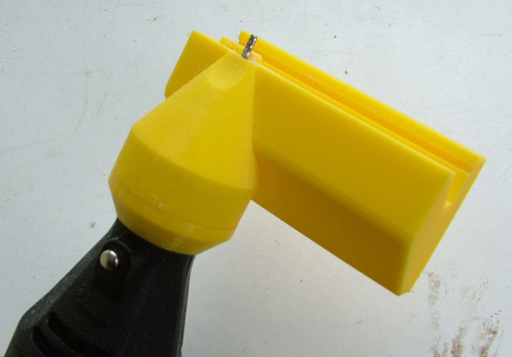

I have 1400 faulty circuit boards that need a very precise trim to put them right. It was so easy to make a Dremel attachment and regain control of a tricky situation. The M19 thread for the Dremel nose had to go on a separate piece to get the grain right. Print time around 4 hours...
Attachment 21496

Attachment 21504
The only way to tell is by extreme close up. This is 0.2mm layers of ABS Plus on a printer that has the folded steel frame and profile rails.
Show is what you've got :beer:

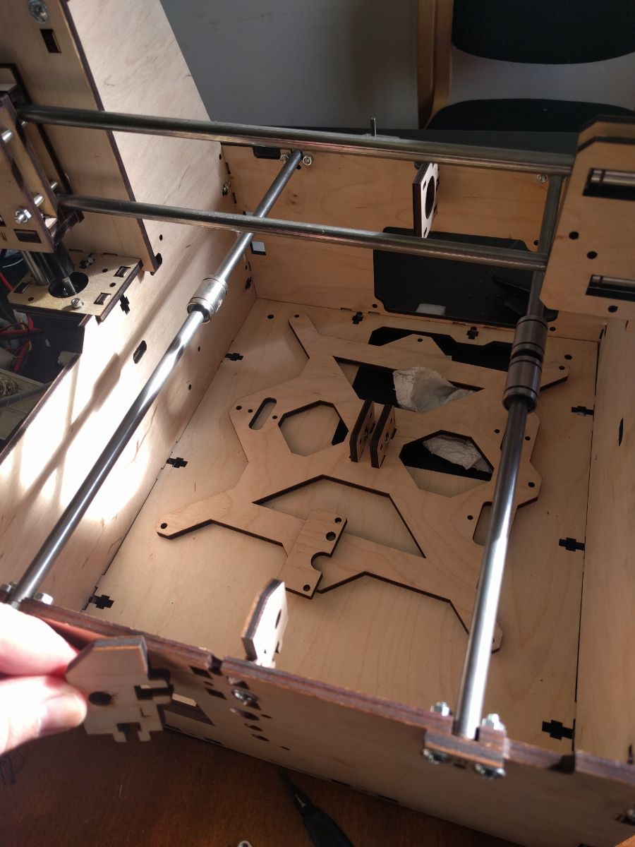

I finally got my Graber I3 frame from Ukraine took about a month to arrive. I'm going to beef it up with metal corner brackets and modify it to take 8mm lead screws for the z axis instead of 5mm threaded bar.
Attachment 21535
Anyone with access to a cnc could easily make their own Prusa style frame from ply, mdf or aluminium.
I am upgrading a reprap mendal, will have to cut 4 of the smooth rods to fit. Not looking forward to cutting the stainless steel z axis rods.
I need to get an lcd for my ramps at some point but the cnc build is killing me financially so it can wait it's no hassle to print from my laptop.
One thing if using windows you have to make sure automatic updates are off, power saving and anything that might put the pc to sleep or reboot it must be disabled. In Linux this is not so much an issue but you can configure a windows pc fine. I use a windows pc for timelapse that's been on for months with no issues.
I'm going to plug the printer into a 1kw UPS (Just because I have one spare) so will have a little extra protection but not essential.

Got my frame last week so yesterday I started to strip down my mendel and rebuild in the plywood frame. Immediately there were issues lol but nothing too severe got about 1/2 done.
Issues were
1. No build manual, so we built using their photo as a reference, only after we mostly built it up did we discover their reference photo is incorrect lol (Or they reversed a part in laser cutting) the power supply would be on the outside of the frame lol the way they show it built.
This is the picture they supply
Attachment 21639
And this is the correct way (See how the power supply mount is orientated)
Attachment 21640
If I tried to fit it the way they picture the power supply is mounts are in the wrong place and the power supply would be on the outside.
had to flip both the back plate and bottom 180°
2. It's built for 5mm threaded bar for the z axis. I'm using 8mm lead screws needs some modification for it to fit.
3. My extruder needs modifying to fit with the inductive sensor
4. Someone borrowed my soldering iron last week and I forgot to get it back will do today, this is needed so I can wire up my mk3 bed so the inductive sensor will work.
I have 2 inductive sensors one works at 5v but the one that is 12v only has a better range that can detect the aluminium plate through a mirror for autolevelling. Although the plan is to minimise autolevelling by probing the bed then adjusting until as flat as possible in the first place.
I already know the mods I want to make when I get my cnc machine working.
I figure I don't need anti back lash nuts on the z axis as gravity will do the same job but we shall see it will be easy enough to retrofit.
