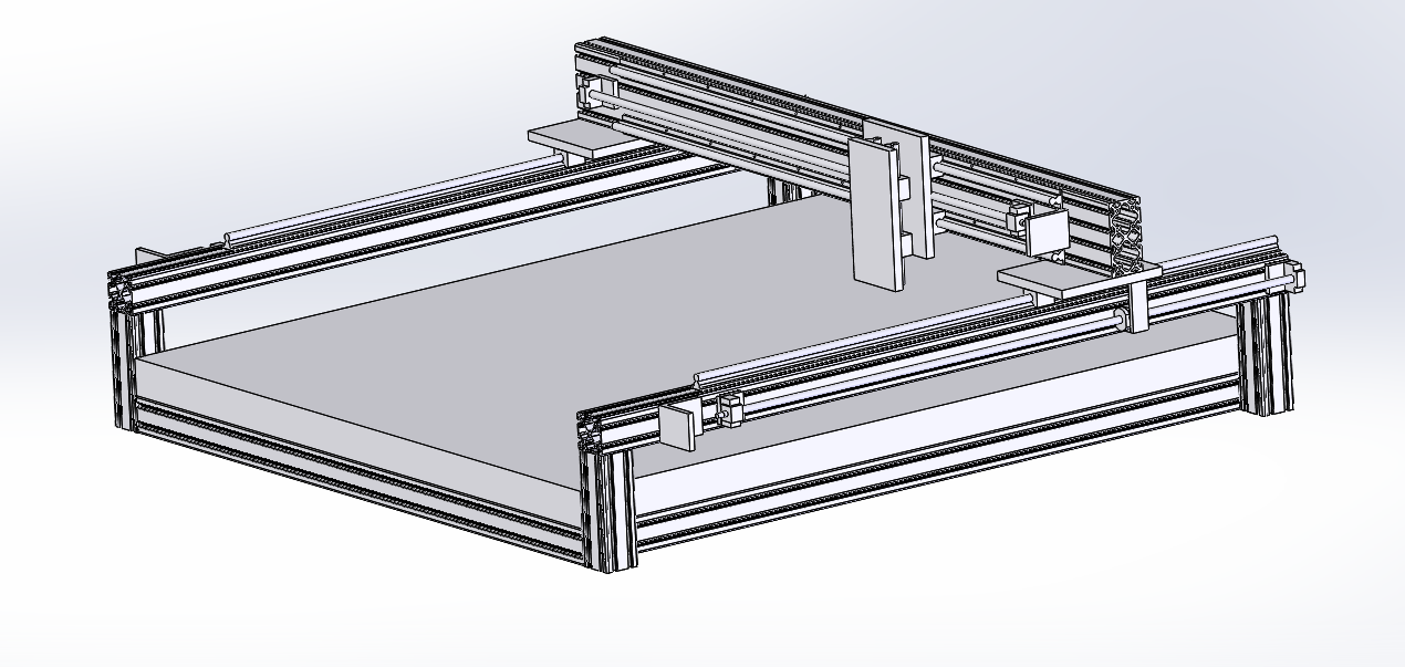

Hello All,
Been lurking on here for a while and picked up so much useful information.

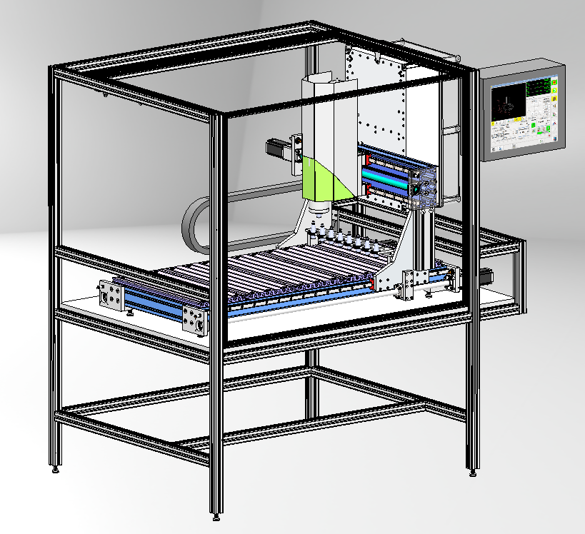

I'm currently looking to build a 4'x4' router to cut aluminium, wood and plastics.
My current (very) unfinished scheme looks like so
Attachment 21409
My initial plan was to use slaved motors on the x axis but after thinking about homing switches and dropping steps I'm thinking of linking the two sides with a timing belt. More thinking required here though

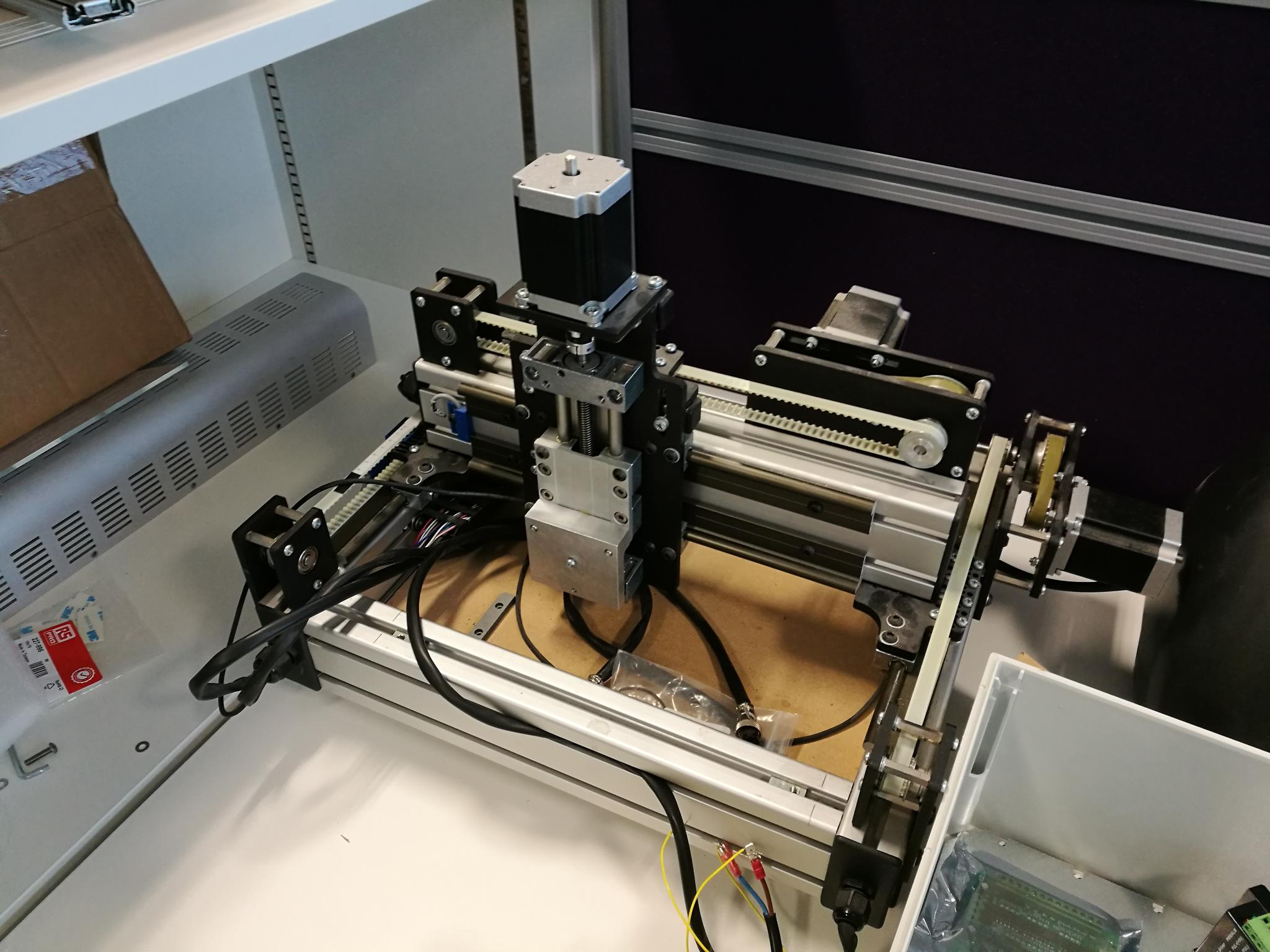

I'm pretty lucky that through work I have managed to salvaged quite a few parts including this small desktop 3 axis router which I will use to test out the electronics panel. When this all works I can progress to start spending time and money on the mechanics knowing that I have the electronics working.
Attachment 21410

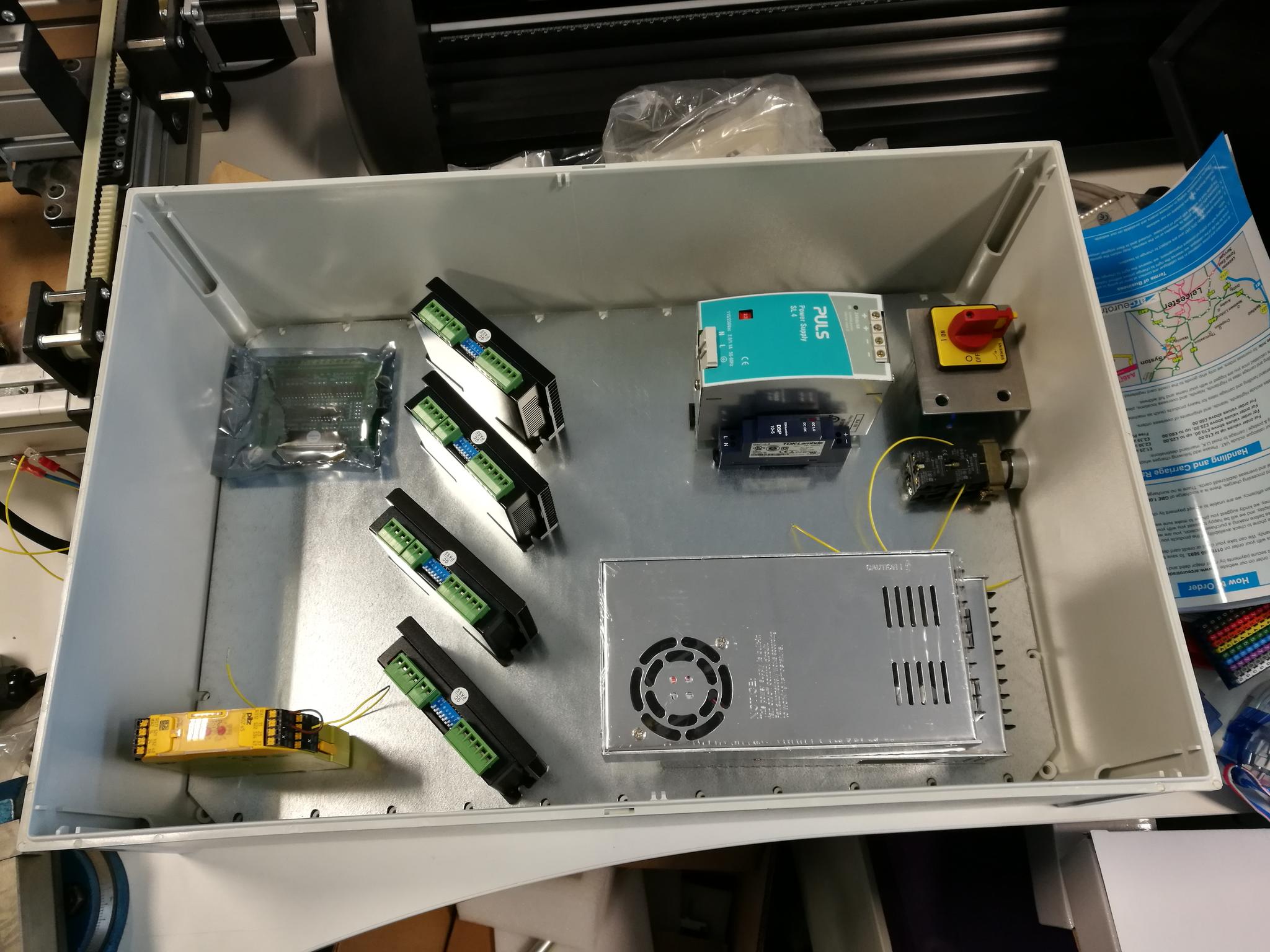

I've managed to put together a wiring diagram for what I think I need to do.
Attachment 21412
I'm unsure about what motion controller I should use and which version of Mach. Originally I was planning on using an Ethernet Smooth Stepper with Mach 3 as this seemed like it would do everything I need and is well documented. However I need to do some more research into Mach 3/4 and see what the benefits of 4 are. Also been reading about Pokeys and CSLabs controllers so want to understand how these compare to the ESS.
Again I have been pretty lucky scavenging electrical components from work for the build of the panel. The drivers, BOB and power supplies for the steppers are standard chinese ebay fare. I'm currently laying the parts out in the box to get a feel for where everything should go.

Re: Build Log: 4'x4' Moving Gantry CNC Router
Hi george!
Just a quick question. Are you planning on using 5v psu for the drivers?
This seems very low...?
Madman
Damnit!!
Scrolled to much on the phone :D
Now I saw the 36v psus hehe
Nr1madman
Hi george!
Madman
Hi madman,
5v is to power the breakout board.
24v for estop circuit
36v for the drivers and steppers
The 5v into the drivers is the pulse and direction signals (plus I think I need to add in the enable signal too).
George
Sent from my EVA-L09 using Tapatalk
Hi George,
I wouldn't use the e-stop system to kill the mains power to the VFD, at least not immediately like that. I don't think they like being turned off while the spindle spools down. Instead install a 3 second (say) delay circuit, or leave it connected normally and use the run/stop signal terminals on the VFD control panel to turn it off.
routercnc
Hi George,
Hi mate,
Thanks for the tip. That output on the pnoz is on a delay. Variable from around 5s to a minute iirc.
George
GeorgeW21
Hi mate,
George
Apologies George skimmed the dwg quickly. In that case no problem. Those pnoz units are pricey but have nice features.
routercnc
Yeah I know, I was pretty shocked when I looked online and saw the retail price [emoji15] . Not having used anything like that before I was a bit worried I wouldn't be able to figure it out, but after a few hours of head scratching with the data sheet I managed to get it figured out. Cheers for taking the time to look over the wiring. Much appreciated. [emoji106]
George

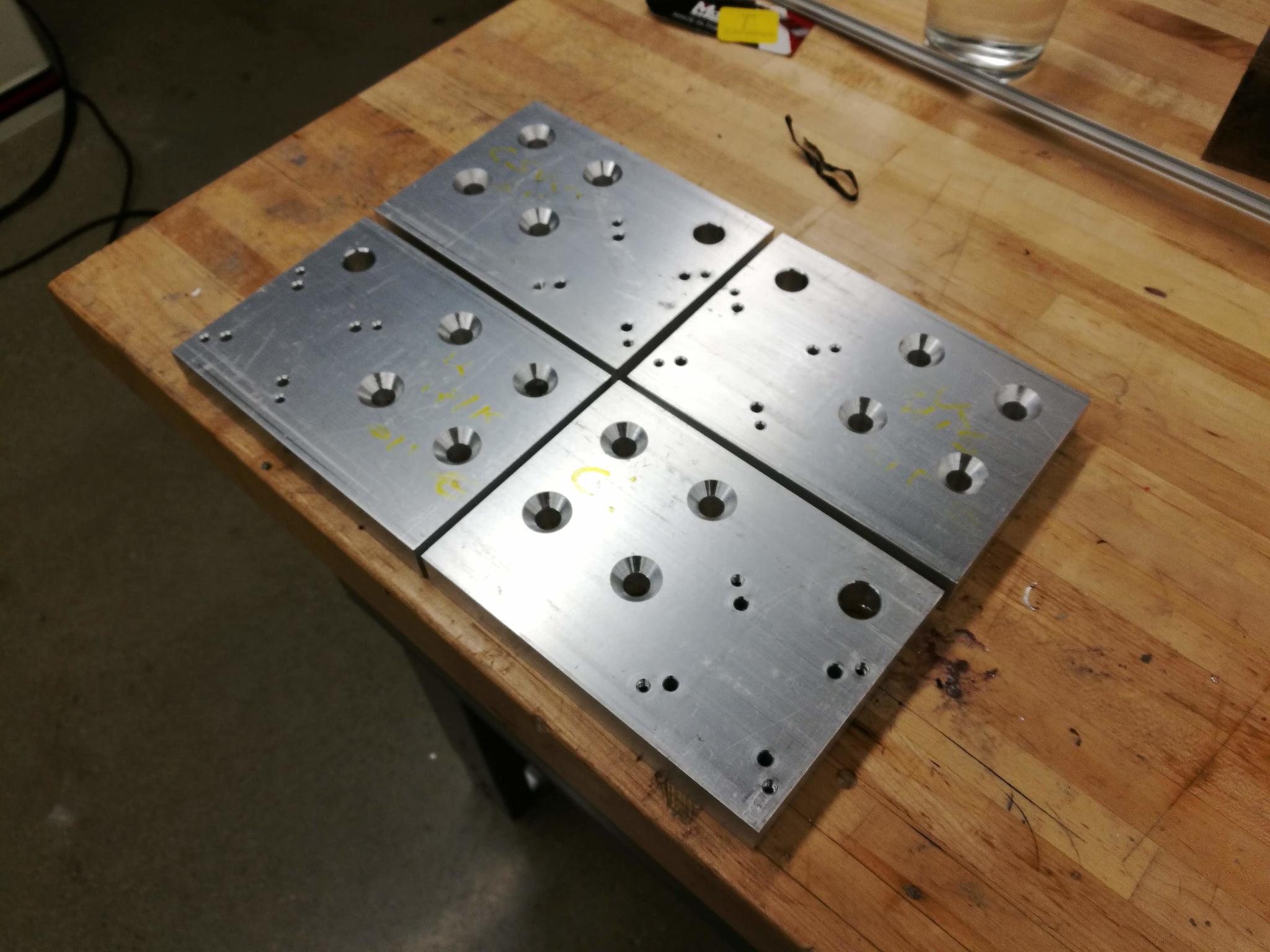

The mechanical design has gone through a number of changes and fluctuating goals but I've now got my mechanical design to a point where I am generally happy with it. Losing access to a workshop or garage has meant the size of the machine has needed to drop quite a bit. I've just recieved the 80/20 extrusion for the chassis and the aluminium plate has mostly arrived for the X and Y axies. This has all come as remnants and offcuts from eBay.
Attachment 24489
Here's the controller mainly wired up testing with the little machine I scrounged.
https://youtu.be/TsRqeZZLF20
George
I see you are running 2.7 linuxcnc is now on 2.7.14 so might be a good idea to update the version. Good luck with the build.

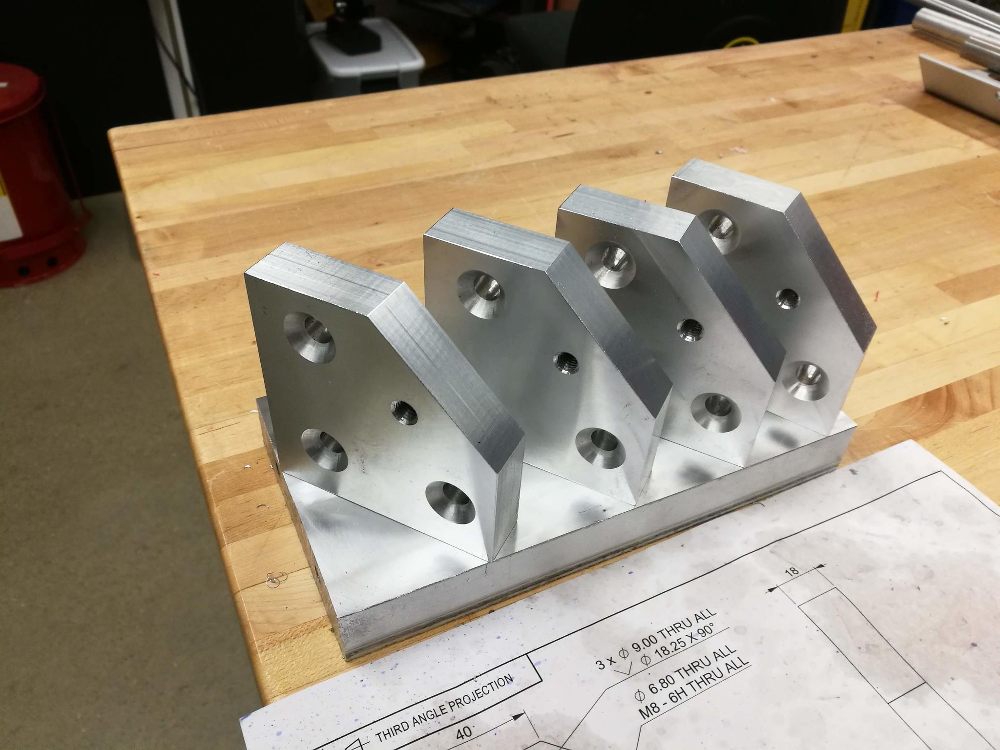

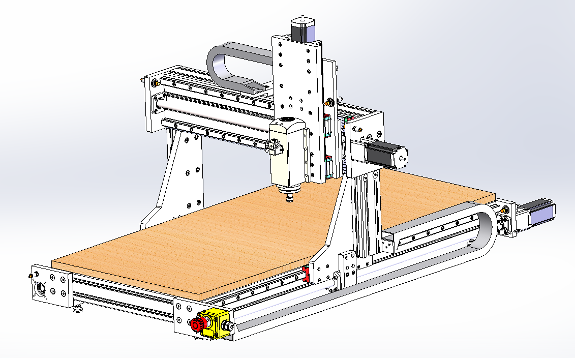

6 Attachment(s)
Progress has been pretty slow but still chipping away.
CAD now looks like this:
Attachment 25004

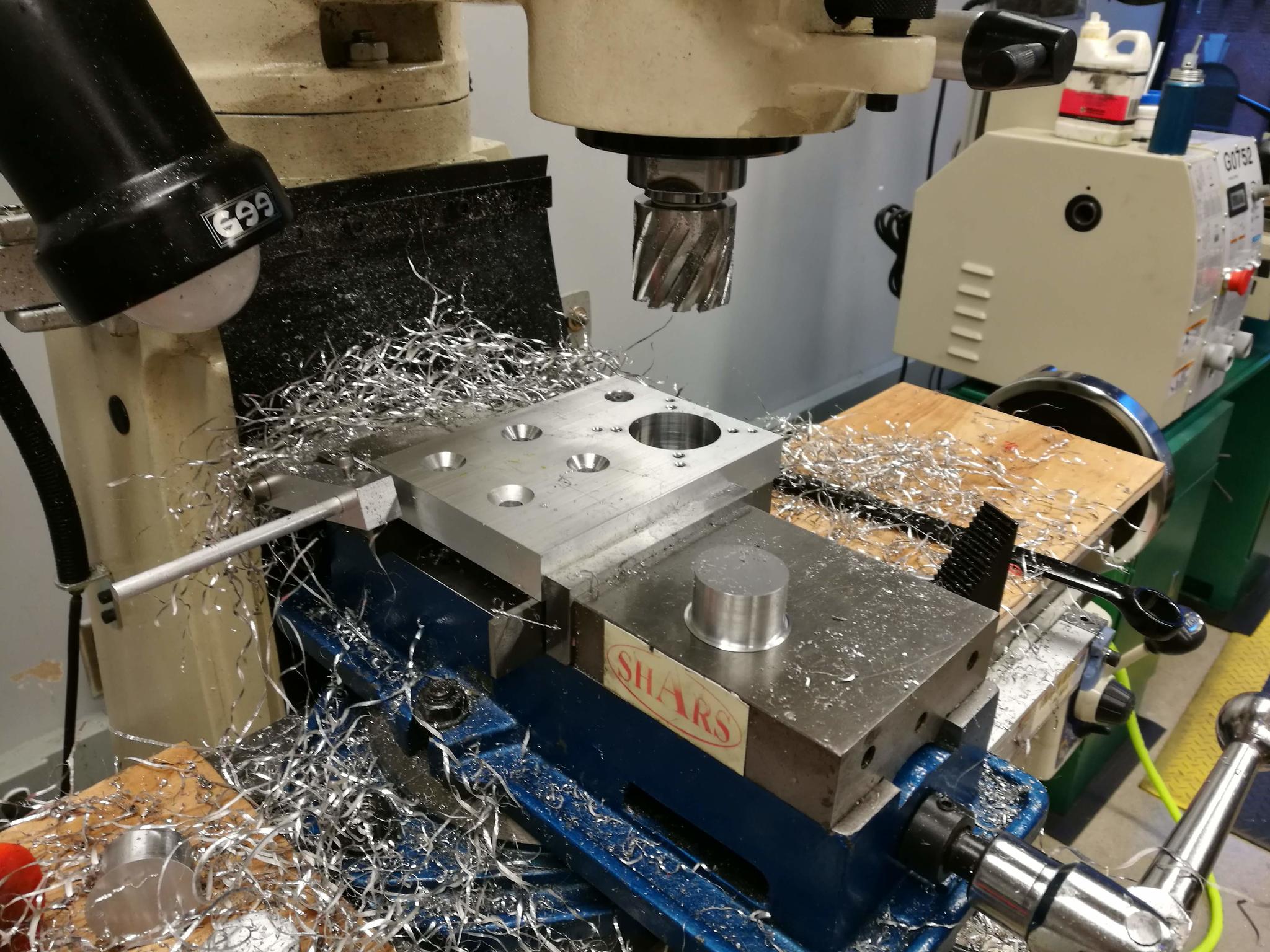

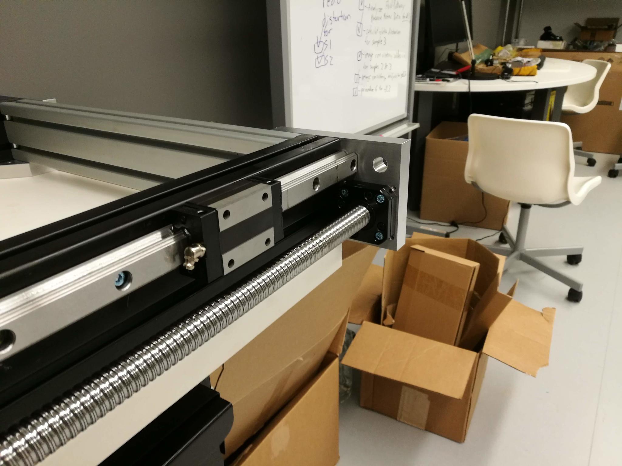

A few pictures of the build so far:
Attachment 25005
Attachment 25006
Attachment 25007
Attachment 25008
Attachment 25009
Looking good, its nice to see it coming along
