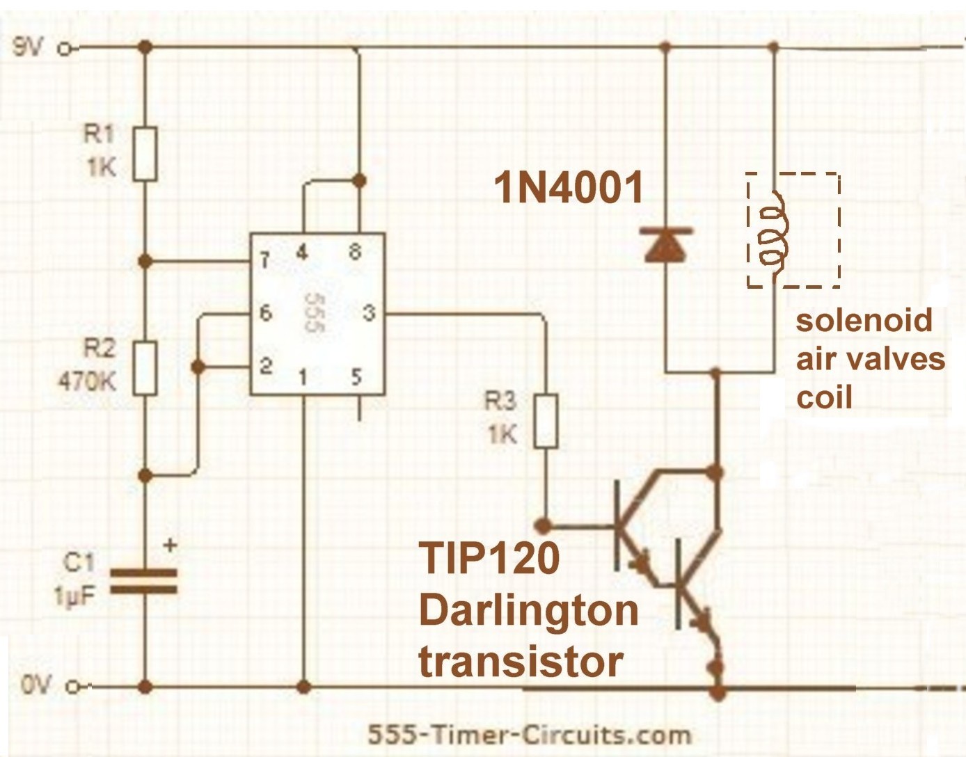

So, I'm going to base my circuit on this one:
http://www.555-timer-circuits.com/flashing-led.html
http://www.555-timer-circuits.com/im...-schematic.gif

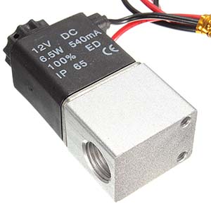

...except I'll be using a 12v PS and one of these instead of an LED:
Attachment 21472
R1 and R2 control the speed at which the LED flashes - or rather (I'm hoping) the solenoid will open and close - as it is, the led flashes rather quickly - I'm planning to replace these two resistors with a couple of linear pots so that I can adjust open/close times - any recommendations for pot values I should be looking at..?
Also, the cap value? As I'm using a 12v supply will I need to change the cap - what difference would a different value make to this circuit?
Finally, will this work..?! Have I correctly assumed that R1 and R2 are independently controlling open/close times?
Any advice appreciated..!
Wal.

I would expect the NE555 can not provide enough current to operate the
solenoid valve without the addition of a high gain power transistor
like the TIP122
the 1N4001 across the coil is the flyback suppressor diode
when the transistor is switched on the diode is reverse biased so it does not conduct
when the transistor switches off a large back emf is produced
the diode provides a path for the current to flow instead of
driving the transistors collector more positive than the positive supply
Attachment 21473
John

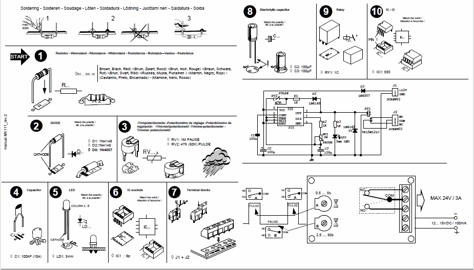

Hi Wal

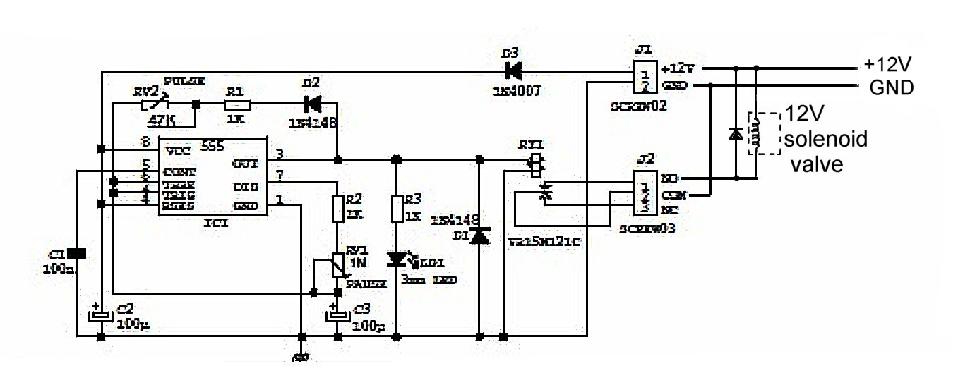

the Velleman kit should make it easier
looking at the circuit it runs of a 12V supply - ideal for your solenoid valve (don't forget to add the diode across the coil)
MK111 kit
Attachment 21474
Attachment 21475
John

...but 12V 6.5W is over 500mA, so if he is going to use the solenoid on the picture he needs a transistor, or a small relay in between the valve and the 555. The 555 is OK for small relays but not for solenoids.

Right, got this made now. It's flung together into an empty air-rifle pellet tin I had lying about, but it seems to work alright...
I eventually used this circuit.
...you can get essentially the same thing for half the price here - I assumed at the higher price that this was pre-soldered - it wasn't..! The two pots that control the interval/pulse are a bit sensitive, but otherwise it's a decent enough kit and very easy to put together. I didn't need the fly-back diode after all.
Thanks to Clive for suggesting the switch to over-ride the circuit and keep the air on continuously - useful and pretty much a necessity..!
