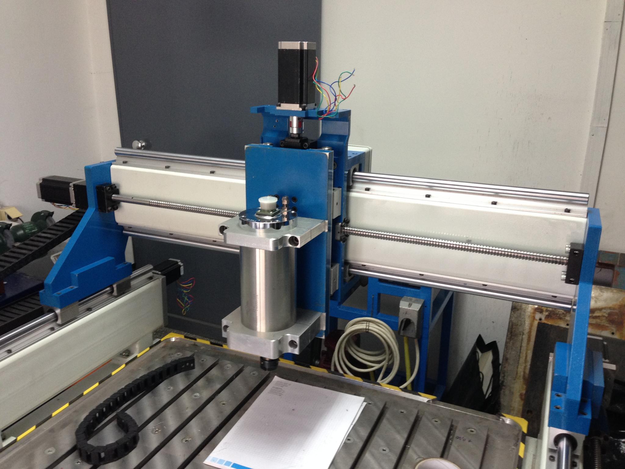

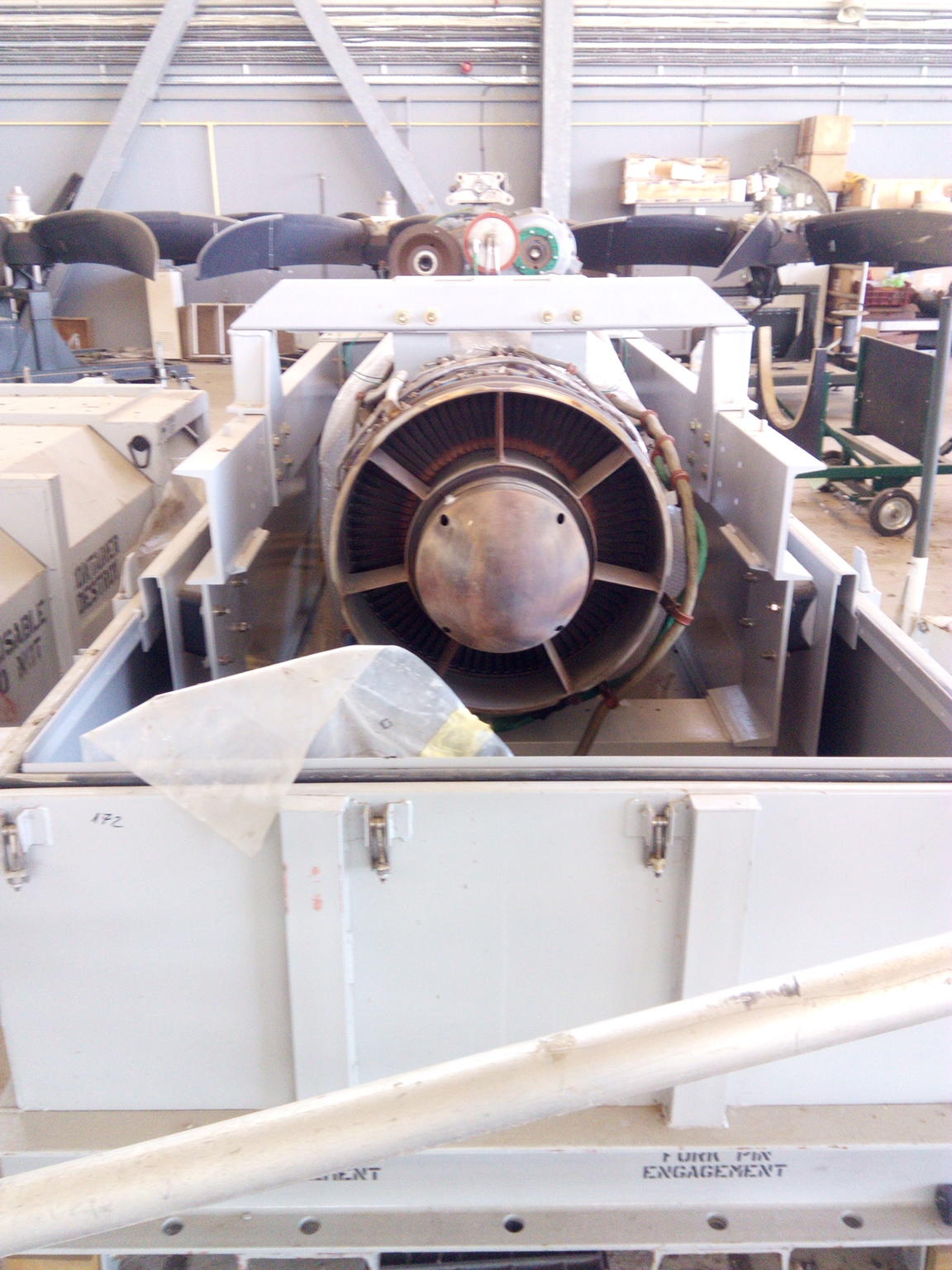

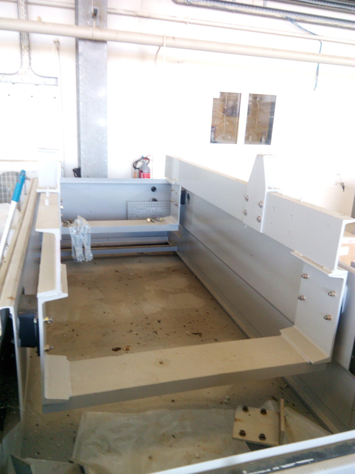

2 Attachment(s)

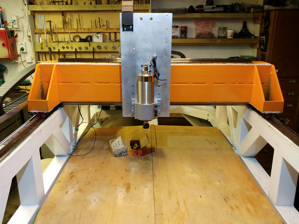

Re: 1500x90x170 4axis steel cnc
Yesterday at work I felt very lucky, since I thought I found my machin ,almost ready ,build for me!!!
But unfortunattely someone place an engine on and I lost my chance.:single_eye:
Attachment 21498Attachment 21499

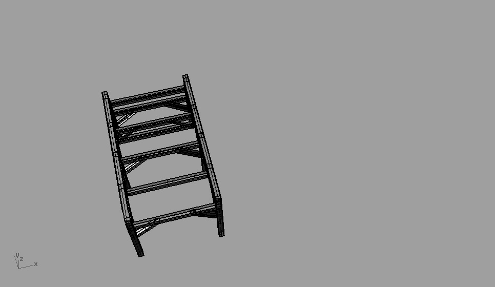

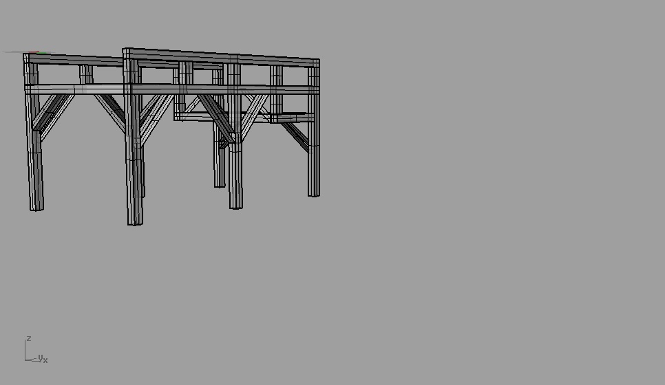

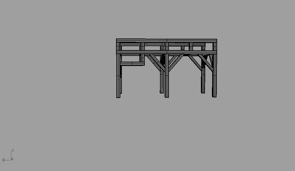

3 Attachment(s)
Workbench plans.
50x50x3mm build, any suggestions?
Attachment 21500Attachment 21501Attachment 21502
Hi Nick,
I'm still learning, but some of the best bed frame designs I've seen have a bed which attaches to the legs with screws, so you can change the height of the bed, or swap it out for a different one in the future. The other thing I thought was quite sensible would be room at the front and sides for sliding large pieces in underneath to work on their edges - looks like you've hit the nail on head already for that one though!
Hope that helps!
Any thoughts about the design and the dimensions of the steel tube I use?
Nickhofen
I think 3mm is a bit thin for tapping into
Clive S
Hi Clive.
Nice input,thanks!
I will then go for 50x50x4, maybe?
Nick.
Nickhofen
Hi Clive.
Nice input,thanks!
Nick.
Hi, May I ask what rails/tracks/guides you are using and what is the method of attachment? What do you want to cut?
The span of the section is where you need to pay attention. Mass/stiffness can be your friend.
Welding can be you enemy with shrinkage and distortion. The 50 x50 x3 might be used for bracing , but the main rail support might be stiffer with 75 X 50 X 5.0 RHS.
Tool load and weight of the material you are cutting will also dictate frame material properties. Sorry not many answers and a lot of questions.
Paul

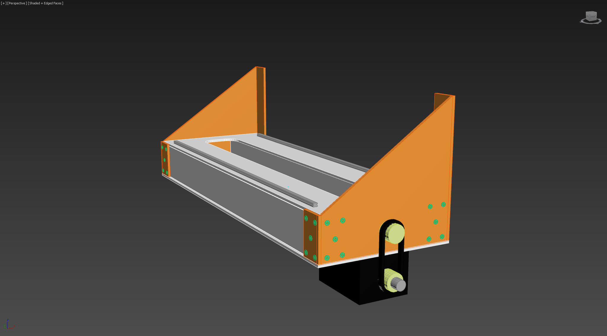

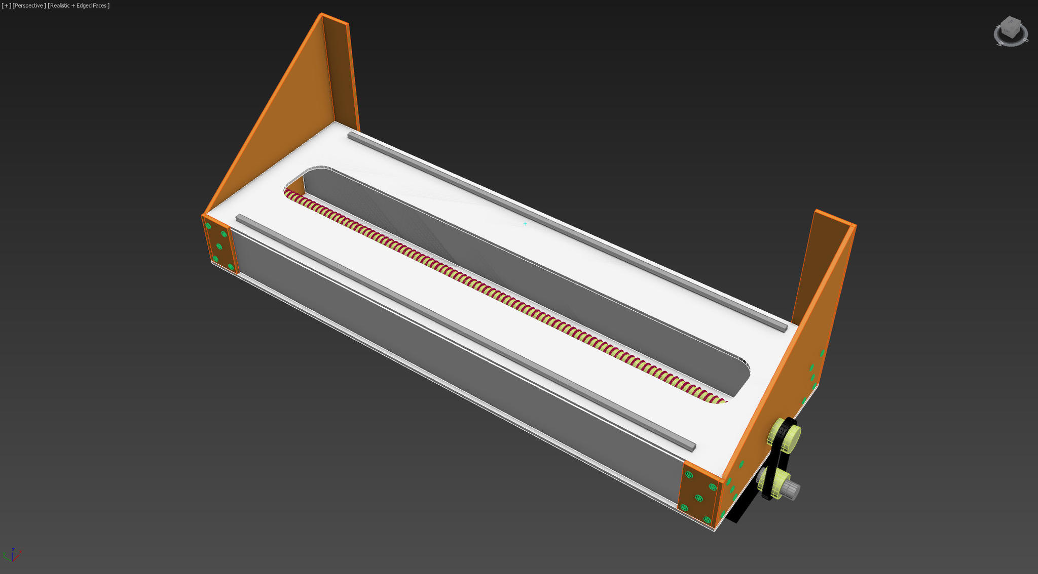

2 Attachment(s)
Advice needed.
I repost here since at my other thread I didn't get any respond.
I am thinking for something like that for my X axis, I prefer to build it bolt on ,with minimum welding, since it is one man job and better to handle, plus I want to avoid metal stress,that I am going to get with welding.
X axis is made from 90x90x900x4mm steel structural sections
At front and back of the steel tubes I will place two steel plates 5mm to stiffness the structure ,also the two plates ,left and right, are going to be 5 -7 mm.
Attachment 22439
Attachment 22440
3 Attachment(s)
Nickhofen
Advice needed.
At front and back of the steel tubes I will place two steel plates 5mm to stiffness the structure ,also the two plates ,left and right, are going to be 5 -7 mom.
Attachment 22439
Attachment 22440
With 2 off 90x90 sections stacked on top of each other with what looks like another 90 mm gap the gantry is going to be very tall. This means the loads going into the top rail are along way from the X axis ballscrews (which react that load) and you are reliant on the sheet panel sides to do the load transfer.
Is this height because you need lots of Z travel?
Whilst yes this would work, I think there are more elegant steel fabricated solutions. For example this one from 'Toomast':
Attachment 22445
There's this one too:
Attachment 22446
Both involve welding so as you point out care is required during construction.
More popular is aluminium extrusion for the gantry because it is easier to work with:
Attachment 22447
For wood working, guitar making and occasional aluminium I would say all the above are suitable designs.
routercnc
Is this height because you need lots of Z travel?.
Sorry I forgot to mention that the total height is 180mm.
I have read at another thread here , that to eliminate the forces when Z axis is cutting, the carriege must be at least at 250 mm from their outer sides.
Nickhofen
Sorry I forgot to mention that the total height is 280mm.
Hello !
I think you (or me) has misunderstood..
The bearings on x axis your long axis should be wider preferably so that the tip of the cutter is between them when viewing the machine from the side.
The y axis bearings on gantry can be closer.
If you use 90x90x4 steel with no welding, how will you close the ends to be able to bolt there?
Nr1madman
Hello !
How close can be the bearings on the gantry so I can have good accuracy and eliminate the tolerance when torgue applied on Z axis ?
The ends of the tubes is going to be welded with steel flanges, I prefer minimum welding for minimum stress and to be able to adjust- align everything.

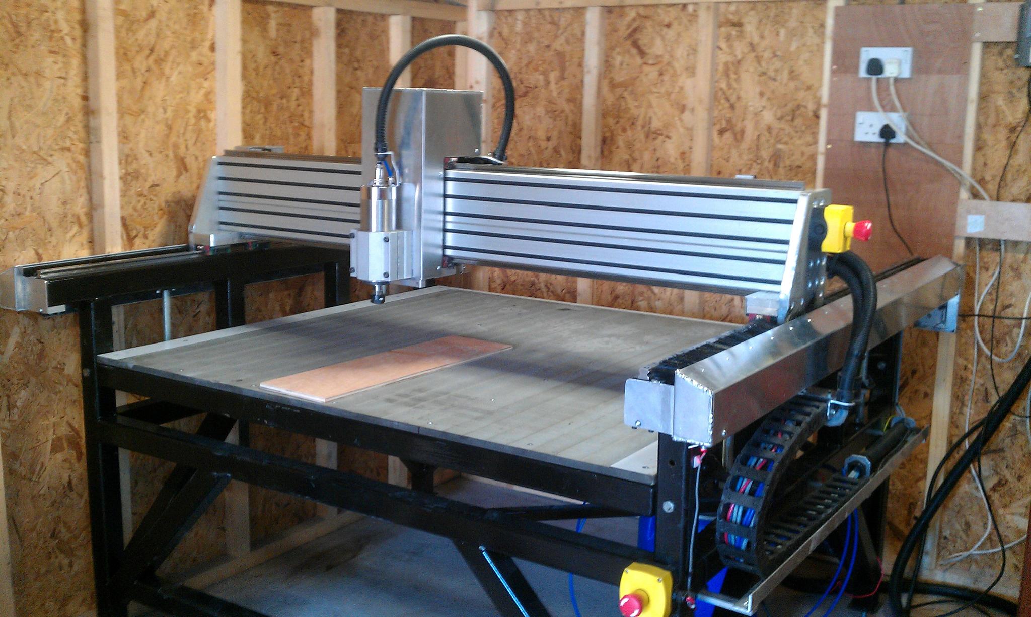

After some sleepless nights watching some video tutorials about Fusion 360 CliveS point me, thanks Clive, I came up with this.
The questions now are:
Can I use two pieces from this aluminum extrusion for the Y axis, not complete on the photo, and screw them them at left and right on the supports?
And what extrusions can I use for the X(long) axis, to support the Hiwin rails and screws.
http://www.ebay.co.uk/itm/like/17233...?ul_noapp=true

I was thinking the option of using aluminum extrusions for the axis, since this way there is no need for drilling ,tapping and leveling with epoxy!
Yes use two pieces one flat and one upright like an L. Then drill the upright one down the channel slot and bolt it to the flat one with tee nuts M6 90mm cap head

Can I use the same extrusion for the x(long axis ) to bolt 20mm rails and ballscrew on? Or I need a thicker extrusion?
Nickhofen
Thanks Clive, always so helpful!
Its very nice using extrusion (heavy duty) because the slots it the 90x45 are exactly correct for the bk and bf bearings and can be mounted with tee nuts 6MM the 20mm rails will also mount into on top of the slots. You would have to work out how to fix the extrusion to your frame.
The ends of the extrusion can also be tapped without drilling for M12 bolts. with a spiral tap in an electric drill.

I see that they are not as cheap as steel tubing but that save me from a lot of work and time!
Thank you Sir!
Yes if you decide on them get the company to cut them to length
I will message the seller,Thanks!
One more silly question..For X (long axe) what side is better the extrusion lay on the bed side, the sort(45) or the thick(90), for matter of stability.
