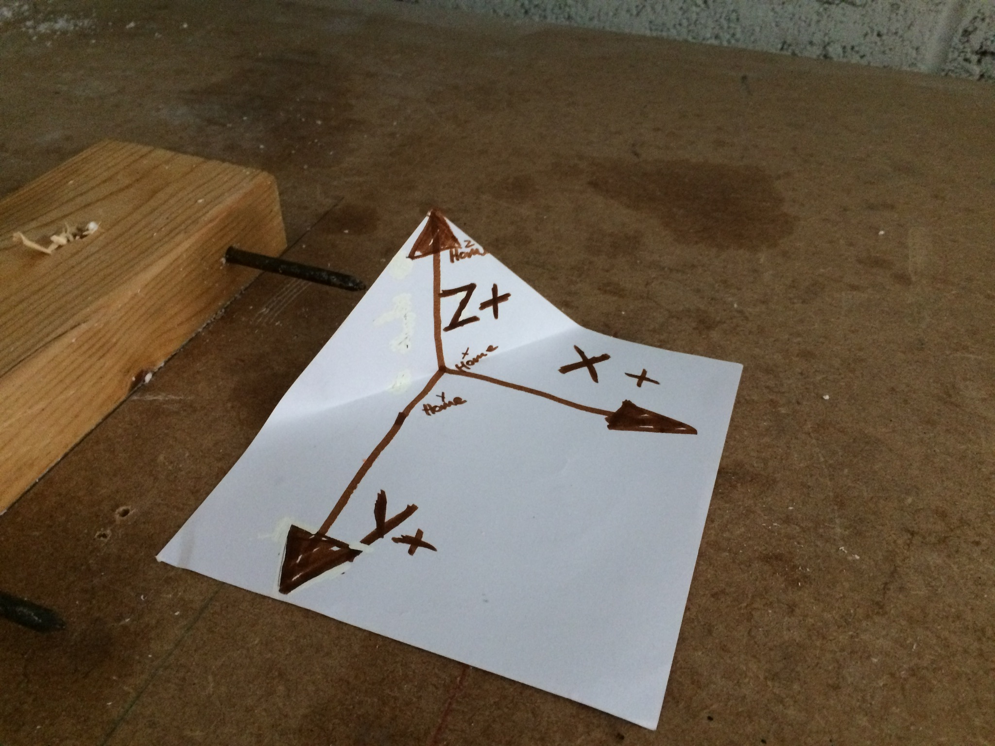

		Doing it wrong all this time!
		So I built my first cnc about 2 or 3 years ago now and it has only just come to realise I think I have the y axis going the wrong way it's just never mattered as I have only been cutting symmetrical surfboards with it.
I think I got it wrong because of the design of the machine being a cantilever style and it made sense to me to have it home in the corner as in the first pic and have the axis set up like the second pic but should the y axis in fact be the opposite way?

		thanks for the reply and the parts :) im happy with the x y and z it more the + and - directions that I think I have wrong?
Basically I have been learning to use fusion 360 and it came to me when trying to do the cam on my machine that I could not get the origin going in the right direction.

		I agree with you, Charlie - normally Y would go in the opposite direction. You could still home to the same position, but configure Mach3 (if that's what you are using) to set Y to its maximum value rather than zero.
What you have would be called a left-handed coordinate system, but most software assumes a right-handed system. Very easy to change in Mach3, though, so well worth doing so it all agrees with Fusion 360 and saves a lot of confusion downstream!
I get the impression that the US tend to have X on the gantry axis and Y along the bed, although my own machine is like yours. People seem to have strong opinions on this, but as long as you know which is which and setup work accordingly, it doesn't really matter. My own problem is that with my mk1 router I stood next to the long axis (X) but mk2 has raised rails along the bed so I tend to stand at one end as its easier to load/unload. I then forget that X goes away and Y across from where I'm standing. Thank heaven for e-stop switches...

 It's not about which is the longest axis, it's about orientation. The one parallel with your belly is the X, the one moving AWAY from your belly is Y and the one moving towards your head from your feet is the Z. Plus (increasing value) is moving from left to right, from nearest to farthest (away from you) and from lowest to highest, assuming the lowest is always zero. Just look in any maths book, it should be like that in every one of them. ...but you may have another book, the one with a printing error, because his orientation is indeed wrong regarding Y. But it really isn't a big deal, except that it is a bit confusing if he is learning the wrong way or talking to other people about axis orientation. I don't know where Y is increasing when moving towards you, and I really don't think it's been like that for any number of years, let alone zillion... :rolleyes:

		thanks for all the help I think I have it all switched around now and working in the correct directions.

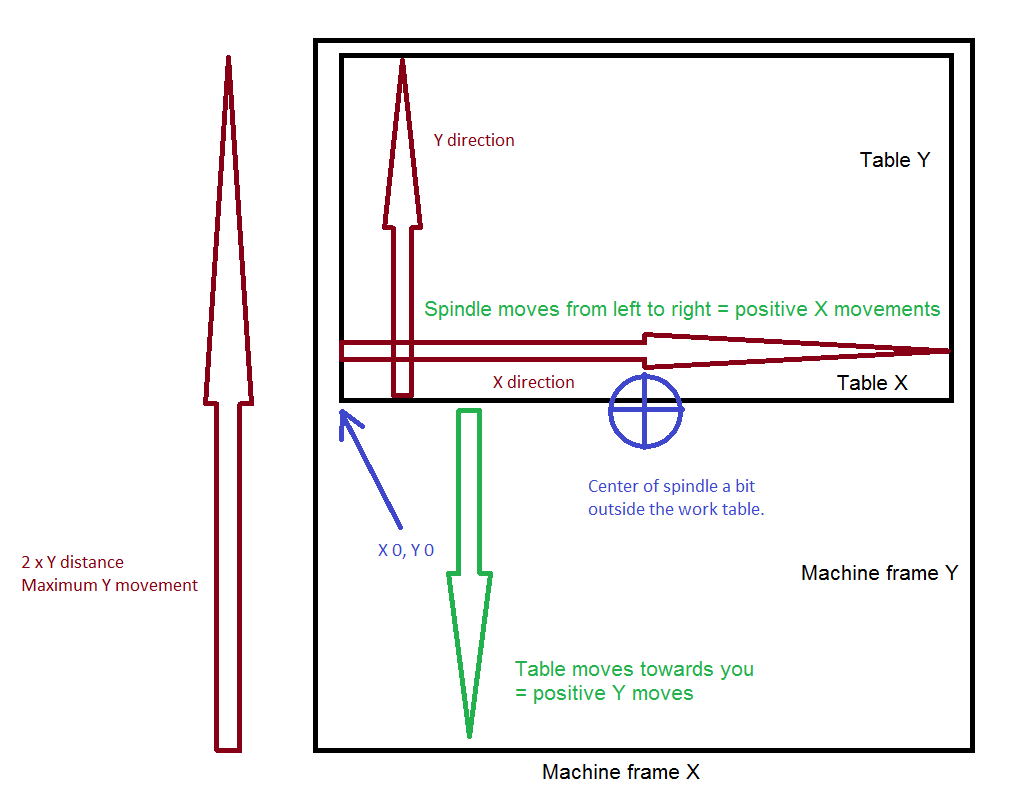

		I gave up trying to decide what was what so now I go with bottom axis, gantry and Z axis then no one seems to get confused.
To me though it seems logical that the bed should be X, Gantry Y and of course spindle Z, wouldn't surprise me if the Americans fucked everything up as they don't even know how to spell colour lol.

 In a moving gantry, yes... well... maybe...
I still think it is more logical the way I see it.
The axis parallel with your belly is the X. Positive X movement is from left to right.
The axis moving away from you is the Y. Positive Y is movement is from you, negative is towards you.
This seems to work with every CAD, CAM software as well as Mach3 and UCCNC screens I used.

		There are two things being discussed here, and it's important not to muddle them.
First - and least important - is this matter of whether X is along the bed (long axis) or gantry, with Y being the other one. Doesn't matter a damn. Do what you like. Better, do what works for you. On my mk1 machine, there were no side rails and I stood at the machine looking at the long axis. So, made sense for X to go from left to right along the long axis and Y along the gantry. My mk2 machine has high side rails so I tend to stand at one end to load and operate the machine. It would make just as much sense to have X on the gantry so it went from left to right and have Y along the long axis. I get the impression that the US tends to do it the second way and Europe the first, but as I say, as long as you know so you put the stock on the bed the right way round, it does not matter. People argue for hours about the "logic" of one way or the other; ignore them. The only logical way is the way that works for you. As Desertboy said, though, people talk about X and Y and assume that everyone else has these the same way round. Much better to talk about long axis, gantry, etc, to avoid confusion.
The second point is very important and must not be ignored. This is to do with making sure that the positive direction of the axes is correct, and this time there is only one correct answer so that your machine is consistent with every CAD, CAM and motion control system out there. This time there are two ways to do it - the right way and the wrong way. What is described below is the right way. This is not a matter of opinion. This is the convention that everyone uses, and you ignore it at your peril. Stand looking at your machine with the X axis running side to side in front of you (long axis, gantry, doesn't matter). X goes from left to right (typically, but not necessarily, X=0 at the left end, X=max travel at the right). Whatever the numbers, as the tool moves from left to right, X is increasing. Under these circumstances, Y must increase as the tool moves away from you. Again, typically, Y=0 is nearest you, Y=max travel is furthest away. For Z, lowest coordinate is down, highest coordinate is up. People often set Z=0 at the top so as Z moves down, the Z coordinate is always negative. This will then tie in with Fusion 360, Vectric VCarve, TurboCAD, Mach3, LinuxCNC, etc. It is called a right-handed coordinate system (although the name doesn't matter) and it's what the rest of the world uses. If you set up your coordinates differently so that the numbers run the other way, you have a left-handed coordinate system and you are screwed every which way. You will never figure out quite what is going to happen when you run gcode generated by any normal software.
What I have described here works for a router, where we can all see that the work is still and the tool moves. That's easy to follow. Milling machines (table moves in X and Y) and fixed gantry machines (tool moves on one axis, table on the other) can give problems. The trick is to see that the only thing that matters is where the tool is relative to the work. Doesn't matter which of them moved. Tape a sheet of paper to the bed of your router. Draw X and Y axes on it - X from left to right at the bottom of the sheet, Y from bottom to top along the left-hand edge. Bottom left is now X=0, Y=0. Now take your piece of paper and tape it to the bed of your milling machine (or fixed gantry machine). Move the table so that the tool is over the X=0, Y=0 point. The DRO or whatever you are using should say 0,0. Now move the table so that the tool is over the max Y position. The table moved towards you. Don't worry about that - what matters is the DRO increased its Y reading. Now move the table so that the tool is at the right-hand edge of the paper. Table moved to the left. Doesn't matter - what matters is that the DRO increased its X reading. Just try to think about where the tool is on the work, and whether the DRO readings go the right way when you move the tool over the work.
So, choose for yourself which axis is X and which is Y. Make sure that when you move the tool, X and Y DRO readings move in the correct direction. Then start using the bloody machine, and the whole business will become second nature in no time. I have a moving gantry router on one side of the workshop and a vertical mill on the other with its XY moving table. There is no confusion as long as you take time to set them up right from the beginning.
 I stand looking at the short side of my router. Gantry runs left to right in front of me. Does it still make sense to say that the long axis is X?
Problem is, there are two right answers!

 I think your only problem is that you don't understand what I am saying or don't want to understand. This happens maybe because I am not a native English speaker, maybe because you feel so much aggression, maybe something else, I am not going to analyze your problem with it. As an effort to clear this misunderstanding, here is a drawing of how my machine is configured.
Attachment 21918
Now, please tell me this is NOT the industry standard and I'll change. But if you do that I would like you to explain what is wrong, not just by telling me that you have been 35 years in business, because that is not enough. I have also 40 years in engineering, even though not machining, but had to deal a lot with X, Y Z charts and other axis related issues all my adult life (and even before that).

		I didn't read all of the replies,but your Y axis is backwards. If X+ is to the right, then Y+ moves towards your wall in the back.
Re: Doing it wrong all this time!
		There is only one right way to do it. There is a certain rule how to find the coordinates in a Cartesian system and if not learned right you can make a very BIG Mistake on a machining centre or when you have more than the 3 axis. Take that 5 min effort to learn things right.
