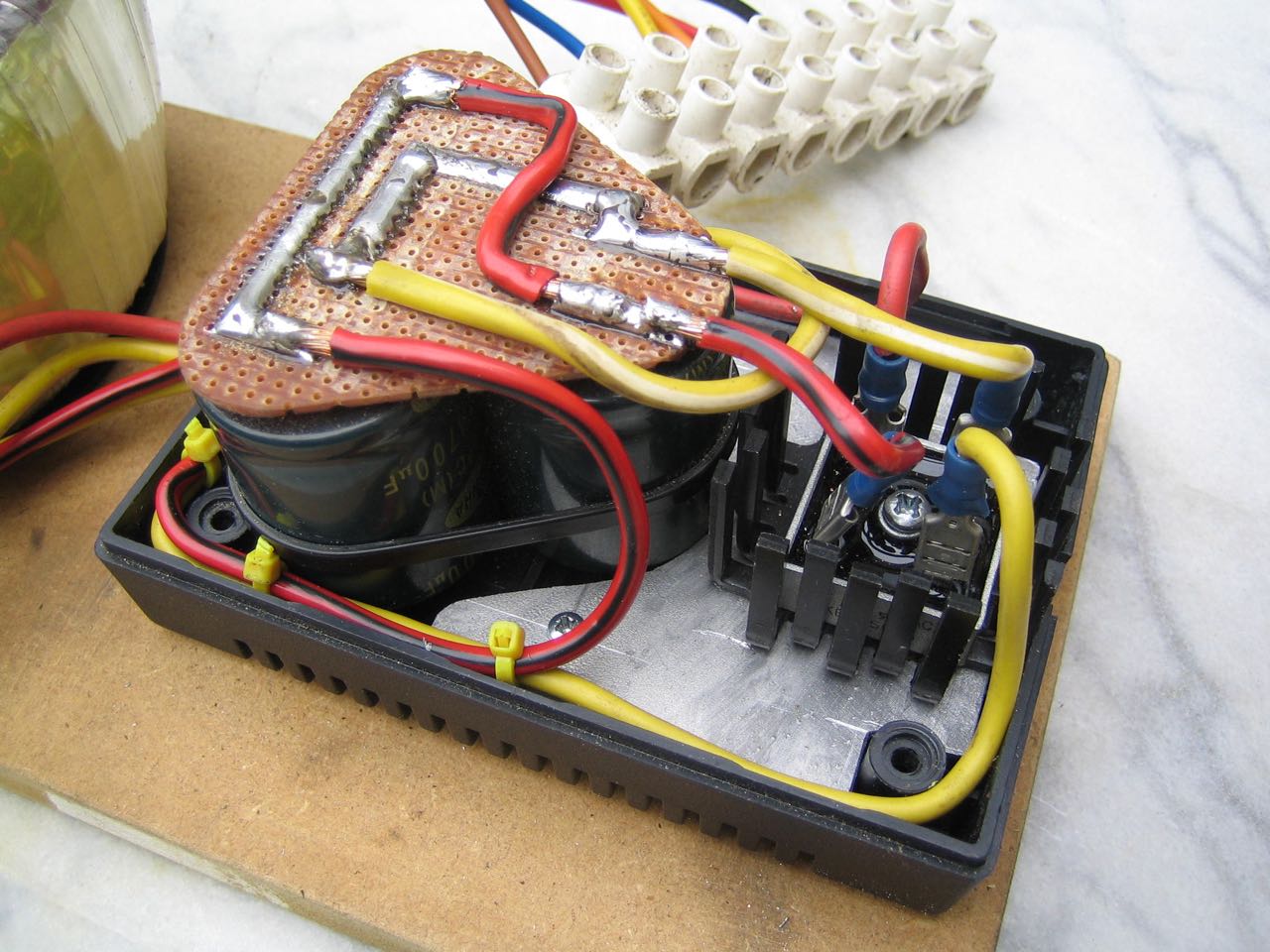

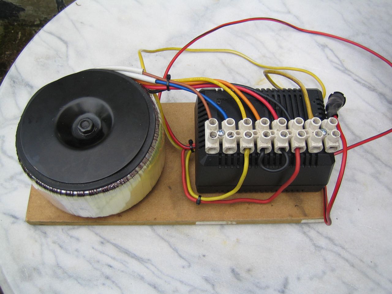

OK, so I've built the power supply (625 VA). Ignore the overlong DC wires in the pic - I've left them long as I'm not sure where I'm going to permanently mount a fuse holder. On that topic, what size fuse should I fit for the output? The temporary set-up has a 20A fuse, but if I go with a 20mm fuse holder the largest fuse is 10A. Would a time-delay fuse work given the short peak over-current demand?
Attachment 22037Attachment 22038
Re: 60-70v unregulated power supply recommendations
You have gone to town on that. Have you fired it up to see if you are getting around 68V DC if so fine. Are you going to mount the tx on a ali back plate? Re the fuse if you are going to make a control box use din rail fuses and fuse to each drive
I'm getting 72v DC. I wanted to mount the whole lot on an ali or steel plate, but just couldn't find anything suitable in my stock. Do you think the transformer needs to be on a metal plate? It has a rubber washer bottom and top that would frustrate any heat transfer. Most of the old Swiss machines that I deal in for a living have low voltage control systems (low current-draw of course) and they usually use Paxolin to mount all the electrics. I did think about using this as I have a large sheet, but it was just easier to use the MDF.
m_c
Only the input to the transformer should be fused.
