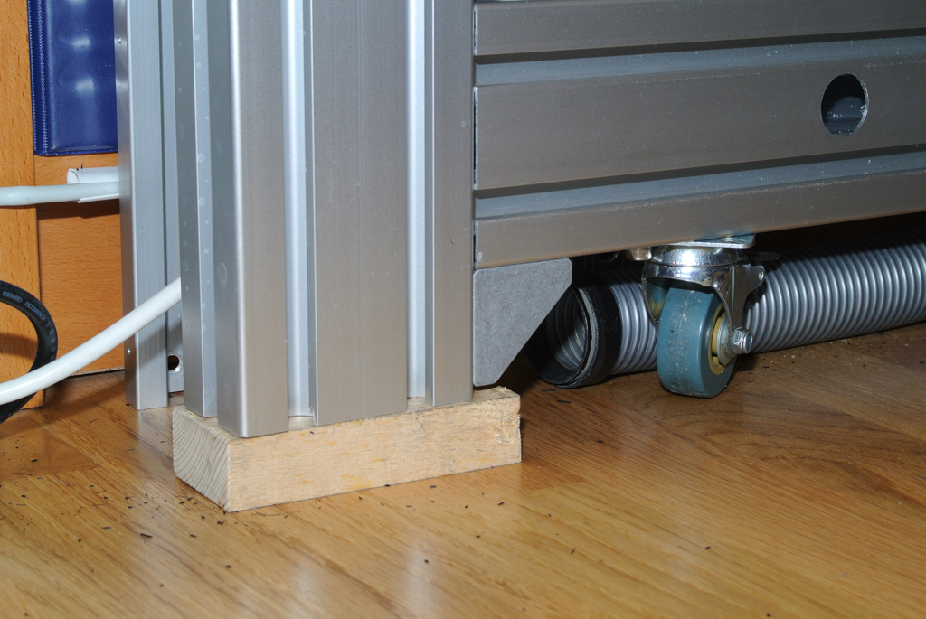

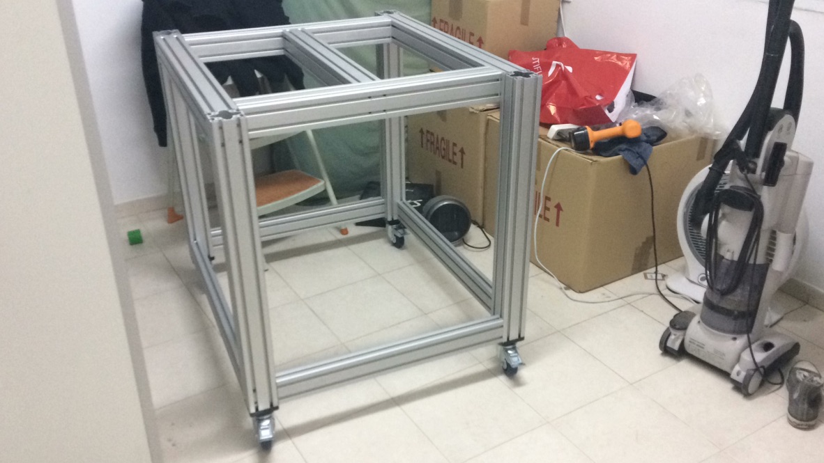

I am sure it's going to be a nice machine but based on my experience I'd suggest making some changes before it's too late.
My frame was originally similar to yours but I had to remove those wheels because of shaking caused by the G-forces. A fast machine with heavy gantry and Z movements will generate far too much shaking even if all the four wheels are locked. I changed my design, moved the wheels and the machine is now lowered to the floor on four wooden blocks, efficiently reducing vibrations and shaking. The wheels are still there but they don't touch the floor and gets lowered when the machine needs to be moved.
I assume your machine is going to be much faster than mine, considering you are using servos, so it would be a shame if you had to lower the speed and acceleration just to prevent the violent shake, so consider this before it is too late.
Re: Gantry style CNC mill
@A_Camera, you are absolutely right, also i wouldn't be able to level the machine with the wheels.
i thought about a hybrid solution of using 2 wheels at the back and 2 anti-vibration legs at the front for stability.
there will also be corner brackets all around.
could you share an image of your solution?
thanks!

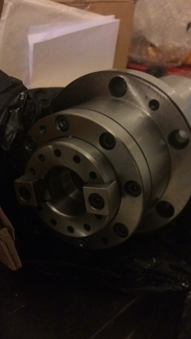

hi Clive, thanks!
i used the BT30 spindle from skyfire
http://skyfirecnc.com/picshow2.asp?id=14
thanks!
Attachment 22288
There is really nothing to show. The machine is resting on four wooden blocks and the wheel is suspended by about a millimetre or two. If I need to move the machine I lift one end, remove two of the blocks, lower on the wheels and do the same for the other two feet. This gives me enough clearance to move it around. I think four steady feet is better than two with wheels.

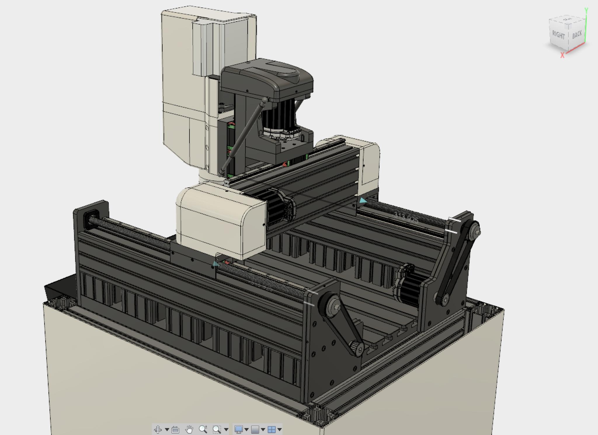

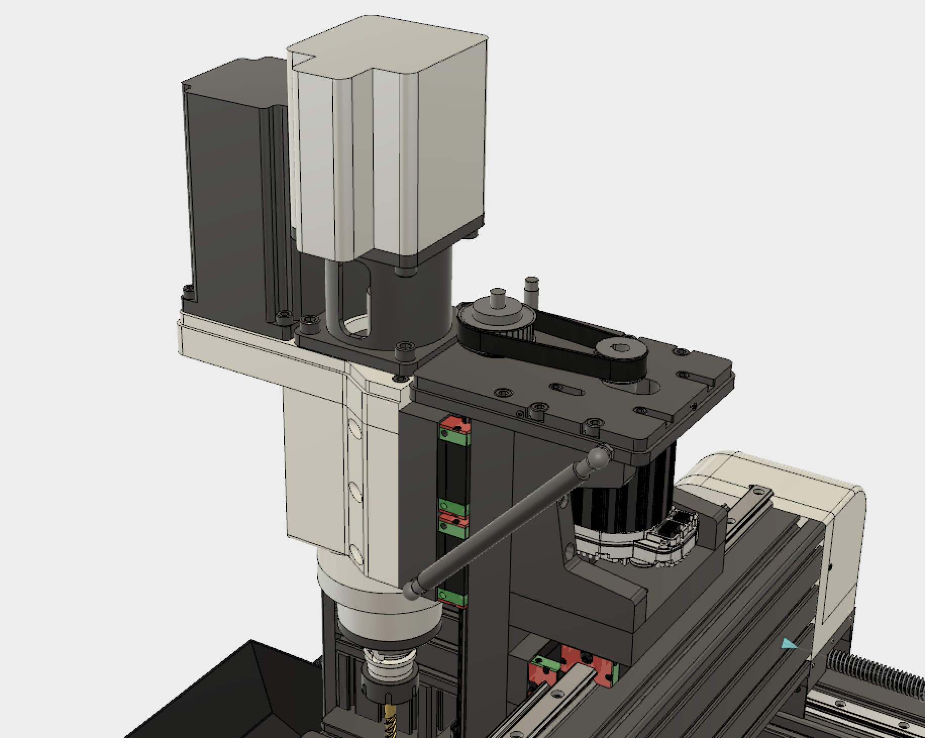

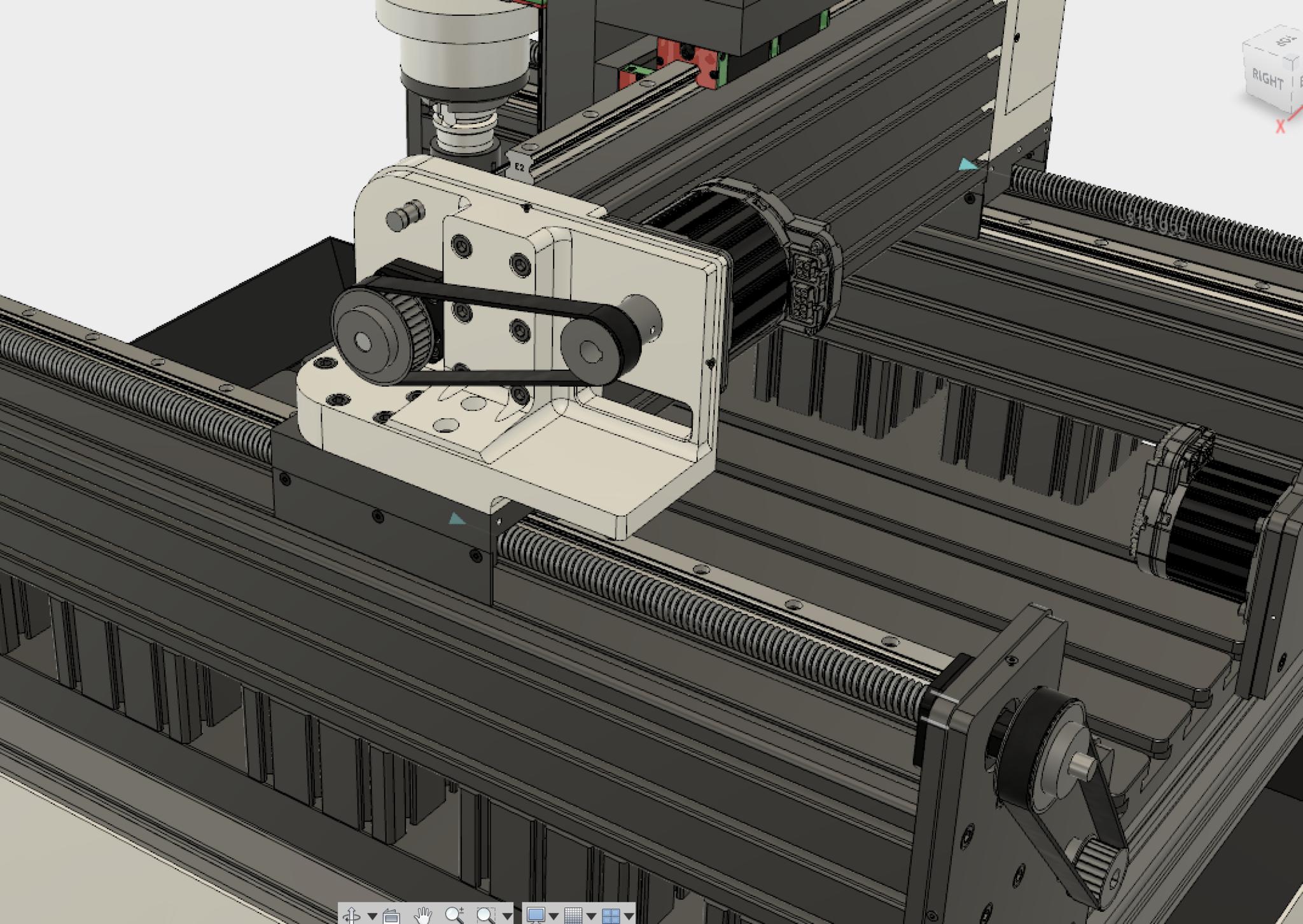

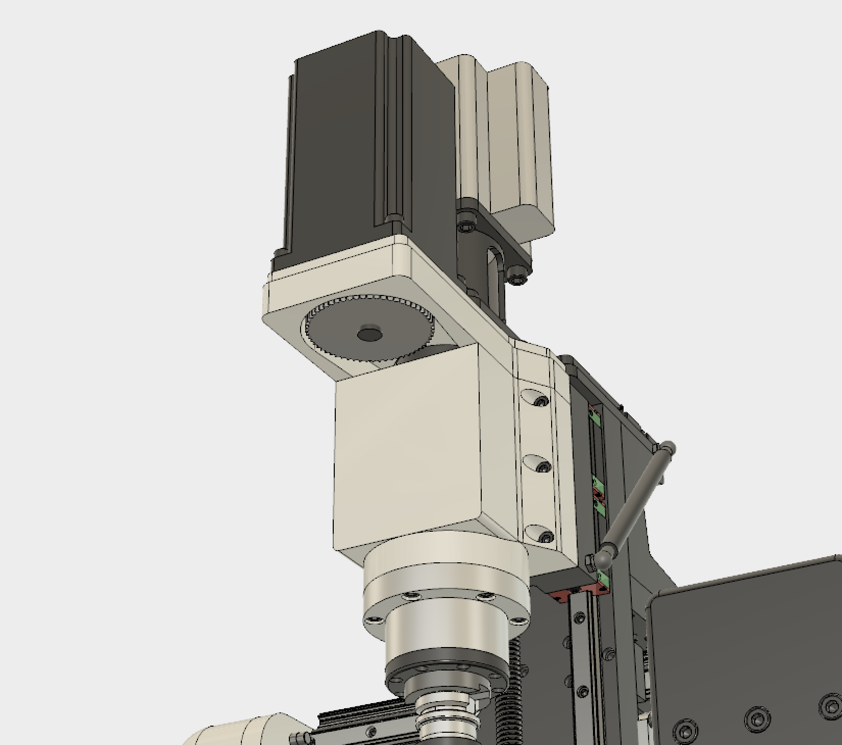

Nice work so far. Can you show the detail behind the Z axis top covers. I'm guessing servo drive via belt to the top of the ATC spindle pulley?
Also, are the gantry ends just covers, or machined from solid (!)

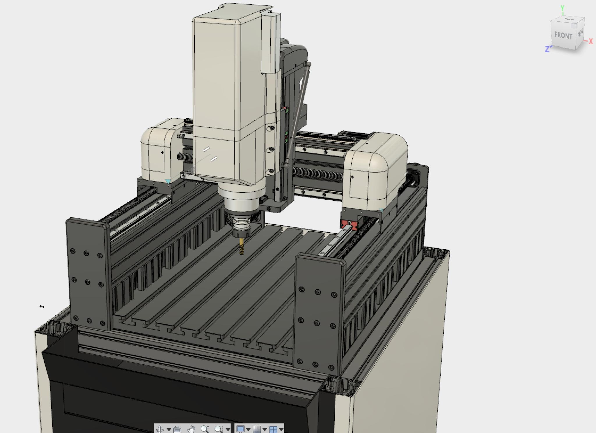

hello everyone!
the gantry ends (and all other parts) are machined from solid 7075 T651 but those are covers as well.
i'm including some images without the covers for clarification
Attachment 22399Attachment 22401Attachment 22400

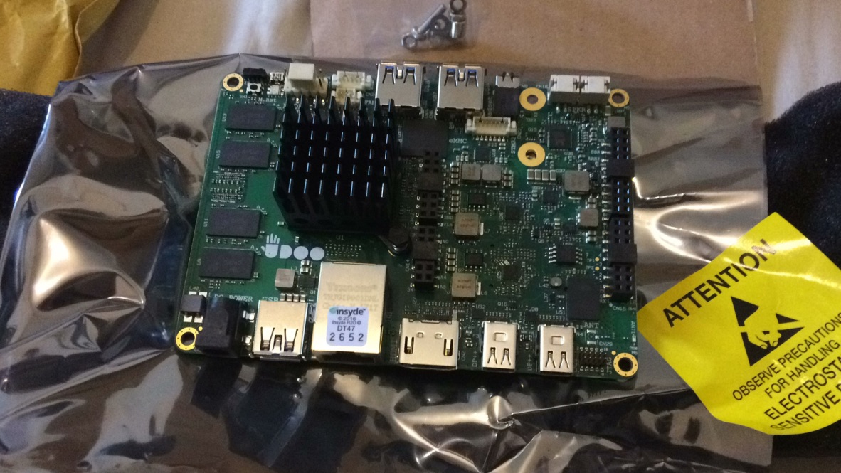

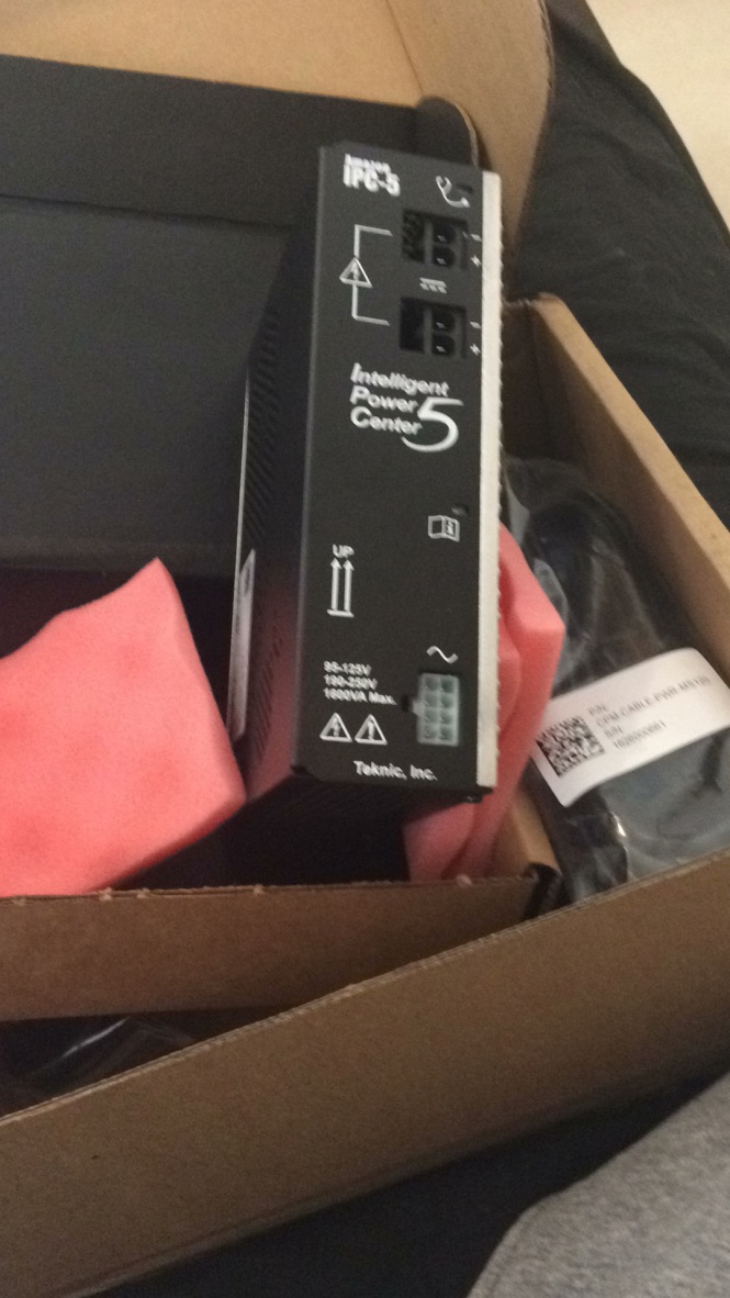

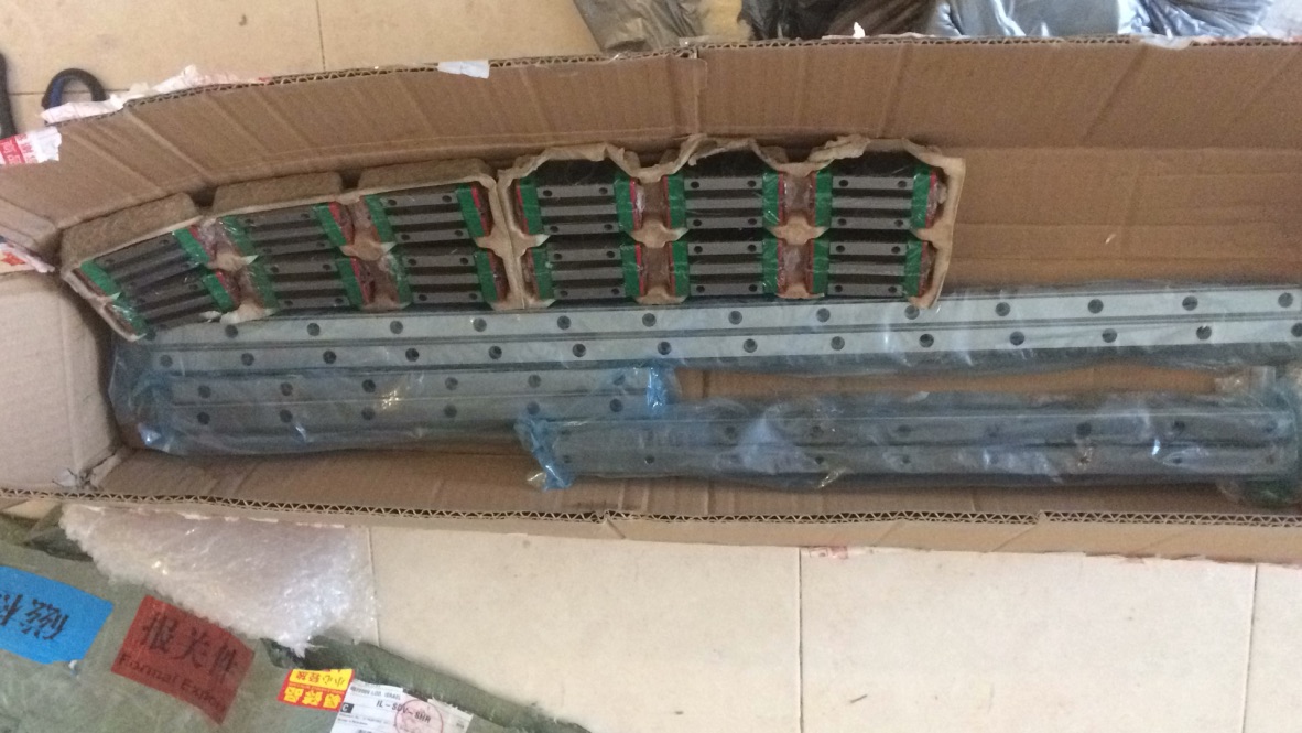

Updates
this week iv'e FINALLY got my UDOO x86 single board PC which will be paired with Dynamotion's Kflop motion controller to create what i hope
is the best hobby solution today for machine control. (more updates on this soon)
Attachment 22404

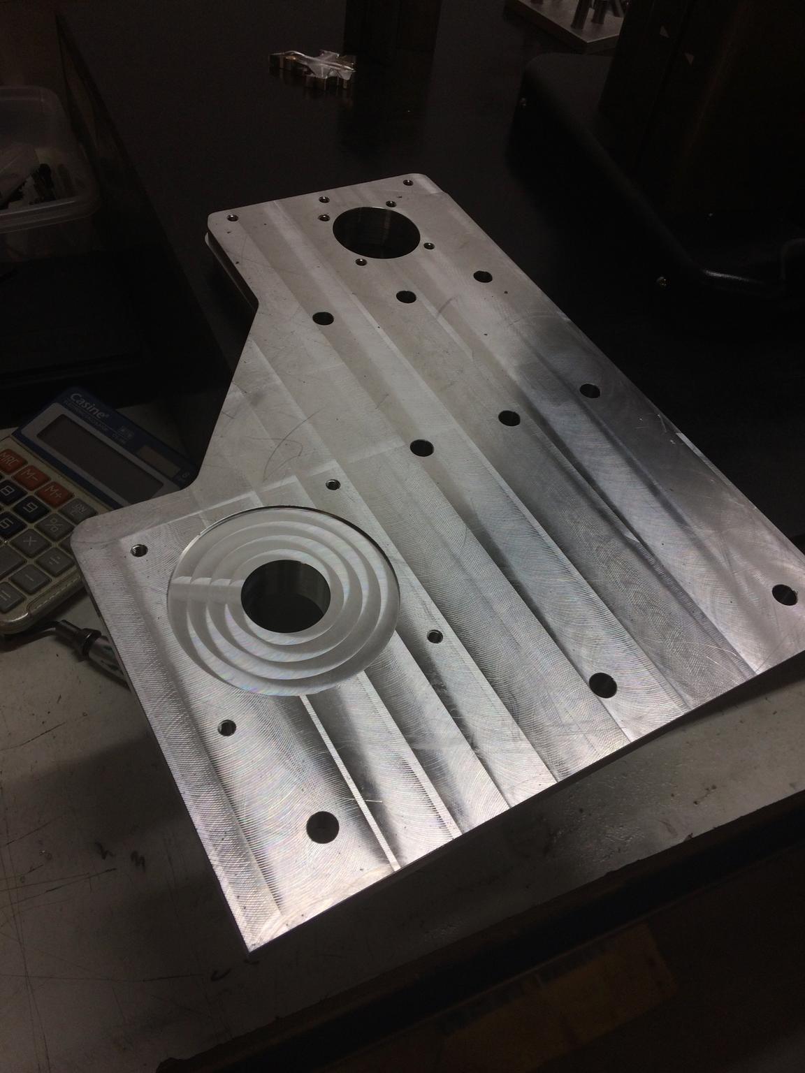

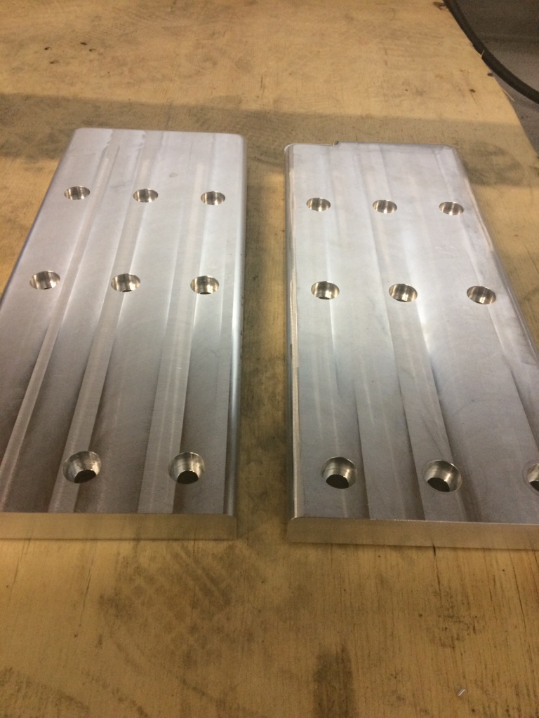

also, the work has begun on the machined parts(!!)
Attachment 22403Attachment 22402

Hi giladv,
Very interested in your project as I am thinking of building something of similar compact size in the near future and your design looks great.
I also use Kflop with my CNC mill and I love it.
One question, the 1.8 spindle servo, can you tell us what servo you are planning to use? Is is a dedicated spindle servo for higher revs or just the usual 3000 revs?

thanks!
regarding the spindle: the ac servo should be 3500 rpm max (with the driver itself i was able to go only to 3000rpm).
but there is a 1:1.87 gear ratio between he spindle and the motor. so i'm planning on around 6000-6500 rpm at the spindle tip.
best,
Gilad

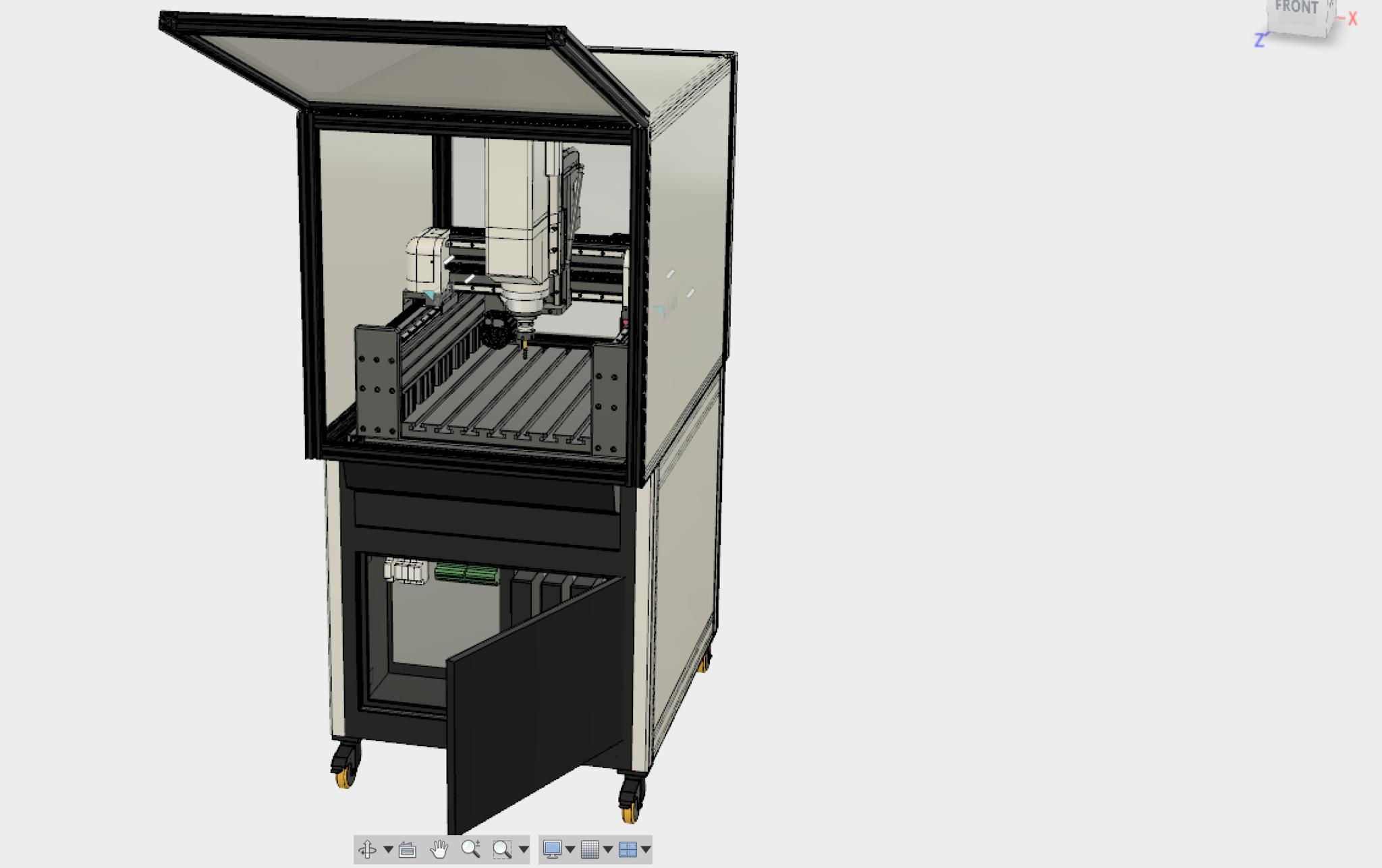

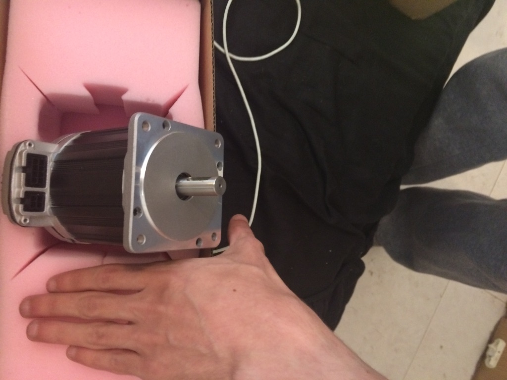

2 Attachment(s)

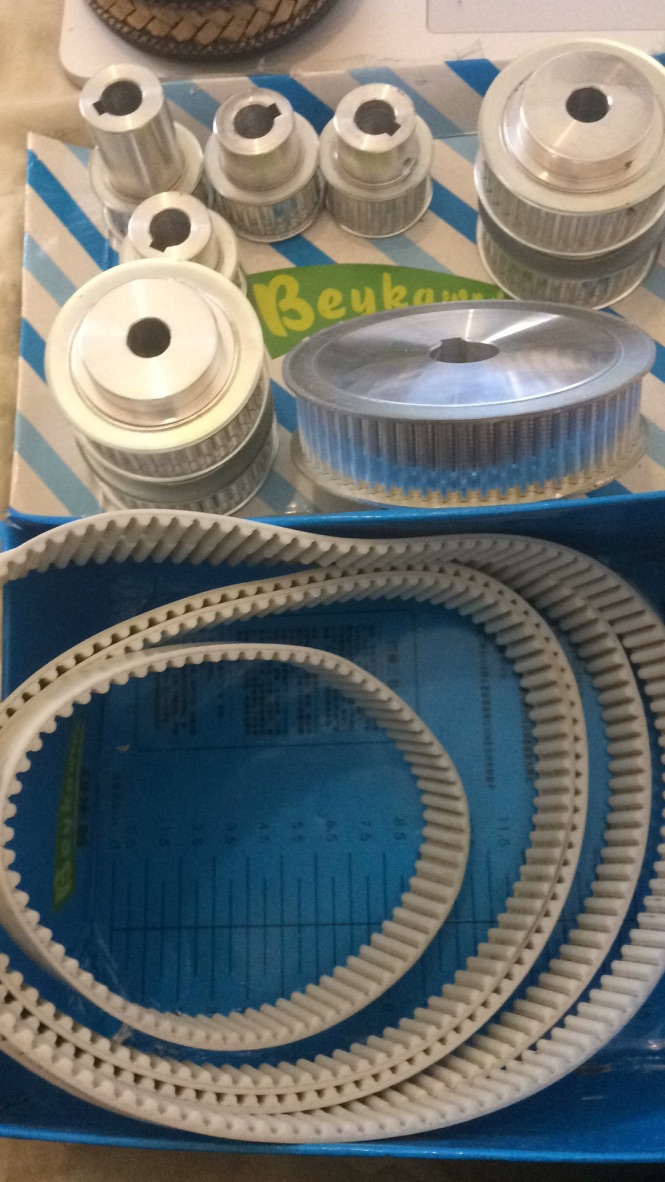

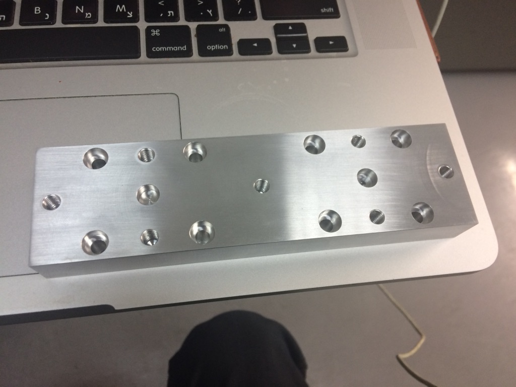

hello everyone, just a small update:
Attachment 22462Attachment 22463

@Boyan Silyavski - valid question/points:)
my machine is intended to be the best, most versatile R&D tool i could build because of space limitations.
but also, it should be a fun project which i will learn the most from. so with that in mind:
- this setup has more tinkering and planning in it than just buying a single piece plug and play off the shelf part.
- this setup costs MUCH less to a comparable BT/ISO30 integrated high speed spindle. because of the actual spindle and because of the expensive balanced tool holders required for a high rpm spindle. we are talking more than X2 the cost for a complete setup.
- torque > speed for versatility. i can always cut slower with small tools but i you cannot use a facemill/tap/fly cutter/sketchy-chuck-setup-for-one time-lathe-work on a high speed spindle.
- reliability - this is very important. lets say the motor or the pneumatic cylinder is malfunctioning, what do you do? i can just swap them out separately with any other semi-compatible components.
- attachments - i can attach anything with a BT30 taper in it to the spindle (lasers/extruders/drag knives/lathe tools). but also i have an active axis on that attachment because of the servo on the other end.
- inertia/momentum - big heavy spindle attached to a big heavy servo and a tool holder are way more ideal for hogging/roughing operations.
- saying a 7k rpm spindle cannot do Al work or engraving is plain wrong. just looks at one of the many Tormac videos doing both and doing it great.
regarding the machine itself, it might not look like that in the CAD but all those profiles are the thickest and biggest i could find (120mm and 160mm). but also, because of their shape and internal structure they are at least as rigid as plain square steel tubes.
in terms of precision reliability, assuming those tubes were stress relieved in the first place, the second you weld them you will need to take them again for stress relief (or they will distort over time) + facing/grinding.
Item's Al profiles comes extremely straight and flat and you use fasteners so you can build with it inside an apartrment.
i intend to deal with vibration by filling the profiles with EG. the gantry profile will be filled with EG mixed with carbon fiber trimmings (for extra rigidity and slightly less weight in the cost of less damping capabilities)
i hope i answered your question:)
