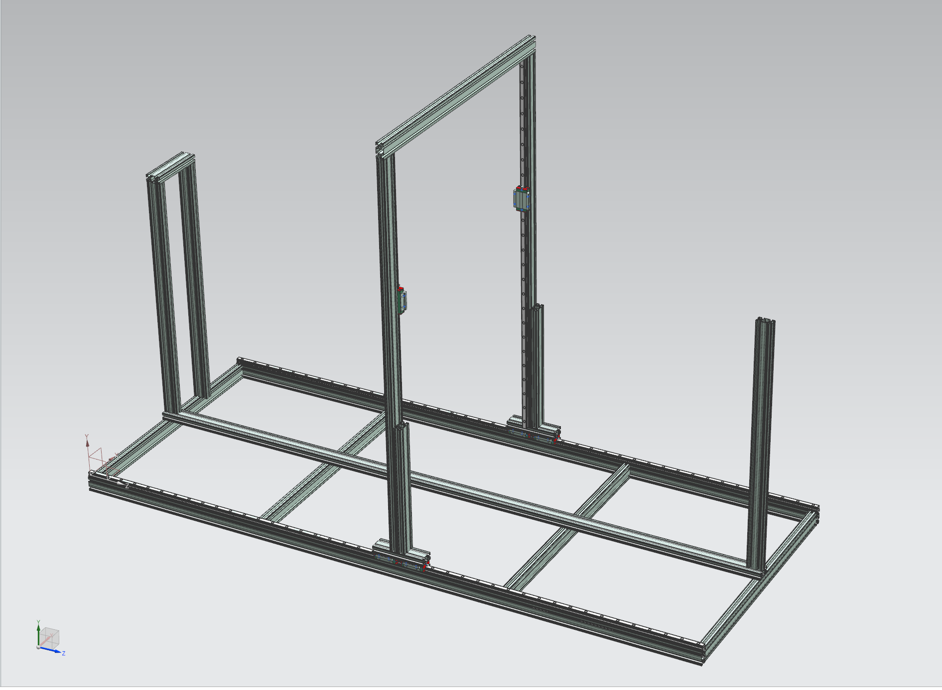

Foam XL hot wire cutter
Hi, after adding some hot wire attachment to my main machine wich showed excellent results cutting 1200x600x50 foam sheets, i decided to build something bigger. And better.
At the moment i use DEVFoam LE to generate the paths and i believe this is the best program at the moment. Yep, tried them all before i purchased this one. Its worth every cent.
Basically i would like to be able to cut 1200x2300 foam blocks 10-1000mm thick. After considering this and that, i decided to purchase another application DevCNC Foam and drive the contraption using Arduino Mega and Ramps 1.4 which connects via USB to PC. Then from DEV CNC Foam on the PC i could visualize what's happening and most of all hit a button and all axis home and square. Aint that great. The big deal is that Dev Foam CNC has and upload feature to the Arduino, so hopefully i will not mess with firmware.
As you can imagine after calculating this and that price, for sake of sanity and simplicity i will have Hiwin 20 on all axis. Not Hiwin, but the copy they sell from Germany on ebay. Hopefully it will slide ok.
The challenge is what to use for linear movement. I wanted ball screws but price wise decided on lead screws as speed will not be big. So choice still is between 10mm and 8mm lead screw which will spin a whopping 2500mm length. I need 200mm per minute cutting speed which i find is the best quality wise, when cutting with 0.16mm constantan wire. So with 2mm 2 start lead screw / 4mm per turn/ i will need to spin the screw mere 50 times per minute. Anyway i decided to upgrade to 24V the Ramps board and use DRV8825 drives that will be coupled with the most powerfull Nema17 Step Motor 42BYGHW811 4800g.cm 2.5A 2Ph. may be even at 1:3 for the sake of resolution. thought at 50 steps per mm resolution will be 0.02 and if i use some micro stepping even better
I believe the motors have to be good enough to move the "gantry" at that low speed and low acceleration. I am somewhat more worried of the natural sag of the long lead screw. i will design and print the nut, so backslash is not a worry.
here is the initial design. It could be wide as much as i like in future by just changing a couple of aluminum pieces . i am still contemplating to fully separate the sides and connect only the " gantry bar" which is a must for everyday use as i will be cutting mainly letters not wings. Profile for the sides and gantry legs will be 30x60 Bosch. It must not vibrate and be strong even if i am radiation cutting, as if it vibrates in any way, then i have to sand. And that's a tedious process ... better to be perfect quality result from start
I have contemplated another linear solutions, offline controllers, bigger motors but at the end i believe this is the proper way to do it. FYI end result will be better than 6k foam cutter which dont even use supported rails :thumbdown:
Hopefully i will even avoid separate PSu for the wire and heat it from Ramps

Any idea for possible cheap solutions for the long rails ??? I decided on 1200 and 2200mm travel .
I am currently exploring options for the way to do it and its seems it is hit and miss
-The oozenest C beam seems perfect but they stock it up to 1500mm. And i need 2500mm
-Mjunit is ready made system but such lengths from China will be 1500euro in total to receive it here after customs
-Similar problem with Motedis, too long travel. I will wrtite them now but i see the 6mm steel bearing rod that fits
-meanwhile talking with Fred from BST
-The german CNc Discount does not answer me or i would have bought the rails from him
Any idea how to achieve that travel on the cheap? And best with stuff from Europe? And if not on the cheap, just on the reasonable side? I will not buy Chinese rails with Hiwin Price tag from EU. Now if they are cheaper ...

To sum it up for the linear movement and structure:
1. Motedis failed me this time. Blah Blah Blah, we dont cut and ship anything larger than 1980cm. Though it says on their web if one needs such thing to contact them to arrange. Now the funny thing is that i found DOLD Mechatronik in germany, that is their partner and does that, plus he has 3m screws and is willing to ship them to me. WTF. I am in the process of buying the profile from him.
2. I prefer the leadscrew TR10x2 for now, simply put - it will be more reliable and cheaper. Screw is 20 euro per 3m . Double row angular bearing pack is 2 euro from china. All else will be printed or machined from plate of aluminum. It could be made also with the Gt2 steel belt , it will be same money but will take me more time to design it, as i don't like much long double belts.
3. I have changed all structure from 3060 to 2040 slot6 , as it will be good enough for the job. I know, not typical for me to not overbuild, but it's not needed here. Final length will be 1300x2600mm travel will be around 1200x2400, as i remembered that locally i have 600x2400 foam sheets
-The original Hiwin for 6x1300 and 6 carriages / yes i will be but connecting them/ is around 800$ and after all will be around 800 euros. Quite expensive
-The Chinese MGN12 6x1300 and 6 carriages will be 300$ and say 60 euros import tax. Probably they will do the job, if something does not move right, will open it and change the balls, as i have seen people on Youtube do. So thats the winner
-The Mjunit is around 1500euro after taxes . is very nice looking but at the end of the day is just aluminum profile with steel rods and U bearings. But again i will say it looks very professional.
-The C beam from Oozenest Looked nice but is only 1500mm so again has to be attached together. Will cost me as much as do all from Chinese MGN12, so better not deal with rollers/ if they are not angular contact?/
-I lost patiance trying to explain Chinese that i need it for a slow foam cutter, otherwise there are some that could make me the whole linear movement cheap from 1204 ball screw , alu profile and square rail. Shipping would be then 300$ for that lenghts .

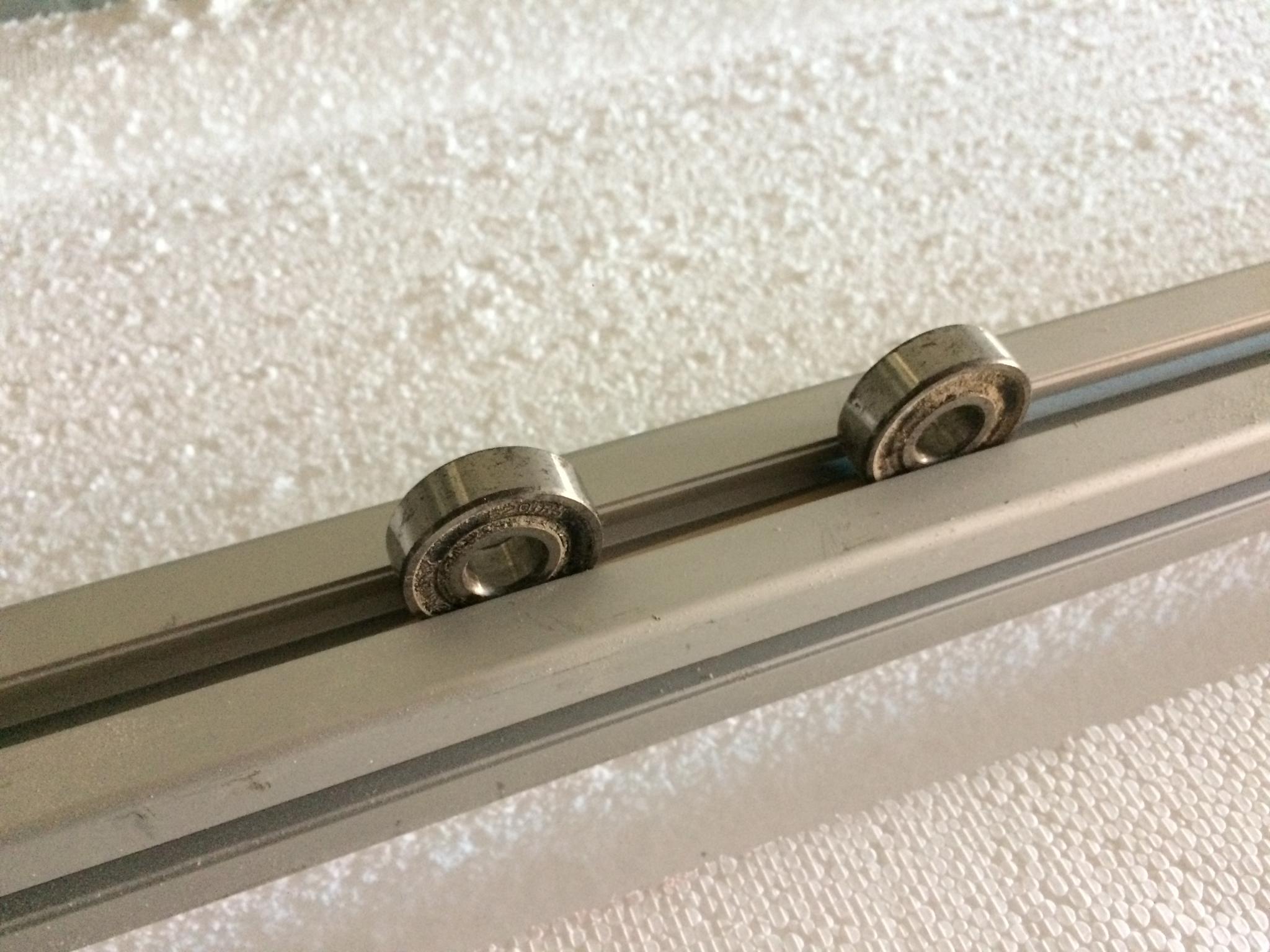

4. Now some interesting stuff. Long ago where there was no 3d printing and i had crappy belt driven machine, i have tried to make something with delrin ball that could slide on top of Bosch profile. Nowadays its even easier. Couple that with 2040 profile and we have a winner. 500 balls are 20$, each carriage has around 18 balls i believe. So i could use them for even something else. I will buy the balls even if i go with Hiwin
No plans here, but i have figured it out with 8mm balls:
https://www.youtube.com/watch?v=7ksZgqKZnZo
Another one, looks nice and have downloaded the files. Waiting for him to see if he will pass me Step file, no just STL:
https://www.youtube.com/watch?v=0IUlMtbzhR0
Check how they compare:
Attachment 22682 Attachment 22683
With the preload feature i dont see a reason why it will not work perfectly for a foam cutter especially where they will not even make a noise., Not to speak of that i could print them in POM. I will wait a day though as i have another idea inspired from i don't remember which bearing block.as i simply like them less bulkier.
There was a bearing that looks like hiwin block and inside it has 4 big spheres that enter the rail channel in a very similar way as abobe. But inside the block there is arrangment of very small bearing spheres that the big sphere lay on. So basically no recirculation as the above but a kind of. The only benefit will be to lessen the bulk and make them look more professional.

I see less of a problem with the printed cages than I do with the balls them self. If using steel ball on Ali you don't need to be a materials scientist to know which will be the winner!
Re: Foam XL hot wire cutter
The balls are Delrin, so would be the printed cages. There is no steel on aluminum.

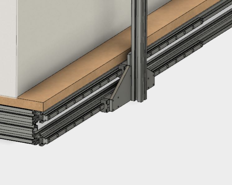

I started drawing my thoughts up is there any difference running the linear rails on the side rather than top of the extrusion?
charlieuk
I don't see any problem with that
charlieuk
I think there is not absolutely any need the foam block to be supported by the structure . It could easily be simply on the floor or lifted by rests of foam. or a bed formed from foam leveled by the wire.
Same could be said for my design, but the cross bracing supports the smaller alu profile i am using against twist.

The problem comes when you have to move the blocks of polystyrene around, the blocks are not all that light and I'm dealing with 16' x 4' x 2' blocks so having a smooth and flat table to easily side them on to make it posable just about by myself were your method I probably could not. I allso will be putting mine in a 20' shed that has a wood floor so I need to build some extra strength into the design so it is self supported.

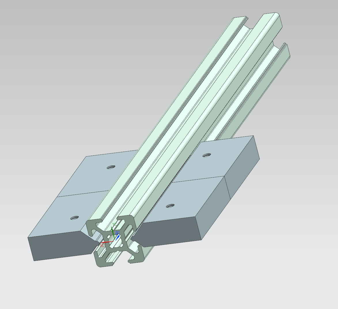

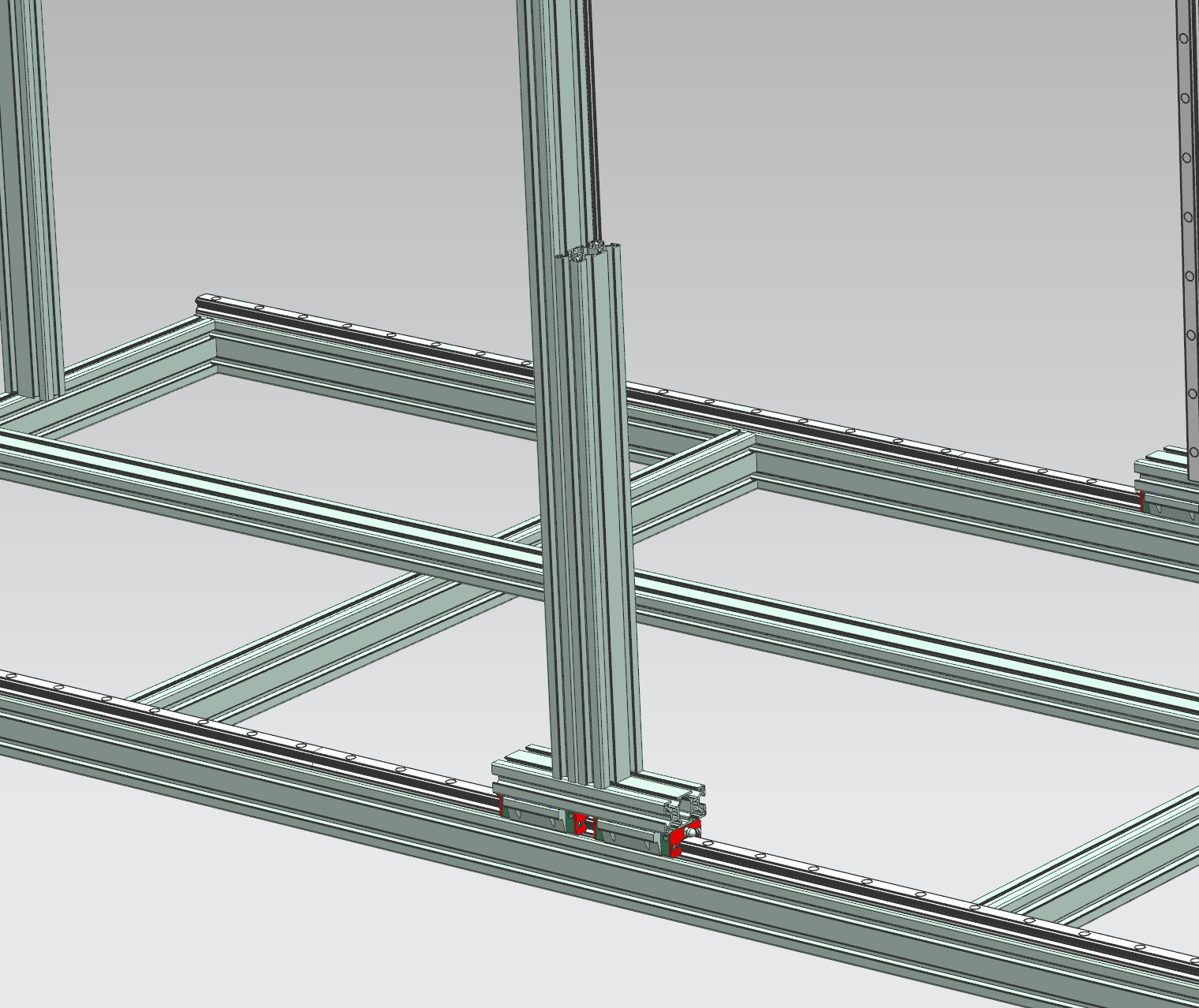

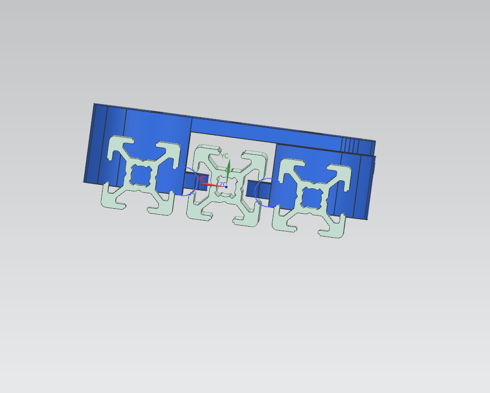

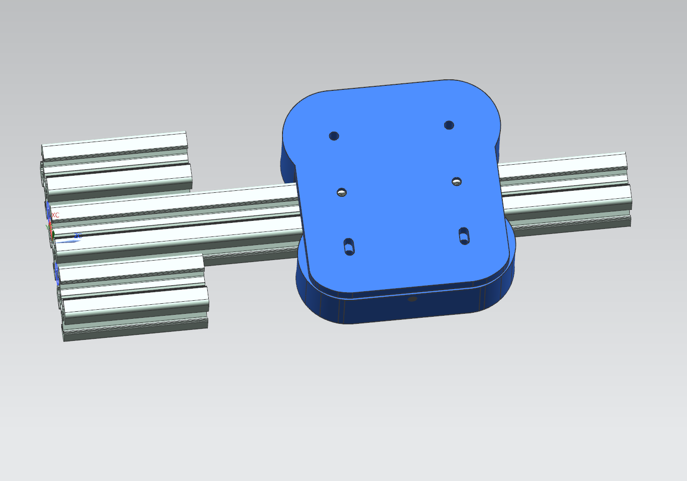

2 Attachment(s)

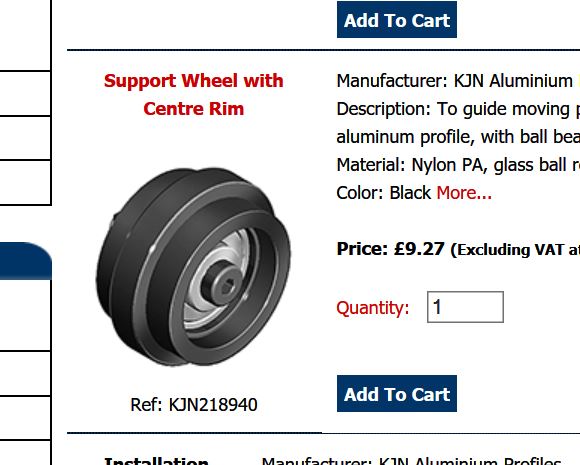

at the moment I'm still going to go for the 80x40 10mm slot kjn aluminium, partly as all the other extrusion I have is 10mm slot so have the jigs and extras to go with it all.
with the 10mm slot I'm leaning towards the 15 or 20mm rails, 12mm doesn't give much to sit on the aluminium.
I have drawn my gantry at 40x80 also but may go for 40x40 on that.
the vertical axis I was thinking would be belt driven however I want to link the two sides together which may be easier if they were screws
I think maybe a lego mock up is neededAttachment 22784Attachment 22785

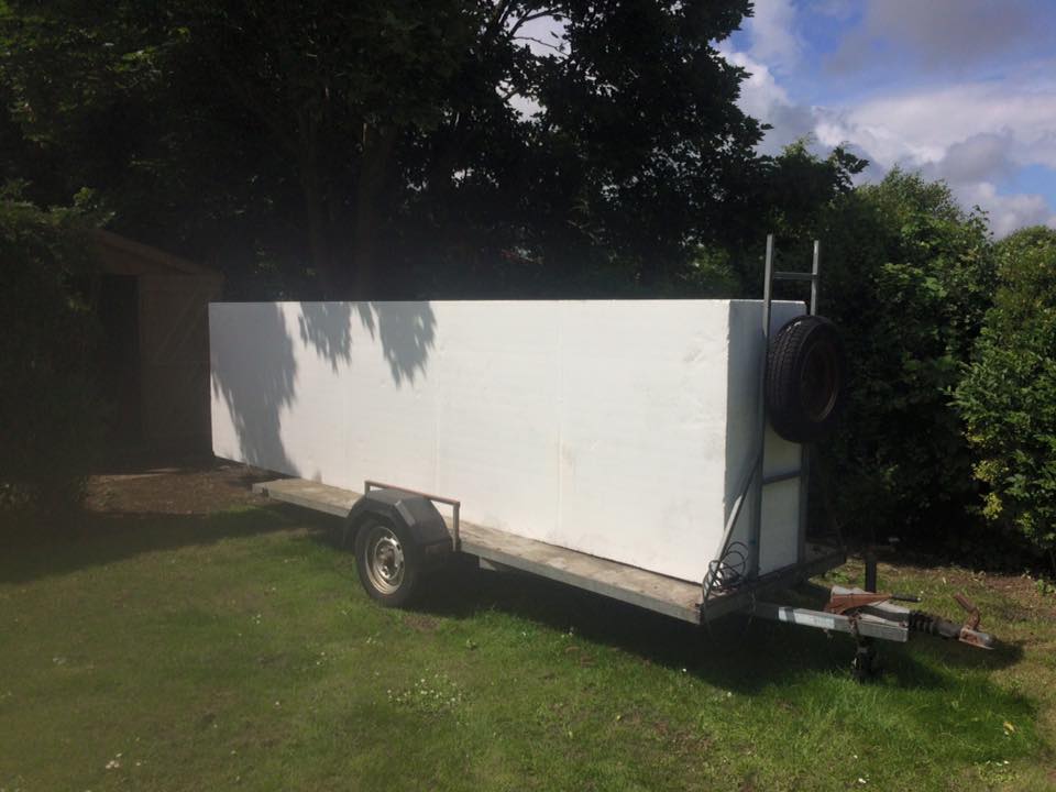

What would you cut at 6meter length? i mean, arent all foam blocks 2mters long?
if i was going to make such a serious machine i would have probably used belt on belt drive which will again simplify things. In that scenario there is no need of very big size belt as the stretch is "none"
the same thing stuff that I cut on my 6m long cnc. The blocks I normally use are 16' x 4' x 2'. belt on belt is a good idea I will just have to figure where is best to place it, it will probably mean that I will need to have one ether side and two separate motors but that shouldn't be too much of a problem. unfortunately I cant see myself being able to join the gantry underneath due to the length and trying to support the frame.Attachment 22786

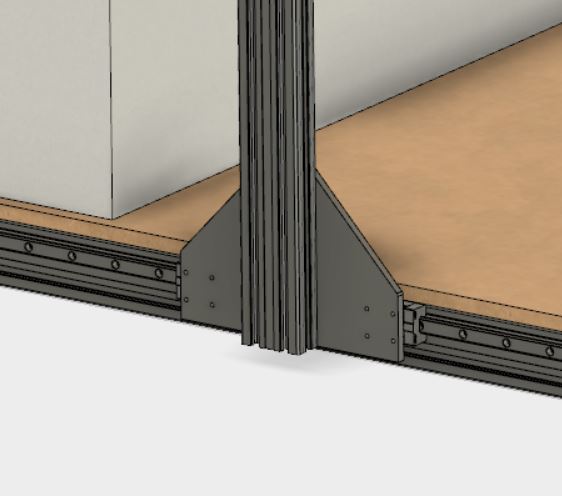

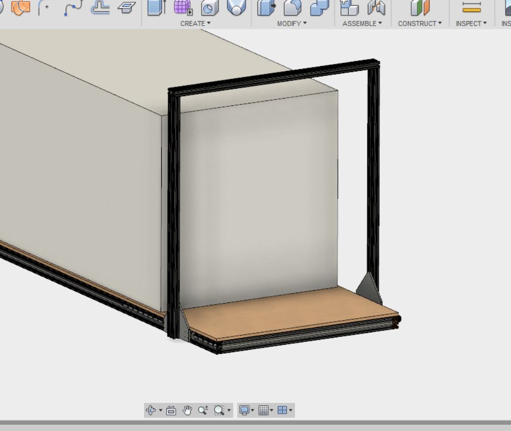

2 Attachment(s)
so I remembered I had this idea a while back but forgot and that was to make it so that in the future I can add cnc and convert to 4 axis. It wont really add anything to the cost of the frame but would require two extra lengths of rail and two more carriages so I will at least do the frame like this from 40x40
Attachment 22801Attachment 22802

I'm thinking maybe these and 3 per side for the main axis and maybe stick with the linear rail for the vertical. It sucks I really hade to cut corners but for the amount it will be used I cant justify 1k on linear rails.
other wise I guess It would be using some sort of bearing carriages to run on some steel guides. like cnc router parts do.
Attachment 22803
Most probably that rollers will not do. Inside there must be angular contact bearing or a bearing with no clearance. I am 99% sure thats not it. Plus they need to be turned, not molded plastic
