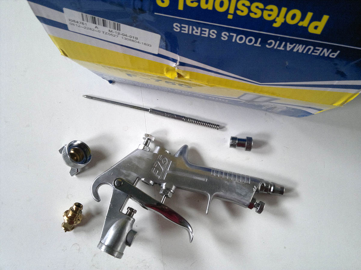

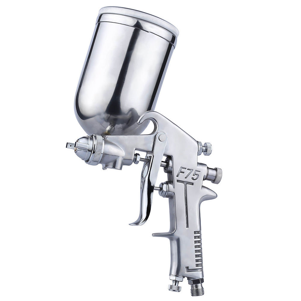

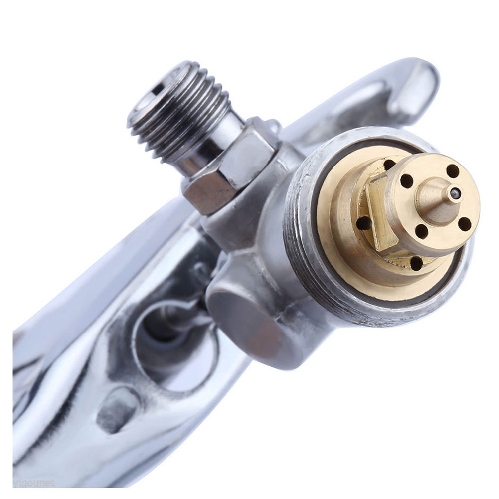

1. F75 spray gun 1.5mm nozzle . Ridiculous 10 euro gun . Ebay number 142241555112
This is my new gun from before a month as i hacked up my 400$$ 3M gun and did not want to spend 60euro on a nozzle. This is the best bang for a buck ever
This spray gun sprays epoxy , polyurethane, water based acrylic, wood lacquer, wood tint. Thick or thin. Its up for a job like spraying a whole machine or even a car or a van. Though its not a big gun with a large deposit. I dont know what the chinese did and who copied, but this thing is a beast.
Attachment 22601 Attachment 22602 Attachment 22603 Attachment 22604

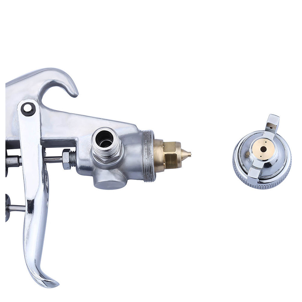

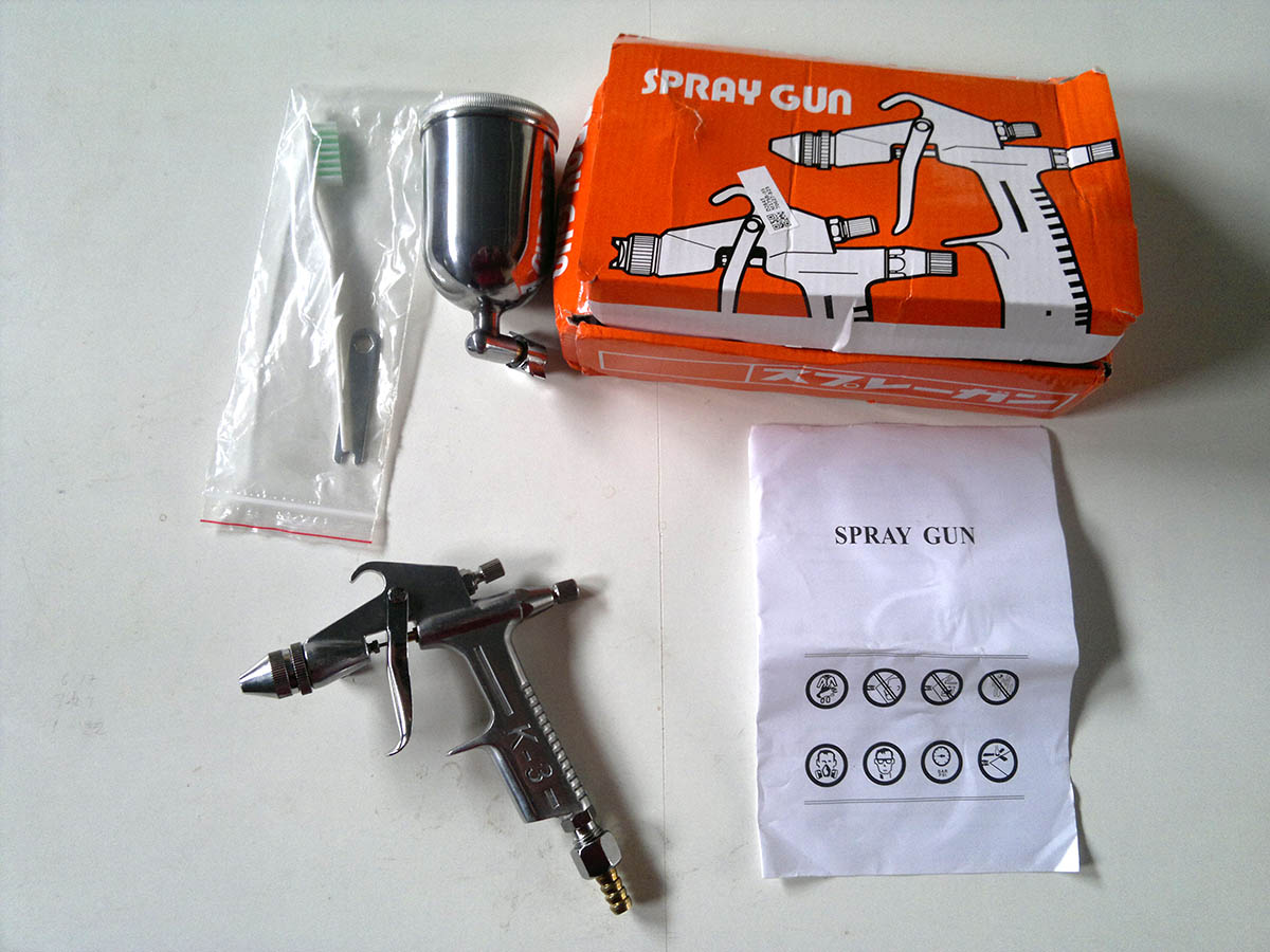

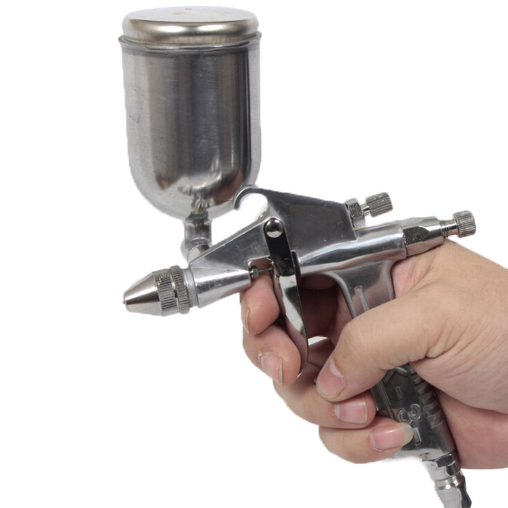

2. 0.5mm K3 spray gun , again 10 euros. Ebay number 311236578956
This is the retouch gun. i have used it a couple of years. this is the paint gun for small objects, details, letters, signage, etc. Where you do not want to spend too much paint
Attachment 22605
As you may note you can use these guns from ANY position spraying up or down vertically. These babies put to shame any other chinese copy for the money and quality, not to speak of that many producers should be ashamed that 10euro gun sprays better than their brand ones.

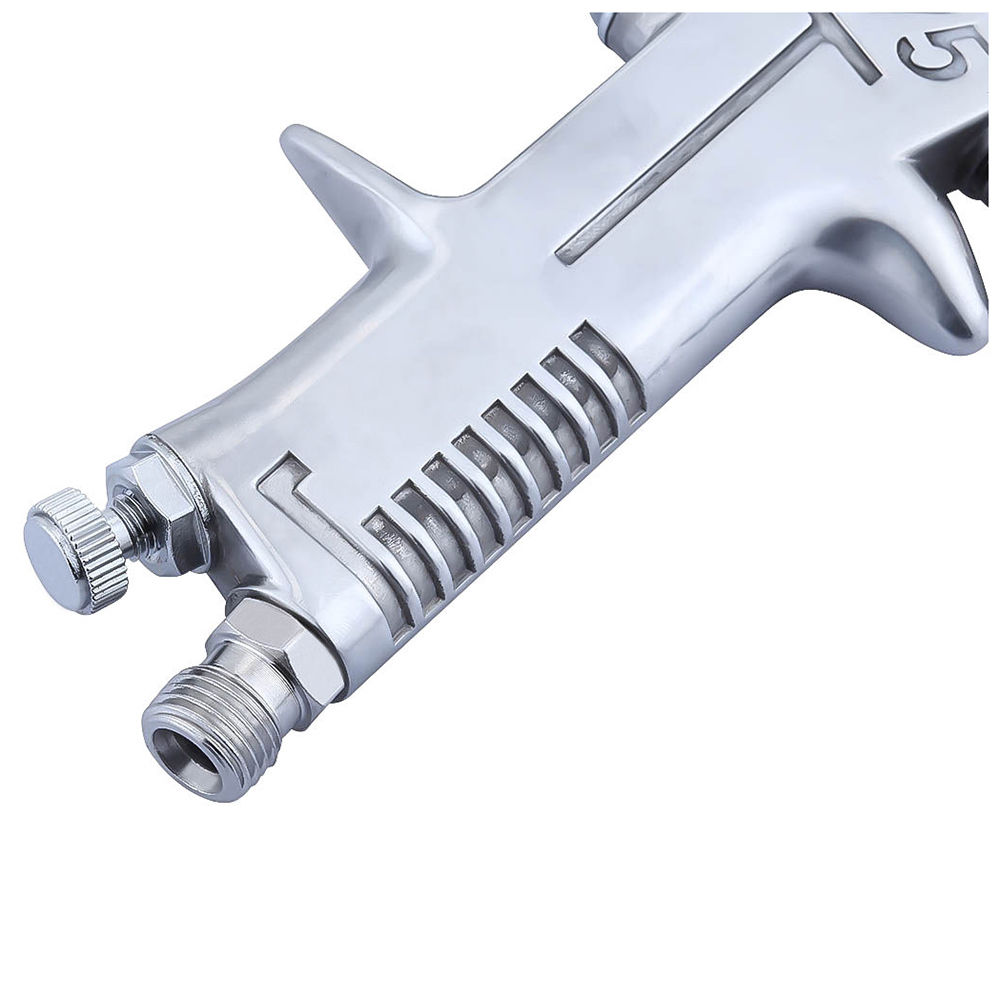

As i am a very practical person, my advice is to buy 2 of each if you are in some fabrication.
And if you are in a serious fabrication or automotive business the choice will be the 3M 16580 Accuspray Spray Gun System with Standard PPS . I have the previous ACCUSPRAY gun and it was the best gun ever. but i refuse to pay 40$ for a nozzle. Sp this new Accuspray gun has plastic nozzles that you use a couple of times and when they clog, just throw them. isnt that great. Nozzles are cheap.
Attachment 22606

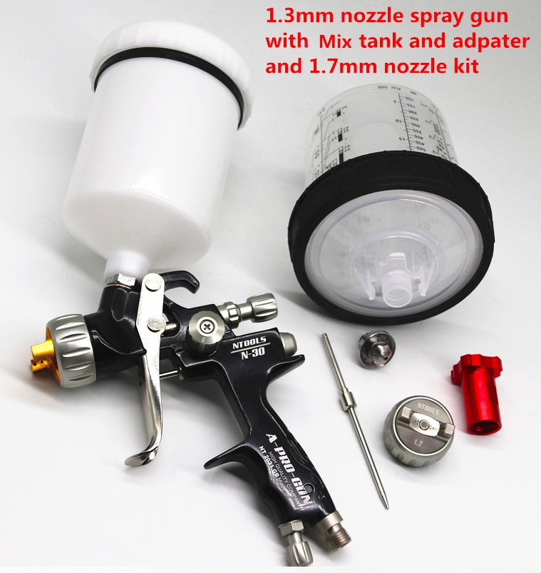

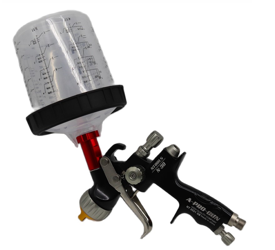

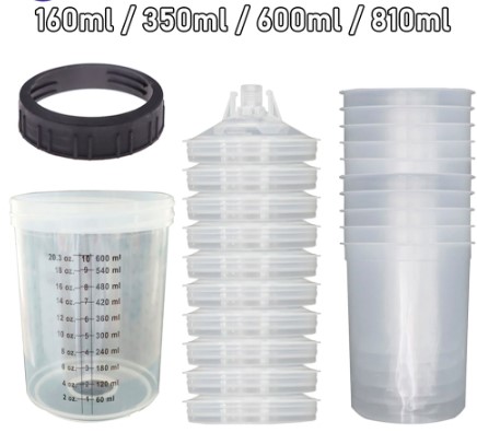

I wanted the gun combo to be cheapest possible and best quality possible :devilish: so here it is:
1.3 and 1.7mm combo kit PPS for 58 euros 2 days shipping straight in Europe from Germany.
PPS means the Gravity vessel has another one with filter inside, so for aprox 1 euro at every painting you dont need to clean anything but the gun, and the paint is filtered and can stay some time in the gun if one does second coat in 15 min or sth. Sold separately the consumables in 165, 400 ,600, 810ml
[Attachment 31760Attachment 31761Attachment 31762

@ Boyan Silyavski,
I totaly disagree with you. These two sprayguns are totaly watse of time and waste of money. To explain in details:
After reading your enthusiastic review, I was stupid enough to forget my "if you pay peanuts, you buy monkeys" and decided to buy both of these Chinese-made spray guns from ebay. Like to hear my pesrsonal review? NONE of them works! Yes, they are good to spray air only or maybe fill cup with water and play a little, but these spray guns are actually useless! Reason? It is IMPOSSIBLE to disassemble them in order to clean them after paint spray.
I DARE you to show us pictures with these cheap Chinese-made "F75" and "K3" spray guns fully disassembled, with needles and nozzles free and ready for clean. To make my point more interesting, I dare to ANYONE who already purchased these cheap HVLP copies, to post pictures presenting the areas shown into following pictures disassembled. Long strory short. Wanna waste money? Buy one of these. I was stupid enough to buy both, because I thought these were a "bargain" as I was fooled by the review. These cheap Chinese-made spray guns are crap.

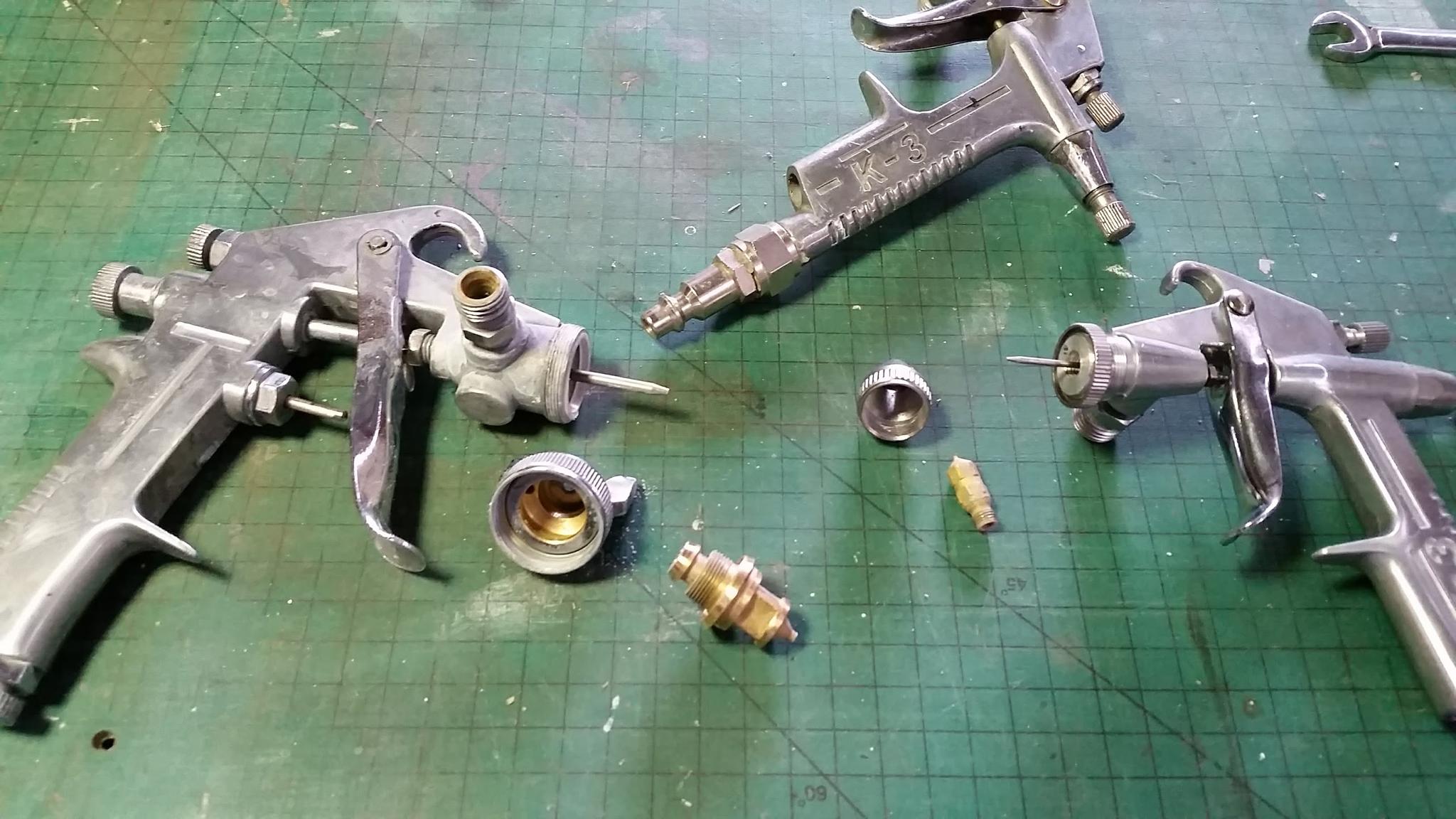

Phill, are you high or sth? "I DARE YOU..." , "It is IMPOSSIBLE to disassemble...". Do you think me for a fool to recommend something in forum which i have not tested at least an year/in fact 3years/. Or you missed to read my other gun is 400euro paint gun, so i have a base to compare.
If i have to explain you how to disassemble a screw, even if its stuck, then this is not the exact place me thinks. Its a CNC forum, not "Fix it at home". Anyway if some people were drinking Coca Cola instead of stronger liquids, they will know the answer, at least for steel screws.
Firts of all you dont need to disasemble the back part to clean the needle. The needle is cleaned when you disassemble the nozzle. In fact you need to do that every couple of times of use, but not always, if you clean the gun using water or the respective thinner, right after use. Fill can with thinner, spray a bit and then with your finger stop air from nozzle. What happens then its bubles start inside the gun and go oput back from ca, that cleans pretty well the needle without dissassembly. Though i always dissassemble when using 2k paint.
I use these guns daily without any problems or need for more expensive guns. Even painted my car with the bigger one. So why dont you take a step back, find a good brand tool like Stanley and unscrew it. With crappy tools there may be a problem if you push too much.
Attachment 23784

@ Boyan Silyavski,
As expected, your pics shows these cheap crap HVLPs without having the needles extracted. For example, the so called "K3" is a cheap copy of the Iwata's HVLP - I guess you already know that. According to instructions, the yellow marked screw need to be extracted in order to release the spring and slide the needle out and clear the way to easily clean the parts. None of this can happen and as far as I see in your picture, you also cannot remove the needle. So, I wonder how you clean the needle... or maybe you dont?
Show the K3 FULLY disassembled! Can you? I bet not! Know why? Because these screws (that should be possible to be extracted) are manufactured by Chinese copy makers as one part fixed on aluminum body.
Long story short? As said before, I was fooled by your enthousiastic review and believed that these cheap crap can do the job. Obviously, they cannot

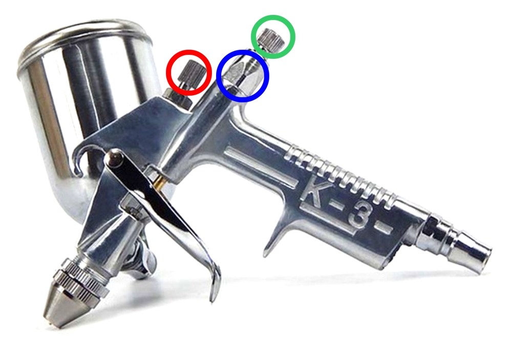

@ cropwell,
This K3 Chinese copy is different. To explain in details (have a look into the attached picture):
- The paint volume is regulated by the screw marked with the RED circle. This screw cannot be fully extracted, but no problem about it, since it does not effect cleaning process.
- The screw marked with the the GREEN circle, only determines how far the trigger can be pulled. For example, you can preset a trigger pull to the middle, in order to achieve a specific paint cone and remain as is. This screw can be fully extracted, but there is no effect to anything else, since the trigger spring is secured by the screw marked into BLUE circle.
- The part marked with the the BLUE circle, guides the needle and secures the trigger spring. Normaly (as happens on genuine Iwata model) this part should be possible to unscrew and release the spring AND the needle by gently pulling back. Unfortunatelly, this part, CANNOT be unscrew because it is part of the aluminum frame. The entire "screw" appearance of the part, is just decorative - not functioning! Therefore, the trigger spring and needle are traped there and cannot be extracted!
I hope the above explanation, can clearly give a picture of the problem.

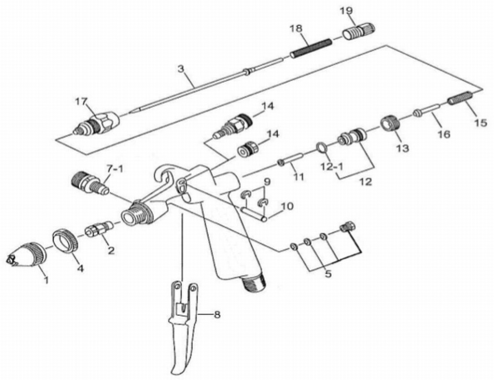

Attachment 23787
Re: Best cheap Spray Paint Guns for DIY CNC builder or small workshop
Philipp
By the way, this is how the spray gun should be disassembled, but I guess that the manufacturers of this Chinese-made piece of crap (previously presented as "the purchase of the Century"), did not bother to think how this tool will be cleaned after use! Typical Chinese-made useless crap for once paint and throw to garbage.

After reading Boyan's post I order both models that he recommended.
Claiming that a brass nozzle cannot be removed from an aluminium body spray gun is hilarious.
Here is what I've got. I haven't used them yet but they look good manufactured for 10$ and 12$.
Attachment 23807
Attachment 23808
Attachment 23809
