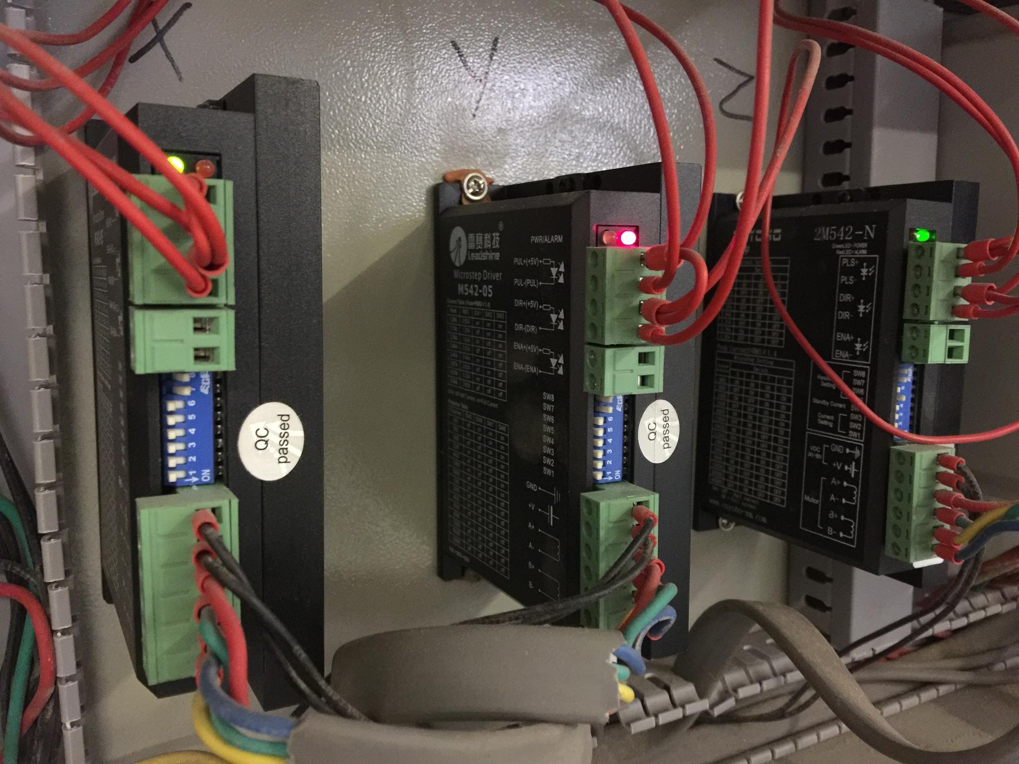

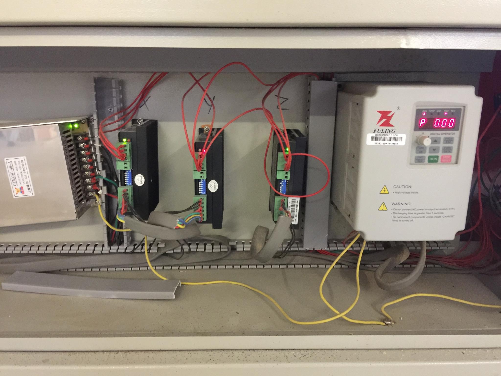

Hello you lot, i'm also a new member based in Portsmouth (i've got a workshop at Trafalgar Wharf) looking to connect with more experienced CNC'ers.
I've got a 2nd hand chinese DM-1212 which is giving me problems with a dead axis. Also want to convert it over to Mach3, so i'd love to pick a few brains!

Hi Will,
What Axis is dead? Did you try swapping the motors or Stepper Driver to see which is causing the fault (if it is either of those).

Cheers the reply Alex! Yeh i've swapped the jumpers from the Y over to the x driver and i get movement on the Y that way. So i've got motion on X,Y,Z motors, just the y-allocated driver is showing a fault and can't drive any of the motors with it.

Cheers Leadhead, should i post up some pics of the drivers? Maybe you could advise on whether i need to replace them with different drivers and board in the pc to get me back to running on Mach3. NCStudio is no fun at all :)

WRandall
Hi Will,
Ok good start, Pics of the drivers would be helpful, do you mean the driver has a flashing Red LED or something when you say it is showing fault?
Not sure what drivers you have, but the AM882 Leadshine drivers i have flash a red LED if any of the vital connections aren't detected / wired incorrectly.

Attachment 23088Attachment 23089
Think there are photos attached now. Sorry, first time uploading photos to the forum.
Curiously, although nothing else has changed, i'm now also getting a Y Limit alarm on NC Studio. The gantry is nowhere near the limit switch, which is a proximity type.
