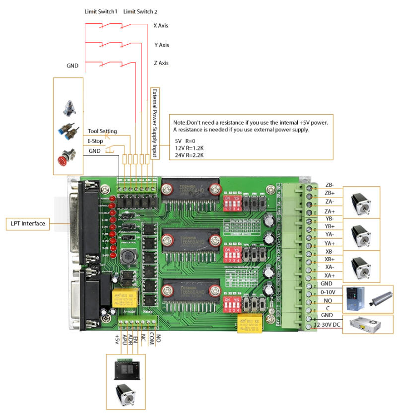

I need help with wiring my cnc6040Z USB 800 Watt machine 3 axis limit switches -->2 per axis in Normally Closed in series to the board mentioned bellow.
My problem is I have JP-3163B ver 3.9 motion controller board,On one side it has these connections--> VCC/XXW/XYW/ZXW and on the other C/NO/0-10V/ GND now please tell me do i need to place the 2 wires per limit switch for eg.for the X axis -->Com and NC wires in the XXW slot and Y axis Com and NC in the XYW and same for the Z axis in the ZXW or only NC wire in each of them and all the COM wires in the VCC slot?
Im so confused ???? plus do I need resisters or is it fine without???? :

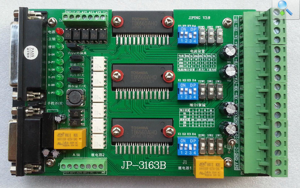

Hi.there I have tried to attached a pic of the actual board I have minus the DB9 which is optional on mine.now i also have [cnc6040z .settings file ] which i can not open and would like to know how to upload on this page it is saying invalid format please tell me how to upload??? I need your help on wiring limit switches and setting exact parameters in mach 3 or 4 demo according to these documents which came with the machine.???
Attachment 22863

now how and where on my jp-3163B v3.9 board i have attached a pic of , will 3 black wires and the 3 red wires be plugged in exactly ???
Also do i have use resisters with my limit switches or not i need full explanation i hope not ?????/??

This is how I would connect the limit switches.
Attachment 22868

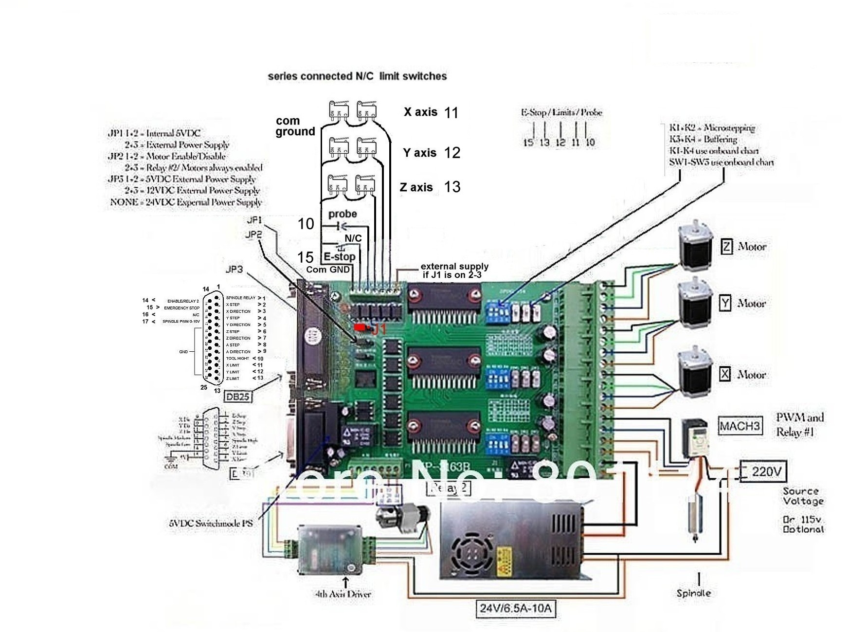

Re: !need Help CNC6040Z USB Limit switch wiring!
I see Eddycurrent beet me to it
while I was adding to one of your pictures
Attachment 22869
with only the link to select either the internal +5v or an external positive suppy for the input opto isolators
but no link to break the ground connection
it looks like you can not take full advantage of the input
opto-isolators
version 2 of limit switch diagram
Attachment 22885

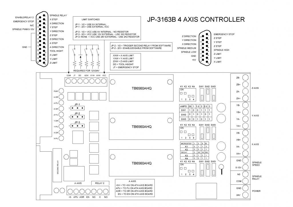

Hi Schematicsman
if you have the jumper J1 set for using the boards +5V supply
you don't need to add any resistors - that's why I removed them from the original diagram
as to how you physically wire the switches it depends on what connectors you have fitted to the control box
very often you find "aviation" connectors are used on Chinese control boxes
the boxes having a number of holes for 4 limit switches and a probe
blanked off by a paper label when the connectors have not been installed
a photo of your box will help
if you fit four 2 pin connectors
then one pin on each connector is connected to the common ground
then printer port pins 10 ,11, 12, 13 can be connected to the remaining connector terminals
pin 15 can go to your E-stop switch
I will add more later when I return home
John

Attachment 22896

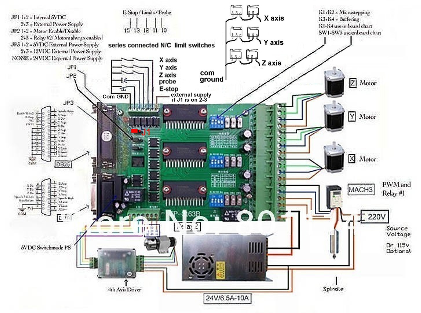

If you are daisy chaining your switches together, ie connecting them in series then they need to be normally closed.
If you look at John's post #11 he shows you the limit switch cables.
as Clive said
wire N/C switches in series
it should be the safer option as the machine will stop if a wire breaks
as this is more likely than a two core cable being short circuited
(although it could happen if a cable is crushed)
the last diagram of post 11 is for 1 axis ,
you will need three pairs of N/C switches for the 3 axis
as mach 3 only homes 1 axis at a time you could connect all 6 switches in series and use just 1 input
Attachment 22903

3 Attachment(s)
now I have seen the photo of your micro switch
I can see why you are confused
on my diagram the N/C contact is shown as the centre terminal
and on your switches the N/C terminal is at the opposite end to the common
Attachment 22907
John
PS
I can not find any details of the board to tell if the unused GND
terminal can be used as an additional Ground / common for your switches
Attachment 22908
you will have to check for continuiy with the switch common terminal
or use an additional terminal block to connect all the common switch wires together to a single wire from the switch common terminal
Attachment 22909
