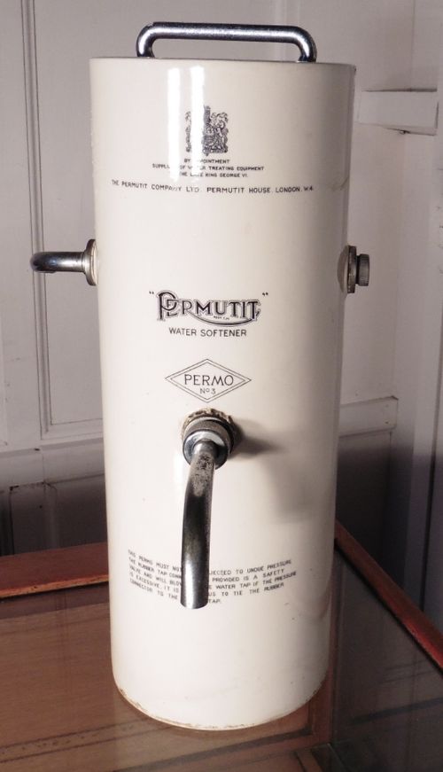

My Gran used to have a water softener (In the '50s) Attachment 23113 and it was regenerated using salt. I wonder if there is any way of reviving spent deionising cartridges in a similar manner. They are both based on ion-exchange resins.
