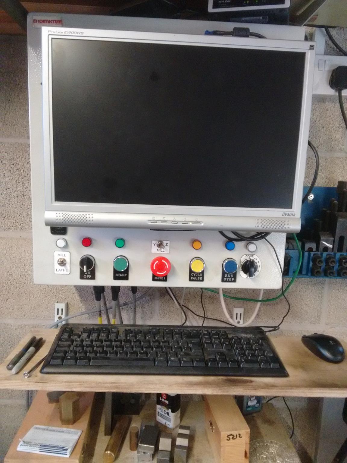

What do you think?
Just a bit wiring needed, then some gaffer tape onto the side of the machine, and I'll be good to go :drunk:
https://farm5.staticflickr.com/4519/...cfcdac3b_c.jpg

I've been umming and arring over the control panel for a while, and having finally finished all the major cabinet wiring and programming last week, it has reached the top of my roundtuit list.
While contemplating button/dial placement, I happened to notice the box which was about the size I had in my head. So after rounding up all the bits, I got the scissors out tonight. I was going to put the axis/step size select switches above the MPG, but having tested the layout, I felt the MPG would be too easy to knock while working the switches, which is why all that seems a bit bunched up.
I'm going to put a handle along below the buttons, so I can rest my hand on it while working the MPG.
Next step is modelling it in Fusion.
You'll be needing the Mach Tavish plug-in Dr Finlay !
I'm actually surprised to read this thread here and now - I'm in the process of replacing a panel on the starmill that had a single E-Stop button with one with a full axis/mpg and DRO indicators, and just last night started learning F360 and mocking up the panel.
I might nick the alternative E-Stop label, though
Doddy, I've done various sketches for control panels, but I really wanted to test the layout, as that's the only way you can get a proper feel for how it'll work.
Like the MPG/selector switch thing. The selector switches above makes sense from a visibility view, as it means their labels would be more visible, however as I mentioned, trying them with the mock-up, it felt like I had to make an effort to lift my hand up, over and clear of the MPG to move them to avoid using the MPG itself as a steady for my hand.
This will be getting coupled with just a touchscreen. I will have USB ports on the housing should I want to connect a keyboard/mouse, however I've got no plan to have them permanently connected, as I'm aiming for most things to be done via the touchscreen, with only physical buttons for critical functions.
I am currently considering not even having the axis/step size select switches, as I've seen a way of adding that functionality to a touchscreen in a way that I think will work well (the new screen designer for KMotionCNC has opened up a lot of options!). If it works, it will save me a good bit of fiddly wiring, as the connectors on the selector switches have to be soldered, with a terminal for each position you want to use.

The key thing with touchscreens, is stick to resistive screens as they rely on surface pressure, so are not affected by contamination like capacitive screens are. Resistive is generally not as accurate though, so you need to have the ability to have reasonably sized buttons.
Mistakes are part of the fun, however experience has taught to me try and make them in the cheapest/easiest way possible..
I tend to do mine in CAD to get a feel however this works well. I'm right handed, so Id place the MPG on the right. Here is a mockup of Thor's panel. Ive since bought a Shuttle Contour controller which works well as my MPG seems not to want to work on 5V, so kinda abandoning this for now.
Attachment 23208
I didn't see if the box was fixed somewhere or if it was portable. The reason I mention that is because any time I use the MPG wheel, it means getting my eye right up to the spindle to see what's going on, so being portable is a must for me.
I did briefly think about going the pendant route, however with this machine, I can stand at the spindle and still reach the control panel, so there's not really any benefit.
If it was something like a big bed router/plasma cutter, I'd use a pendant.
