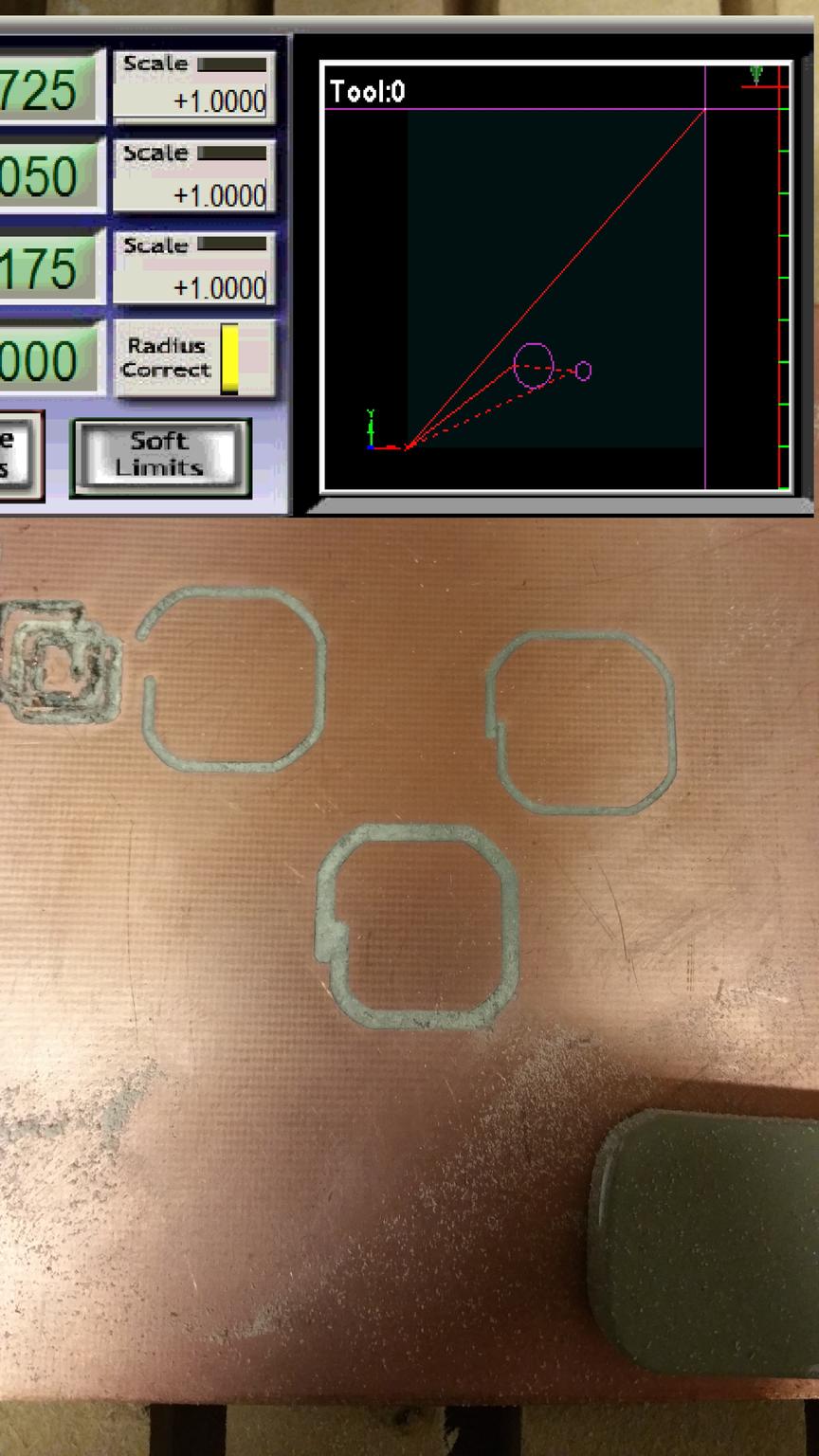

I have no idea whats going on here guys.
My china 3040 does not want to cut out circles.
I used aspire to generate the gcode and the circles come out as shown in the pic. The cnc doesnt seem to follow the line back to the start.
Any ideas or suggestions to troubleshoot this would be appreciated.

Others will have more experience here, but have you tried a simple square?
Things I'm thinking - superficially, at least, it looks like you might be losing steps in the x-axis, but I don't know/can't rule out if aspire has a mach3 post-processor and/or if arcs could be causing an issue?, If you repeat the test with a simple 40x40mm square then at least you can start to understand if you're losing steps due to acceleration or max feed rate. When calibrating my machine I usually run a 40mm square with diagonals routed as well (a X in a box) just to get a visual on linearity, etc.

The project itself does have a rectangle section that it did cut out fine it's just not in the shot.
I also recently ran staight grid cuts that appeared to work ok.
If you have some gcode I could try in mach3 that's not dine in aspire that would be helpful. The circle is suppose to be 8mm in diameter.

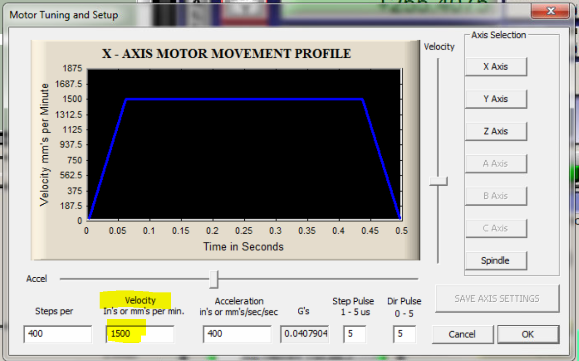

Improvement with your mach3 settings. Not perfect but that may be the cutter i am using.

How am i not helping myself. I ran his code but i still had issues so that.
Once i changed the acceleration the circle cut improved. it was set to 2000 but reducing it to 1500 improved the circle.

i did say the acceleration was 2000 but now i set it to 1500 which has improved it. What i meant was i changed velocity.

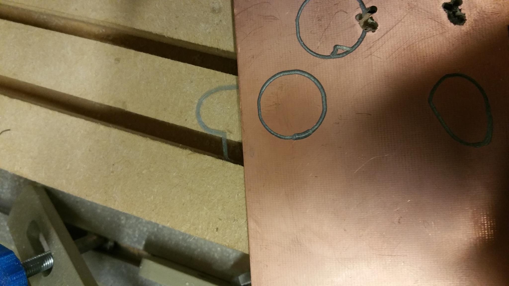

Yes I zeroed the top.
The z seems to move up the further it gets into the job.
This is on some scrap pcb board. https://uploads.tapatalk-cdn.com/201...a6d16139bb.jpg

Or the bed is going down. Have you levelled the bed and skimmed the top off?

Re: Profile Circle on 3040
dfox1787
...or...
...the PCB is not fixed to the table. - Are you using double sided tape over the whole surface of the PCB?
...the PCB is not flat enough. - Measured over the whole area with a caliper?
...the PCB is not even in thickness. - Checked for variations with a caliper?
...the table is not levelled.
...the X is not levelled to the table surface and is tilting the Z.
PCB is not the optimal for this sort of tests but many things can be wrong. Work with the G-code given to you, once you can mill a square you can move on to making other things, but don't jump from one to the other type of code. Personally I think you have alignment issues somewhere. You have to align everything mechanically as good as possible, measure every angle BEFORE surfacing the table. The surfacing is the last moment, when everything else is as good as it can be.
When making PCB it is important that you fix the PCB over the whole area to eliminate warping or bending. At least if it is a large piece and if the PCB is low quality.

Sorry for the delay on this i ended up go away for a few days for work.
I changed my mach3 settings to the same as Kevs and it machined fine this time round.
