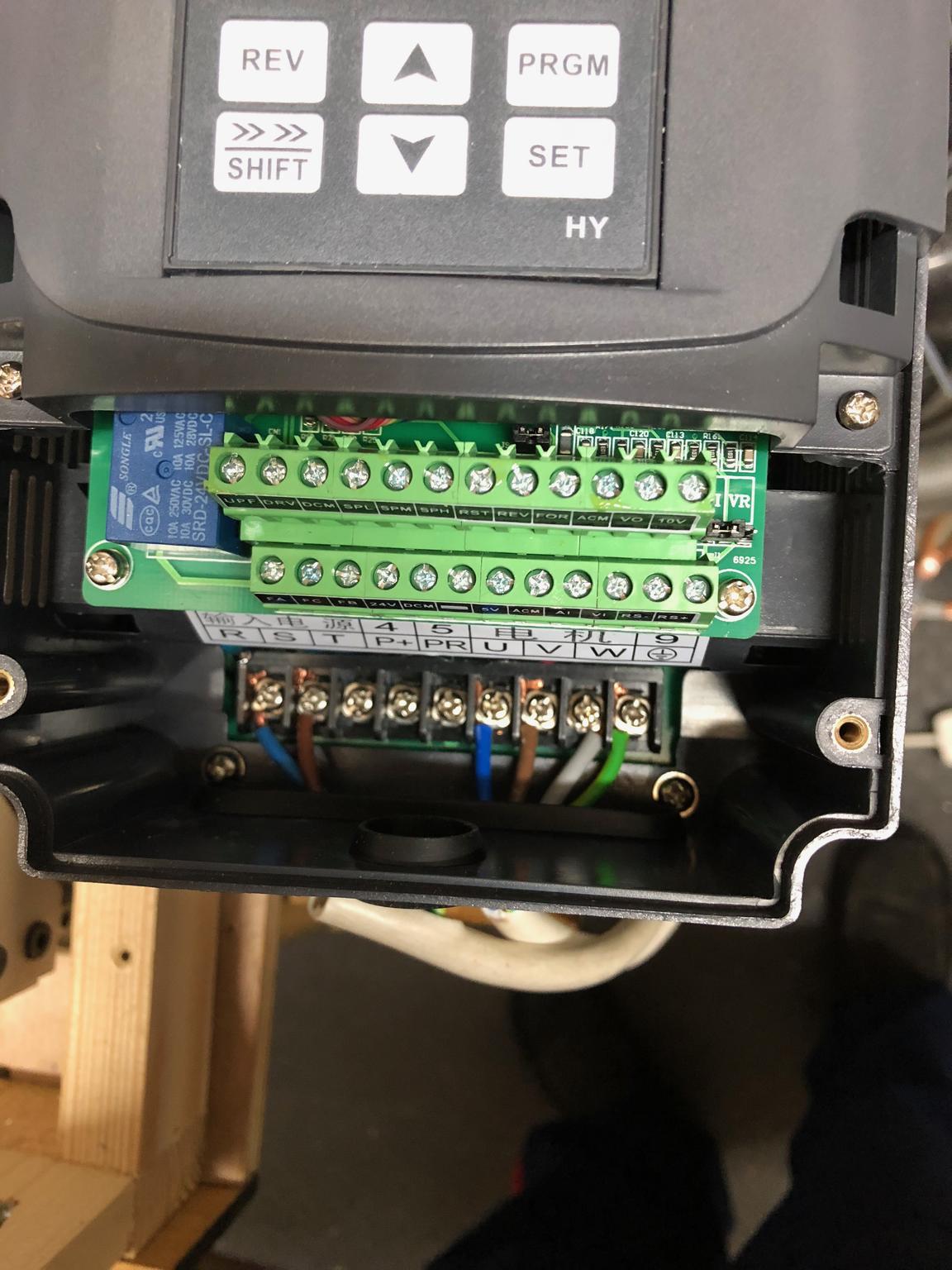

After trawling through countless online videos and documents to wire up the Huanyang 2.2kw VFD I was finally confident enough to get the wiring correct. Taking the plunge I got all the wires in the order depicted in the many documents.
Plugged in and switched on. After what appeared to be a lifetime waiting the inverter kicked into life.
My next step was to get the programming out of the way, this also was successful. Pressed run and the spindle started turning.
Now this is where it all went wrong. I wanted to see how fast the spindle was turning and pressed >> button a few times might and various modes were selected. I considered that I had changed the programming somehow since i had, had it running.
My only course of action was to start again. When I had completed the program inputs. I switched the unit back on and "Bang" all the power went off in my workshop and smoke pored from the unit.
Now prior to the spindle working okay and me attempting to fix things via programming I was pressing the Run btn, the spindle behaved strangely to this in that it would sort of chug round a couple of times the unit went into error.
Could the spindle have been at fault, if so how could i test it without an inverter? Is it possible to sick a 13amp plug on it and connect it to an outlet?
Don't want to get another inverter and blow that up due to a faulty spindle.
And all I wanted to do was to see the RPM and my next step would have been how to adjust the speed.
NO
I may be wrong - but - I do not see how it is possible to blow up an inverter by parameter setting. (This is an invite to members to point out otherwise:dread:)
The first test of your spindle should be with a multimeter before connecting to the VFD. If there are four wires one should (but not necessarily) give earth continuity to the case of the spindle. the other three should give approx the same resistance reading between any two pairs*. These tests are done at the VFD end before connecting the wires.
Shorted wires will cause currents large enough to blow the output gate transistors and give the grand illusion of failure with a large amount of magic smoke.
Open circuits can give voltages in the output stages of the inverter enough to do the same.
Your inverter may be repairable, but repair costs will be as near to replacement cost as to make it not worthwhile.
DON'T take your inverter to pieces - you will lose any chance of a warranty claim.

wiring diagram ? or did you just connect the power in and motor without adding any control wiring ?
Re: Just blown up my inverter
240v Inverter
Blue to R
Brown to S
Earth to Earth
spindle
Using normal 13amp extension cable
Blue to U
Brown to V
Yel/grn to W
A proper diagram is essential, for your own sake too, but it seems you don't have one.
So just to be clear, you connected the spindle cable cores to UVW at the inverter, and where did you connect the other ends at the spindle itself ?. (I don't have one of these spindles so I'm not sure what terminals are provided) Did you use any of the cores as an earth wire ?
No I never used an earth, the plug has 4 connectors and one of them is left empty (No 4)
My soldering is NOT the best in the world and I'm wondering if there was a short in the plug on the spindle. I didn't see anything when I took it apart could that have caused the damage if it had shorted?

"No I never used an earth, the plug has 4 connectors and one of them is left empty (No 4) "
That sounds good and correct.
Pin 1 Phase 1
Pin 2 Phase 2
Pin 3 Phase 3
Pin 4 Not Connected
The spindle needs checking out as cropwell explained.
Regarding parameters I would change these.(when you get the new vfd)
PD014 acceleration time, 1 second is too short in my view, 5 seconds sounds better especially in the early stages of setting up.
PD015 decceleration time, same as above set to 5
PD142 motor rated current, set this to current specified for the spindle, I looked at some and the correct figure seems to be 8.5
PD143 motor poles, I don't know myself how many poles these spindles have but if people are using a value of 2 then it seems reasonable.
PD001 set this to 0 if you are using the keypad controls.
I'm wondering if you have reversed the motor several times without realising it from the front panel buttons, with ramp times of 1 second this may have caused some damage.
As you say, a short at the spindle end would not do the vfd much good.

A good photo of the wiring and spindle plug would help, was the plug connected securely as a loose connection can be bad for the vfd.
I take it you meant (not the best) as a dry joint could also cause problems.

Don't mess with it, return it as faulty!
A decent VFD will detect an incorrect load, be it short or one or more disconnected phase (some detect open circuit but not all) and simply refuse to drive it with an appropriate error code rather than emit Magic Smoke!.
You shouldn't be able to bugger a VFD even by shorting the output, it should detect current overload, shut down and give you a meaningful error.
It's a bad 'un, send it back and buy something decent!

To be honest I think it was a bit of both. I have placed an order for a new VFD and spindle, and have ordered 2 additional plugs so I can get the soldering right on my next attempt.

Just wired up the new VFD and changed the programming as before.
When I press "Run|" the spindle turns for about 2sec then I get an E.ora message and the spindle stops, any ideas? Seems I have been here before.

Are you using the same spindle? Have you rewired the Plug on the spindle. What parameters have you changed?
Which vfd did you get as there are a few types? Pictures would help.

I'm using the new spindle.
I have now got it working without error. I changed back some of the settings I had changed earlier. now it runs full pelt without error.
Just to to understand now how to display RPM and how to drop the speed?

Hi Clive
Thanks again. I set the parameters as before using the same document I posted here in a previous post. I had also been in contact with the supplier. I have viewed a number of different YouTube videos some I thought were conflicting information.
My current position is that I have the spindle up and running and fixed to 12000 RPM, seems this speed is okay for most cutters?
I now know how to change the speed by setting the Hz. I have seen that some of you have fitted a Pod. Think I'll steer away from that for the moment, else I know what my next post will be on here.
So long story short I now have it working.
I have to install some sort of cooling setup, pump ordered just got to wait for it to arrive. In the mean time I use it for ruining perfectly good pieces of timber.

Re the speed fixed to 12K what hz does it show as you might not have the motor poles set right it is either two or four I think it is pd143 set it to two
also as Eddy has pointed out pd14 ad pd15 need to be set to about 5 seconds
200Hz is what the spindle reads at 12k.
I have made the changes you suggested in your post.
