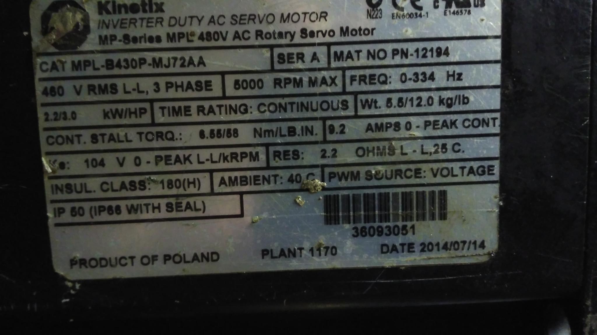

Ah! In post #1 you said you have two AB servos without the drivers
Re: Beaver Knee mill conversion- by a newbie
Oh yes I have those two but I got no wiring or controllers with them, so they are on the shelf in the workshop.Attachment 23538 this is a picture of the label.

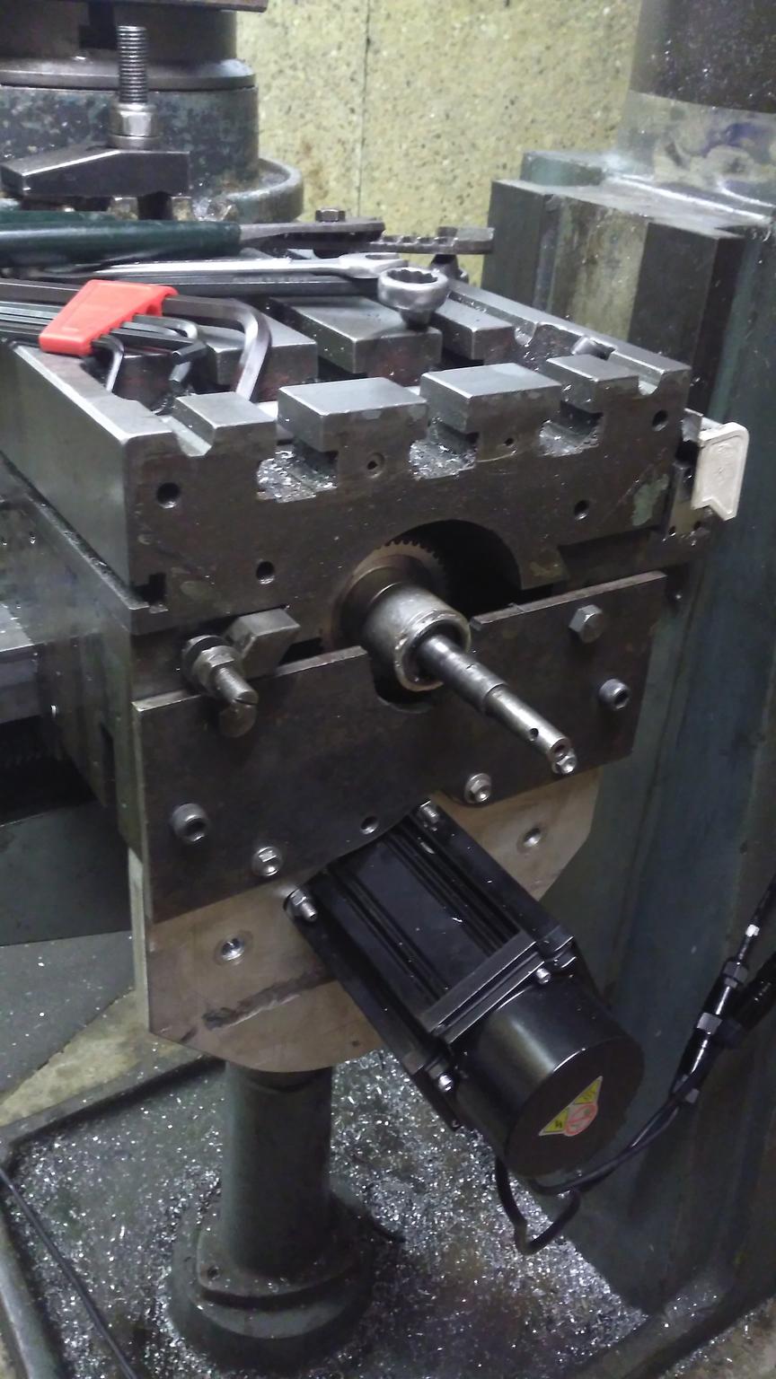

OK, thanks for your help, looks like I have some studying to do.
I have the X axis mounted and working. i set it up using the settings menu,set steps per unit. My mill has its own DRO, so I used that to help me config steps per.
Attachment 23736
Bit of a bodge, but I was not sure it would work, i will make new plates for the X and Y once i have it working.
The backlash is massive at the moment so I will have to adjust that, before I use the machine in anger.
Attachment 23737

The oscillation is because the drive is struggling to settle and find position the drive then faults because couldn't find position fast eneough. you'll need to play with Gain(PID) settings in the drive. But first I'd check your table is moving freely and the Jibs etc are not too tight.
Also you cannot set the PID settings or rather tune the motors on the bench. To do this correctly must be on the machine and working exactly as would in use. By that I mean with all guards, vise's etc permanently on machine while in use so can tune to weight your shifting.

Yes often the case on old Iron. Many people try to tune there way out of sloppy machines but all there doing is stressing motors/drives when good strip down/clean and setup is all that's required.
Wouldn't mess around with any PID settings until you have done this and took as much backlash out as possible.

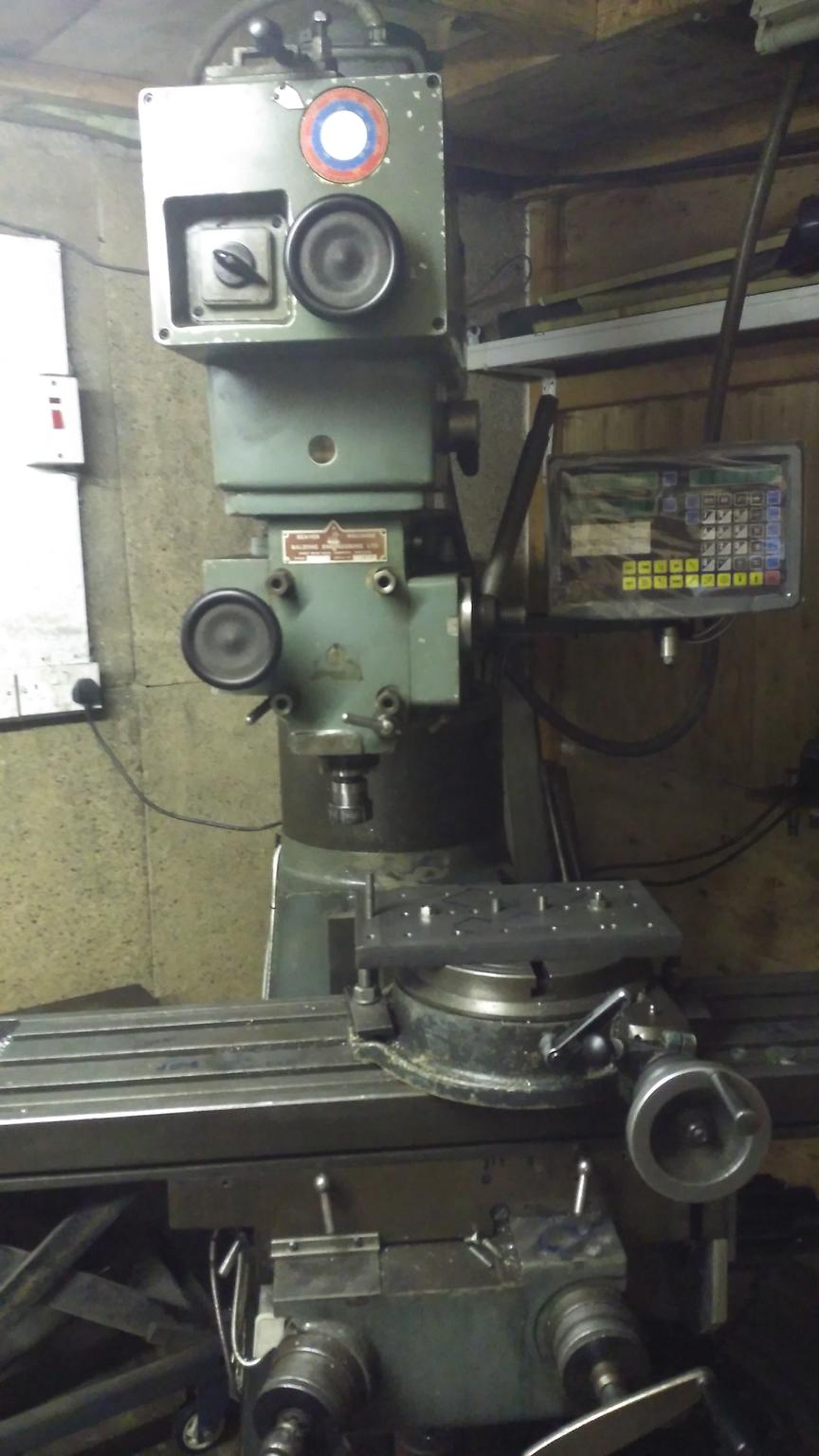

Just installed a tachometer. And it looks like the speeds were out.Attachment 23738
Attachment 23738
You'll probably find somebody has had it apart at some point, and not realigned the gauge correctly.
I put paint marker on the rack before I started and put it back on where it came off. So it was probably wrong to start with.
I was so giddy about the tach working I never thought about that.
Thanks for your help m_c. Looks like I will have to separate it again.
