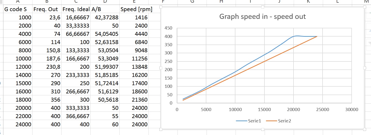

Hello. I bought a cnc 6040, 2.2KW on aliexpress from Chinacnczone.
The cnc works well enough only that I have a problem.
The spindle speed is about 20% greater than the one set as shown in the following graph:
s1000 -> 23.60
s2000 -> 40
s4000 -> 74
s6000 -> 114
s8000 -> 150.80
S10000 -> 187.60
S12000 -> 230.80
S14000 -> 270
S15000 -> 290
S16000 -> 309.6-310
S18000 -> 356
S20000 -> 400
Attachment 23549
It should go to 400Hz when I set s24000 and not with s20000.

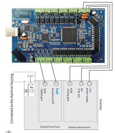

I opened the controller and found that they connected the output of the inverter (Nowforever D100S2R2B) that is 12v to a board input (MKS-V-V02 www.cdxhctech.com) that instead expects10v, as shown in the following scheme.
Attachment 23550
How can I solve the problem? Where to get 10v?
Thank you.

One for the electronic experts - would a pair of resistors in series across the 12V output with values chosen to give 10V at the centre tap point work? All outputs would be 10/12 ths of the input so it would track all intermediate speeds ? If so just 2 cheap components required
Re: 12v --> 10v Nowforever D100S2R2B inverter & MKS-V-V02 CDXHCTECH board
routercnc
That's a classic Voltage Divider and Yes, it will work provided your circuit can carry enough current to deliver the signal current required (V=IR)
Do the maths in combination with the input impedance data from the controller manual.
Remember that sourcing any current from a simple resistor based Voltage Divider will skew the output, you need to know the input impedance and available current to work out the values which will safely give the best result.
Hence my suggestion of an Op Amp circuit with fractional gain.
- Nick
Okay, had a quick look at the data sheets for both the inverter and the controller. OP is quite correct - the controller expects to be supplied a 10V supply from (e.g.) inverter, and will presumably generate a 0-Vref for the spindle speed. What is needed is to reduce the 12V reference voltage to 10V. A simple way to do this would be to place 3 silicon diodes in series with the 12V output from the spindle.
+12 -------->|------>|------>|------------- +10V In
Diodes 1N4001, or similar would be good enough and cost pennies each.
You could put a LM317 regulator inline - with 2V difference between Vin and Vout, it should manage well enough, but it's probably a sledgehammer to crack a nut.
There is also a AO1 analogue output on the inverter, range 0-10V, but I can't figure out a way to use this to generate a constant 10V output.
I would go for the diode solution as well. Even if you buy from Maplin, they're still cheap enough and it's a better solution than resistors. Tweak the calibration as also suggested here (if needed - give or take a few per cent, spindle speed isn't that important) and job's done.

The reason I suggested changing the parameters is this;
The manual for a Nowforever E100 shows that it uses 12v for the 0-10 input.
The graph shown in the first post of this thread shows that speed error gets worse as the frequency increases.
It suggests to me that the upper frequency setting should be adjusted so that at maximum input voltage to Analogue Input 1, the frequency was such that spindle speed was correct.

My interpretation of the E100 manual is that - yes - it provides a 12V supply to the speed controller but that the AI1 input still remains expecting a value from 0-10V from 0-100% RPM. That's pretty much backed off with the graph that the OP provided (full RPM at 20000dmd/24000full x 12V(ref) = 10V). Reading the manual the value for the AI1 input is programmable from 0..10V, but not beyond. There is a gain setting that can be applied also, but I'd expect, again, that requires that the AI1 input is limited to 10V. My concern is that the response to the AI1 input will be limited at 10V, and so no amount of scaling applied by the controller in the VFD would counter this.
What you say is correct but;
1. Regardless, the vfd diagram does show the input connected to 12v
2. I never intended that the parameter should go beyond 10v because that is obvioulsy it's limit set in the firmware, my intention was to set it so that whatever was output from Mach3 e.g. S20000 actually produced 20k RPM at the spindle.

No it doesn't. Read my post - it's reducing the Vref voltage from 12V to 10V. The controller's charge-pump will then generate a voltage proportional to the M-S ratio of the demand vs Vref - from 0v to 10v.
It is a functional solution.
I didn't think the OP had a "pot" - if he did, then the solution would be to introduce a positive-side static resistance, e.g. 2k on top of a 10k pot, which would give a sufficient offset from the 12V reference voltage. But that's not the design case here.
Re. the chop-off. Nope, what you have interpreted is the insertion of the diode chain into the Ain1 input, that's not what I posted.
The BoB requires a 10V ref input. The implementation is flawed by driving that with a 12V reference.
