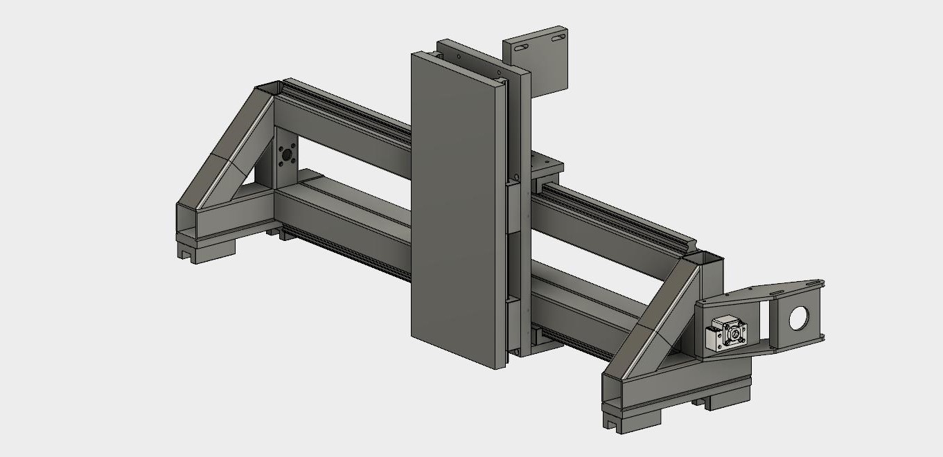

Attachment 23609

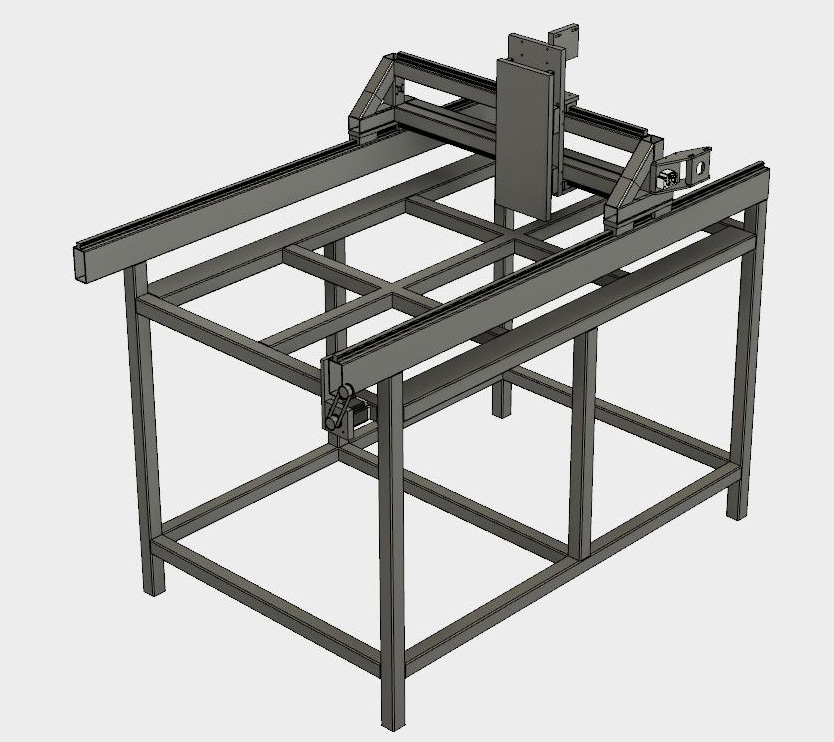

Although I did a lot of the design in Fusion 360, this was more to work out overall dimensions and some of the details which is why the drawing has some odd little items (motor mounts, for example) but no ballscrews shown.
Attachment 23610
The photograph was taken during construction but you can see the bracing in place.
The structure is steel box. Most is 50x50x3 although you can see that there are some 100x50x3 sections supporting the side of the bed and the X rails to give extra stiffness for relatively little extra weight. Reading this forum, there seems to be a general view that anything less than 4mm wall thickness is needed, and 5mm might be better. I have not yet found 3mm to be a problem with one exception – it is not thick enough to take the M5 capscrews holding down the profile rails, or for similar attachment screws elsewhere.
An unusual feature (not unique so I’m making no claims here but I don’t remember seeing one described at the time I started my design) is the welded steel gantry. People worry about gantry mass and how it might affect performance. When I did the sums, I reckoned that the rotational inertia of the ballscrews was at least as important, if not more so, than the inertia of the gantry when it came to acceleration/deceleration (which is what often matters most – inertia isn’t very relevant to speed) even with the steel gantry. With suitable bracing it could be pretty strong even though I was using my 3mm wall thickness box. This design also meant that I could run the ballscrews through the uprights at the ends of the gantry which solved a lot of design issues. More about all this later.

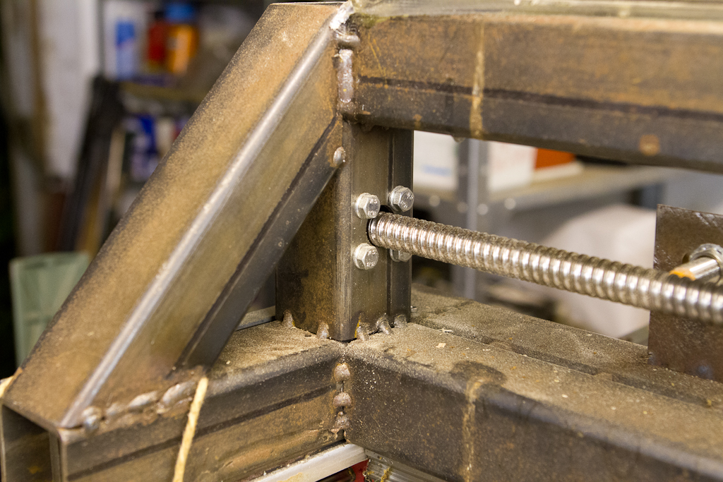

As described in the intro, I used 3mm wall thickness box section steel throughout for frame and gantry, with a mix of 50x50 and 100x50. The frame is pretty straightforward. I found that steel has one brilliant advantage over aluminium extrusion – it is remarkably forgiving. The combination of angle grinder and MIG welder (I’m not clever enough for or could justify TIG) means that building the frame is not difficult, and in particular those two tools will also deal with the odd mistake. Chop and reweld to your heart’s content. What I did realise, after the event, is that I should have spent a lot more time jigging and clamping and aligning before welding. Obvious to the more experienced out there, not so obvious at the time to a beginner with a welding torch. Close scrutiny of any of the welds will indicate my lack of ability, but fortunately it seems that a strong enough weld does not have to look pretty. In many cases, I welded as a series of “spots” as I had found that there was more tendency for things to move if I made continuous welds, and what I have done is probably good enough.
3mm is too thin to take a decent tapped hole for fittings, especially for things like M5 cap screws to hold down the Hiwin rails. I have used the same idea as other people, therefore, and fitted a steel strip inside the relevant box sections to provide added thickness for tapped holes. To keep tapped holes square, I used the old toolmakers’ trick of turning up a short mild steel cylinder, maybe 20mm long, ends faced square, with a hole up the middle a close but not binding fit on the tap. Hold guide to the work and turn tap with other hand. Very easy to make, very easy to use, does a good job. And use spiral-point taps for these kinds of through-holes – enormously better than conventional hand-taps for this kind of work. Mine were cheap from China but stood up well enough to this steel with a bit of tapping compound, even when I was turning them with a cordless drill. I “marked out” the hole positions by clamping the rails in place and then using a cordless drill with a drill bit that was a close fit in the rail’s mounting hole to make a small mark in the steel. You can then swap to the correct tapping size drill which will pick up the mark and drill a hole where you want and not where the drill point drifts to. Using M5 cap screws in the rails gives just a little bit of wiggle room for final alignment as long as you were fairly accurate to start with.
Note that the additional short vertical braces (see photograph in previous post) which take loads from the main rail supports to just above the diagonal braces are not shown on the original drawing. These were added as a result of a sophisticated deformation analysis. I clamped a DTI to the bed structure and measured the deflection when I put my weight on the middle of the (unsupported) X rail. From memory, I think the bend was around 0.25mm which seemed a bit too much. So I added the extra supports and the deflection was very much reduced. Again, I forget the numbers but I think it was around 0.05mm. Gut feel said that this was better, and good enough.

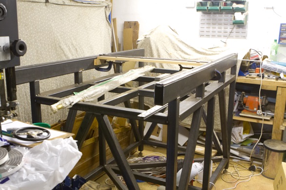

Of all the things that are important with a home-built machine like this, the most important has to be, “If you can’t build it accurately, make it adjustable!” I knew that I was not going to be able to keep the “feet” of the gantry accurately aligned due to welding distortion (I should have done better – see comment about jigging and clamping) but the machine design allowed for that. The X Hiwin carriages bolt to a flat 12mm aluminium plate. The gantry feet - lengths of 50x50x3 - bolt into tapped holes in those plates via a set of holes just inside the ends of the feet. However, the feet were not truly horizontal, as expected. I therefore made up a thick epoxy paste, smeared a good layer on each plate, covered it with a sheet of Cling film, and gently placed the gantry on top. Excess epoxy oozed out and was removed, and the whole thing left to cure. Once cured, I lifted the gantry clear, removed the epoxy from over the tapped holes (a small square of sellotape over the hole ensures that the threads stay clear), and the gantry then dropped neatly back on to its prepared bed with no wobble. As I said, allow for inaccurate build! The holes in the gantry feet were also made a little oversize for their bolts, to allow a small amount of movement for squaring the gantry (at a later stage).
The whole machine sits on castors bolted to simple welded brackets so it moves easily around the workshop if necessary. However, in use, it sits on home-made feet. I welded M12 nuts to flat plates across the bottom of the legs, and turned down the heads of 12mm bolts so that they fitted into counterbores in wooden pads to sit on the concrete workshop floor. I also welded on M12 nuts so that the feet would be easily adjustable with a spanner (as I had just turned off their heads which were hidden in the wooden pads anyway…), and a locknut makes sure that they don’t move afterwards.
A lower shelf of thick MDF rests on the bottom rails, and I welded on a set of brackets to carry a second shelf halfway up and across half the area of machine. There is just enough room to bolt the control box to the frame so that it sits, in effect, on the lower shelf but is easily accessible, and at the moment the PC and monitor also sit on the lower shelf. I’m still making a swivelling bracket to hold the monitor at eye level, and I use a wireless keyboard with built-in touchpad. However, I have just started using one of the wireless Mach3 MPG devices from Aliexpress which is making things easier and I wouldn’t want to be without it now.
The bed is supported by a simple grid of 50x50x3 box welded in place. I did my best to ensure that the grid was flat, but I had a plan to allow for inaccuracies anyway. I have bolted a set of strips of hardwood to the bed support rails. I used U-bolts sunk into grooves below the top surface of the wood. I then machined the top surface of these wooden strips using a 50mm face cutter, and using the machine itself. This guarantees as far as possible that the bed supports are parallel in all dimensions with the machine X and Y axes. The bed itself is a simple sheet of 19mm ply which seems to be flat enough for my purposes (mostly woodworking) and if I need more accuracy for small components I machine a spoil board in situ. I have also added ľ” aluminium extrusion track to take T nuts and bolts for work hold-down; by machining the grooves for the track with the machine itself I can also align work pretty accurately using the tracks. The track comes from Rutlands – they have it on special offer fairly often. I also bought a big set of T-bolts and clamping knobs, again at special offer prices. They are intended for ˝” track, but I made up some sliders to make use of them on the bigger track. Really useful.

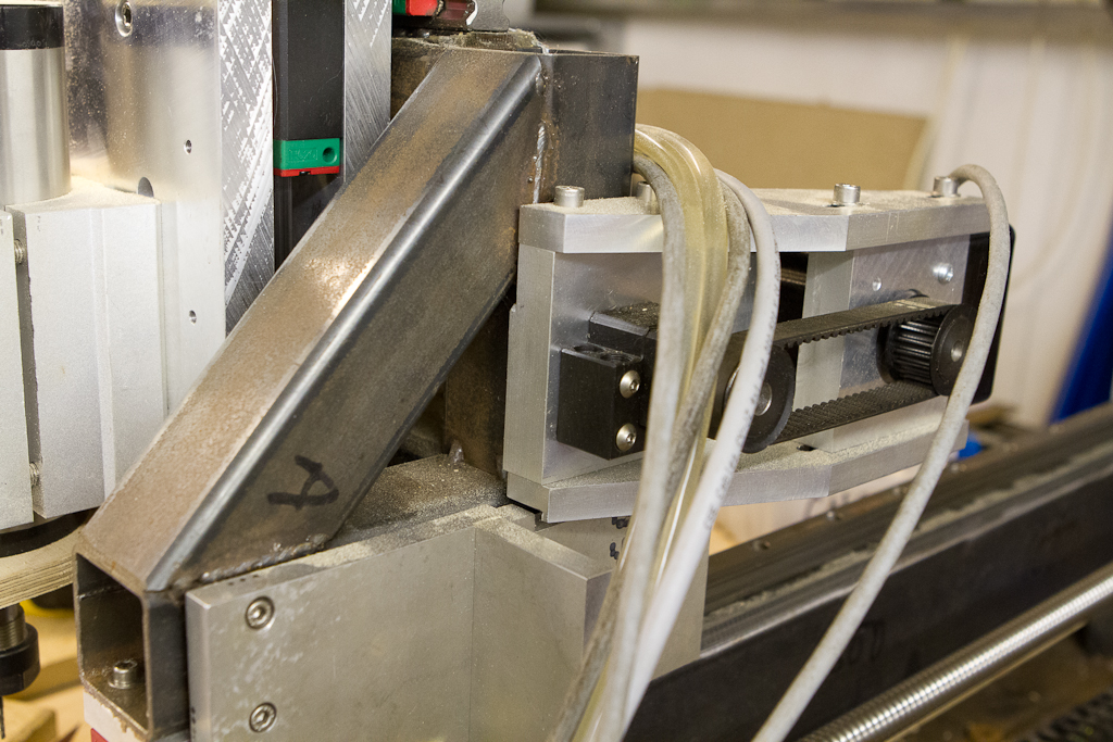

I fitted pulleys partly because I wondered at the design stage about needing to change pulley ratios. However, given that the critical speed of the X ballscrews is about 900RPM (2005, fixed/floating bearings, although different critical speed calculators give slight variations) and the corner speed of the steppers is about the same, I was designing for a machine rapid speed of about 4500mm/min, which seemed reasonable at the time. Still does, in practice, as I tend to be making small fiddly bits where acceleration is more important to total cutting time than speed. In practice, after playing about with settings, I’m running with a max rapid speed of 5000mm/min which seems to work OK, and I’ve set the Y to be the same just for consistency. I don't see any real need to change pulley sizes.
However, pulleys also allowed me to mount the motors within the overall envelope of the machine rather than protruding, which is useful in a confined workshop where space is important. The motors sit on slotted brackets which allow belt tensioning and in theory the slots are long enough to allow other pulley size combinations.
I spent a long time wondering about two X motors or one bigger motor with a long belt. Two motors is mechanically better on my machine as it leaves one end completely unobstructed without needing multiple pulleys to guide a long belt across. However, I also wanted to use a CSMIO-IP/M motion controller which originally did not support dual motors on a single axis, sending me down the single-motor route. However, before I had finally committed to the single-motor design, CS Labs issued a new firmware update which provided minimal but adequate support for dual motors, so that’s the way I went.

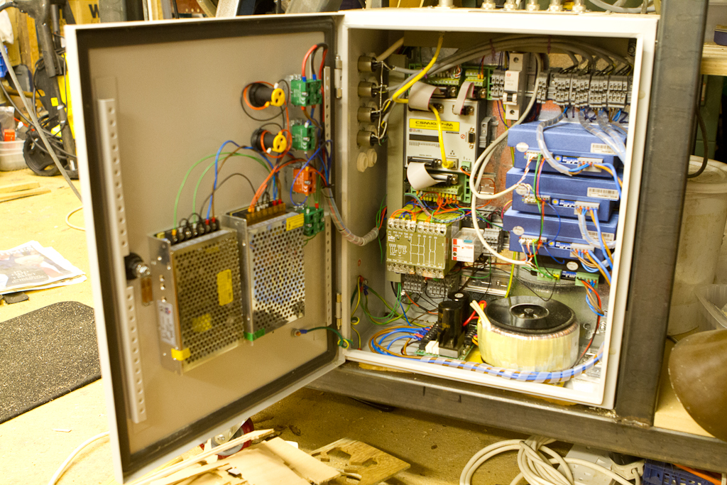

Attachment 23615
Attachment 23616

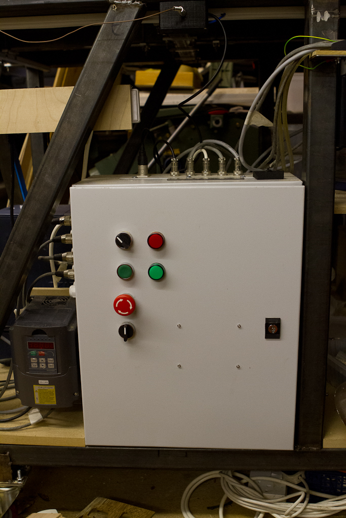

For completeness, here are a couple of pictures of my control box. External controls are mains on/off and pilot LED, reset button and associated LED, e-stop, and spindle coolant pump switch. This has two positions and centre-off; turn to left gives 12V on pump (only used for filling system and purging bubbles) and turn to right gives 5V – slow trickle of water through system which is more than adequate and should extend the life of the cheap water pump I am using. I often don’t bother with the spindle coolant if I’m only doing a smallish job – I just check the spindle case temperature from time to time. Everything else is driven through Mach3, using a wireless PC keyboard with integrated touchpad and a wireless MPG “pendant”. You will see warnings against using wireless keyboards like this because of potential electrical interference generating false keystrokes but I have never seen this problem.
External connections are made via cabinet-mounted sockets, with the exception of the hard-wired mains lead. Stepper motor connections are via 4-pin XLR connectors. They lock in place, so minimal chance of one falling out, and the contacts, on paper at least, are rated for the motor current. I started by hard-wiring motor connections to DIN rail terminals but found that I was continually needing to remove the control box while setting up and testing so went back to the same connectors that I had used on my previous machine, and where they had worked successfully for a number of years. Control and similar connectors use what were described as “avionics connectors” or GX16. I use 4-pin versions which have a screw-lock to keep them in place. There are 5 of these altogether and carry e-stop, limit switch, spindle coolant pump, and VFD connections. The remaining connector looks like an XLR connector but inside the shell is an RJ45 ethernet connection. The actual plug and socket are pretty much standard RJ45 but the cabinet-mounted socket has an XLR-compatible fitting around it and the plug is an XLR shell that fits over the RJ45 plug for protection and locking. These are available off-the-shelf from people like Rapid Online, but make sure that you get the one that fits over an existing connector if you want to use a commercial Ethernet cable. Otherwise, you are going to have to fit the RJ45 connector yourself AFTER putting the shell on the wire. Guess how I know this… The RJ45 bulkhead connector has a short length of Cat5 cable inside the cabinet connecting it to the CSMIO.
All cables on the machine run through cable chains; motor, limit switch, spindle power, and spindle coolant pipes all run through the same guide. I have tried to keep limit switch and motor cables (all CY) on opposite sides of the cable chain and I have not seen any interference or false triggering effects. I suspect that the 24V signalling voltages are a great help here – much better noise rejection. I have also run ground wires through each section of cable chain between ground points close to each end of the cable chain. This removes any reliance on ground connections via the Hiwin rails. Certainly the touchplate mechanism is very reliable – no need for crocodile clips to the tool bit or anything like that.

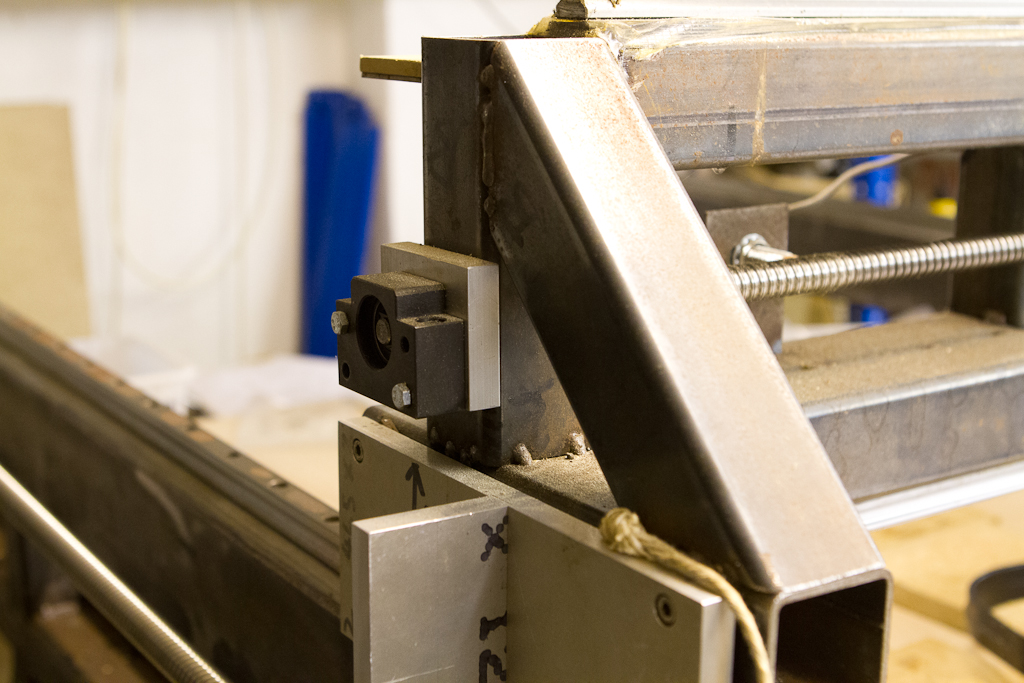

Re: AVOR – a steel-framed medium-size router
Great thread and write-up. Thank you.
It coincides with my own effort for almost exactly the same design.
How difficult was to attach the gantry to linear blocks?
Attachment 23630
Very simple. The linear bearing carriages are bolted to a 12mm aluminium plate with cap screws in counter-bored holes so that bolt heads are below the surface. In effect, I then have a linear bearing skate. The bearing carriages are aligned to the rails before being finally bolted up tight (just run the "skate" backwards and forwards a few times before tightening screws). The "feet" of the gantry sit on pads of epoxy paste for leveling (as described earlier) and are held in place by three bolts at each end of each foot. These go through the base of the foot box section into tapped holes in the aluminium plate. Two bolts are near the end of the foot and one further in, carefully positioned so that you can get more than 60deg swing with an allen key in order to tighten it.
Does that help?

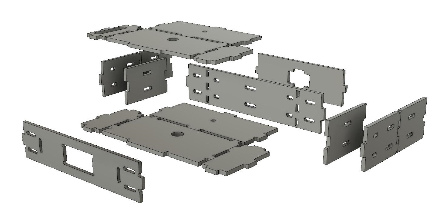

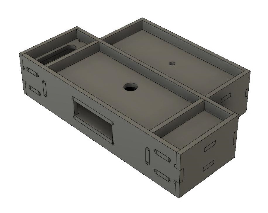

Just to give a better idea of what I was cutting, and why I thought that CNC would be a better way than milling manually...
This is the "finished item", as shown in Fusion 360. It's all now cut and waiting final assembly.
Attachment 24902
And this is an exploded view. Not quite as good a view as F360 only explodes "components" and some of my components actually consist of several pieces that are not separated here.
Attachment 24903
My technique varied slightly as I went along. I started with more-or-less rectangular tabs and slots, with fillets in the internal corners to soften the tool motion while cutting. The resulting corners needed relieving with small files before assembly. Eventually, I realised that I could machine appropriate clearance fillets, so tabs had small semi-circular cutouts at the base and slots were given semi-circular ends. In practice, with a structure like this it is only the flat faces of the tabs and slots which locate; the tabs can slide sideways a little as this position is actually constrained by the way that the pieces butt up against each other. You can see the different techniques in various places in the exploded view.
As ever, I don't recommend that you try to copy me too closely, but it's an indication of the art of the possible if you are both careful and lucky.

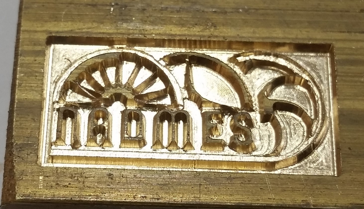

Another little sample item, cut with the router. Remember that the machine was designed and built for cutting wood, up to quarter-sheet size. This item is a prototype engraved master for a lapel badge for my local model engineering society. A member offered to lost-wax cast these provided that someone could make a master, and as the only one present with any kind of CNC capability, I was volunteered.
This was a first attempt to see if it was possible. The overall size is 20mmx10mm, and the engraving is about 0.75mm deep. Done with a 30deg included angle carbide V cutter. Although it looks a bit rough in the picture, remember just how small this is! The top surface of the engraving also looks a bit rough as it is the original surface of the drawn brass bar. I was only interested to see if I could achieve the detail needed in this test piece. I have recently completed a larger version, about 35x17mm, which is rather better, and where I have also skimmed the top surface to get a decent finish. The toolpath was generated by Vectric Vcarve, with the design traced from an original bitmap copy which needed a bit of manual clean-up.
Attachment 25867
The original investment in decent ballscrews and Hiwin rails was justified, I feel.
