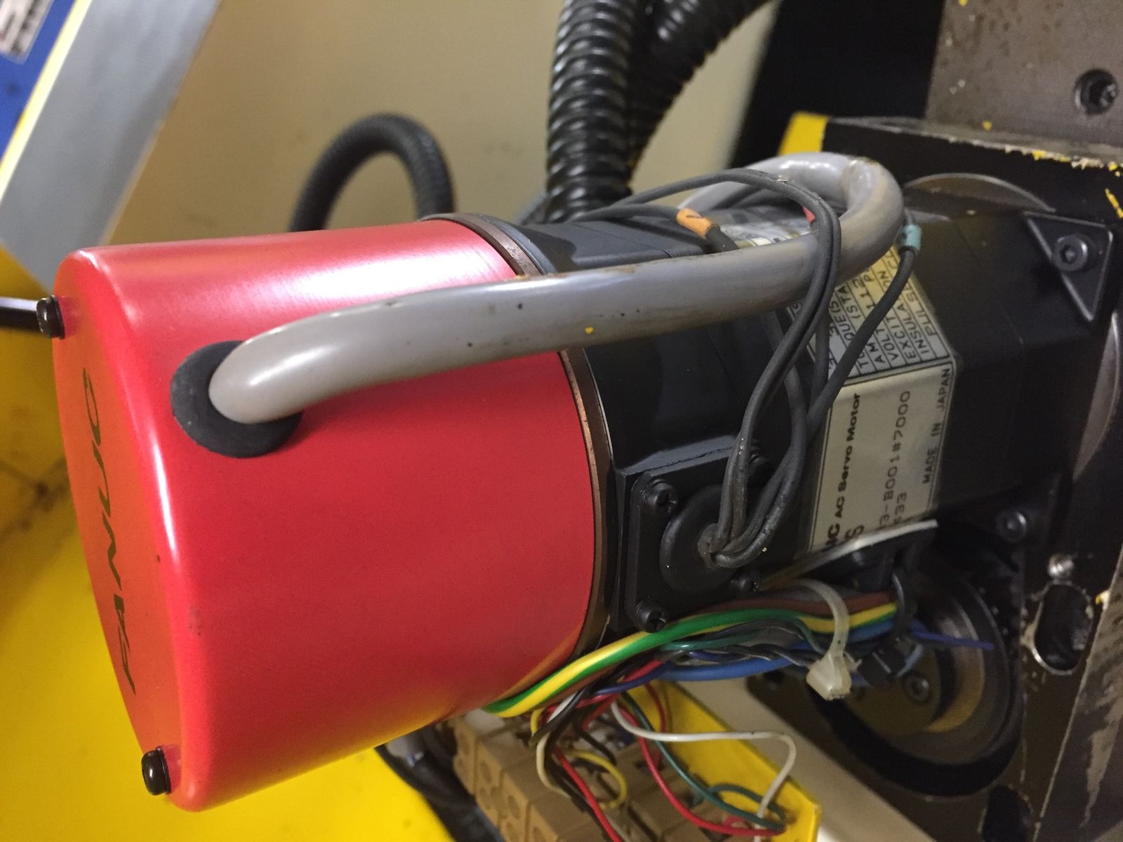

Yes they are definatly red top AC servos and feed 3phase 415v Attachment 23703

Had a look today and the motors are Type 3-OS, A06B 0533-B001#7000 and dated 90 04 so guesing April 1990
6 pole, 112v, 0.5Nm and 1 amp, google seems to indicate a 2000ppr incremental encoder.
Are they worth saving or just replace with a all new drives.

Those servos are not actually that powerful. 112V and 1A puts them at 120W continuous (there will likely be an instantaneous rating 2-3x this).
Kinco from Zapp, you could go for SMH60 400W servos which are £264 along with a CD422 drive at £240 makes it £504 per axis (those prices are including VAT).
If you go for a Chinese option, 200W servo and drive combos can be had $264 per set (https://www.aliexpress.com/item/New-...760383887.html) or 400W for a similar price (https://www.aliexpress.com/store/pro...760376015.html with an 80 frame motor, or https://www.aliexpress.com/store/pro...760394727.html with 60 frame motor)
Or I've just remembered CNCdrive do servos and drives. They do AC servos in 156 and 400W versions at €156 and €198 respectively, although I can't find their corresponding drive in their web shop. They also do DC brushed servos, but I'd personally pay the extra for AC servos.

I'm going to use Allen Bradley drives for my triac with fanuc reds
I've bought a few for around £100
I've been testing them with various motors up to 3kw off single phase and step/ direction. They are very versatile when you work out how to set them up!
I know fanuc use strange comutation but these can commutate without halls etc.
Probably the most versatile drives I've ever tested.
