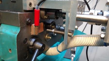

Looking for a high quality homing switch so that I can get my Lathe's X Axis set correctly and allow my tool changer to be consistent.
When looking at proximity switches, how do you know if its high quality? I did see a test a while ago where a guy on youtube tested a number of them and found a mechanical switch with no arm seemed to be the most reliable.
As I dont have index homing (stepper), what are my options?

I used an opto slot sensor on my old lathe, and there was never any measurable variation. I used RS part number 480-5231 however I see that part has now been discontinued. The only problem was I had to make sure a bit swarf hadn't landed in the slot prior to homing, as I never bothered enclosing it.
The new lathe uses proximity combined with servo index homing.
You could combine a proximity or microswitch with a slot sensor on the stepper, provided you can add a suitable slot to the stepper/ballscrew, to essentially give you a poor mans index homing.

Thanks, something like this - https://uk.rs-online.com/web/p/photo...nsors/1254515/ ?

Does this need a 'receiving part' or anything that it can pick up in the slot?

You need something that goes through the slot. It doesn't have to be anything fancy, I just used a bit bent bar suitably mounted on the cross slide -
https://farm6.staticflickr.com/5026/...7e86900d_z.jpg

Chaz, I have made something based on the "touch plate" concept used for mill Z homing.
Attachment 24073
(I hope that works!)
Repeatability seems to be better than 10 microns, and in conjunction with my tool setter on my first trial of homing/applying set tool offset/turning I achieved indicated microm accuracy on diameter. This cost nothing to make, it's essentially a bit of PCB laminated on to 6mm of tufnol superglued to the apron front. Obviously there are issues of wear and tarnishing so I intend to upgrade it with one where the contact surface is beryllium copper.

Thanks, I had though of similar - this is the way that we deal with milling offsets, so no reason why it wont work on a Lathe. Ill try the switch from audioandy (Thank you) first and go from there.

I retested my cheap proximity switch with a 'semi decent' analog DTI and it was surprisingly accurate. My el cheapo electronic DTI seems not to be repeatable. Go figure ...
I also managed to get my spindle speed / encoder setup to work and tweaked my steps for X and Z, explains why I was getting inaccurate cuts, not out my much, but it was out.
Ill still try the mechanical switch - just need to figure how to mount it with my setup.
