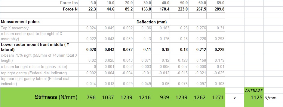

Hey folks,
I thought you might want to see the results of adding a stainless steel channel inside of a c-beam. I took extensive measurements from various places on the machine from 5 to 65lbs of force. The results are not what I was hoping for but I'd be curious to know if any one has taken a similar gamut of measurements from their CNC and how it compares.
Here is a video of the process:
https://youtu.be/SwHb75_GWwM
And here is a link to the data spreadsheet:
https://docs.google.com/spreadsheets...it?usp=sharing
Cheers,
Tyler
Re: Added steel channel to X-axis c-beam
Hi Tyler,
I took your google data sheet and used the deflection which I believe is closest to the collet to calculate the stiffness. It is around 1125 N/mm where you took that measurement (router plate Y direction). This would be lower at the collet itself which is really the only value that matters.
Attachment 24291

Ooooo, this is very helpful! The take away is that I don't believe all my efforts and expense to add steel to an aluminum extrusion had much of an effect. Would you agree? Next I'll try replacing the X assembly mini wheel setup with linear bearings on some form of steel X beam. I think this will be the most significant upgrade I can make presently. I'll fashion it in such a way that I can use it moving forward.

1) Benefits of your upgrade: I didn't see any data in the 'before' condition, and I think in your video you have only measured after? So difficult to say, but you are currently in a modest DIY machine territory. For reference technical papers mention commercial machines of 50,000 N/mm upwards if I remember correctly . . .
2) Wheel upgrade to linear rails, plus steel beam: The linear rails upgrade may not show much stiffness, as they are probably not the limiting factor. But they will reduce the maintenance, and may reduce the vibration a bit. But when combined with the steel beam it will start to help.
3) You can post my reply on YouTube if you like. Just reference the 'mycncuk' forum for the source.
4) You can link to the calculator, again quoting the 'mycncuk' source for the reference. Just one thing - I wrote it many years ago to help myself out with some decisions. I have a Mechanical Engineering background so these calcs are OK for me but I really do not have time to explain the calculations or theoretical background for the worksheet. There are instructions on how to use it contained on the sheet but that is all I can offer. Hope you can understand.
5) Measuring force/deflection around the structure: The only one that matters is the force/deflection at the collet (or tool if you want), and ideally with the spindle in the middle of the gantry and at some depth away from home to represent a cutting position. Force/deflection at other locations doesn't help any. But what does help if you want to explore is keeping the force FIXED at the collet, and measuring deflection at other parts of the structure. This will build up a sort of deflection map of the structure and show you where in the chain the worst deflection is happening. Keep the force FIXED at the collet. Then measure the deflection at the collet, the spindle, the Y axis, the gantry, the gantry sides, and the bed in turn. You will probably see a sudden delta change at some point in this chain, that is where you need to improve things.
For applying force to the collet in X & Y I used kitchen scales (the flat electronic type) with a short length of wood in between to get onto the collet. I was then pushing until the scales read 5kg (~5N). You can also pull with luggage scales for X and Y. For Z I put the scale under the collet and pushed up. I'm not sure how you would do that will luggage scales other than perhaps with a pivot and beam, then scaling the results. As your readings showed the machine is fairly linear so any force (within reason) will do.

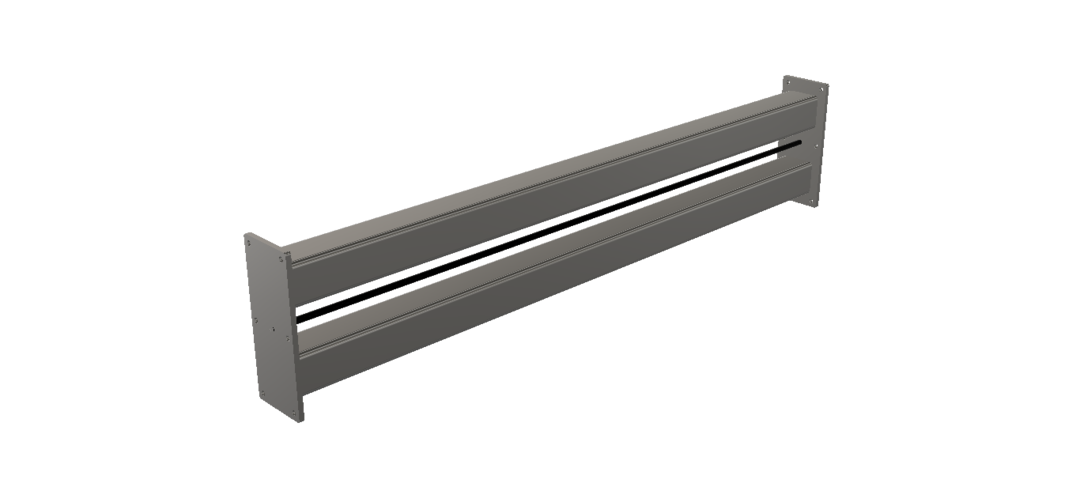

So, here is my current plan for the X beam, 2" x 6" x 3/16" steel beam with linear rails. I'll weld at least .25" thick plate onto the ends for mounting to the gantries. Maybe thicker? Not sure if it's necessary, will just add more weight.
Over on the Openbuilds forum, M90Ranger suggested I split up the rails and use a design like this: Attachment 24452 Certainly two .25" wall 2" or 3" square tubing would be cheaper than the single 2" x 6" I purchased. Somehow I like the overall feel of the single rectangular tube. Which do you think would be more rigid?
Two tubes could be almost but not quite as good if the end plates were of infinite stiffness, the guy who suggested that obviously isn't aware of the concept of Triangulation in structural design or the properties of different cross sections in torsional load.
I don't find that surprising any more though ;-)

The split tubes have the advantage that the Y axis can be very close to the gantry as it does not need to be offset to accommodate the ballscrew behind it which usually takes up more space than the rail and carriage.
But it is nowhere near as stiff a shape as a single rectangular gantry. In vertical bending the 2 tubes are only twice as stiff as one of the tubes on its own. But when joined as a single large tube they are 2^3 times stiffer (8 times) for example.
As mentioned by magicniner there are similar benefits for torsion for similar reasons.
That is why when you see 2 tube designs with the screw in the middle the builder often plates them together at the back to try and gain some of this advantage back.
If you go with the single large rectangle then the rails can be spaced out on thick solid bars welded to the section to give the ballscrew clearance. Sure, this puts a moment on the section but you can afford a bit of this loss as you have so much to start with.
Another variation is to have a tall more slender section vertically and have another horizontal section behind in a reverse L shape. This is popular when used with aluminium extrusions and the ballscrew can sit behind the section driven off a good bracket that often houses the Z stepper too then the rails can be tight against the section again.
I’d favour the large rectangle as per your blue drawing but the above gives you some options and reasons.

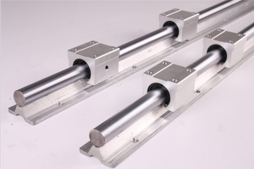

OK, so I'm solid on using the 2" x 6" steel tube for the X beam! I have a few more questions for you good folks.
- 1/4" inch steel plates for the end caps on the beam? Or should I go thicker? 1/2"?
- 20mm round supported rails and bearings ~$80, or spend the extra dough and get linear rails and bearings ~$240!
The other factor on the square rails is that I'll have to have the steel beam milled, which will probably cost $200 or more, whereas the supported round rail is far more forgiving when it comes to alignment. The rectangular steel tube has a round crest to it, but it is fairly consistent along the length of the beam. I'm thinking that I can screw the supported round rails right to the beam, maybe a little shim stock if necessary, easy peasy.
Attachment 24471 VS. Attachment 24472

Supported rail will be better than the wheels you have now and my previous machine ran on those for a few years. But there can be some maintenance such as sometimes the bearing coming loose in the housing plus there was some wear on my set that I noticed when I took them apart and was the likely cause of it getting worse for chatter.
So if you stay in this hobby you will get linear profile rails in the end.
As for the gantry sides - looks like they are the drop down style to raise the gantry. So they need to be quite thick. If they are aluminium then they should ideally be 20mm. But if they are steel they can be thinner. Steel is 3 times stiffer than aluminium, just in terms of material properties, but then when you go thinner you quickly loose out due to geometry (which is independent of material) so . . . go for 12.5 mm over 6.35 mm.
Better still if doing a really good upgrade raise the bed sides so the gantry doesn’t have to drop down and you will gain much more than trying to get stiffness back in the side plates.
Linear rails are far superior to round supported rails.

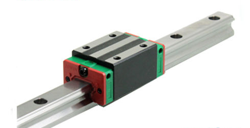

OK gents, I hear you! Dang, y'all are making me spend more money! Ha! I'm a bit afraid of epoxy since it's out of my wheel house. Does anyone have a simple tutorial for using epoxy to do some leveling?
I think I'm going to give these a whack:
http://www.automation-overstock.com/...sp?prod=BLH20N
