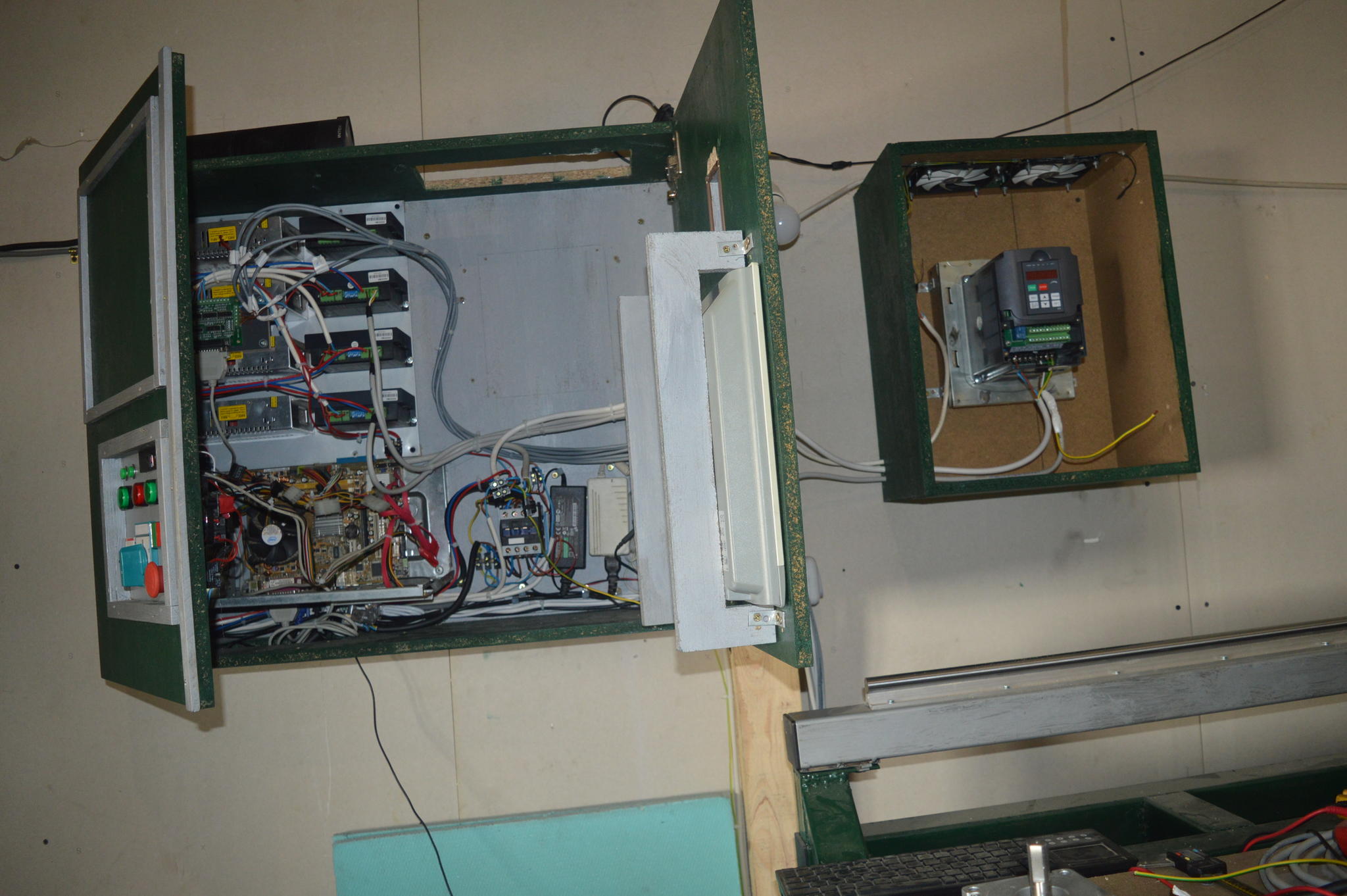

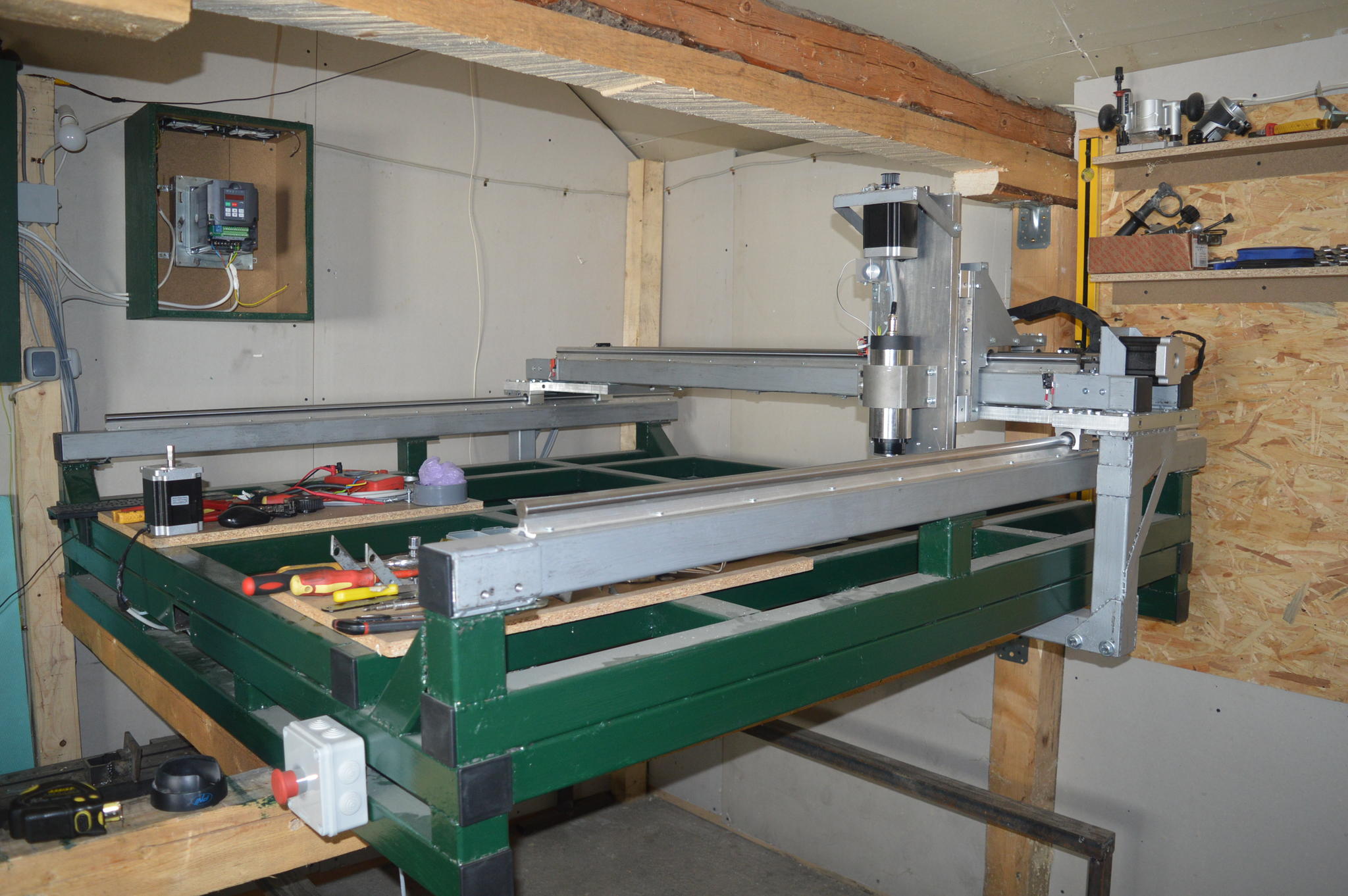

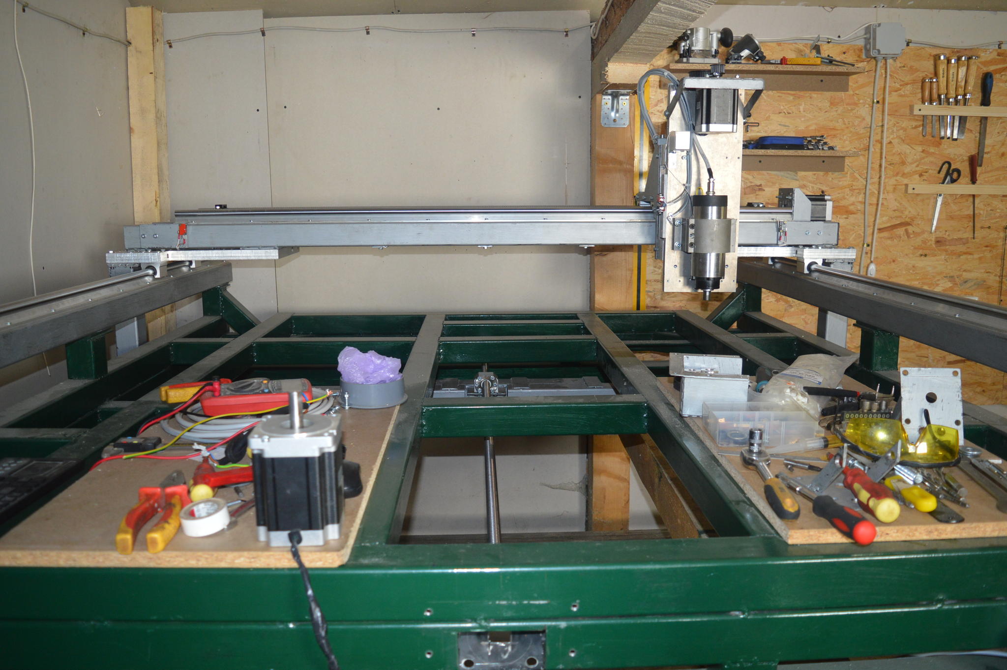

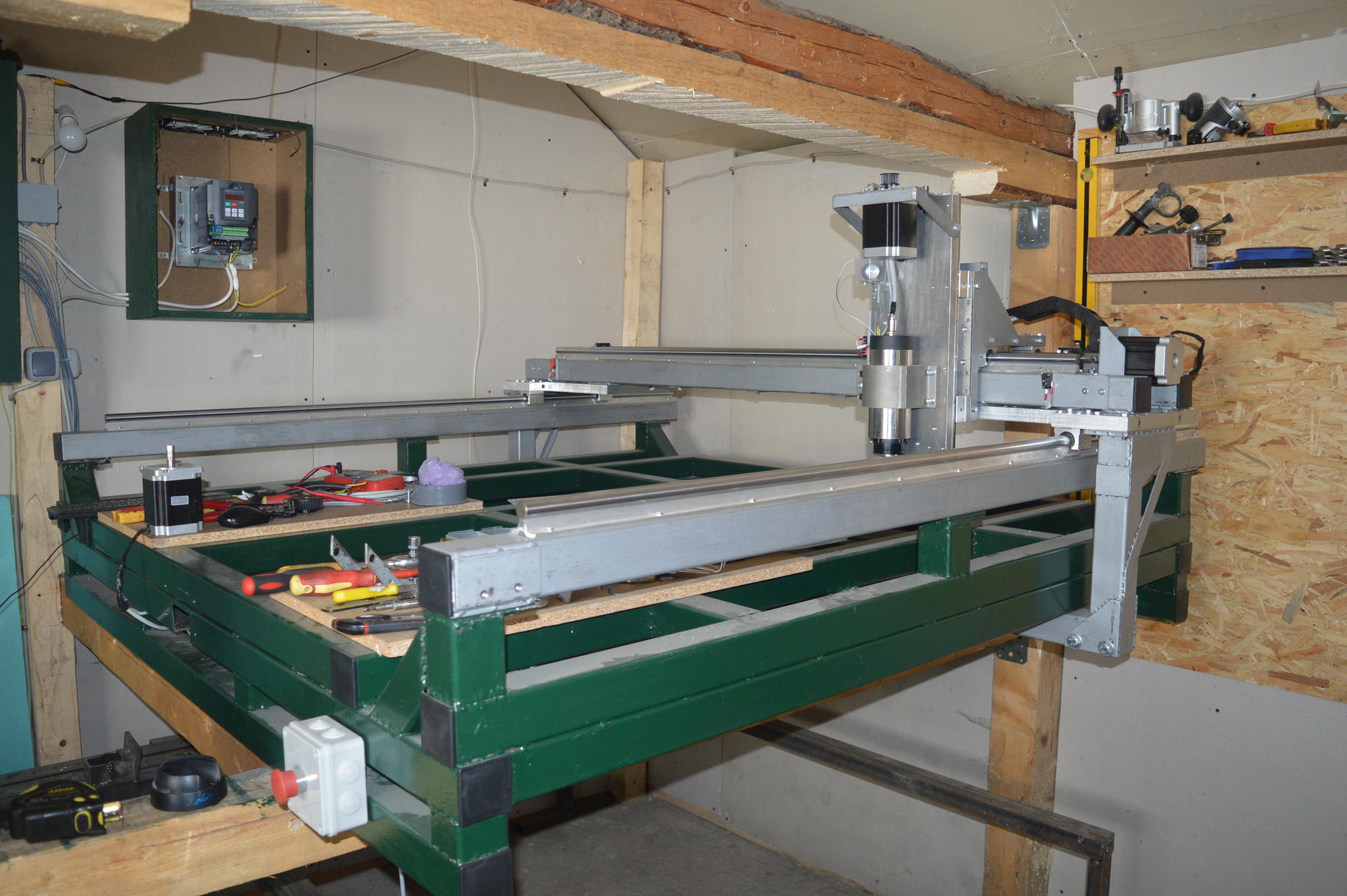

		Hi again,
 Here are the photos I.ve promised 4 weeks ago.
 It is a 5/5 machine (1.5m/1.5m) made of 2.3 inches (6cm) steel tubing, and aluminium plates.
 Rails and ballsscrews of 20 mm. Nema 34 motors (overkill for z axis, but i.ve bought a kit of 4 a few years ago,  I.ll get a nema 23 kit sometime in the future). The part of the gantry moving left and right weighs apx 65 pounds (30 kg), while the whole gantry apx 240 pounds (110kg). I did not have any problem so far with the supported rails and bearings, or screws and motors, just a limitation in speed, as a hard stop at a high speed will shake the whole thing. Adjusting each motor to a certain speed seems to work fine.
 The project was designed at first with 2 motors on the y axis, and it weight apx 200 pounds, but the fact that I could not mecanically sync the two ballscrews involved, had me worried and I.ve decided to go with one screw in the middle, as any kind of failure does not have the potential to break or bend something.
 It is this large, as I need this mainly for carving soft and hardwoods, for cabinet making, and this size let me fit 6 door panels at once on the table.
 This is where i.ve got so far with the project, and once again I ran into an issue which I.m not able to fix. Everything was going fine, until I.ve wired mains for the vfd, then I had a surprise when I almost crushed the z axis as it did not stop when I released the keybord.  After I.ve wired the spindle, evrything went nuts, as the steppers make a strong noise, and move back and forward quite fast. It.s a chinese 1.5 kw air cooled kit.

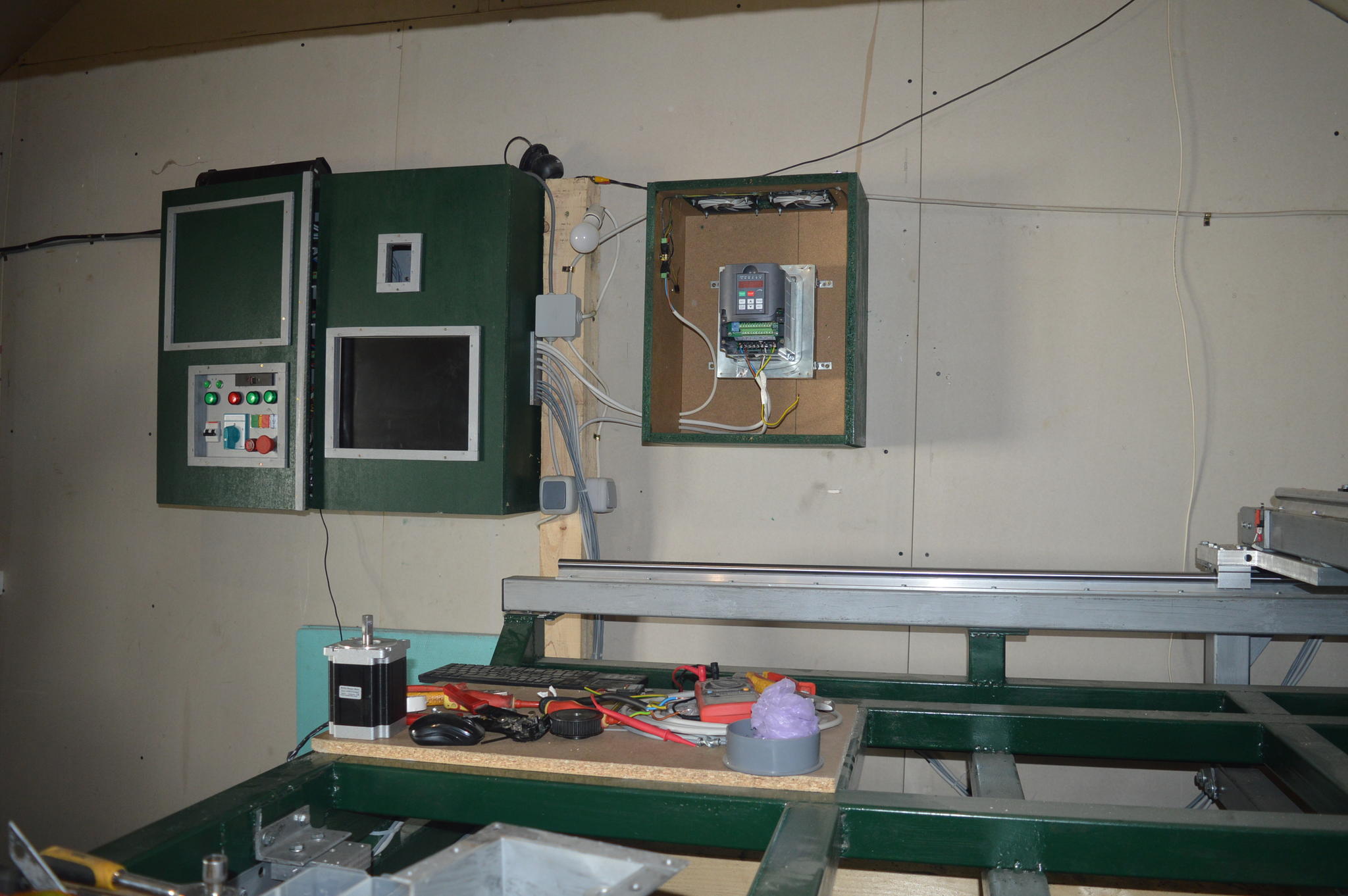

 As it can be seen in the photos, my idea was to put eveything in one box, including the pc.
 I.ve decided to make another enclosure for the vfd and move it a bit further away, and it did not fix the problem. When I turn on the power for steppers (with a contactor) and the vfd (cam swith), even if the pc and mach 3 are off, or even if the vfd is off, the steppers go mad until i hit reset in mach 3, then they stop and work fine, until i turn on the vfd and/or the spindle.

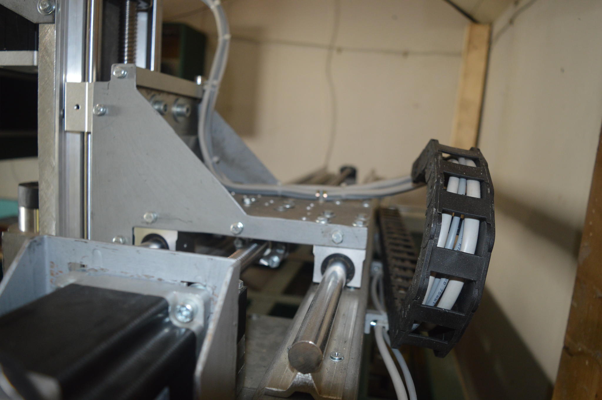

 The wires are shielded, 4 wire cable for all steppers and spindle (18 and 14 awg). I did open the cap of the spindle and connected to the case a ground wire (the 4th one) and connect it to a steel rod in the ground. I did this because it says in the manual to avoid having a common ground with a welder. And I do use one quite often. I did not connect the shielding to anything. I.ve only tried yesterday to connect one end of the shielding at the vfd end to see if it makes any difference, and it did not, and also disconecting the spindle ground from the vfd did not do anything (as by default there is not a 4th wire available). No shielding it connected at any end for the steppers or the limit switches. The only non shielded wires are the mains for everything, pc, sources, drivers, breakout board and vfd.
 All the wires go togheter in a cable drag chain.
 So this beeing one issue, the second is how to wire and configure the limit switches. From what I know so far, I can wire all of them in series, normaly closed, and connect then to the breakout board (DB25-1205 in my case), to one pin from P10 to P15, and to GND. Well, I did something like that, only that I.ve separated each axis 2 limit switches to separate pins. So P10,11,12 to X,Y,Z and P13 to Probe, P15 to Estop, and all grounds together. And it does not work, as the RESET button from mach 3 stays on emmergency limit swicth all the time, when I enable the pins in cause.
 So 3 issues,
 1. How to fix the stepers issue? I though I.ll ask first here, and then call an exorcist. (it looks a lot like in the movies) :P
 2. How to wire and setup the limit switches?
 3. Opinions, reviews, criticism, potential problems and solutions for this particular design, if you may. :)
 It.s a long post, so before anything else, thank you for taking the time to read it.

		Re: Help please. Dip switches and mach 3 settings
 It is important to connect all the shields to a star point at the control box.  Including grounding the router frame.
 Only ground one end of the shields.  Also make sure the various  mounting plates are also grounded to the star point.
 With a gantry that wide I think you will need two screws to stop it racking this can be done with one motor and a long belts or two motors one each side.

		2 Attachment(s) Re: Help please. Dip switches and mach 3 settings
		Hi Clive,
 I did what you said with the shieldings and it works. Almost perfect. The only thing left, is that my pc behaves a bit weird sometimes, for a few seconds, when I turn off the vfd, weird meaning the cursor is dancing on my screen for apx 10-15 sec and them returns to normal.
 I'll try to use a ferrite ring as you mentioned, for the vfd mains, as that cable is not shielded.
 The motors are working fine so far.
 So THANK YOU!
 I.ll keep in mind your suggestion about a double ballscrew drive and one motor, if any issues will come up with this design. This change on it.s own takes a long time, as I.ll need to build and buy a quite a few extra parts to make it work, so maybe wishful thinking might work this time and function ok as it is.
 Even if I have the hardware to add two motors, I.ll avoid this method, as in this last problem I had with noise, the motors were spinning in random ways, not to mention other possible hardware failures which might get them out of sync, and it looks problematic to a point of damaging some expensive parts.
 A 5 feet belt might cause some trouble as well, but with enough patience I think I can make it work.
 So once again thank you.
 As for the second issue, with the limit switches, any idea what I.m doing wrong?
 All 6 limits are wired in pairs of two, in series like in the photo, NC, where one wire goes into a numbered pin, and the other into the ground pin. P10 to 12 being used in this case for limits.  How should I set this in mach3?

		Ok  I would keep all the questions in one thread as it helps to see the history.
 Re the twin screws I use two motors with out issue.  I think  it is about half and half ie some use two and others one motor. There are pro's and con's for both.
 Do you have homing switches ?  generally on the Z axis it only needs a switch at the top. I would set that up as a combined home and limit switch .
 You can wire all the limits in series to one pin. ( set that up in ports and pins in Mach) and also set up soft limits as the machine when homed should never hit a limit.
 There are plenty of vids on the net:- https://www.youtube.com/watch?v=ma7lMocQbv0  if that helps

 8. Noise from the BoB, not usually (only when it gets drunk on a Saturday night) but seriously - I refer you back to 3 above.
 You should test each earth connection by continuity checking from the central earth point to the earthed appliance. Disconnect the appliance earth and check that the continuity between the earth point and the appliance then disappears. If it doesn't - you had a loop. :beer:
 Hope this helps !
		As Rob said.  But I hate timber boxes and think of the fire hazard.  If you can go with a metal box with the VFD external to it.
 edit: something like this could help  https://www.jaycar.com.au/iec-emi-po...6-amp/p/MS4003

		Thank you Rob for the detailed answer.
 Got it. Metal box at least for the vfd, ideally for everything else.
 By shielded box, do you mean just an earthed metal enclosure, or aluminium foil :P or like a faraday cage with chicken wire?
 Out of curiosity, Clive, about the fire hazard, how hot do this components get?
 I did it from particle board cause it.s easy and fast, and I put all components on a metal plate, actually on the side panels of the pc enclosure, as I dismanteled it. All panels beeing raised half an inch from the wood.s surface.  I could not wait to have the cnc running, and was planning to upgrade after a few months of use, and yes, I.m aware it.s a crap and unprofessional design, but it seemed to me a resonable prop at the time.
 And should I add an enclosure fan to the drivers as well, as I already have 2 for the vfd enclosure.

 If you don't want to replace the control box with a metal one, you could line it with aluminium foil (https://en.wikipedia.org/wiki/Tin_foil_hat) but to be any use it would need to be earthed. I don't think the guy in the wiki is grounded (I apologise if you don't get that joke straight away, it is a little play on the vernacular - in this instance 'grounded' means connected to reality).
 LIDL sells adhesive backed foil tape, when they have it.

		Hi again.
 Just to test to see if it improves anything, I used some zinc sheet metal to shield the control box.
 Earthed and everything, it did not make much difference.
 So I started to disconnect components, and removed the vfd from his own shielded box, and then unplugged the limit switches fom the breakout board, and all was left was the pc with the drivers, sources and steppers.
 The steppers are earthed at the driver end, everything at a star point as recommended. Checked all shield with the multimeter, and it.s all good.
 The only thing done questionable is that I have one stepper cable, which I measured wrong, and had to join it to another bit, each of the 4 wires twisted and taped, and did the same with the shield, put some aluminium foil on top, and taped all over it. Not great, but it should not be a bigger deal than any other type of connection.
 Also the limit switches are the cheap lever type. Even if not the best, they are not connected to anything now, and still have issues.
 I removed all flexible couplings, and have the motors running without any load.
 THE PROBLEM: randomly, the motors stall, all 3 of them, some a more often than others. Simply keeping pressed the keyboard arrow keys, they run ok, for 5, 10 even 30 seconds, then at least one stalls.
 I,ve loaded a default g code, those coming with the software, and the same problem. I changed the motor turning config to acc 50 and speed 300, 400, 500, still have the problem.
 I.ll remove all steppers tomorrow and connect them directly to the drivers. At least to exclude the cables as well.
 The motors are 5.6A and the drivers set to 4.9A Peak, 3.5A RMS.
 The drivers are DQ860MA and wired like this: +5v to PUL +(+5v), and bridged to DIR+ and ENBL+, then PULL- and DIR- go to the pins 2 and 3 for example on the BoB, ENBL- is not wired. The other 6 terminals are 2 for the source and 4 for the stepper.
 The breakout board is db 25-1205.
 I.m working on the metal cases, control box and vfd box, suggested by Rob and Clive, but I can not go further with the design and construction, until I figure out the cause of this stall.
 I.ve already tried to separate the components and to shield all boxes and ground them. I rechecked all wires, including the drivers, and rewired those with twisted cables inside the control box. This wires between the sources and drivers and the BoB are not shielded. Everything else is.
 I had a touch plate fitted and disconnected it as well, as it concerned me that the wire connected to the spindle, and to the chasis as is all conductive materials, sends a ground signal into the input pin of the BoB and might cause problems. Does it?
 I.ll even remove tomorrow all other wires from the drag chain and leave only the steppers. It might exclude something else.
 BUT I higly suspect the BoB.
 What do you think guys? What am I missing?
		Ok. I tried it like this.
 From left to right in the photos and video, drivers set at 800/1600/2000 with motor turning acc 50 and velocity 400.
 There is a difference, as the 800 one runs smooth without vibration when touched. The noise difference exists even between steppers with exact same settings so not sure if it matters.
 https://www.youtube.com/watch?v=dsHN_Botomk
 Also, changing the pigtail connection with a terminal one, seemed to improve a lot, but still sometimes it does like in this video  https://www.youtube.com/watch?v=4nHuNHK4fLA
 What still does not seem ok, is that when I run DriverTest in Mach3 folder, I get the first time ..Pulsing to fast and then pulsing to slow.. messages and then runing it again, I get System Excellent (apx 25000 pulses per second, 25 khz), straight line.
 Everything is taken apart like in the photos, so design wise, I got the fact that the vfd has to be somewhere outside the control box, or in it.s own box, but what about the pc? Any issues with the motherboard being close to the Bob?
 As I shielded the boxes with sheet metal, it seemed to get warm inside, which did not before ,with just the wood ones.  So, the new box will be a cleaner version of what I did, and I have two 12v fans. How would to mount this, in order to avoid dust collection, as much as possible and overheating? Blow in or our, from above, from beneath? I.m asking about the control box.
 How do you suggest , I should test the steppers to make sure all iss good, and proceed with building the metal box?
