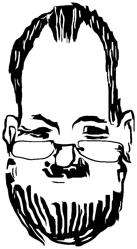

I purchased a 50 X 40 router engraver in the hope that I could start a hobby for my old age ( I am only 80 yet) I have failed and I hope some kind person will come to my rescue I will be happy to pay a fee to some one who will write G-code for a house name sign (SAN JOSE) about 16"X 6" with a groove on the perimeter also G-code for the attached image about 12" X 6"
I will be really pleased if these can be done for me

Re: G-code failure help needed please
Hmm,
I'd hesitate to send you any code as what my software generates is very unlikely to work on your engraver (without me knowing exactly what post processor you use, where you're zeroing off etc. etc. - it's a bit of a minefield, best not go there!)
What I will say, though - is that the image you uploaded is far from ideal in terms of getting enough information from it in order to generate an engraving that's going to look any good...
This is likely to be a hiding to nothing, but I've poked it around a bit and improved the contrast for you so now it looks like this:
Attachment 24601
It's still not great, but the attached .pdf (look for it at the bottom of this post) now contains the vector (or line) information that your software should recognise and be able to use to tell the machine what it is that needs to be cut...

Hi Wal, OP seems to use Mach3 set up in metric. I have sent him some code to play with, just to prompt up the problems. So far it looks as though he has hit the 500 lines demo limit, so if he wants to continue, he will need a licence. At least now he has some code to carve a sign for his house, and if it doesn't work we will have a chat by phone or email to get him pointed in the right direction. That way we can get the dross of the problems sorted before reporting back to the forum.
When we have the machine set up, I can send him the face on Gcode. Thanks for doing that, it look great and it saved me a bit of trouble farting about with Inkscape Trace.
Cheers, Rob

Thank you Wal, The improved image looks great and I hope to use it asap Joe
