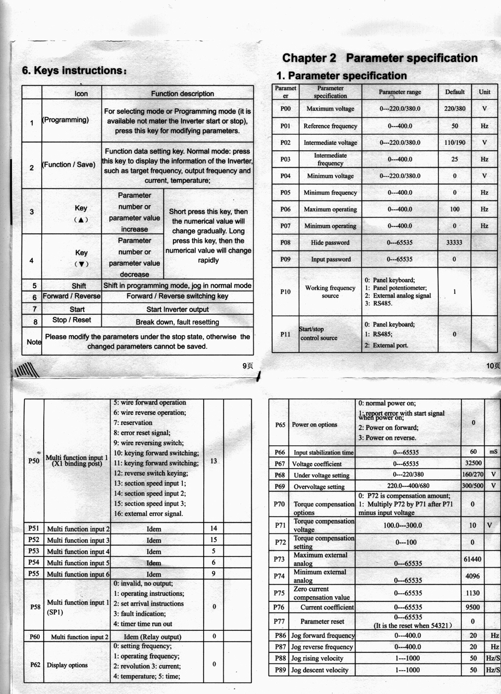

I bought it because its dimensional height meant it would fit in my control box. It has a manual (of sorts) Here’s a scanned page with some of the key perameters to set.
If the Huanyang would fit in my control box I would have bought one. Attachment 24641
Re: vfd query about the program settings for XSY-AT1 and air cooled spindle
From the looks of that you need to set
Maximum Operating to 400 and
Minimum Operating to the correct percentage of 400 to give your spindle's rated minimum speed.
Reference Speed to 400 and
Intermediate Speed to halfway between 400 and minimum rated speed

thanks thats very useful information.

After a bit of trial and error I have the spindle running although clarification would be good on what the intermediate frequency does.
P00. 220
P01. 400
P02 15
P03. 200. Changing this from 25 up to 200 resolved the matter. Not happy at 100 but ok at 300. Spindle starts to rotate when this value reached.
P04. 0
P05. 0
P06 400
P07. 0
P78. 8000
Be interested to see how your values compare.
It suggests to me that the VFD is defaulted for a 3ph 50 Hz motor and once you come away from that various other factors come into play.

Im running a small surface grinder on one of these and cant seem to get the power id expect. Ive been looking for the current limit. Any idea where it is?
I am absolutely no expert and hopefully somebody can assist. Not sure what you mean you are not getting the power you expect. You have set P78 to the rating of your grinder?
It's set as when I got it at 8000 but I'm not sure what it's 8000 of? My grinder has a rating in amps and it certainly isn't 8000 amps. Is this milliamps?
In which case its set far too high. I'll set it to the correct rating. I feel it may be something else then. Is there a pole count setup?
