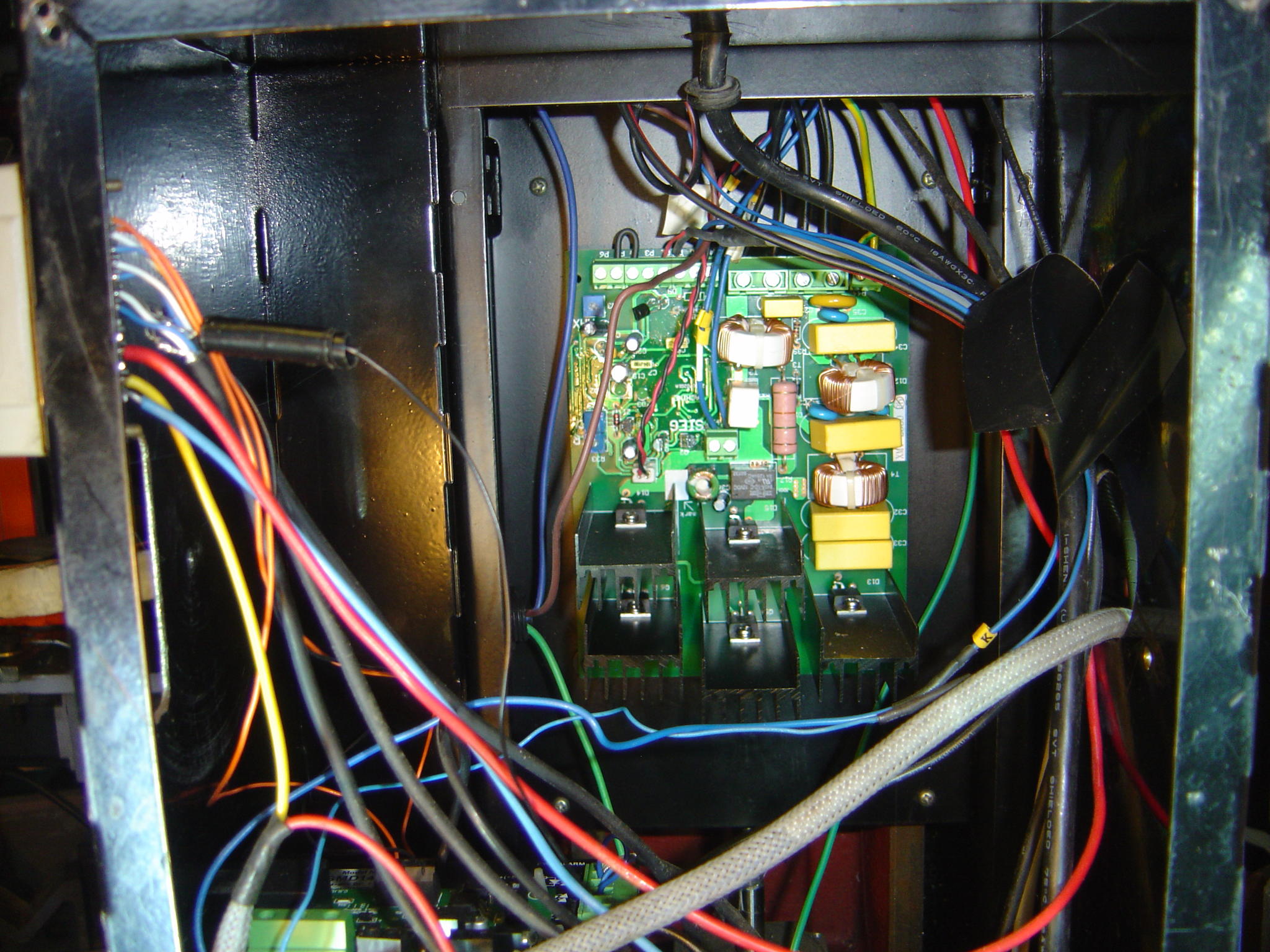

Need help please, with my Seig CNC. This is an early conversion from Arc. Had problems for some time with the front guard micro switch. So took out the switch and coupled the wires together. Solved the problem and all was well until I accidentally dropped the wires and shorted the main fuse. I can now hear the relay clicking in and out as normal but no spindle movement. If you have any inclination towards a possible solution, I would be extremely grateful.

Photos of the speed control board and CNC interface will be useful
my mini lathe for example has a seig FC250 PWM speed control board with 2 FET's as the control devices
the board has has two relays that form a no-volt release and interlock that forces you to start at minimum speed
later machines have a XMT2325 speed control that uses two thyristors as the control devices that are part of a controlled bridge rectifier
once the various boards have been identified it will be easier to fault find

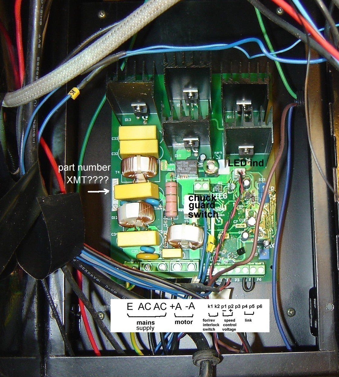

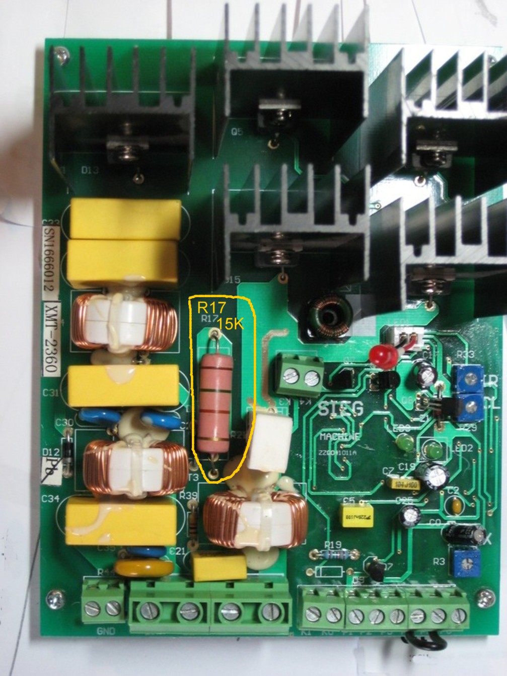

John - Here is photo of board. The two blue wires next to the central small white box are the ones I shorted. The card is marked SEIG MACHINE zz0070201A Attachment 24671

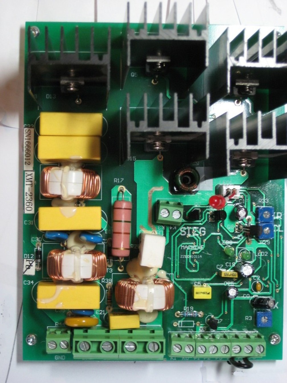

found it
the board is a XMT-2360

John - Thanks, the board is XMT 2360. The two blue wires are connected to the green chuck guard switch you have indicated. There are currently 3.6V across the terminals.
Re: Seig C3 CNC spindle problem
Les has details of the XMT-2360 on his web site
http://lesjhobbies.weebly.com/upload.../pcb_speed.pdf
if your lucky R17 on page 2 has gone high resistance when terminal K3 shorted to earth
terminal K4 shorting to earth will be of a problem

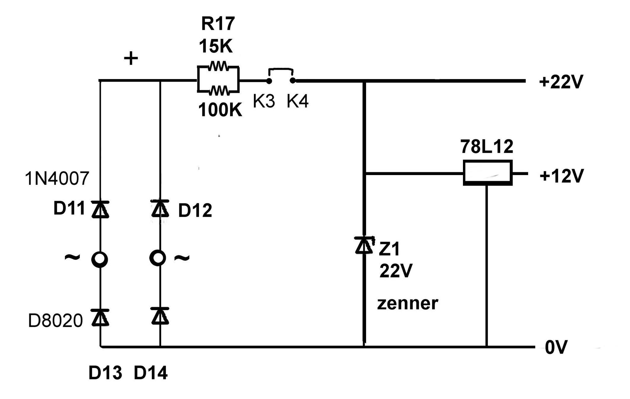

2 Attachment(s)
looking at the circuit diagram I linked to
this a simplified diagram of the low voltage supplies to the control circuit
Attachment 24675
R17 is the large resistor on the board
its value is 15 K (15000 ohms)
in parallel with a 100K resistor that gives you a total of 13K
if you get more than 13K then R17 will need replacing
has R17 changed colour ?
Attachment 24676
the resistors drops the rectified mains down to 22V at terminal K4 is linked to K3
with K3 & K4 open circuit I would of expected you to have 200V DC
if terminal K4 was shorted to earth
a number of semiconductors will need checking
starting with Z1 the 22V zenner and the 78L12 regulator IC
John
