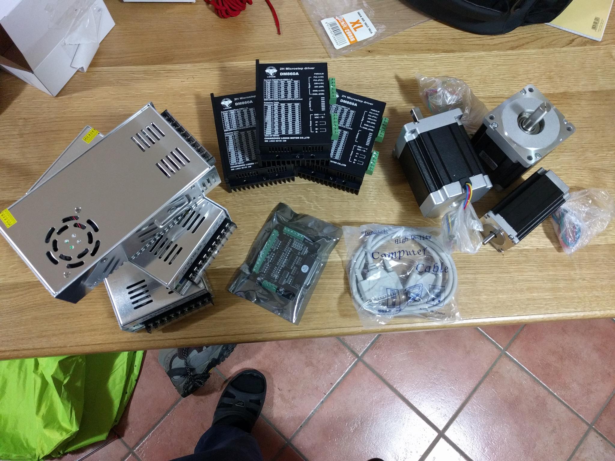

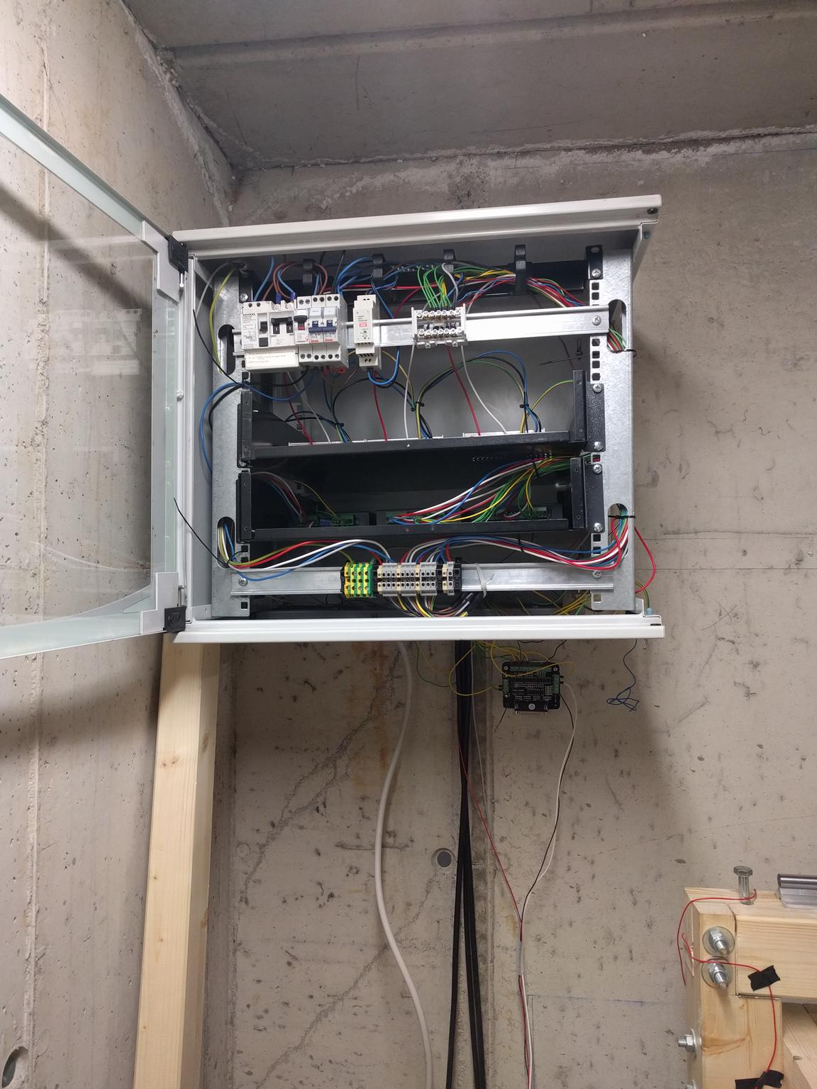

Last year I bought a cnc project with a wooden frame.
(I do not know if I can paste the site link here).
At the moment I have assembled the whole structure with the engines too, but I have some difficulty in configuring them.
The engines are:
- 2 Nema 34 1232oz.in 5.6A 4 leads (X axis & Y axis)
- 1 Nema 23 425oz.in 3.0A (Z axis)
The drivers are DM860A, one per engine.
- 3 Power supplies 350Watts (60VDC / 5.83A)
- 1 Breakout Board DB25-1205
Mach3 management program.
First Question:
On these engines it is not specified if the power supply is Peak or RMS, so at the moment the dip switches for the Nema 34 are set to OFF OFF OFF >> 7.8A Peak / 5.6A RMS is right? Or do I have to set them ON ON OFF >> 5.7A Peak /4.0A RMS?
Second question:
From my information the engines have the following technical specifications:
- 200 steps
- 256 microsteps
So if I do 200 * 256 = 51200 it should be the maximum resolution that these engines support and it is also a value that I can set by dip switches on the drivers.
In this configuration, however, the machine is moving very slowly even if objectively with this setting I have not changed speed and acceleration
Based on your experience, what values should I set on the dip switches?
Besides I can not find the right parameters for the motor tuning section of Mach3, is there a way to calculate it (including speed and acceleration) or do I have to use the "auto-calibration" tool once the dip switches have been set?
If you need more information (for example pulleys - motor ratio), tell me.

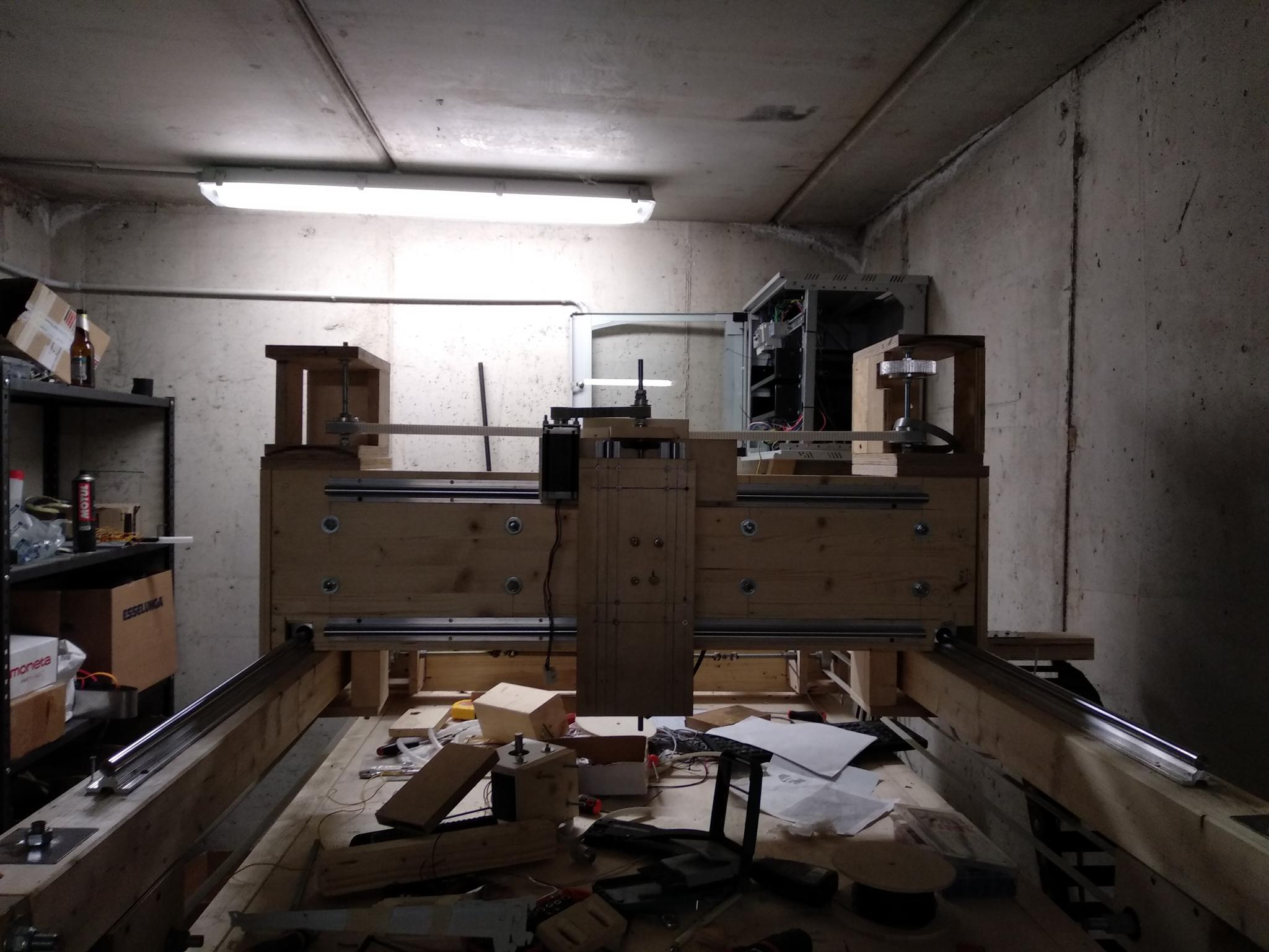

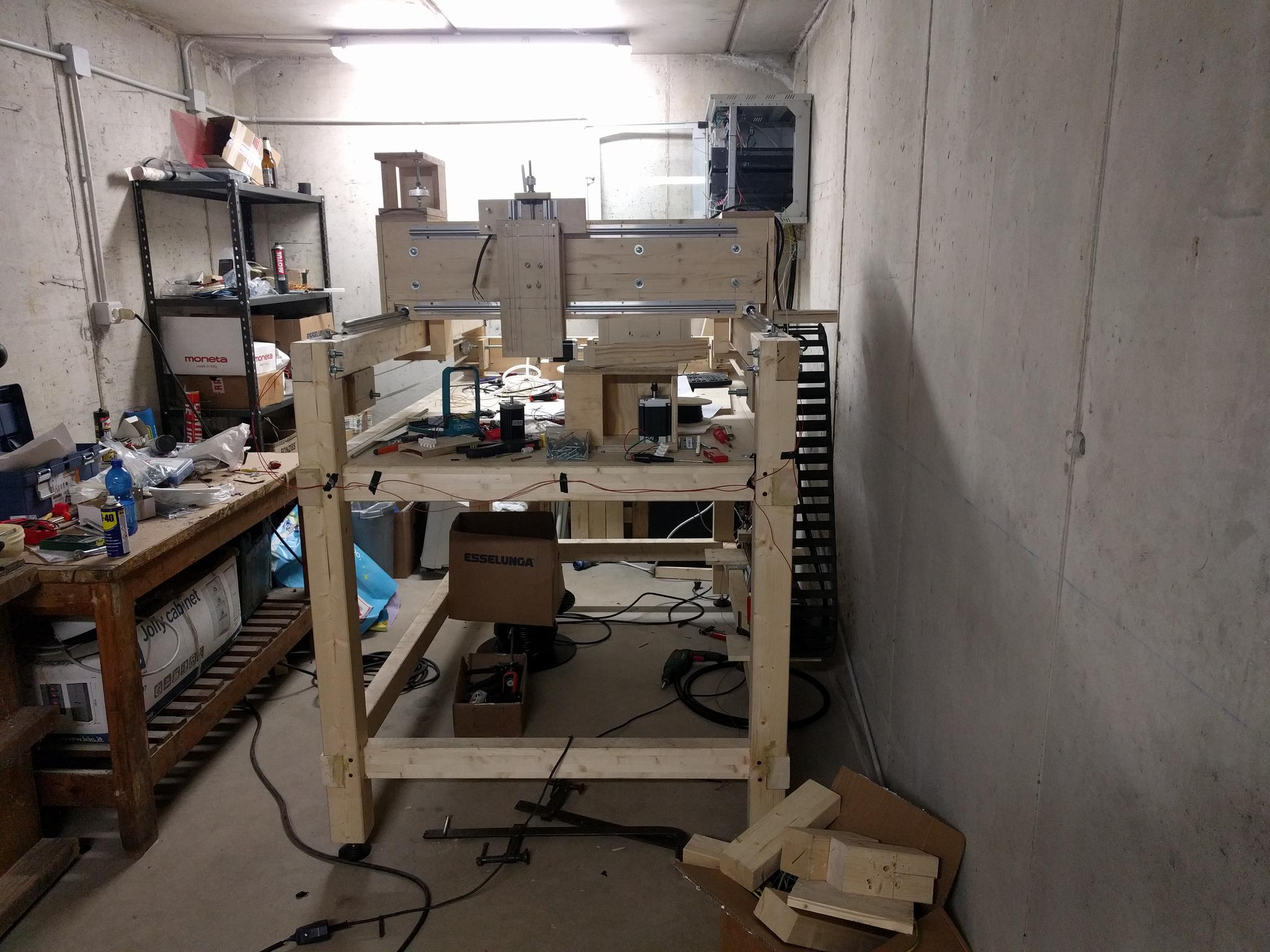

For a better understanding I am attaching some photos of the work (now it is completely assembled and wired but I have no more recent photos)
Attachment 24771 Attachment 24772 Attachment 24773 Attachment 24774
I thank all those who can help me in advance.

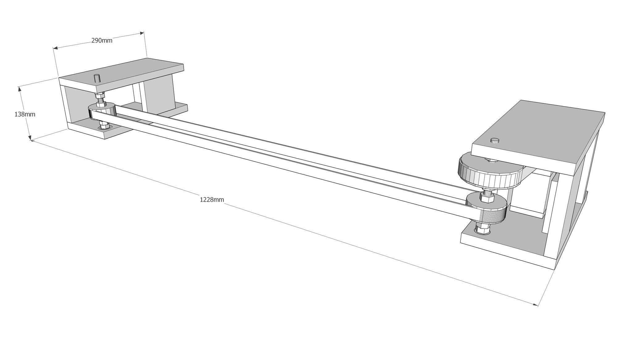

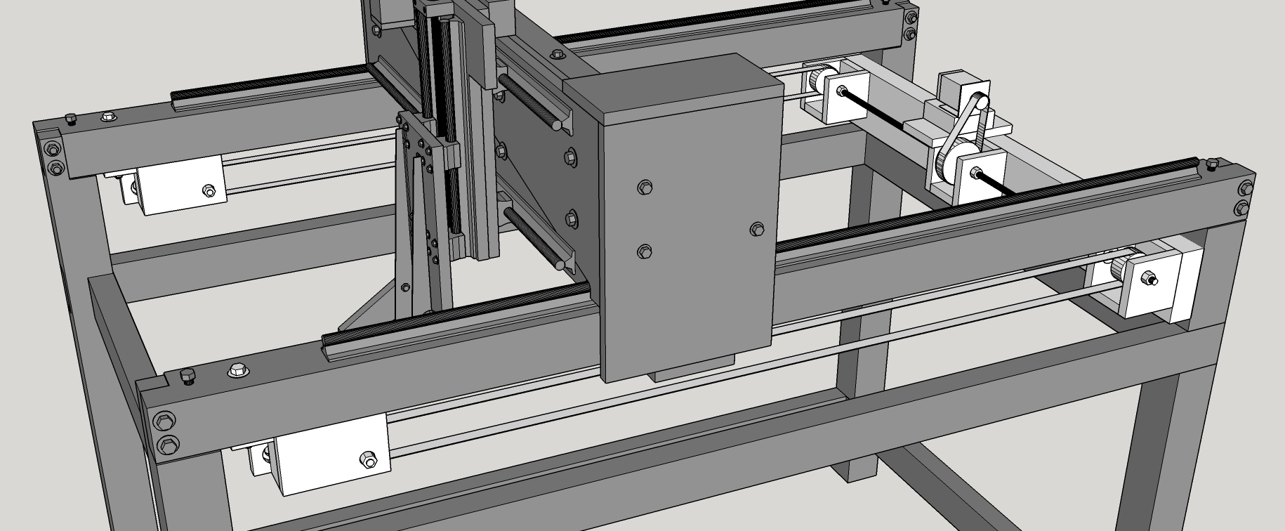

My transmission of the X axis is made with:
- M12 screw
- a pulley 20 teeth 5 pitch on the motor axis (I have to check if it is 20 or 15 teeth)
- a 60-tooth pitch 5 tooth pulley on the M12 screw
- two 40-tooth pitch 5 pulleys connected to the ends of the screw
- two 40-tooth pulleys step 5 for "neutral"
I attach photos:
Attachment 24799
For the Y axis it's all the same except that the screw is an M10.
I attach photos:
Attachment 24800

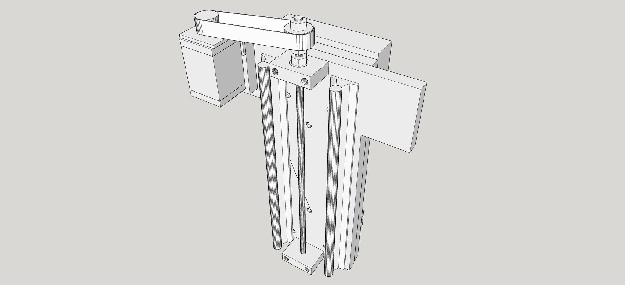

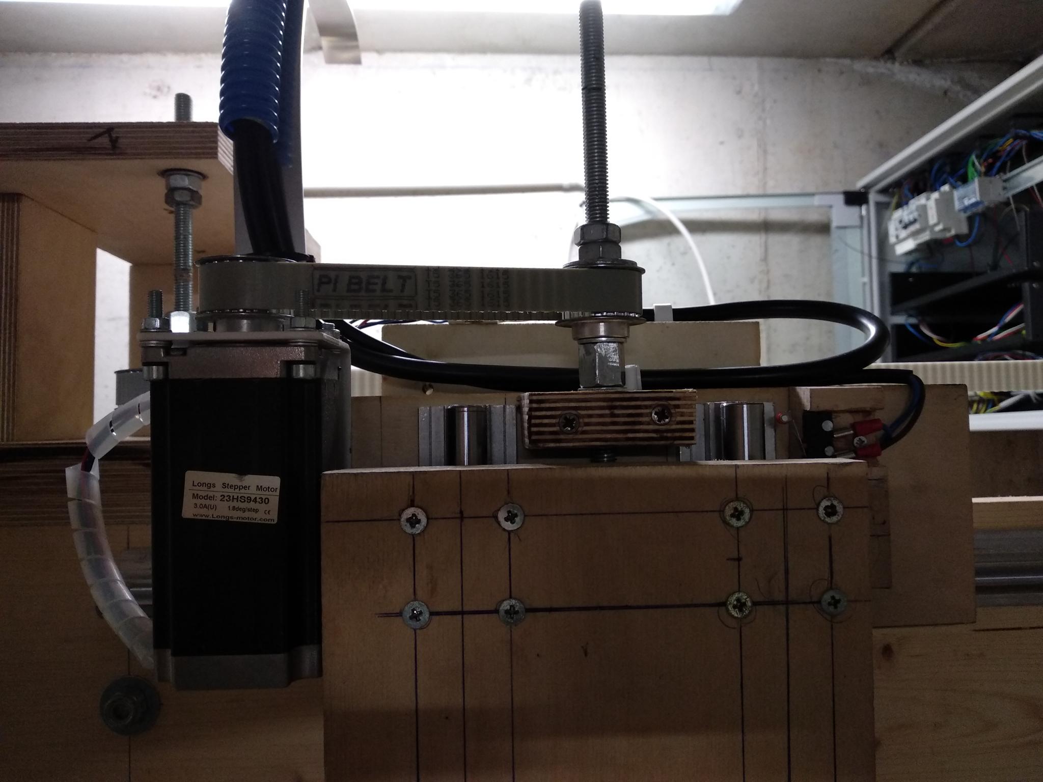

For the Z axis I have:
- a pulley 15 teeth step 5 on the drive axle
- a pulley 20 teeth 5 pitch on M10 screw
I attach photos:
Attachment 24801
The information I miss is:
- How much should you set the driver for? (from what you say 8 could be an optimal value)
- Once the driver has been set how to calculate the "step for" parameter in the motor tuning section of mach3. (My idea is to do the theoretical calculation, and then use the "auto-calibration" tool of mach3 to adjust the value.
For speed / acceleration I thought I would try some values until I found the optimal ones. (unless there is a formula to calculate these two values)
How can I get these values?
Thanks again for the advice and patience XD :thumsup:
Re: Nema34 - DM860A Driver & Mach3
OK, so X and Y are belt drive and are a different problem.
On your Z axis you say M10 screw. Do you mean a piece of threaded rod with the normal coarse pitch of 1.5mm?
If this is so then on your Z axis 200 steps -> 15 (driving pulley)/20 (driven pulley)x 1.5 mm of movement = 1.125mm, so steps per mm is 200 / 1.125 = 225 (note this is steps per millimetre). If you then use microstepping, you will have to multiply that by the factor you set in the driver DIP switches. (other forum members - could you check this as I am tired today, I have done some work and I am not used to it :unconscious:)
I will get to the X and Y later.
A lot of information is here http://www.machsupport.com/wp-conten...all_Config.pdf

Is this calculation valid even if the pulley on the threaded rod has not been tapped but is held in place by nut-locknut?
I attached a photo for a better clarity:
Attachment 24809
Channel
Attachment 24809
Only if the pulley does not slip, and that arrangement looks as if it will do so at some time.
You are only using threaded rod on X and Y as axles, so the pitch is irrelevant.
I have yet to get my head round the X and Y axis arrangements, but it looks like the belt attached to the axis will move 200mm per turn of the axle, but you are geared down 3: or 4:1 depending on the number of teeth on your drive pulley. So if you are using 15T drive then your resolution is 4 steps per mm or if 20T 3 steps/mm. So I can see why you are hoping to get some positional accuracy using microstepping to increase your resolution.
I have doubts that this current design will be very accurate. You should also look at some way of fixing your pulleys to the axles other than locking nuts, are there no grubscrew holes on the pulleys ?
