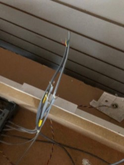

I am looking for advice/help on repairing my cnc router. I have had the machine for 3 years now and never had any problems ( touch wood ) however having recently moved the machine ( due to relationship split ) i noticed there had been some damage caused ( maybe intentionally !!) .
The Connection that came from the drive board to the PC . I believe it was a 36pin connector where the series of wires had been soldered to . So i am now left with around 18 lose connections . Honestly i have no idea where to start , with sourcing the correct replacement connector and where each of the wires is then connected so any advice would be greatly appreciated ?
on the other hand does anybody know of another way around this , like can i buy a replacement unit to avoid any re-wiring etc as i am a complete novice in these aspects !!
or does anybody know of a company/persons that i could contact to repair.
Attachment 24802
Attachment 24803

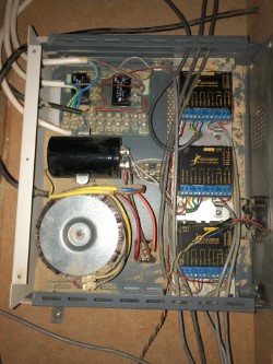

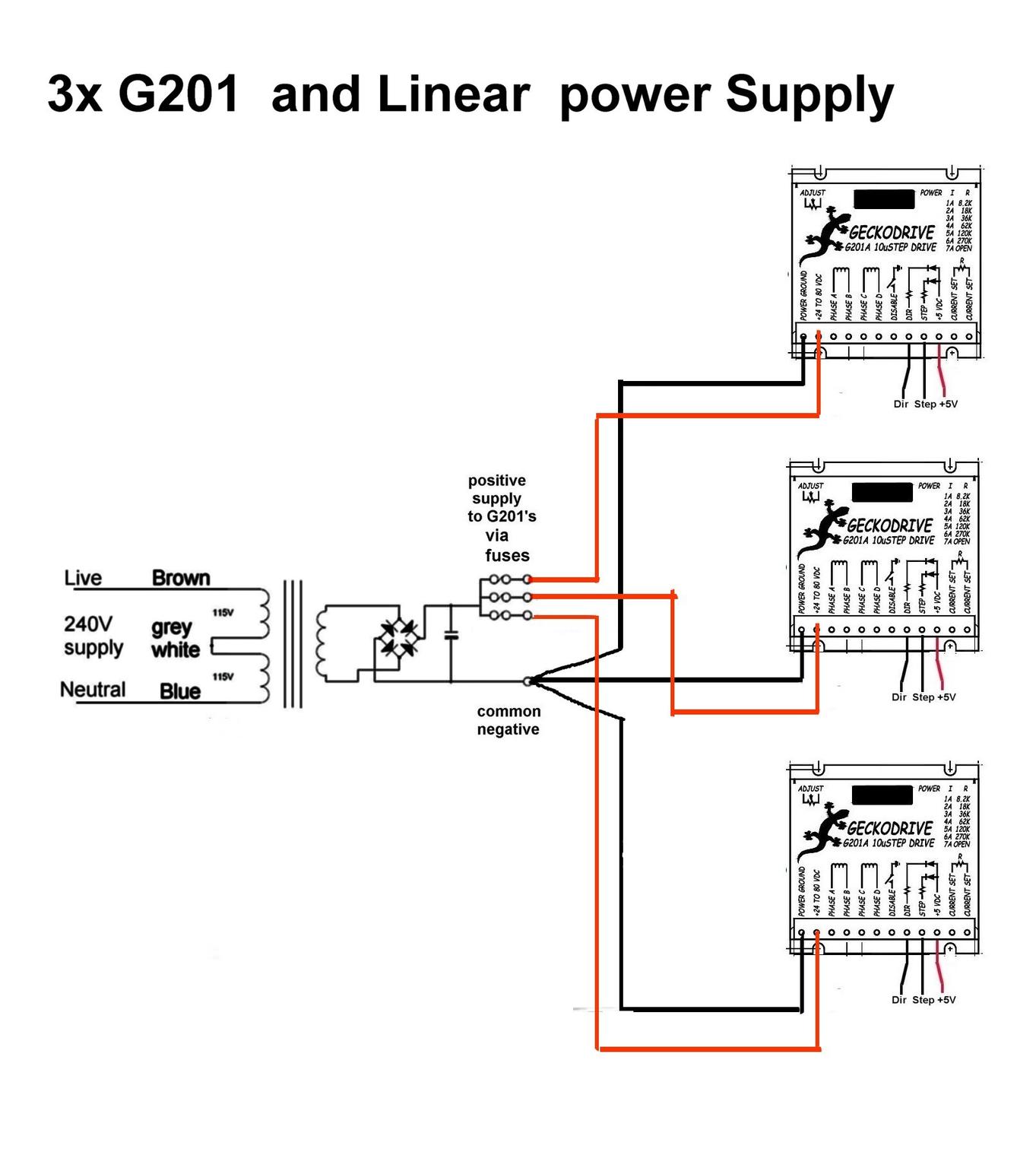

is this the stepper drivers in your control box ?
Attachment 24804
do the two solid state relay switch the spindle & dust extractor ON & OFF
with no control of the spindle speed
some thing like CNC4PC's
C10 break out board should do all what you need

Thanks for your reply , yes that's correct the cable from the printer port went to a female 36pin connection then from the cnc those series of wires went into a male 36 pin connector. This is where all the wires were soldered too . Attachment 24805

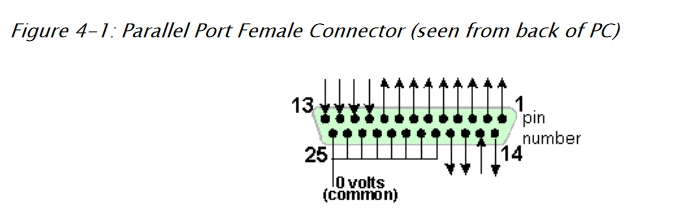

3 Attachment(s)
Re: New here . Help/Advice on Cnc Router repair

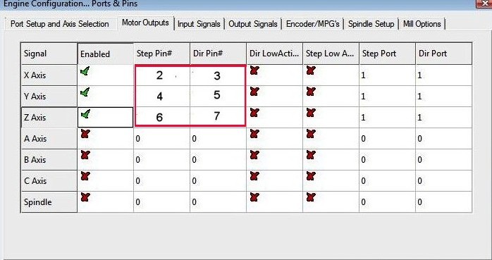

Yes , in Mach3 the first printer port can only provide 5 inputs (for E-stop & limit switches etc)
and 12 outputs that you can assign to control your motors , relays etc
printerport pinout
Attachment 24808
PDF manual
http://www.machsupport.com/wp-conten...all_Config.pdf

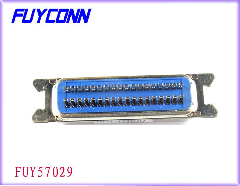

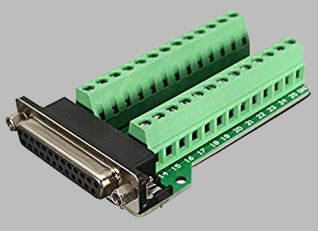

I assume when your machine was built
printers and printer cables had the original 36 way Centronics connector
to connect to your PC's 25 way D-type printer socket
use a 25 pin male to male printer cable and
to save soldering a connector / adaptor like this :-
https://www.ebay.co.uk/itm/222305065110
Attachment 24806
the 25 way D-type connector are less expensive than 36 way centronics connectors
In addition you need a +5V supply to connect to the G201 stepper drivers & solid state relays
this can be taken from your PC
as can a 12V supply for the fan
John

this is the Mach pins & ports page to find the pins assigned to control your stepper motors
Attachment 24807

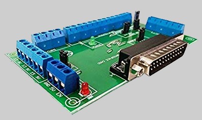

Hi Adam
you only need to use the C10 BOB or screw terminal 25 way socket
not both
the C10 BOB has the advantage of buffering the inputs & outputs to & from the printerport
also it gives the printerport some protection
the 3 year old PC I an using to connect to the net has a printerport that works at 3.3V logic levels not the 5V levels of the old IBM PC I have for CNC projects
when you moved the machine did you lose a 5V + 12V power supply ?
its possible to take the supply from the PC
John
Hi Adam
Just double checked and the C10 has a 25 pin plug
Attachment 24810
to connect it to the 25 way socket on a PC
you need a printer extension cable with male and female ends
not a printer cable with two male ends !
John

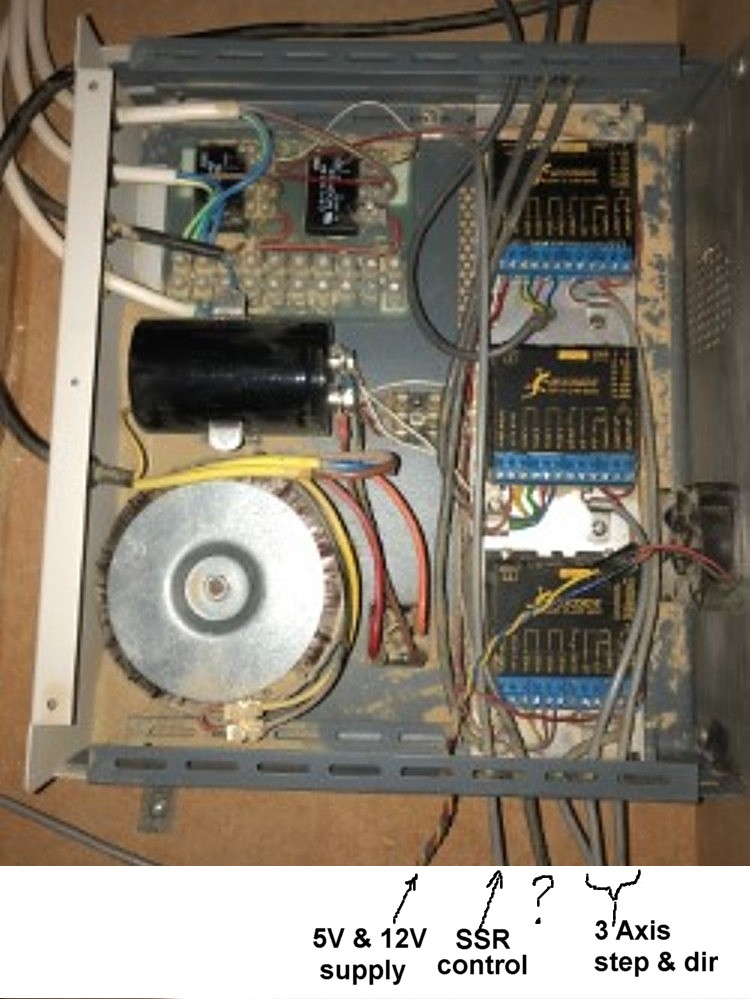

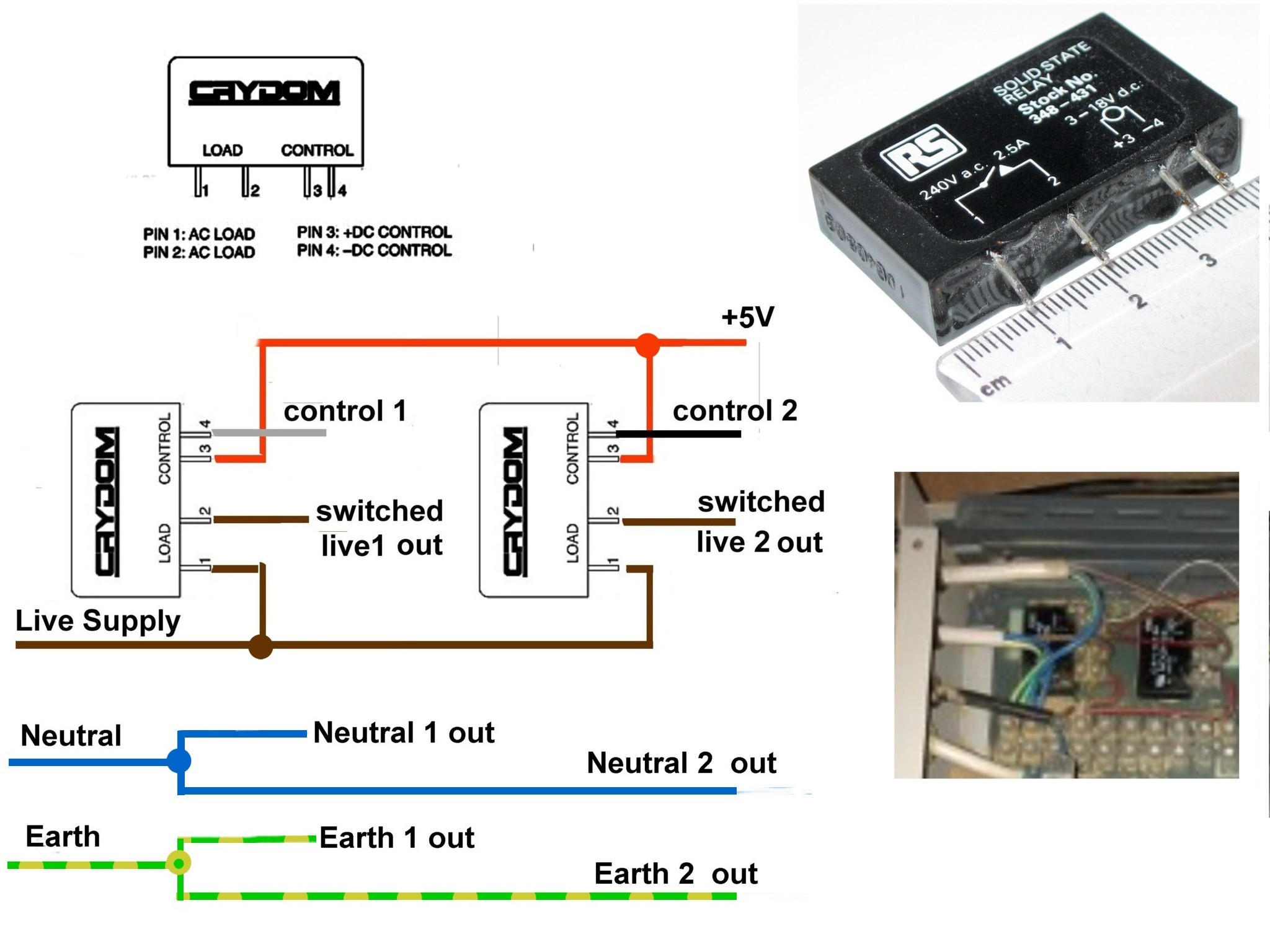

3 Attachment(s)
Hi Adam
while your photo is a bit too low a resolution
this a little more of the wiring of your box
from what I can see
Attachment 24811
Attachment 24812
Attachment 24813
John

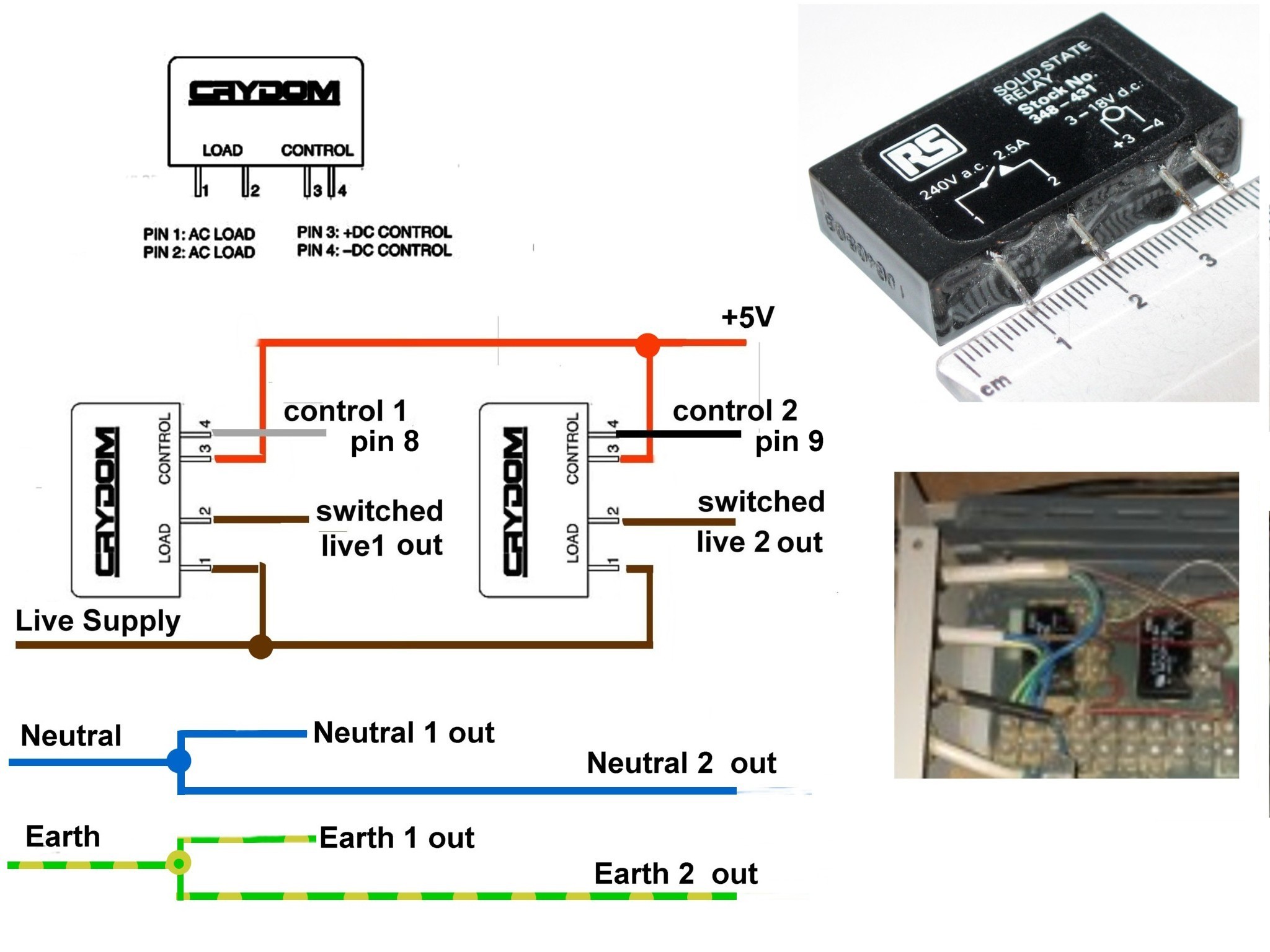

Hi John , have managed to wire in the x,y,z pins corresponding with the pin table in Mach 3 however I’m not to sure where to place the ssr control that you have noted on the above picture ? Where would I find the correct PIN numbers for that ? Thanks in advance
Adam
Hi Adam
I would expect your Mach3 software will have
2 outputs assigned some thing like this -
Attachment 24859
if your using pins 8 & 9 for example
they will need be set up as active low
Attachment 24860
John
