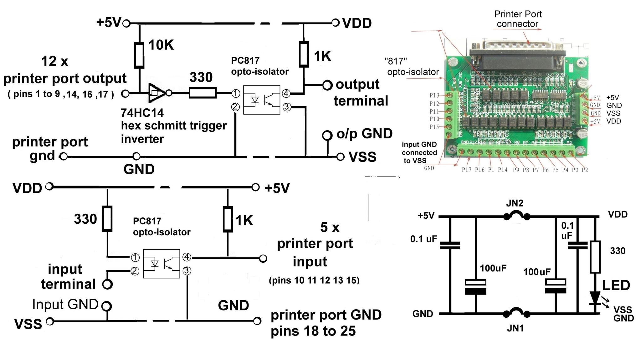

5 Attachment(s)
Re: Longs 3 axis CNC kits - are they suitable for Bridgeport Series 1 conversion?

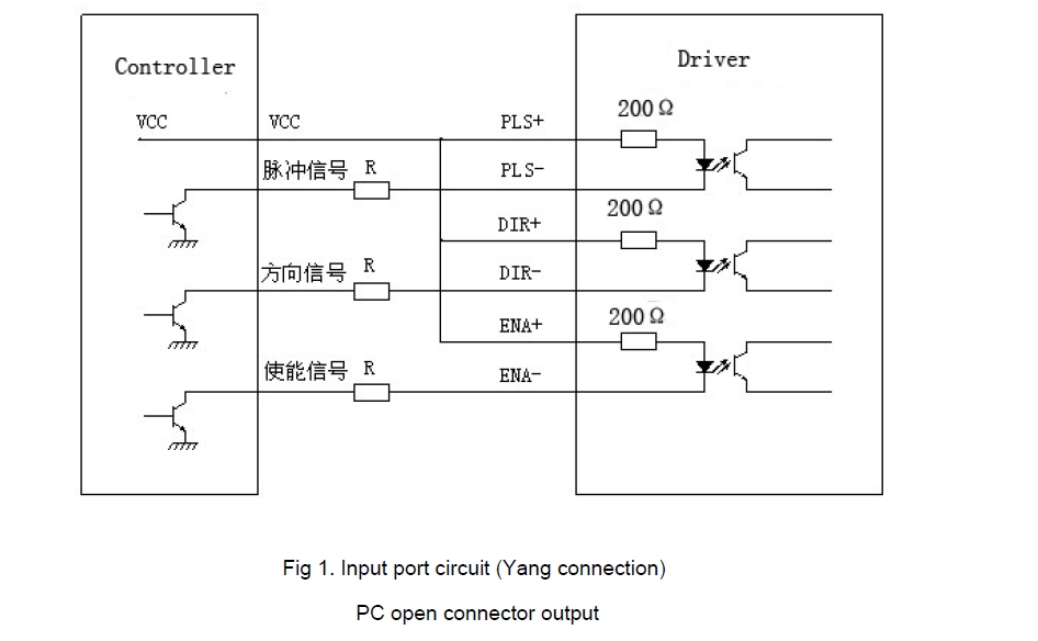

with stepper drivers like the dm860a that has its own input opto-isolators
Attachment 24997
you don't need a breakout board with output opto-isolators like this supplied in the kit-
Attachment 25001
these two BOB's only buffer the printer port outputs and only opto-isolate the 5 inputs -

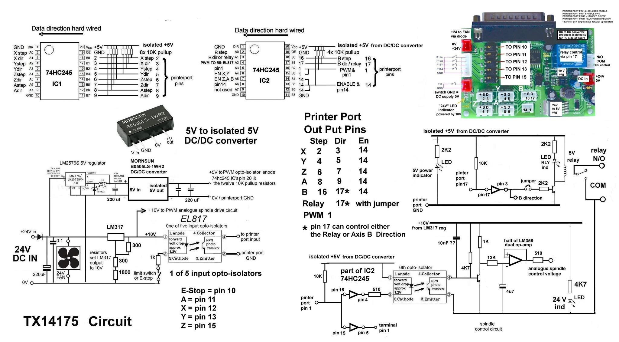

a breakout board like this found in some of the ready made control boxes
Attachment 24999

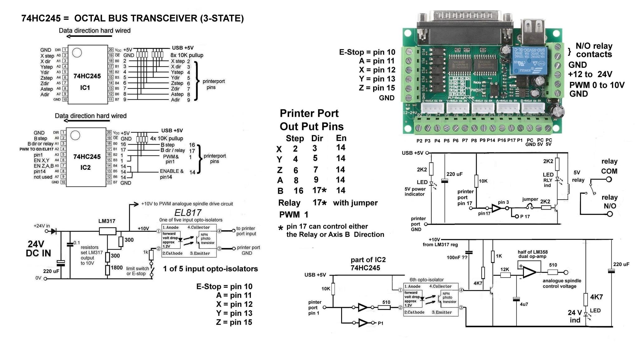

the closest available on ebay is something like this
Attachment 24998
note it does not have the 5V DC/DC converter found on the TX14175 and requires another power supply
the least expensive change will be the breakout board but it may not make any noticeable
difference when using the original motors and drivers
As I don't have the longs kit to test, I don't have a definitive answer but
problems the original breakout board will only show up at high speeds
the original motor / driver combination may limit the maximum motor speed first
without going through all the stepper motors , stepper drivers and power supplies on sale
its not easy to say which is the most cost effective change
using a higher voltage supply & stepper drivers verses replacing the motors with lower inductance motors
John

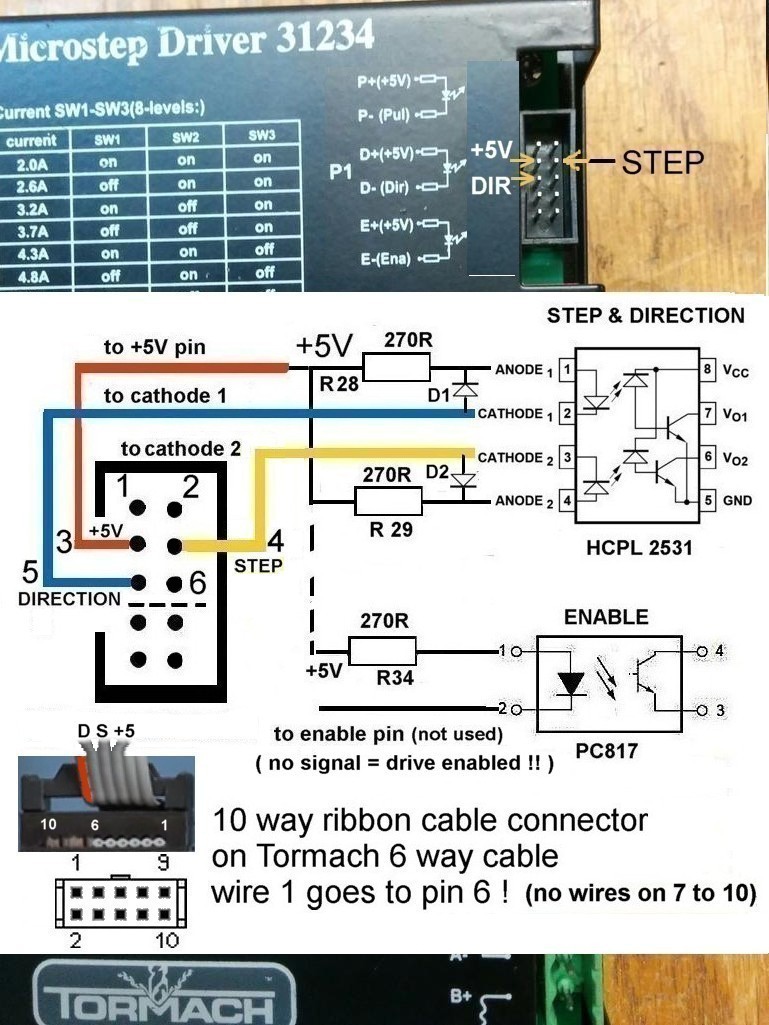

adding more detail to post 7 for any one wanting to use a BOB with opto-isolated outputs and stepper drivers with opto-isolated inputs
the problem with the BOB supplied as part of the kit is ue use of the slow PC817 opto-isolators used for the outputs
I would expect the DM860A stepper drivers would have a PC817 on the enable input and a high speed isolator like a HCPL2531 for the step and direction inputs
as used on this Tormach driver input
Attachment 25010
the diagram is from
https://www.cnczone.com/forums/torma...ml#post2107952
if I used a breakout with opto-isolated outputs then I would look for a BOB like this -
https://cnc4you.co.uk/resources/Brea...ard%20HG08.pdf
or this
http://www.electronics-lab.com/proje...r-cnc-routers/
they are just two of example found
