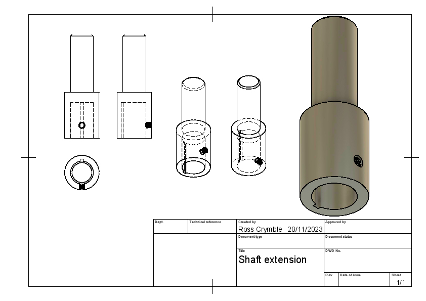

Had 2 different thoughts on pulleys. ( but that's all they are right now.)
A) Make a shaft extension piece and stick original gear on the
end. ( quick & simple, but depends on length)
B) Make a new gear with an extended boss.
( seems a more engineered solution, but more expensive
and a lot more time to machine from solid. Also I would
have to make a single tooth form tool. Fortunately I already
have a H/V rotary table with dividing plates)
Sickeningly, this would be a great job for the 4/5 axis machine that I hope to end up with:disturbed: ,but isn't that always the way!
Re mounting, my servo motors have a stupid raised boss on the front face. Going to turns this off in the lathe.
X & Y axis should be OK with a flat face.
Z AXIS mounting plate is part of main head casting and has a circular pocket machined in to accept the old SEM motor. ( no way I am stripping that lot off to mess with. Thinking of just making an exact size disk to drop into pocket to level out the surface. Then bolt motor straight on.
The bolt pattern on new motors is a little larger, so just thought of rotation the bodies 45°, marking and drilling a new PCD to suit.

Thanks. I was thinking the same for Z (mine is off however) so if I Can get my spindle to fit in there, ill enlarge the holder. The problem with your approach might be the shaft length as the motor is moved away from the pulley location (might be OK, pending on what you do with the shafts).

How are you going to make up for the shorter shaft? Our machines look identical, apart from your slightly more powerful motors.

2 Attachment(s)
Re: Bridgeport Series 1 Interact. Refit/update . Opinions please.
Hi, really glad to find this thread as I'm currently planning to swap out the motors on my non working Interact 1 series 2. I see the problem with the short shaft lenghts on these new Chinese servo motors. What route did you go? I was thinking of making shaft extensions something like this and re-using the 12t stock pulley but would the over hang be too much? Cheers Ross
Attachment 32020
Hi. for X and Y I used Panasonics with standard shaft but its not great. For the Z, I used the next motor up (1KW Panasonic, overkill) for the additional shaft length.
Suppose if you can get the shafts with a good tolerance and some grubs, it would be OK.
