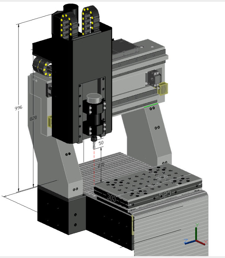

Its been a while since I popped in here, I am working on a new milling machine build. This not a light weight design. It has been designed to work with steel or Aluminium depending on the spindle fitted.
Alas the thread describing making i will be huge by the time it is finished so posting on multiple forums is difficult.
I have posted it at another place nearby. https://www.model-engineer.co.uk/for...?th=139042&p=1
You may find it interesting.

I have a couple of comments and questions about your build:
I really like the rail alignment cams - did you make these or buy them? They are going to be great for both alignment and increasing mounting strength of the rails.
The Z axis travel seems a bit short compared to your other travels. What sort of spindle / tool holder are you going to use?
What was the cost of the laser cut steel? Do they cost it per cm cutting length or similar? I'm interesting in getting a milling head and gantry beam laser cut. I'll probably use square hollow section for the base however.
I had them laser cut from 4mm steel they cost about 50c each the laser cutter provided the material
I drew in an Asian high speed spindle fine for Aluminium Brass and plastics and fairly low cost. I also plan to build a 30 or 40 taper spindle, Possibly using the high speed 2000 rpm spindle with a 4 to one reduction belt drive. I also have a large Manual V Mill, It is easy to make the Z axis taller I decided not to as this machine will be used for smaller parts. Shorter = less deflection
Laser cutting cost of the machine parts was about $500 including material plus the molds that cost more I am sharing the cost of the molds. 160+ part files is a lot quite a few of the parts were in multiples. looking at it that way the cost per part is modest. FWIW the cost per kg of parts was AUD $3.85 All up inc GST/VAT. I would not try to use that figure it will depend on the mix of parts, OK I guess as a ballpark.

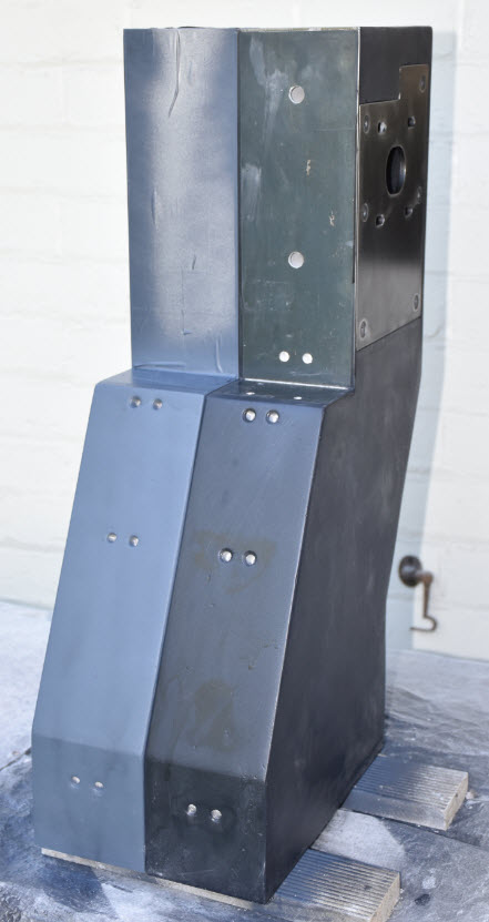

Hi All
I just completed the columns for the mill next is the base, an exciting step as for the first time the frame of the machine can be tested.
I have a full write up here.
https://www.model-engineer.co.uk/for...?th=139042&p=2
Attachment 25326
John

Hi All
At last the base, columns and cross-member are one and I don't believe I could achieve the level of accuracy obtained without a laser cut mold.
https://www.model-engineer.co.uk/for...?th=139042&p=3
