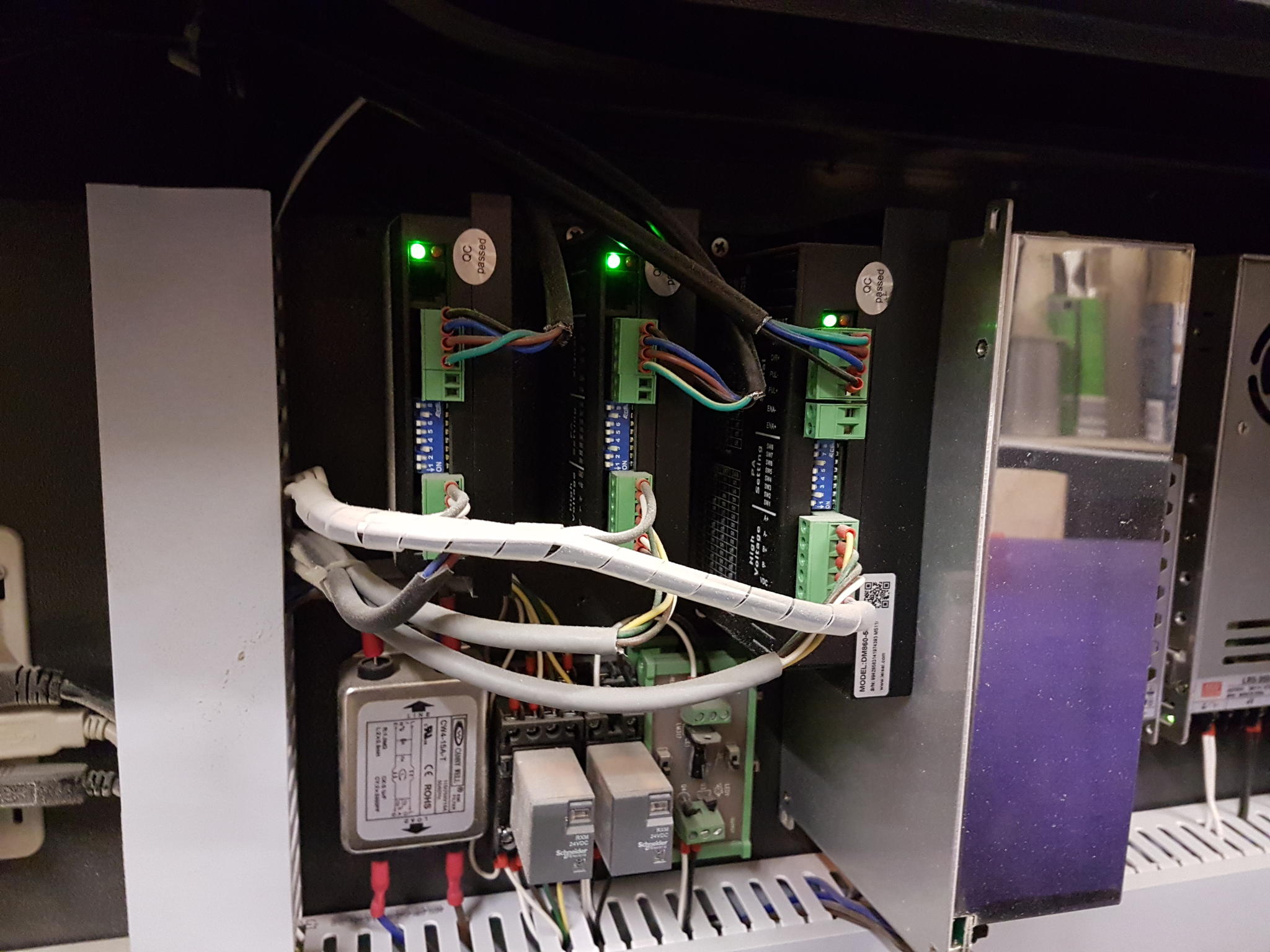

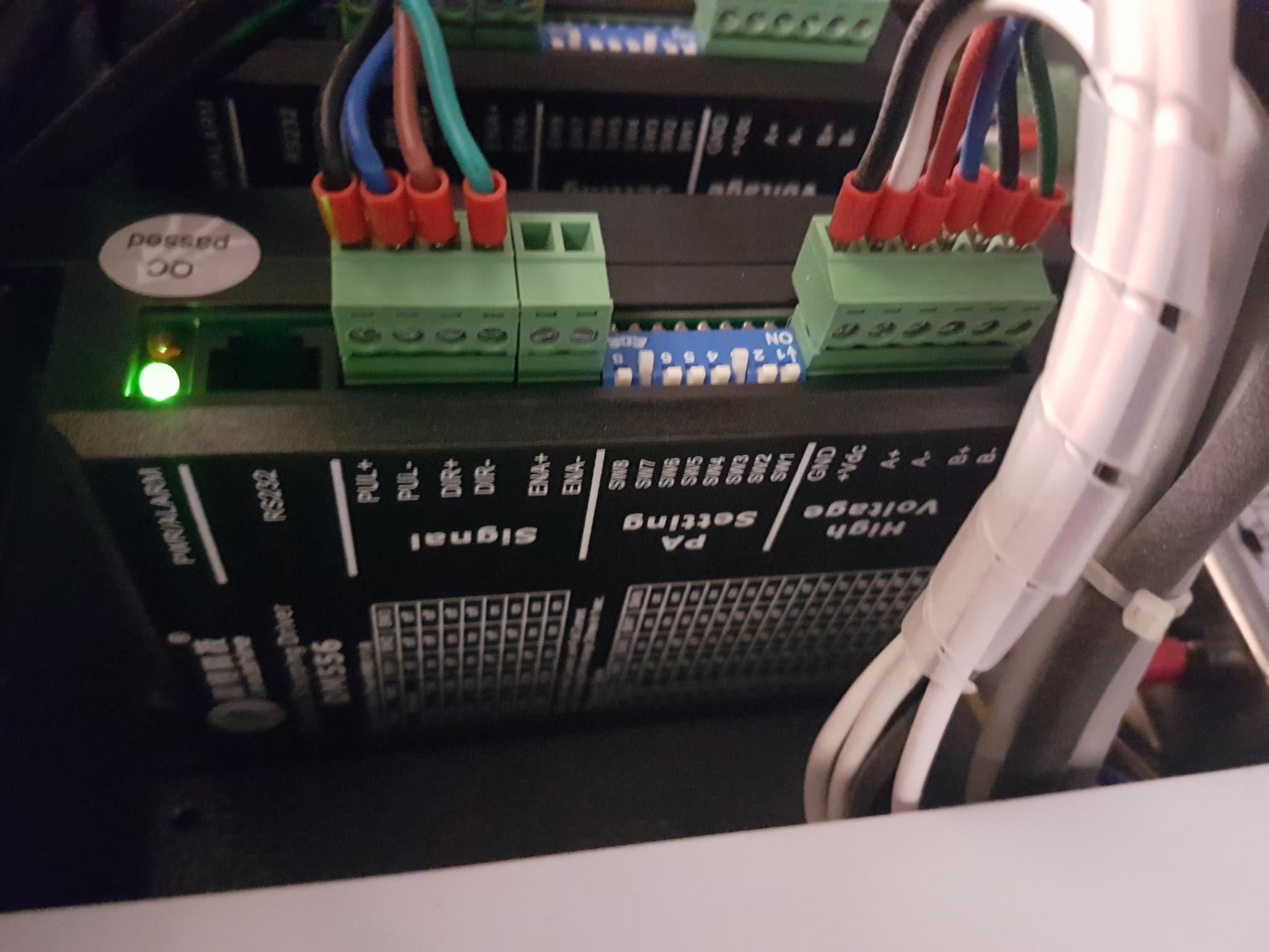

So my laser machine has developed an almighty vibration when moving the y axis back and forth. It runs off of a single motor mounted in the center of the machine, attached to a pulley which then transfers into a shaft through couplings and runs dual belts either side...if that makes sense.
We were running some precise but elaborate work this week at 150mm/s and I think this has damaged the motor, everything else seems to be fine so I am guessing that this is the issue.

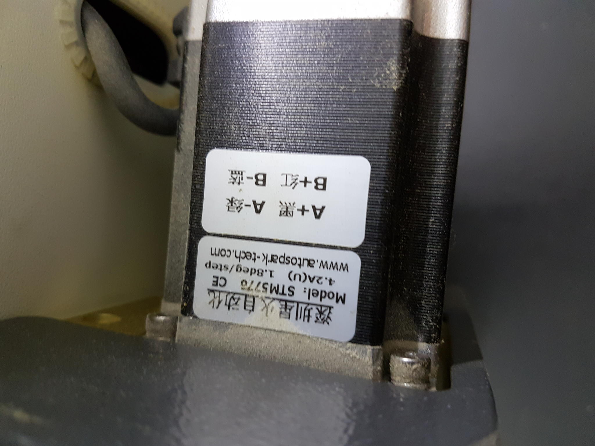

The motor has the following on the sticker...
Model : STM5776 CE
4.2A (U) 1.8deg/step
www.autospark-tech.com
A+ A-
B+ B-
I have had a google and can only find a couple of pages that don't have any specs that I can figure out. Have any of you seen or used one of these? Any ideas on what I can use to replace it? It is running off of a DM556 if that helps any

and going by the label motor current = 4.2A
the NEMA motor sizes relate to the physical imperial dimensions
so a NEMA 17 will be 1.7" square and a NEMA 34 will be 3.4" square
John

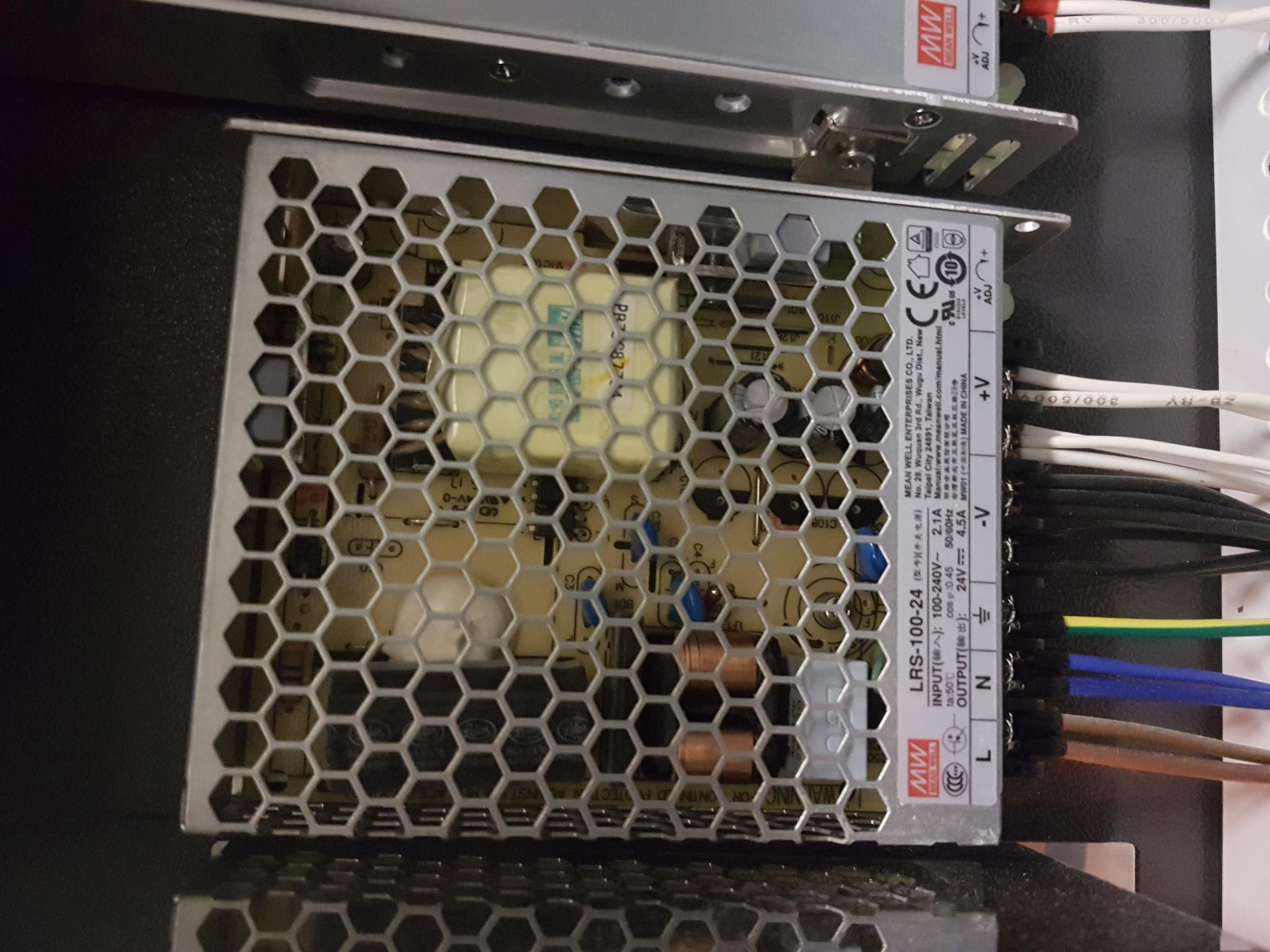

I have two power supplies in the machine, one with one live, which I am assuming powers the Nema 34 which raises the machine bed and one with 2 lives coming from it which I am assuming powers the 2 Nema 23s for the X and Y axis.
This is a.....
LRS-100-24
Input 100 - 240
Output 24v @ 4.5a

24V is lower than the 36V I expected
what is the other power supply rating
have you measured the supply voltage at the DM556 terminals
just in case the bootlace ferrule crimped joint has gone high resistance
John
Re: Stepper motor help...STM5776
I haven't checked the voltage but I can do that tomorrow just to make sure.
The other unit is a LRS-350-36 36v @ 9.7a

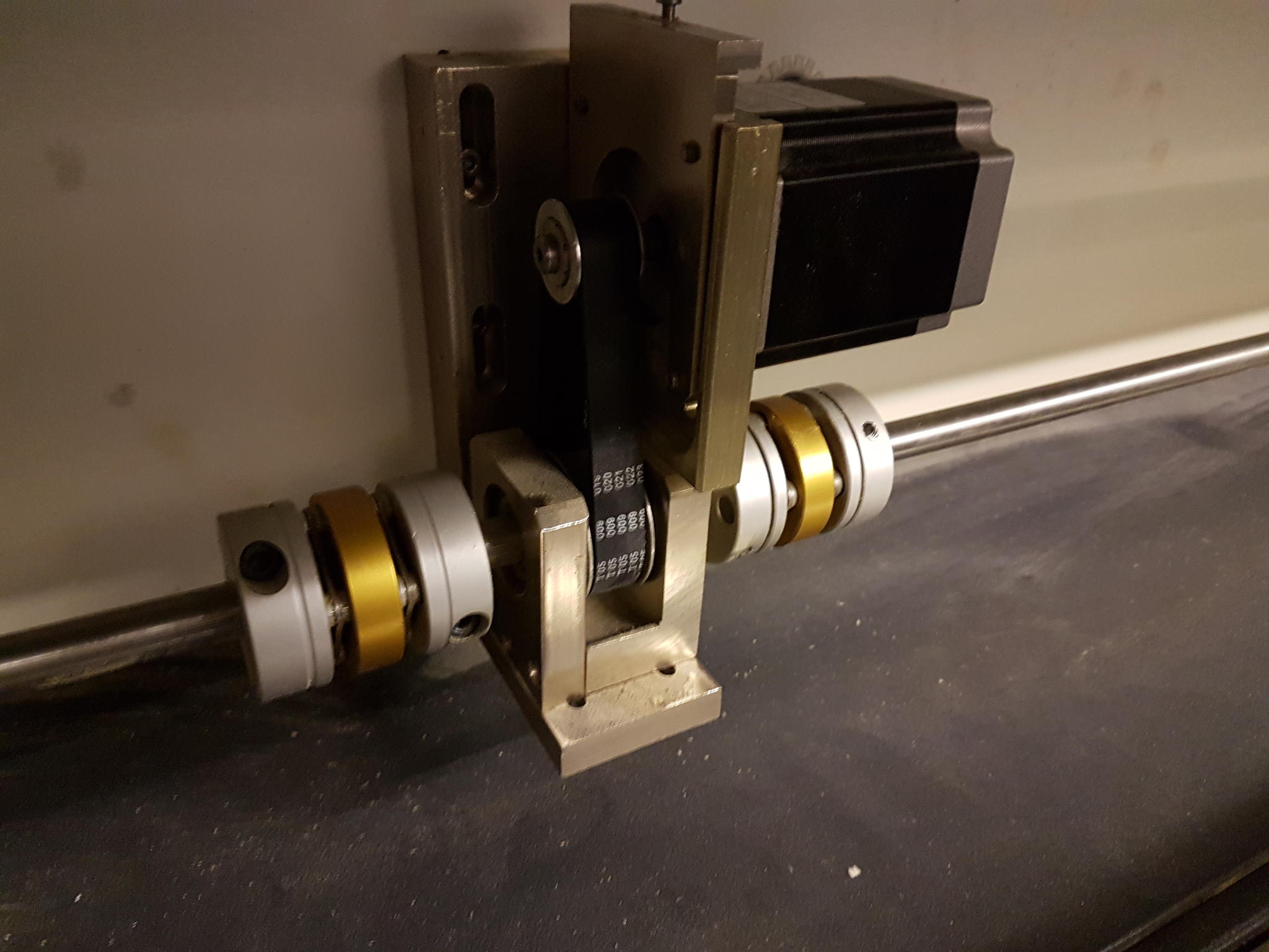

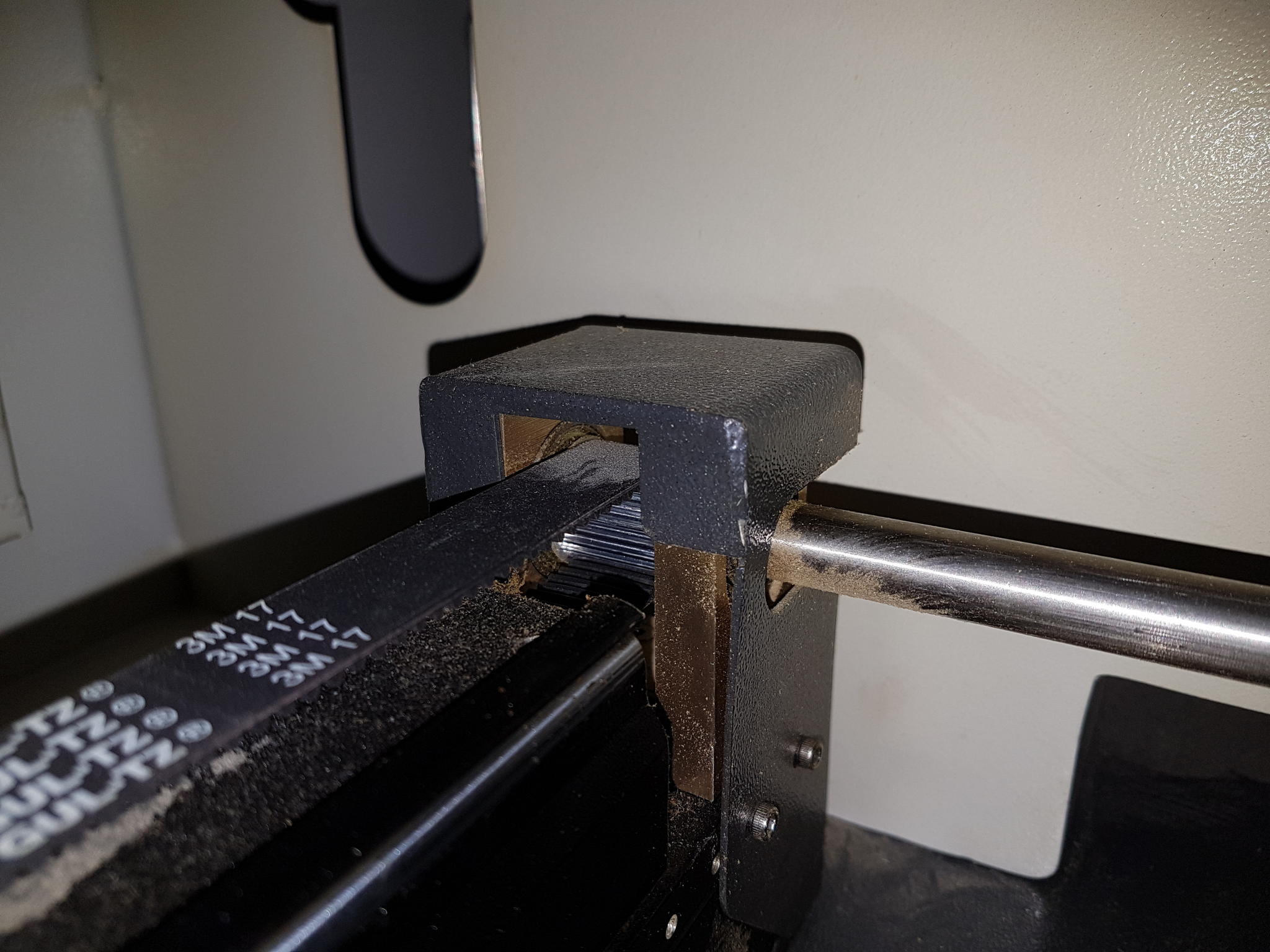

Yes all checked manually. I've just taken the belt off again and checked the following..
No discernable play in the shaft of the stepper motor.
Pulley grub screw is tight
Moved the Y axis back and forth with the pulley to stepper belt off, everything felt smooth, checked the bearings as best I could but they look fine. They are 6001Z and the shaft is supported twice, either side of the belt pulley at both ends if that makes sense.
Ill take the main Y belts off in a second and see how the axis moves without any resistance at all.
Couplings adjacent to the motor seem fine, no play in them.
Here is a pic of the set up....
Attachment 25201Attachment 25202

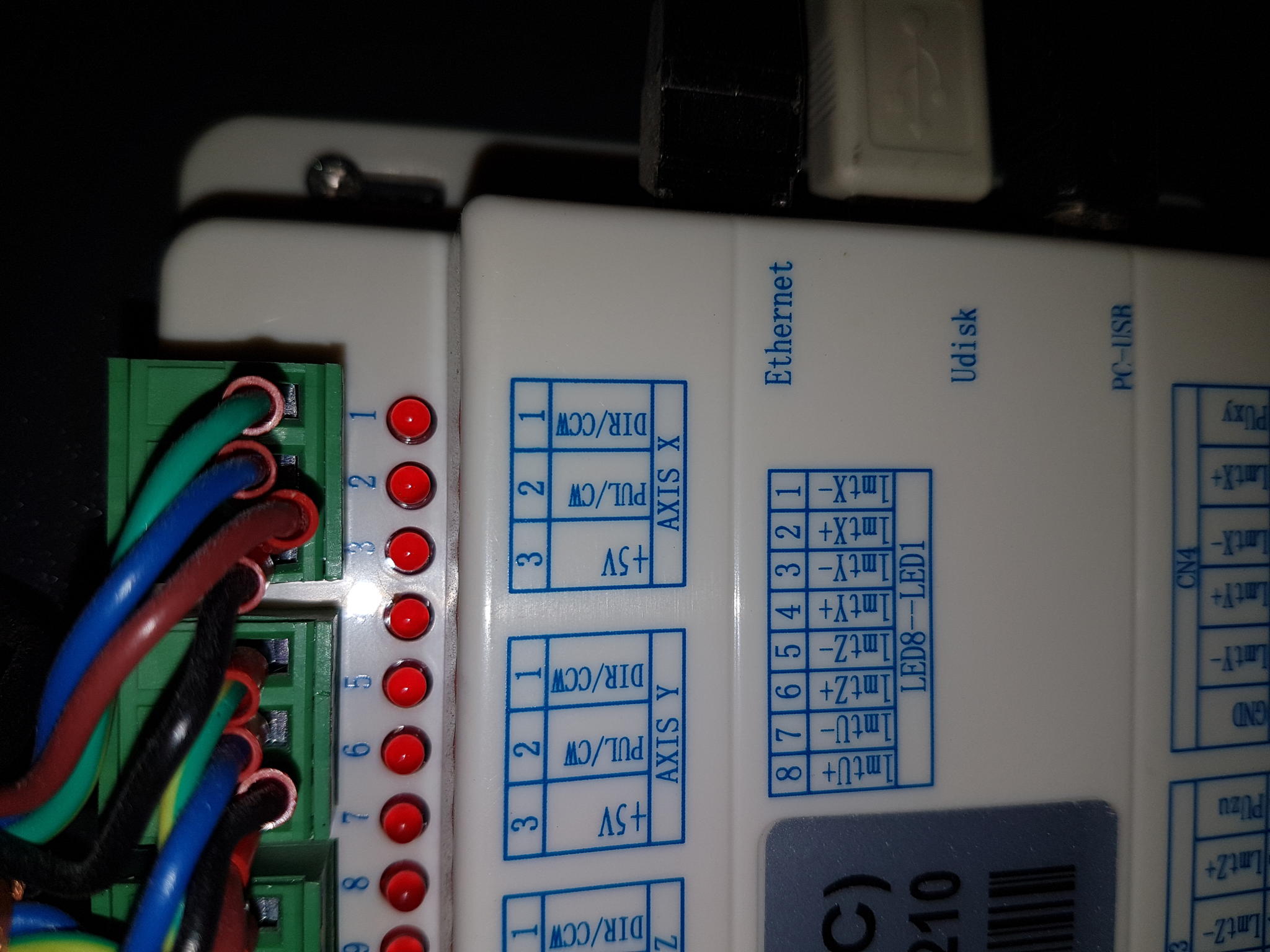

By the looks of it at the rear of the motor there is a black block connected to it which has a single black sheathed cable going through the panelling and straight down to the controller unit.
The wire has 4 strands, black, blue, green/yellow and brown. Black and brown are linked together in the controller, green/yellow and blue are on their own. I've attached a picture of the controller unit so you can see how they enter.
Can I just take the connecter block off and check or does it need to be at the stepper end?
Attachment 25203Attachment 25204Attachment 25205

Just as a heads up.
Took the Y axis belts off.
The Y axis free wheeled and had no resistance
The shafts did not free wheel however they moved smoothly
No movement in any of the bearings from what I could see
:dispirited:

Those are not the wires going to the motor but the signal wires going to the drives. The motor wires are connected to the black drives from your first post picture (A+; A-; B+; B-)

Could you bypass the relay and connect the motor cable directly to the drive? Blue wire to A+; red wire to A-; green wire to B+and black wire to B-
edit: You can also check the resistance between blue and red and between green and black after you disconnect them.

Better if it is possible to unplug directly the black motor cable from first picture and connect them directly to the motor driver.
