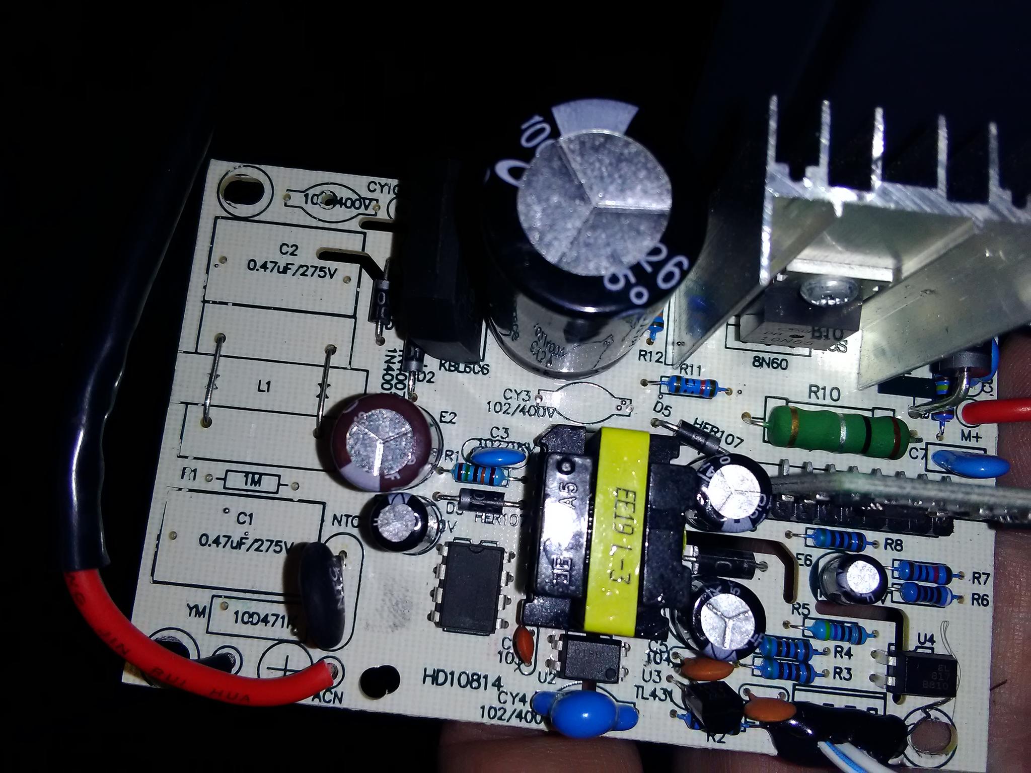

I've attached (or at least tried to) a pic of the motor controller board (any help identifying it appreciated)
The problem is I have no electrical diagram or means of identifying the board to ascertain how it works.
There's 240v ac in and dc out, then there's a ribbon lead which was previously (incorrectly I think) wired to a potentiometer.
When powered up via mach3, the 4 wires on the ribbon lead measure as follows:
wire 1 has 5v across wire 4
wire 2 has 5v across wire 4
wire 3 varies but when switched off slowly loses voltage so assume that is capacitor on the board?
wire 4 see wires 1 & 2
The spindle only spins (to 2800 rpm) when wires 3 & 4 are connected, no other connections have that effect, wiring the potentiometer in allows the spindle to be slowed manually.
I've tried various permutations, but cant get the pwm wires from the breakout board to have any effect on rpm?
Any ideas?

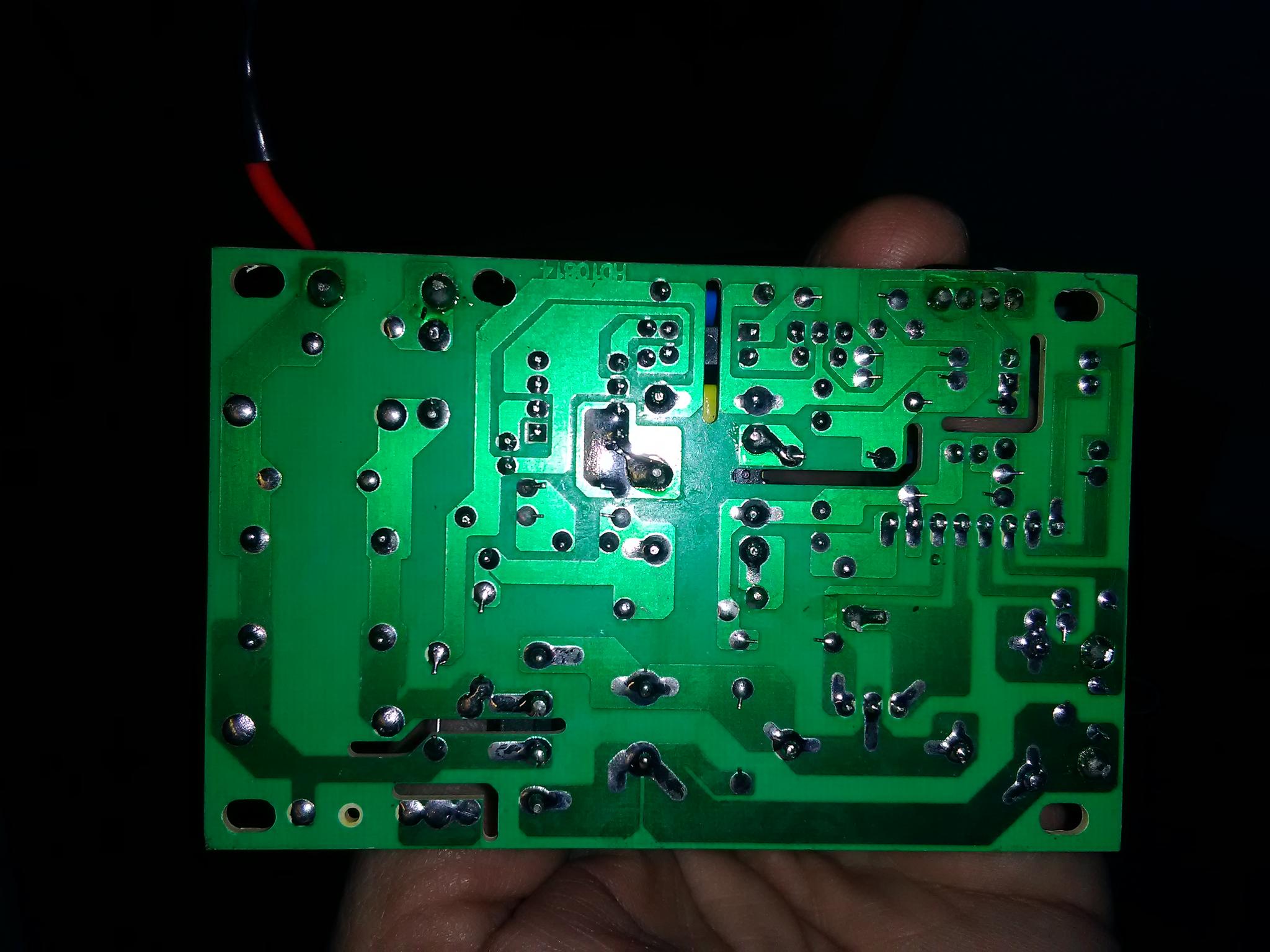

Can you post a pic of the underside of the PCB as well please - then I can probably work out what the circuits doing.
Re: pwm schematic help required please?
Voicecoil
Attachment 25484
Does this help?

Nothing more fun than trying to diagnose boards from photos :)
You're right - Pins 1+2 look to be the local +V supply from the on-board switched-mode PSU, and pin 4 is the ground. Now, pin 3 is connected to the cathode of the opto-isolator (U4), with the anode pulled up to +V via R5 (4k7?, can't make out band 3/4, think its [4][7][0][10^1]... could be wrong) - the output from the opto isolator heads off to the vertically mounted control board - which looks to be the brains of the speed control. That basically means that pin 3 is pretty much all you can use to control the motor - it could be basic PWM, or some other form of digital signalling - unclear, and would need images of front and back of vertical board to even begin to guess). What it almost certainly isn't - is any form of analogue control on the pin-3 input, so I'd bin the pot. I did wonder if the pin-3 was an spindle encoder feed-back input but the absence of any other connector would tend to suggest not.
Connecting 3-4 spins the motor?, yeah, can see that. So presumably it is a PWM input. What you need now is a PWM controller that generates an inverted output (e.g. more "Space" than "Mark" as the demand increases). The problem is that it's hard to guess what the PWM frequency should be to generate the M/S signal. Something like that would be easy to knock up on an Arduino if you have the inclination - and would allow you to explore the speed range easily. That'd be where I'd be heading next in the absence of any data on the board. You could instead experiment with (I assume you're using Mach3?) the PWM output from the BoB (if available) - don't use the analogue output. Or, re-map the Mach PWM output pin to an unused axis on the BoB and use that to drive the PWM input to the speed controller.
You say you can get the motor to Start AND Reverse?, there must be some other control/switchgear to support that - this only allows a variable 0-XX VDC to the supply, so it should be unidirectional. Is there other switchgear? (heading off on a tangent since this doesn't really address the speed control issue).

I guess this is the drive board that came with the motor??? i.e. ripped out of the original treadmill???. From what I've seen these driver boards vary a lot, from moderately complex ones that have all the control stuff on board and are fed directly from a pot on the control panel to things like this where it looks like there's no more than the power switching stage and all the clever stuff will be being done with a microcontroller on the treadmill control panel. From the information available I would agree with Doddy, it'll need a PWM signal to feed it, can you get this from the BOB and control vis Mach3 (which I know very little about, but found this which would suggest it's possible, but might need the signal inverting: http://www.audiohms.com/en/blog/item...y-pwm-step-dir).
From looking at other similar circuits I would guess the frequency would need to be between 12 and 25KHz - if you have problems doing this then it would only take a little while and about £1 of components to make a simple analogue circuit that would generate the required signal from the 0-10V O/P. Alternatively you could ditch this driver altogether and go for something like this: https://www.ebay.ie/itm/180V-200V-DC...NVdb:rk:2:pf:0

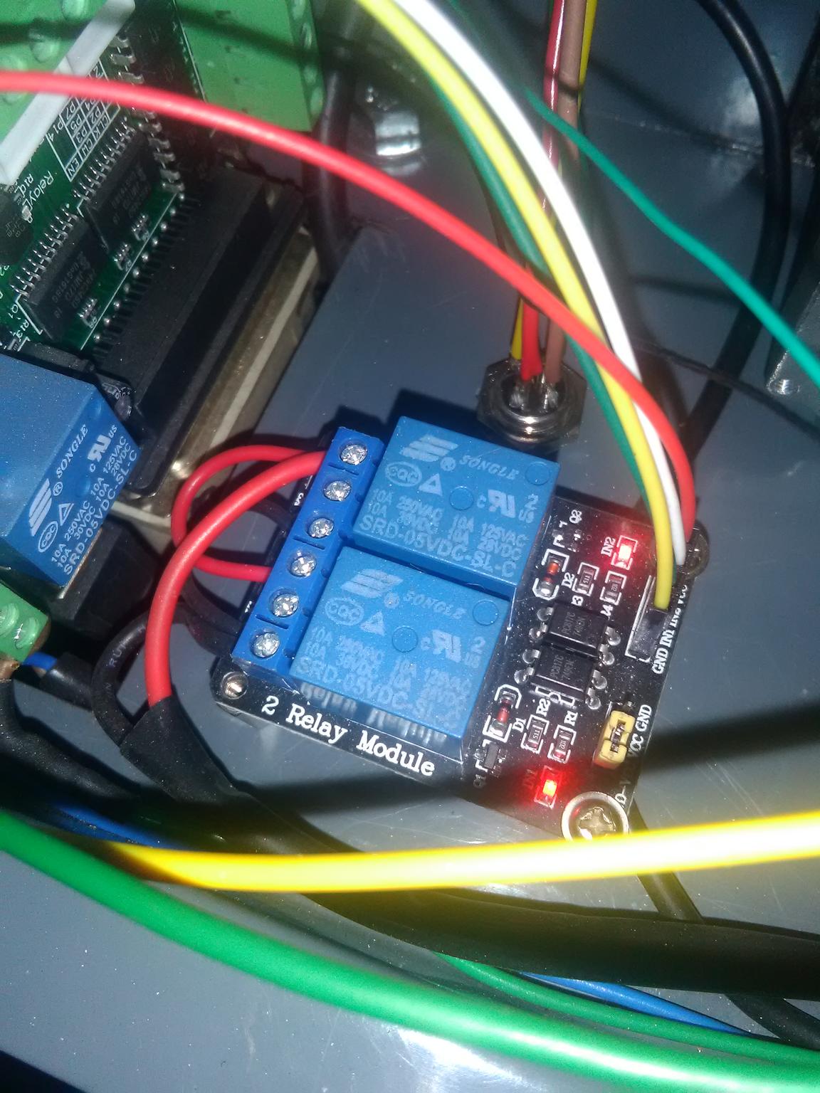

The direction is switched via relays on the other board (I assume as they click when direction is programmed), the voltage from the breakout board when I mdi input s240 m4 is 0.5v, then at s500 measures 1.0v, at s1000 2.0v etc etc.

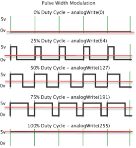

It would be instructive to measure on that same point with your meter set to AC rather than DC whilst inputting s240, s500, s1000 etc. and see what you get: if there's a decent (a volt or two) AC level there at s1000 then it's a PWM output, if not then as Doddy says it will have been converted into DC. A DC meter will average out a PWM signal and give a reading corresponding to the duty cycle:
Attachment 25494
The AC level will be zero at 0% and 100% duty cycle, but doesn't vary so much in the middle range.

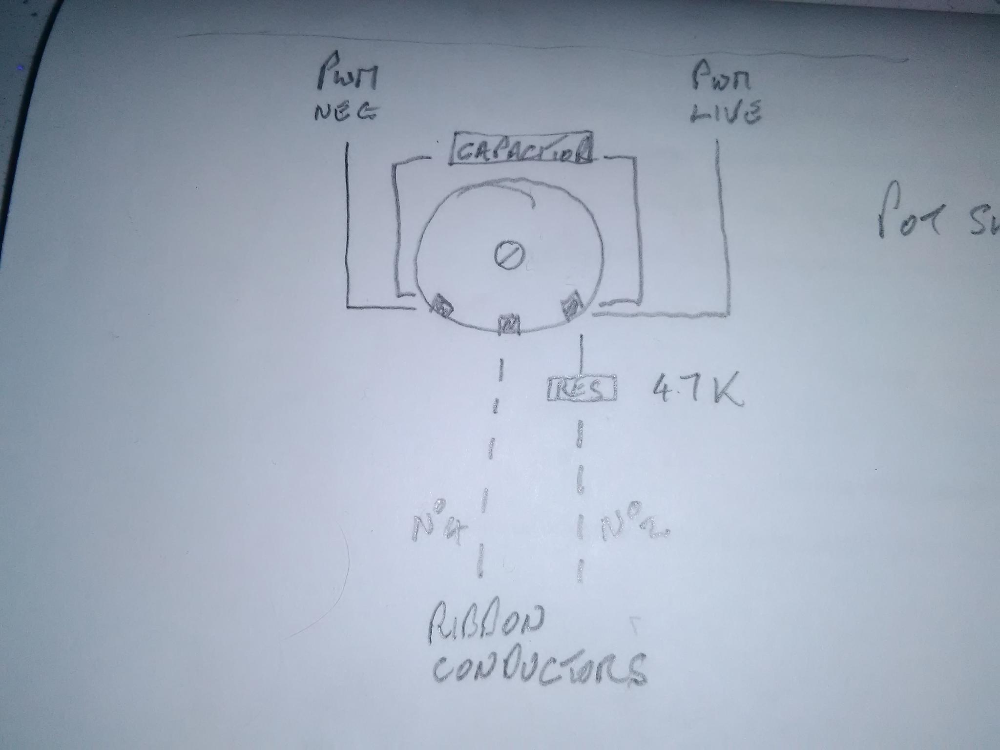

This is a sketch of how the potentiometer was previously wired up - I think its incorrect, looking at previous comments, there is NOTHING going to wire 3 (this was merely cut off), and it sounds like wire 3 is the ONLY way the PWM output can connect to the controller board? (with or without the potentiometer in the circuit)

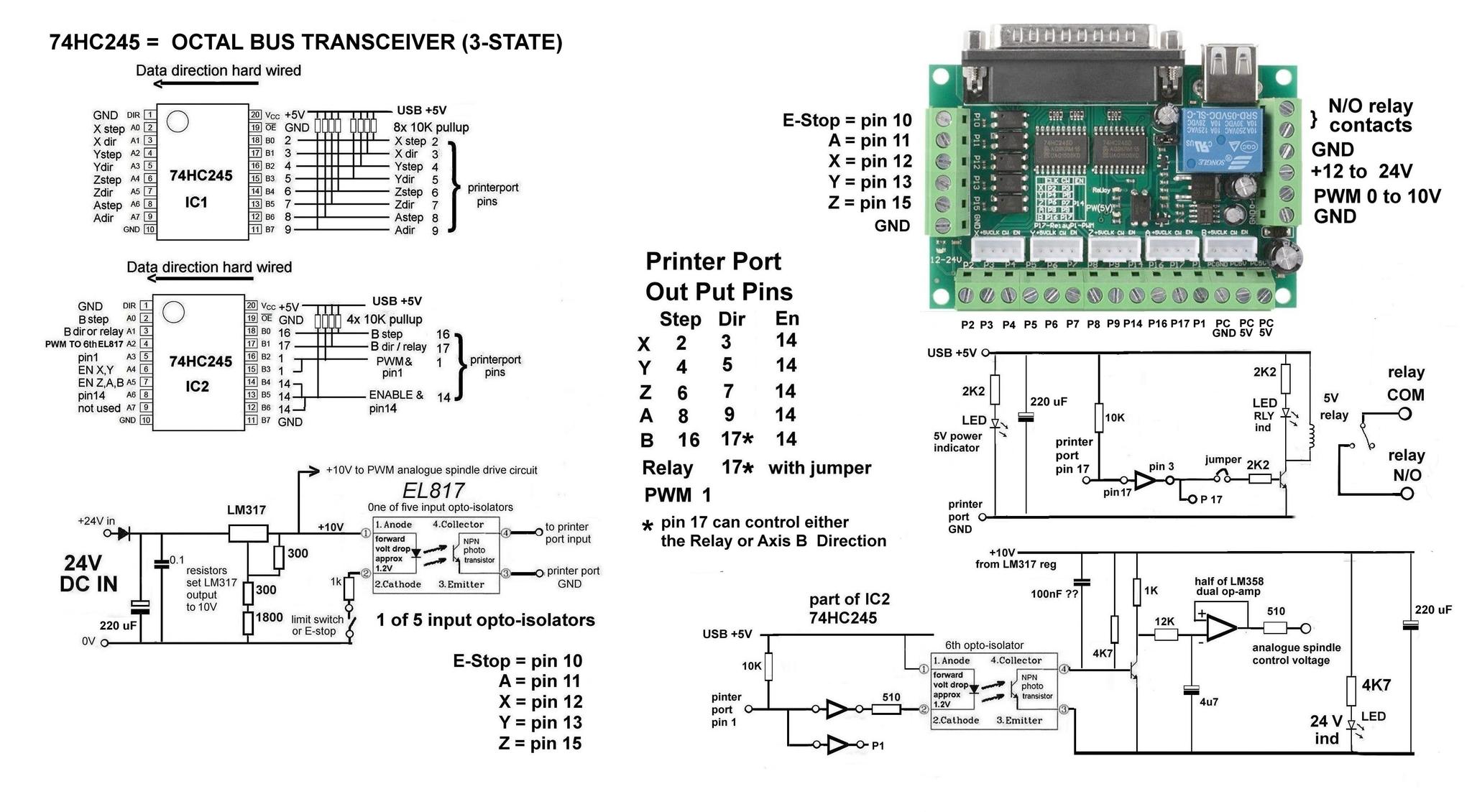

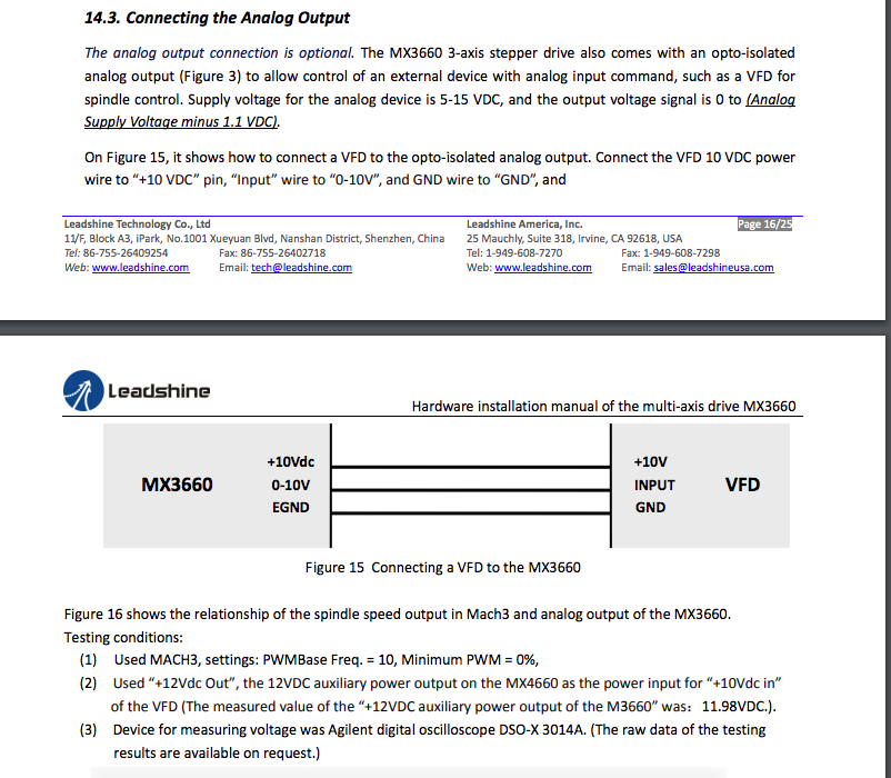

I've just done this to my MX3660 BOB and driver. The thread is here https://forum.linuxcnc.org/38-genera...-output-solved have a read through and then see how it stacks up to yours. On mine in the end I removed the whole POT circuit board and wired mine straight to the wires. If you have a spare output you can get the spindle to reverse too incase you want to tap.
Jools
If you measure voltage across the middle and right hand pin on the POT this should go from zero to 5v (or what ever the voltage in is) The missing central wire from the pot is the variable part of the voltage that controls speed. I would think that this should be wired up to your wire four from previous posts.
On mine I simply took out the pot and wired the PWM 10v in to the right hand pot connector (wire 1) (So I took my power from the machine) . The left hand ground to ground (wire 4). and the wiper to wire three. This controls mine perfectly.
Page 8 from this BOB manual helped me http://cnc4pc.com/Tech_Docs/C11GS-R1_1_USER_MANUAL.pdf though your's might differ. Though it may be the same.
This is my BOB's wiring digram though it was the same to my machine not using a VFD as they show.Attachment 25496

The original Pot set-up looks (a) to be mis-wired, and (b) likely intended to be a potential divider to scale input - whether this was PWM or analogue to a lower voltage/current. If the value of R5 is 4k7 then this just isn't needed for the opto-isolated input for any supply up to 10V (If ~= 4mA on the opto-isolator LED at 10V input). BUT, unless you get a PWM signal into it I doubt from the quick look at the board that this will give anything other than On/Off. The OP needs a PWM source.

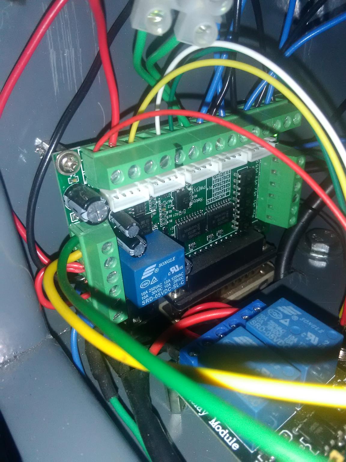

OP: On the image of your BOB - what's the label on the fourth pin from the left on the top edge of the board (after the Red/Red/Yellow cables)? - Is that P1?

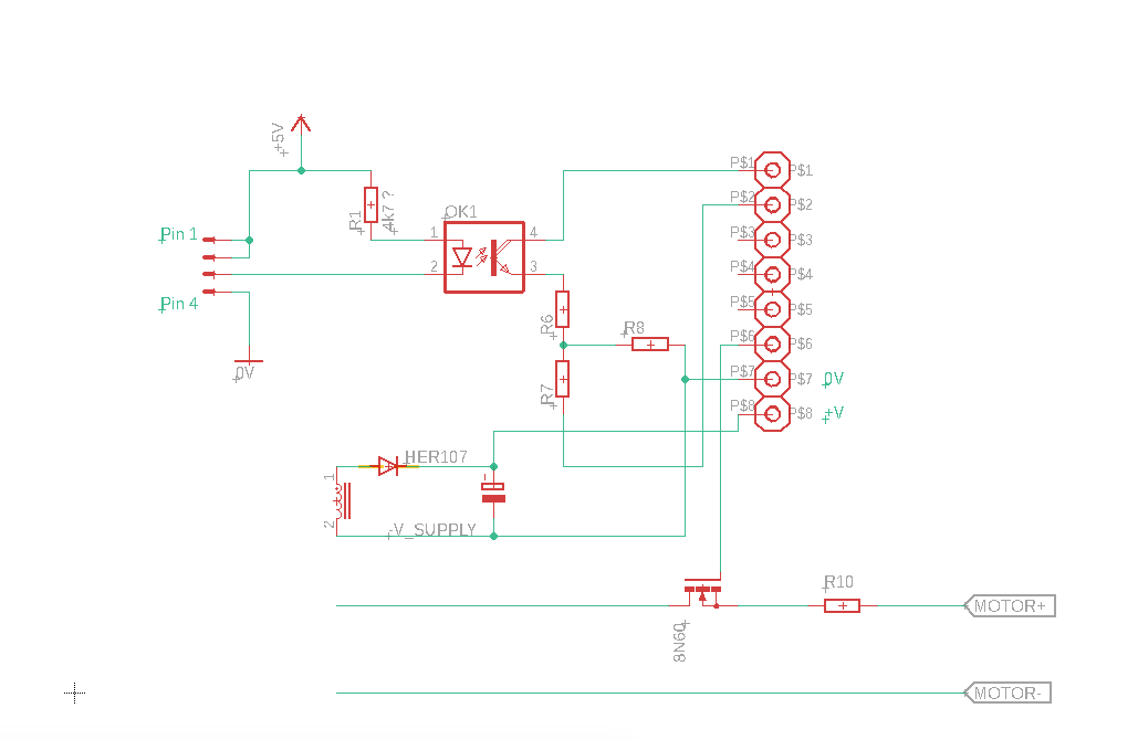

looking at the second photo in post 8
the BOB looks like this BOB
Attachment 25497
John
john swift
John
Thanks John, that's very clear and I think supports my advice above.

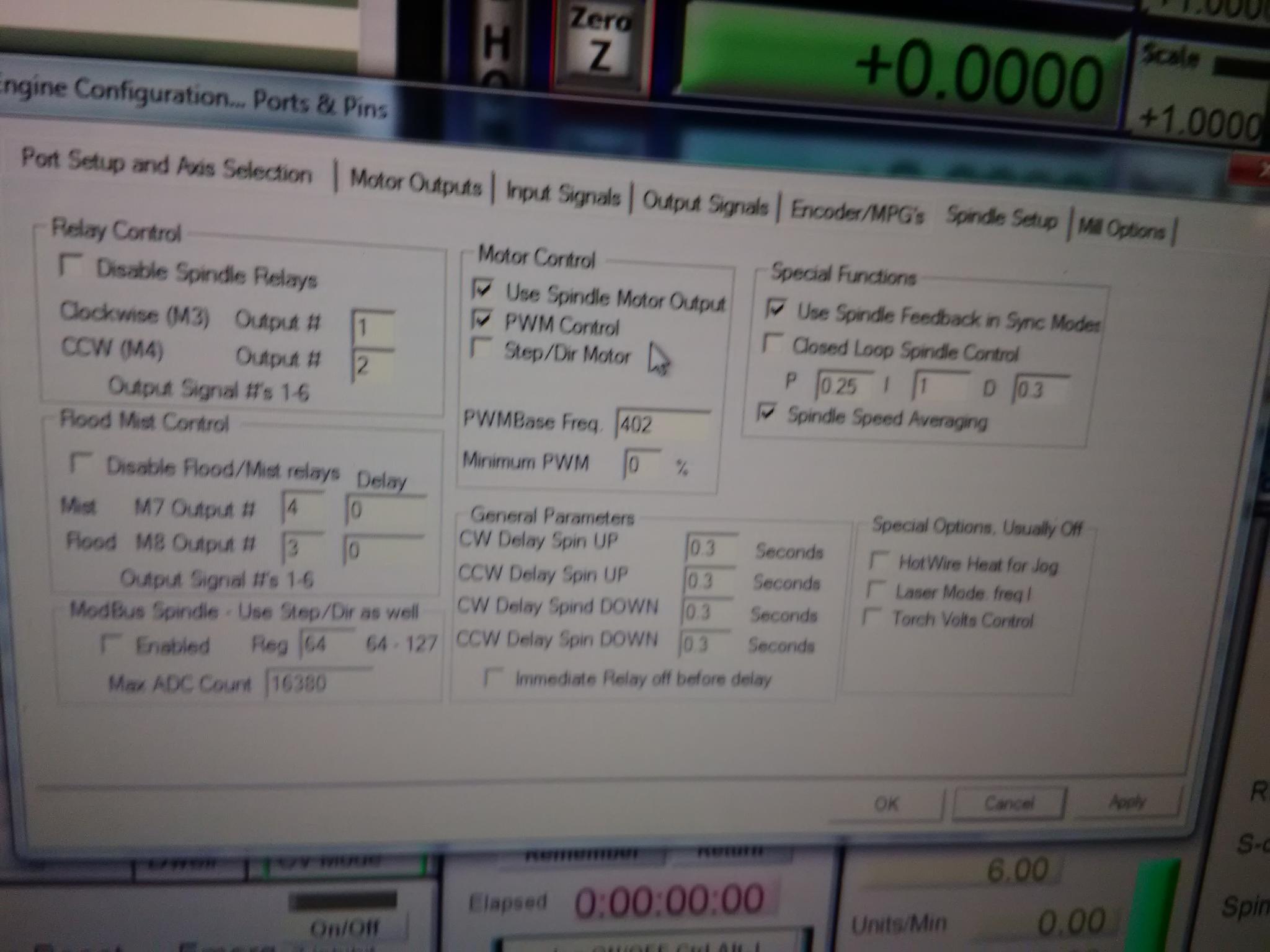

Havent had much time to look at it for a couple of days, but having read the reply about measuring the output voltage with the meter set on ac, it does indeed read 0.2v ac when programmed s1000 via mach 3 (assume that means its a result of pwm "wave"?)
Attachment 25498
As you can see pwm is activated to output on p1

Pin 1 of the BOB is connected (using the schematic from John), to two inputs on one of the octal transceivers (74x245) - inputs B2 & B3. The "DIR" direction pin on that chip is set to transfer from port B to port A. So the PWM input appears on A2 & A3. A3 is connected to the connector P1 on the BOB, and as such presents a buffered copy of the digital PWM (Mark/Space signalling) from the PC. It is this that needs to be connected to the speed controller. The other port, A2 is connected to an opto-isolator, through to the op-amp (half of LM358) which is configured as an integrator - it converts the Mark/Space ratio to an analogue voltage. This would be used for an analogue input to a speed controller (but NOT a digital PWM input).

Google Mach3 Spindle Settings to find out how to setup. What I meant by "calibrate" was perhaps misleading, my fault.
My intent, when you issue lets say a speed of S1000, that the actual speed would be a ratio of the commanded speed vs the maximum spindle speed - so if the max spindle speed was set within Mach to 2000rpm, then a S1000 command would set the PWM output at 50% Mark/Space. If the max spindle speed was set within Mach at 4000rpm, then the same S1000 command would set the PWM output at 25% Mark/Space ratio. My comment was to ensure that the commands that you issue to test the speed control would respond with a sensible response from the PC/machine.
Well, that didnt work either, I'm getting to the end of my tether with it now, got a few things I'd like to do with it looming large (been calling in favours elsewhere too long now)
