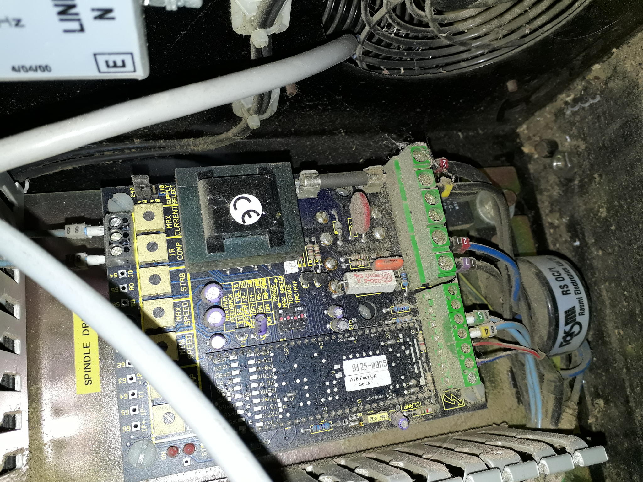

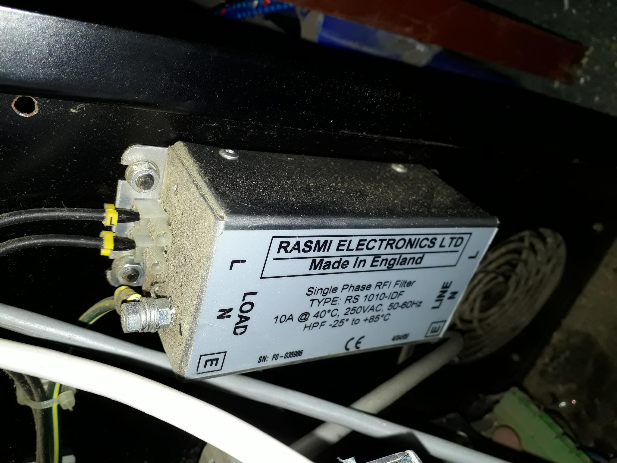

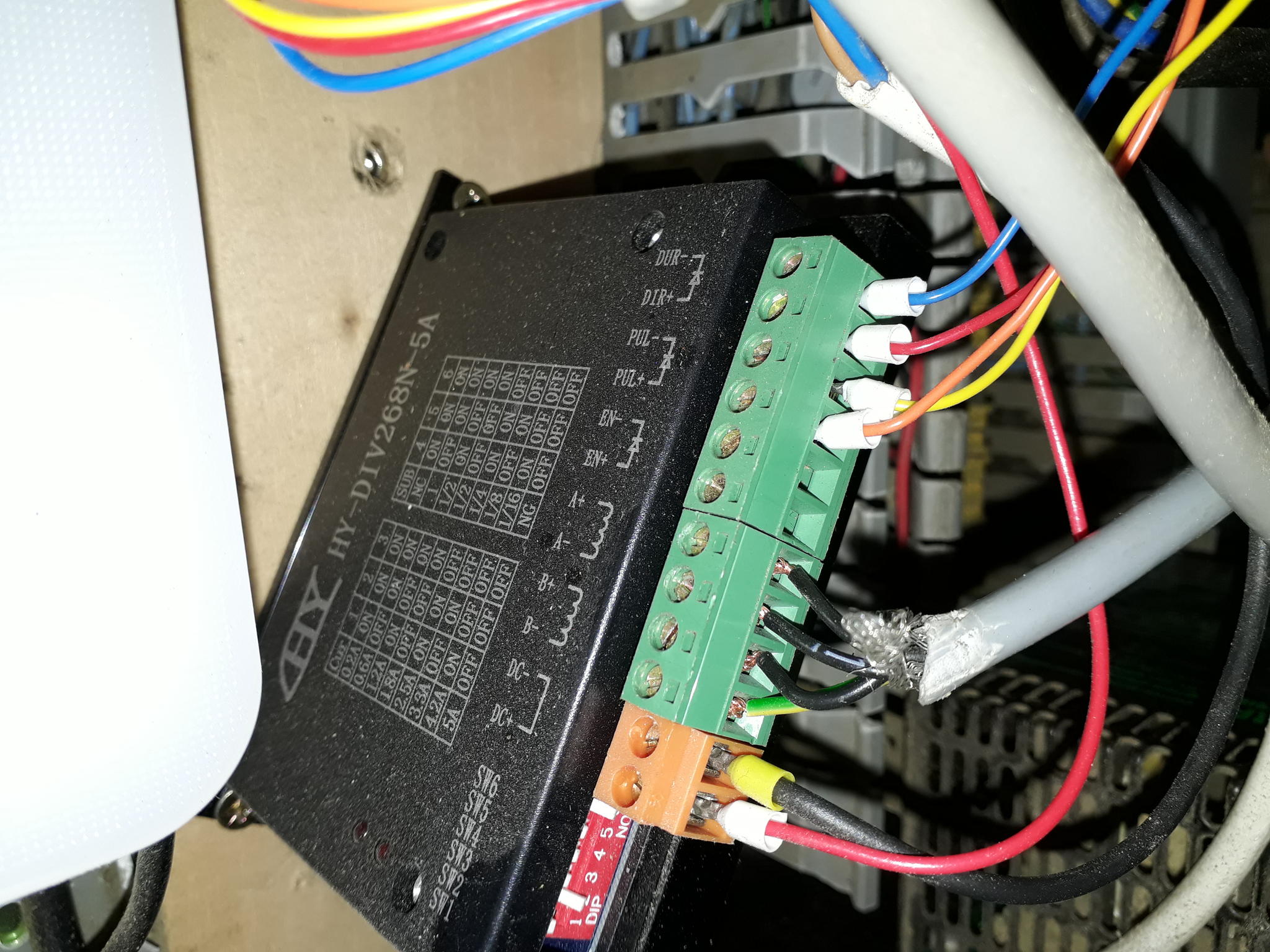

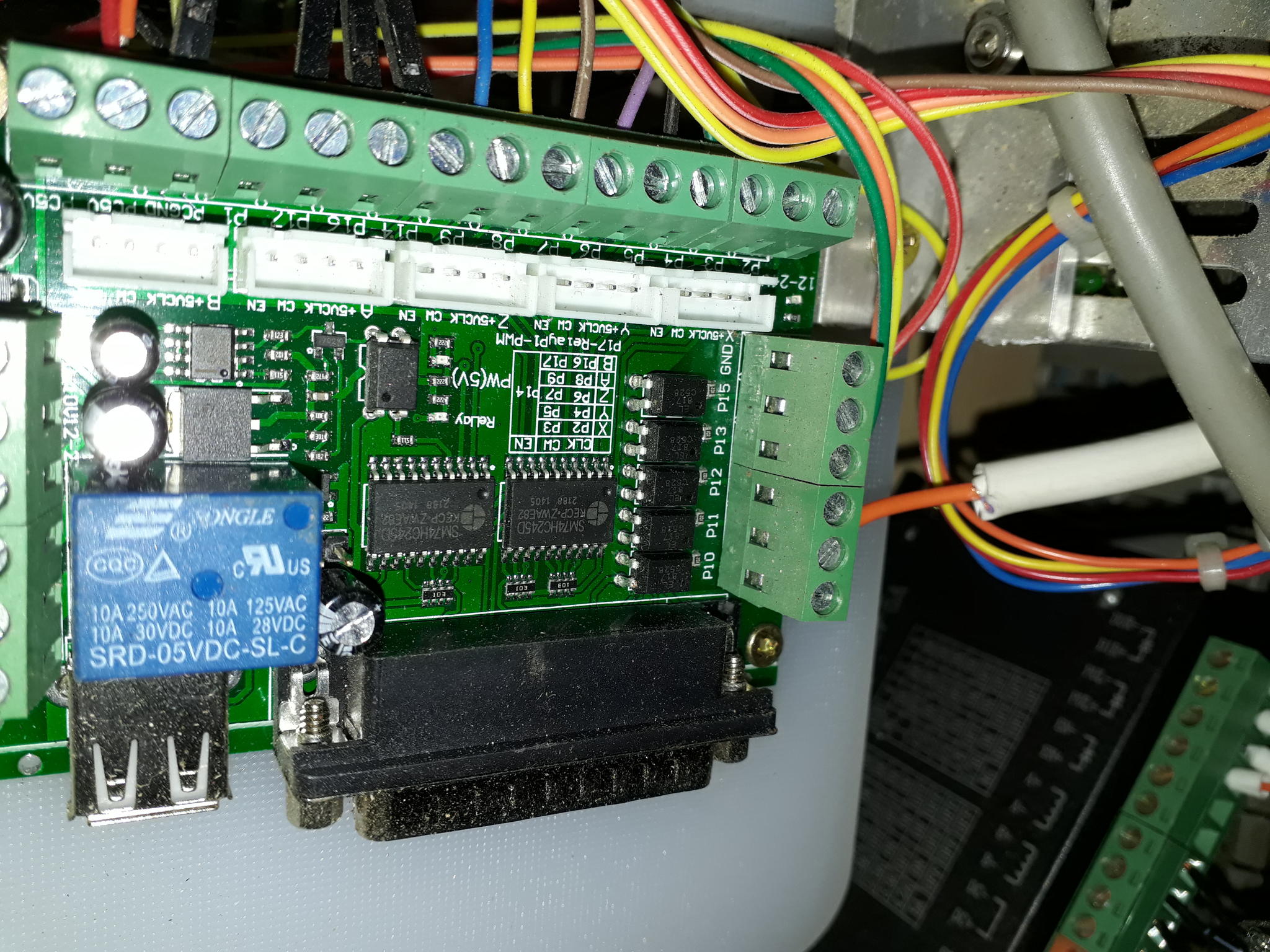

I have aquired a Denford MicroRouter that has been modified to run on Mach3 using what I believe is the original Cable Porter spindle. What I want to do is fit a new spindle with an ER collet so I can use smal (1.0 dia) cutters to finish components that have been semi-finished on a different machine. As I would still like to use the router for machining wood I would ideally like to find a spindle that will run off the existing electronics.
The on/off and speed of the spindle fitted is controlled by a Spindle V5 board (https://0201.nccdn.net/4_2/000/000/0...spindleV5x.pdf). I have attached pictures of all the other internals in case information on them is needed.

		The BoB you have, I am certain, has 0-10v output to control spindle speed with a VFD and Spindle setup, so you don't need any more electronics apart from the VFD. The rest is setting it up in Mach3.
 Thanks, so which spindle should I be looking at bearing in mind it is for finishing only so RPM is more important than power.

		Just a quick update to let you all know the outcome.
I ended up buying a serial to RS-485 adapter (less than £3 on fleabay) and downloaded a plugin to ebable Mach3 to control my spindle directly.
The new spindle is fitted and running and I was originally using a 5 gallon drum for a water reservoir but this didn't stop the temperature hitting the mid forties centigrade during the hot Easter weekend. I have to point out my workshop is upstairs and the room temperature was in the low thirties. As downstairs is always a lot cooler and having plenty of plastic pipe to hand I simply added about 15 metres of pipe to the outet and ran this downstairs then bak to the tank which solved the cooling problem.
