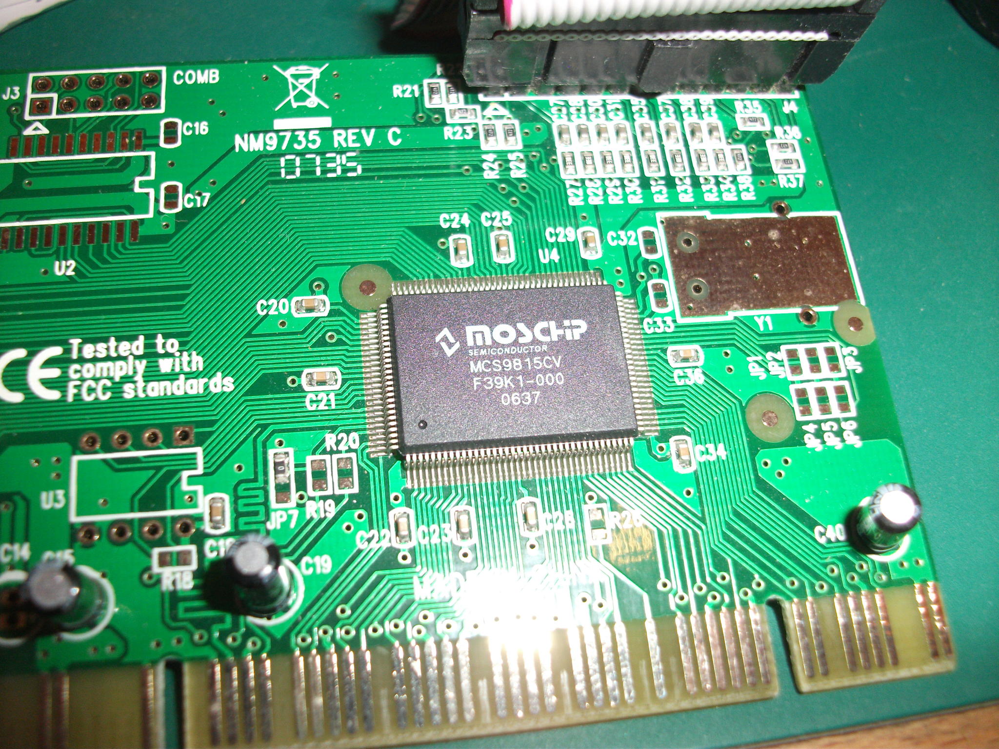

Back to Topic though, I have a new (old tower with a working hard drive now and have just installed the pci card, and the version of mach that I downloaded. However, it would appear I am still missing he pci card driver, I know not what it is called etc so feel a bit stuck.
Re: Made a right balls up
Can you let me know what chip is on the PCI parallel port board and I will see if I can root out a driver for you. if it is a NetMos chip I will need the 4 digit chip which is something like 9825 or so. Let me warn you that these can be a bugger to install.
cropwell
Thanks for your help Cropwell. I had a look at the number, it is: 98651V. does this mean anything to you? because it means bugger all to me :thumsup:
It looks like a Moschip board - you should find a driver here http://www.network-drivers.com/companies/1614.htm If that is no use, I will need more details of the hardware.

Right, I found a driver and downloaded it. It came with a thing called driverupdater or something. Alas, I couldn't install the driver as driverupdater wanted the internet and my mill pc isnt connected so it simply would not install. I got the driver from elsewhere, and again, it came with driverupdater, and as such, wouldnt install without the internet. Bum
Is this the chip on your printer port board ?Attachment 25754
If so your printer driver is here https://www.dropbox.com/sh/fjwgmfaue...sFt6cGSta?dl=0 You will have to copy the files to a memory stick and run the Moschip setup program form the stick.
Hi Cropwell.
I'm afraid not. the chip has no logo on it, just the aforementioned number and some other numbers. Such as: CH350L, 202205221, CH352PA5@1012, and 0413.
ah, thanks for that. The pci card in the picture at the top of that website page looks exactly like the one that I have. Just downloaded the driver, will have a go at installing it tomorrow. Thanks again.
