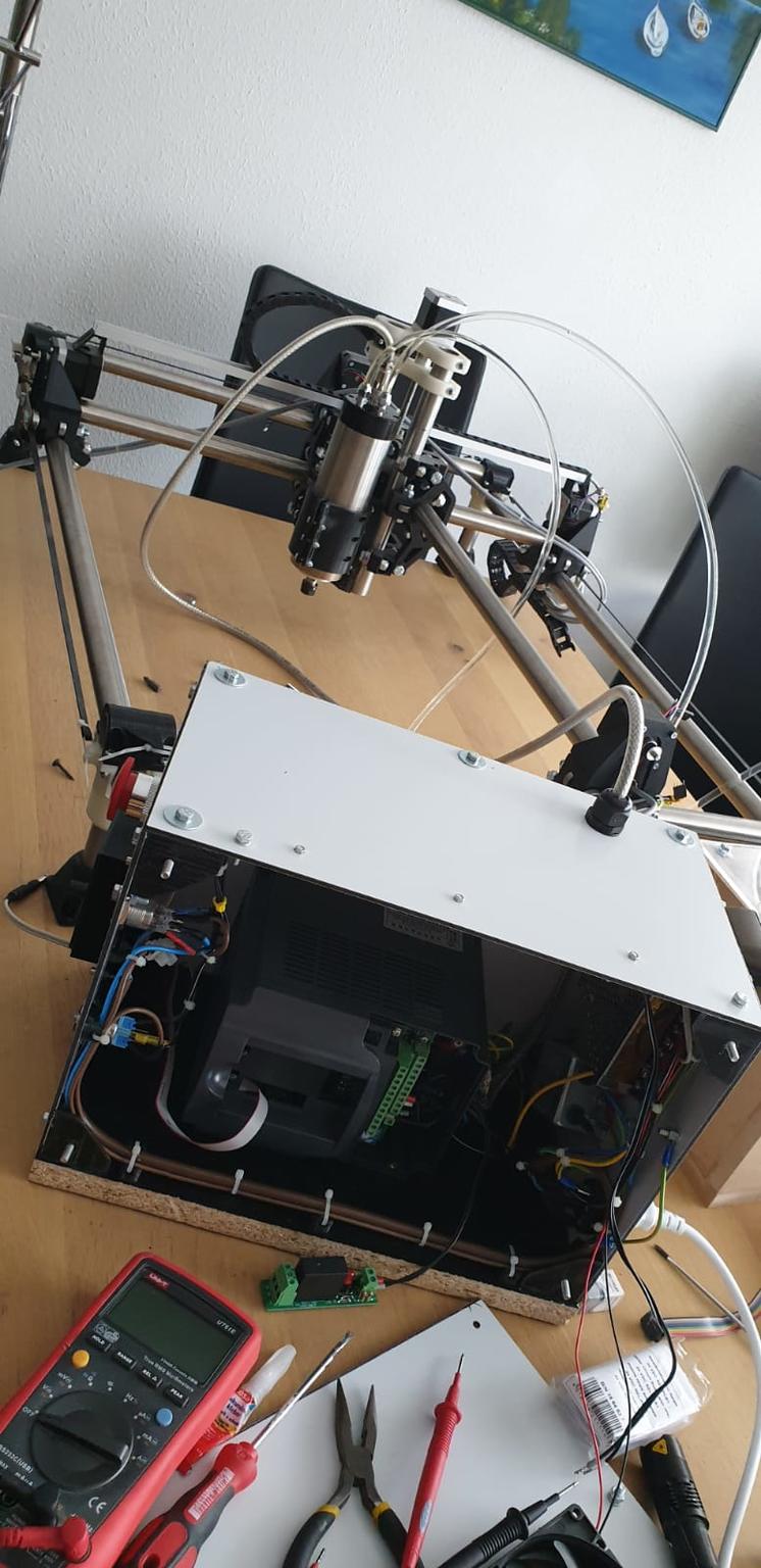

		Huanyang VFD, how to get Waterpump switching on with UPF/DRV/DCM connectors?
		Hi, I built my first CNC Router (just a "lousy" MPCNC :)) and got a 0,8kw Chinaspindle and Huanyang VFD2,2kw.
I created a Waterpump solution using 12V supply.
I would like to only turn the pump on, when the spindle runs. Therefore I wanted to use the DRV/UPF/DCM connectors switching an external Relay on. I already programmed PD050 and PD051 to "1" but I cannot measure anything between these two ports (no matter if spindle is on or off).
Now I dont have any clue how I could use these 3 ports for this action?
The FA/FB/FC Terminals are already used to switch the CNC off by error.

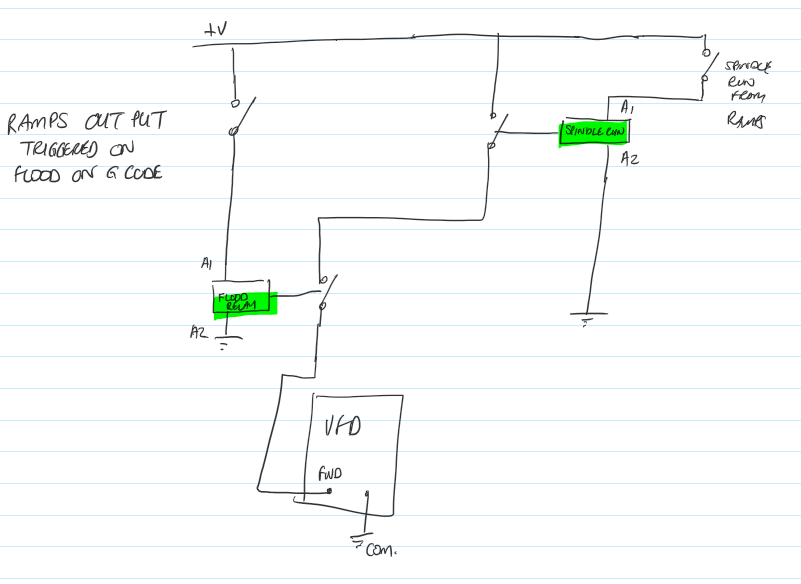

 Not difficult to do.
You could run a relay from your controller, activated on M8 (flood) or M7 (mist) G Code, that then enables the Coolant pump but then runs through another relay which is triggered by the Spindle Run command (For your spindle). I do the same for my CNC Lathe but dont care about spindle status.
Get yourself some 24V relays and drive the logic from your controller. What control option are you using?

		I use simple Arduino with Ramps controlled by Marlin 2.0. As I mentioned, this is only a MPCNC.
Attachment 25763

 Ok, so can you have an option where, in your code, you enable a G Code and then enable an output signal? I used Marlin and RAMPS for my 3D printers, so it should be possible.
The same way a heatbed is activated (Relays on the board) you can do here. Enable a relay, switch an external relay that has logic. Ill draw a circuit diagram if it helps ... ?

		It should be as simple as this. Your spindle already has some logic to start stop. Tap into that, use a Normally Open switch (add a new relay if needed) to then feed a Normally Open switch triggered by Ramp's output for M8 G Code which then goes to your Coolant Pumps FWD connection. I've Grounded the common side but you need to work out what your VFD wants here.
Attachment 25764

			Thanks for your drawing!
 Does it make sense / help?

		Yes it makes sense, just dont know what you mean with "flood".
I am still in building phase of the CNC. Meanwhile I drive the pump simply with +24V and DCM triggering a 24V Relay. That means its always on when VFD is on, thats good enough for now. I will later on realize your idea with switching from Ramps with Gcode which is pretty smart.
