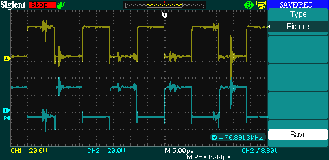

 I'm adding a spindle to my mill, just for small turning parts etc. I'm using the chinese AASD servo and drive but cannot get it to run correctly on my controller. The controller is a CS Labs IP/A unit.
 It will run ok as long as speed is below say 2900 rpm but if i ask for full speed the controller faults on max following error being exceeded.
 In Pid tuning you can jog the spindle at various speeds and below 2900 rpm the following error is low <100 as you go over that speed the counter just runs away until it faults and stops
 JazzCNC had the same setup here...
 https://youtu.be/tW8knRAOr7s
 and it seems to run ok.
 I also have these motors/drives on all other axes but the big difference is that they never run flat out as i have the motion tuned pretty low. I did take a motor off of another axis and connected it to this drive and it did the same thing so that points to the drive or controller??

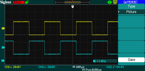

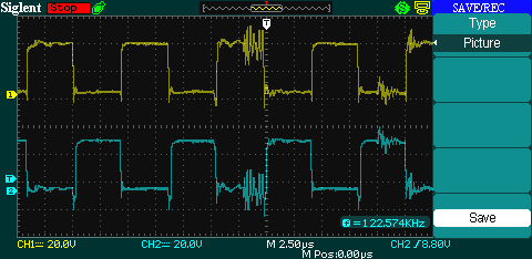

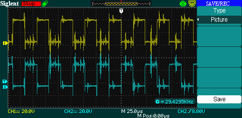

 Four pictures below of encoder channel A, at the controller, three at different speeds and one taken direct from the drive output with cable to controller disconnected.
 I have no idea if these are normal or bad??
 Its not a ground loop as the signal does change if i remove the shield connection.
 Attachment 25806
 Attachment 25807
 Attachment 25808
 Attachment 25809
 Totally baffled.
 Any suggestions?

		Its not encoder related as far as i can see  :(
 I had a spare 600ppr encoder so wired that in and connected it by clamping in the spindle.
 It still suffers the same fault, just slower as there are only 2,400 pulses instead of 10,000 per rev - the error count just goes up slower.
 It still worked ok until 2980rpm.

		Thanks. I did et a reply from CS-Labs shortly after posting, they did confirm that you cannot expect to pid-tune a servo to 3000 if its limited internally to 3000, they also advised, for the same reason to increase the gain to 400rpm/V - this was again to increase headroom and allow Pid to do its thing.
 Its working now, error is about 2500 but thats because i only have P value set - seems adding any I or D causes issues, adding I seems to lower the error, i can get it down to about 200, but it makes it wobble at zero point and very unstable at speeds < 800 rpm, it gets very jerky at low speeds with I values.
