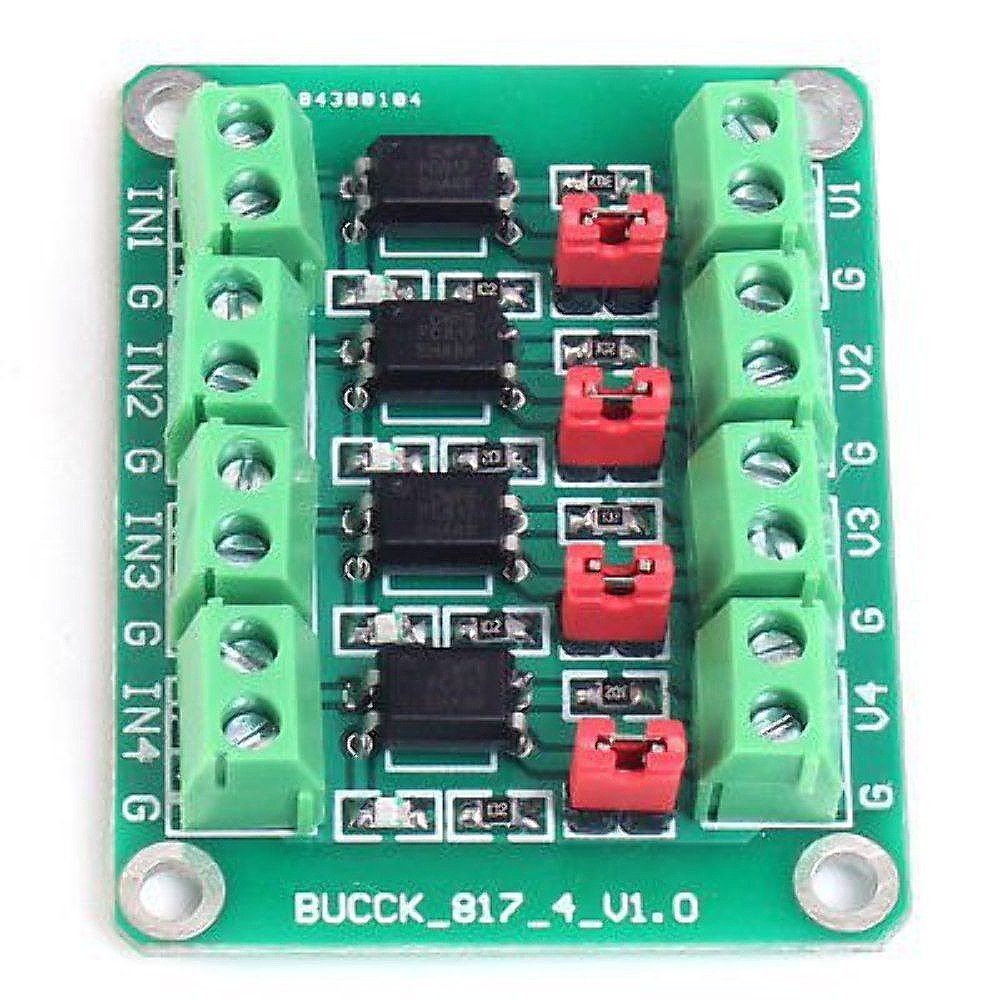

going by your photo of the opto-isolator board it looks like the opto-isolators photo transistor collector is connected to the output terminal (U1, U2 ,U3 ,U4 ) via a resistor
the photos resolution is too low to read the value
can you either post a photo that shows the 3 numbers printed on the resistors or just say what the resistors are in your reply

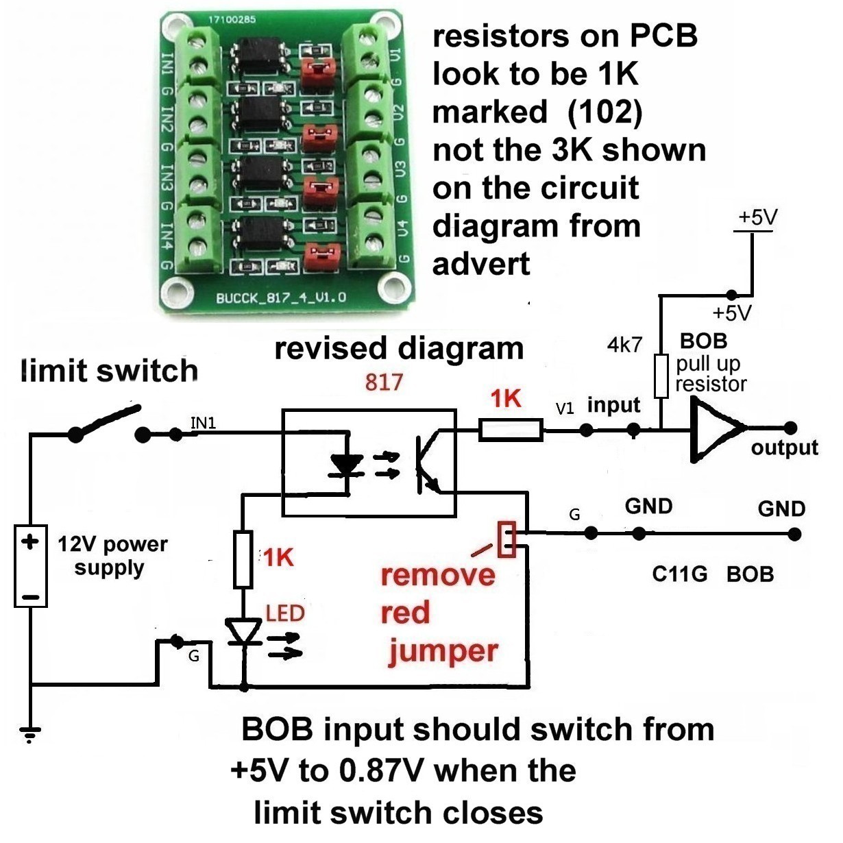

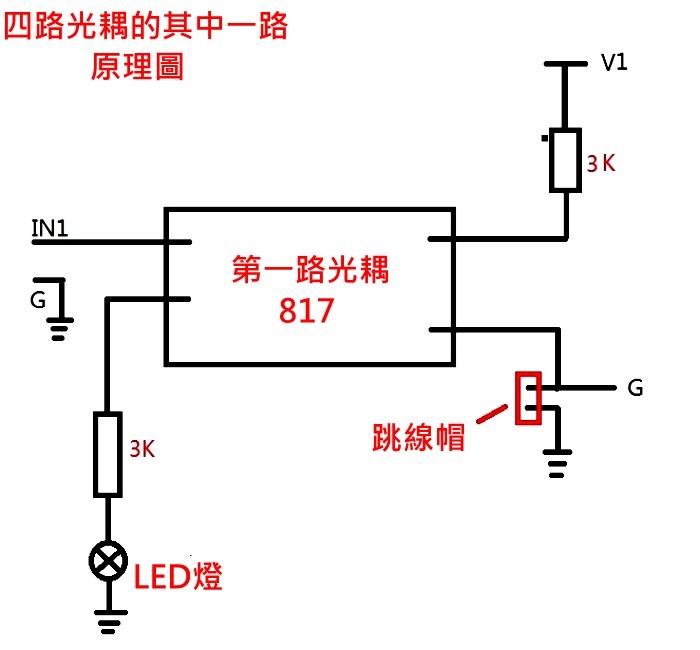

found this circuit of the 4ch opto-isolator board online
Attachment 25980
looking at this photo it looks like the resistors are 1K (marked 102) and not the 3K on the circuit diagram !!!

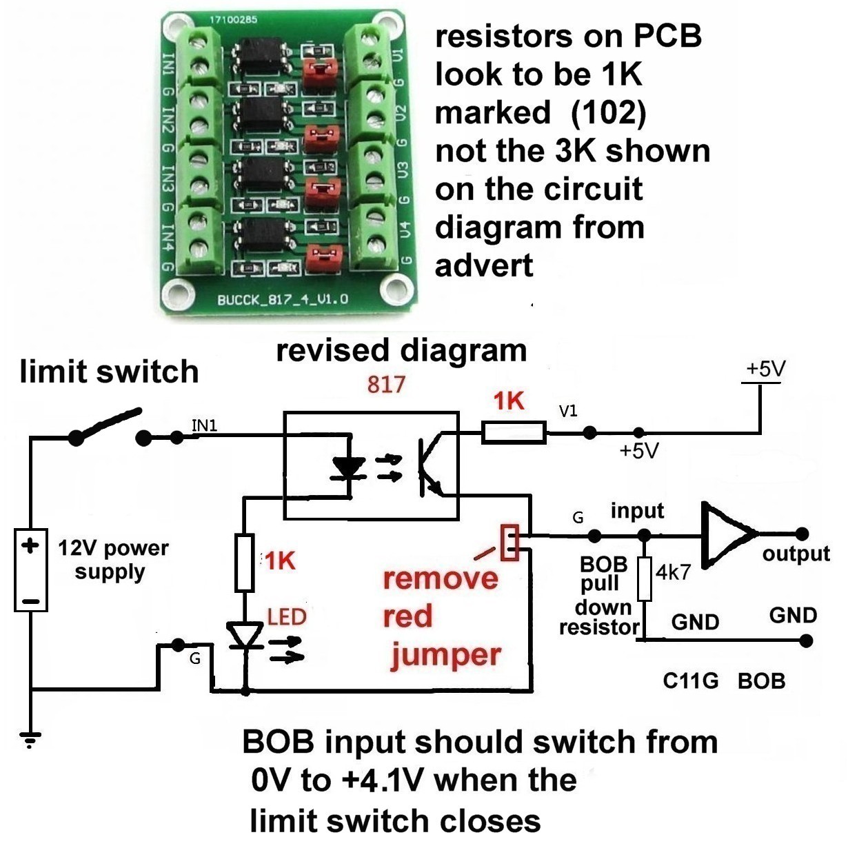

once the details of the breakout board are known it will be possible to workout if the 1K resistor connecting the photo transistor to the output terminal will stop the BOB seeing the output switch
PPS
example
two possible ways of connecting the opt-isolator board to a C11G breakout board
Attachment 25982
Attachment 25983
revised diagram for your BOB can be made once I have details of the BOB
with the 1K resistor on the opto-isolator board the opt-isolator board limiting the current

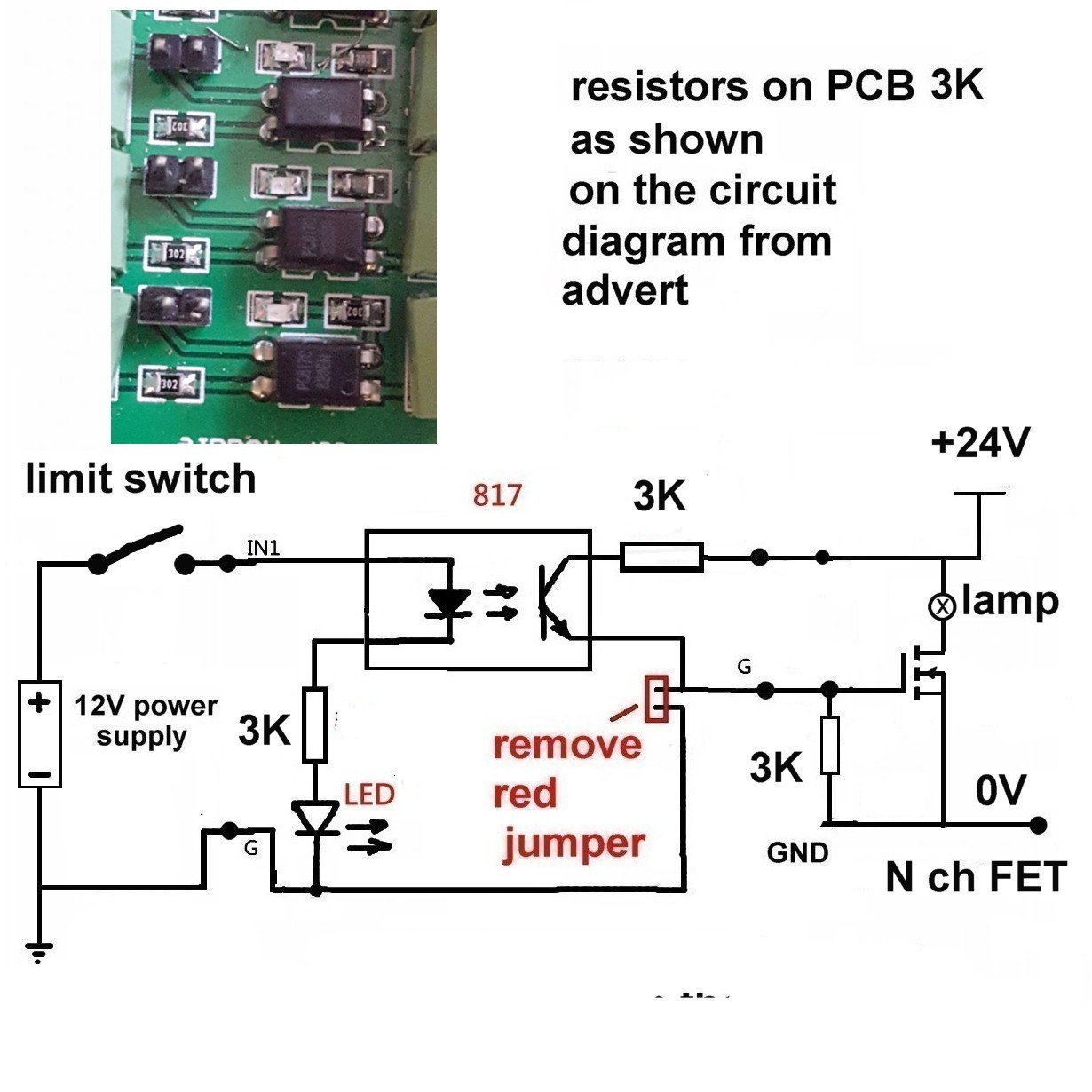

looking at the photo of the opto-isolator board
it has 3K resistors fitted as shown on the chinese circuit diagram
so the output current is even more limited
with a 3K or 3.3K resistor between the gate and source of the Fets you have you could wire the opto-isolator to pull the gate upto +12V (half of the 24V supply ) to switch the FET on
Attachment 25986
the BOB is like this I have looked at before
Attachment 25985
John

it looks like you have all the parts to try it out with the FET
the combination of the high value resistors and the gate source capacitance is going to slow the FETs switching but for this application it should be OK
I usually use a 100 ohm resistor to connect the gate to a low impeadance driver
(very like the 100 ohm "grid stopper" with valve (tube) circuits )
John
