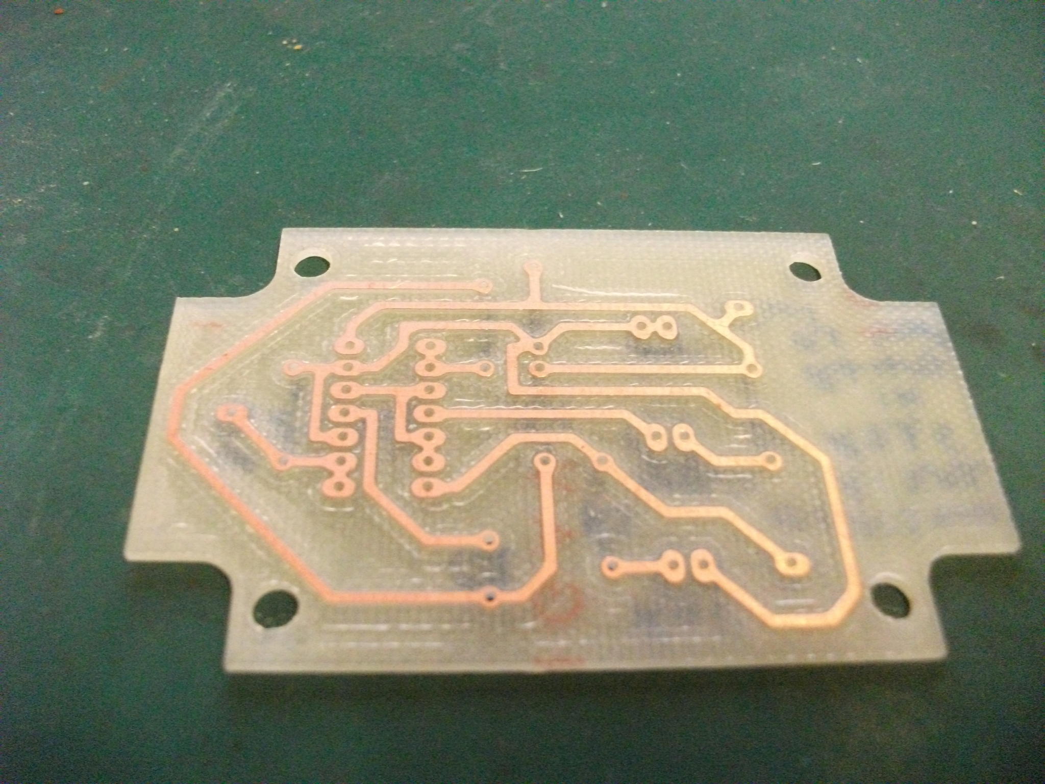

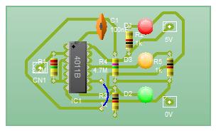

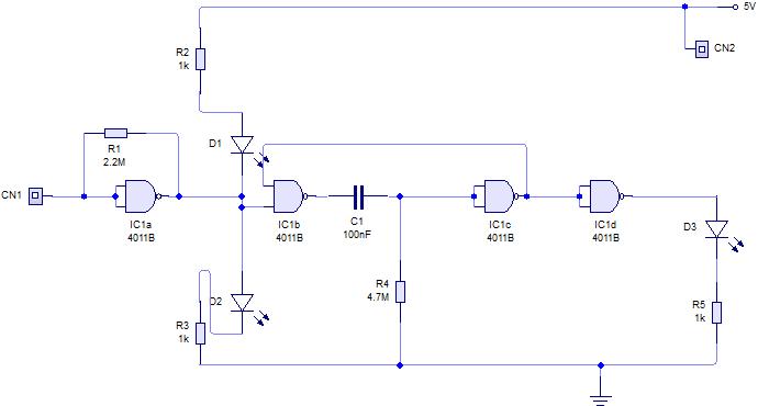

This was my yesterday project ---
Attachment 26017
and I briefly mentioned it in another thread.
Doddy - I cut the PCB with a 1mm single flute mill to drill the holes and clear the bulk of the copper, then tidied up the tracks with an engraving cutter, DOC 0.2mm.
The circuit was designed by an adaptation of one I found on t'Interweb. It is a logic indicator (Hi-Lo-Pulse) which used a 4001 quad NOR gate. I rejigged it to use a 4011 quad NAND gate as I could find some of those (I have probably also got a tube of 4001's somewhere in my entropy driven storage area).
The circuit was drawn up using Circuit Wizard (which is old and has a very basic component library) and that produced the circuit board and output Gerber and Drilling files.
Attachment 26018
Attachment 26019
I then used CopperCAM to build a dxf from the Gerbers and then I put the dxf through the CAM process to give Gcode.
This was all a small run as I want to do a larger board for my next(ish) project, but I will be starting with KiCAD for the circuit design.

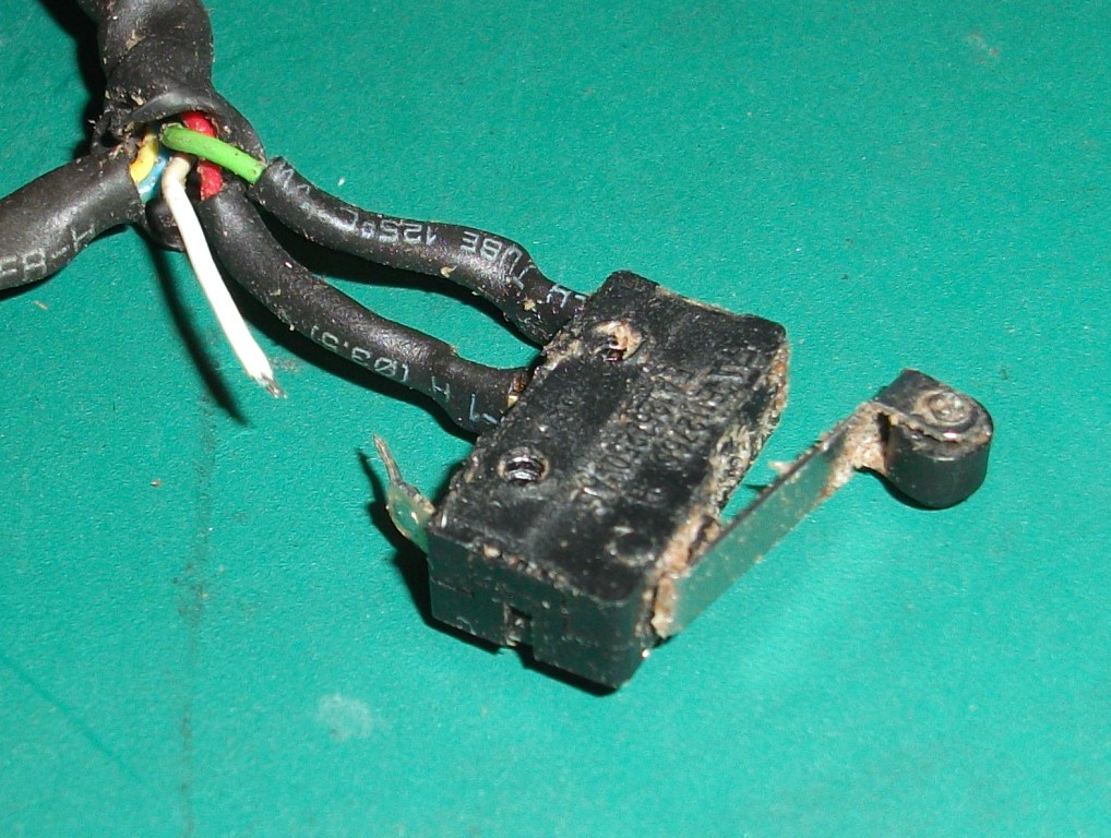

cropwell
but I am up to my neck in minor problems to sort out, including why my limits switches have just decided to stop fecking working and why the downstairs toilet light doesn't come on...........
Limit switches?, had same with my home switches recently - turned out the supply to the NPN proximity switches was disconnected and the system failed silent. Bad design that I need to get around to fixing (nothing more fun than stalling your Z axis and bending the limit switch out of the way).
Downstairs toilet light... also had this fairly recently and ignored the fused spur plate above head height in the bathroom and rewired around it in the cavity. Then saw the plate and did the Homer ("Doh!"),

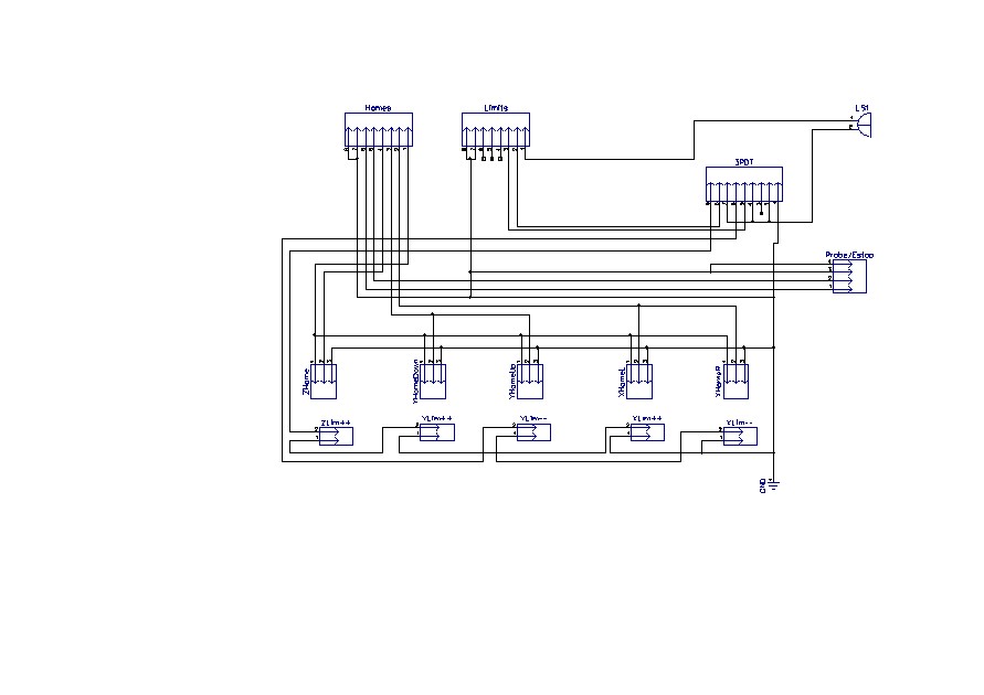

Attachment 26061
I think I may have found the Limits switch problem, when I put a larger cable chain I did not route the Z axis homes and limits cable properly and it was being pulled along the X axis. .
I am going to remake the bracketry when I get my 3D printer working again (waiting for X axis motor cable). It just seems that disconnects in moving cables are blighting my life at the moment).
I need to get back onto PCB cutting !!!
